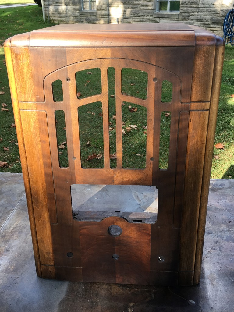

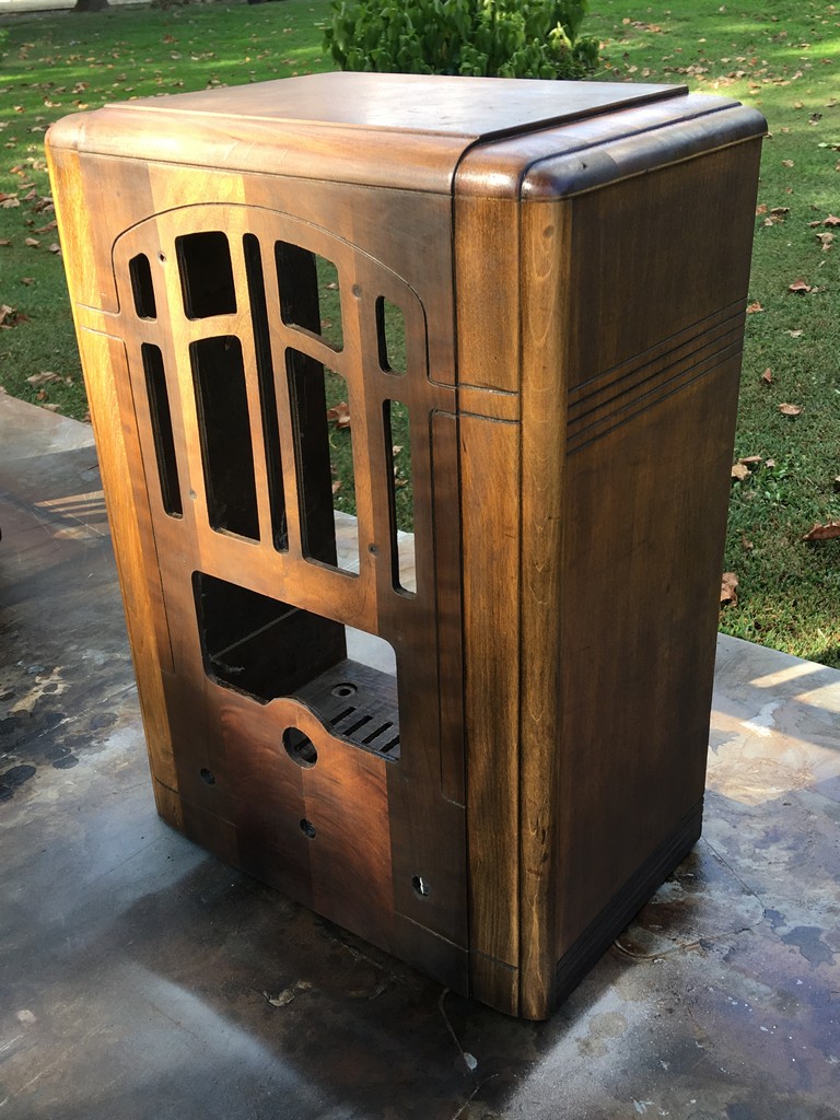

How the front panel looked after the grain filler had been rubbed with burlap:
[Image: http://www.philcoradio.com/images/phorum...T2_012.jpg]
Eventually, grain filling was complete on the top and sides as well.
[Image: http://www.philcoradio.com/images/phorum...T2_013.jpg]
[Image: http://www.philcoradio.com/images/phorum...T2_014.jpg]
Don't let the sunshine fool you - the cabinet is darker than the pictures seem to indicate due to the grain filler and its residue.
Removing the excess grain filler from the routed grooves was a bit of a challenge, but I think I did okay with that.
The goal for tomorrow is to sand off the grain filler residue, then begin toning the cabinet. I have not yet determined which color toner to use. The original color, from what I'm finding on the Net, is somewhat dark but not to the point of being super-dark like Extra Dark Walnut. What was left of the original finish on this cabinet was dark as well. I have some Dark Walnut to try as well as Perfect Brown and Dark Red Walnut (all Mohawk Ultra Classic). I'll try all three on a scrap piece of wood before deciding.

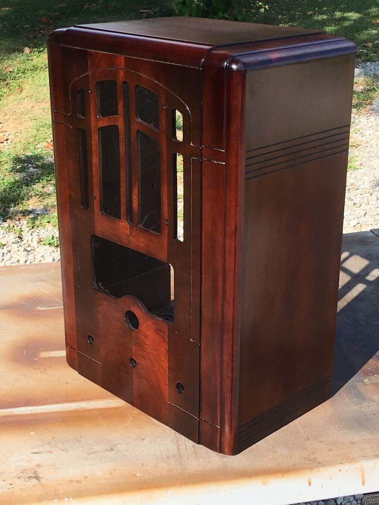

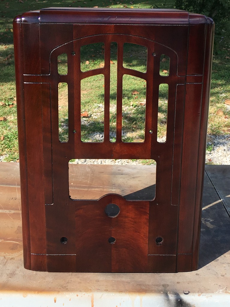

Thanks Ed. Hopefully you (and anyone else reading this) will approve of today's progress.
I wet sanded the cabinet with 400 grit paper, wiped it down, let it dry, and then began applying toner.
After test spraying Medium Brown Walnut, Perfect Brown, Dark Walnut and Dark Red Walnut on a piece of scrap wood, I came to the following conclusions:
Medium Brown Walnut appears to be nearly the same color as Perfect Brown. Now, this may not be true if sprayed on old wood such as a stripped radio cabinet.
Dark Walnut was actually lighter than both of the above...possibly even slightly lighter than Medium Walnut Tone Finish.
The closest match was Dark Red Walnut, so that is what I chose.
I applied one of Mohawk's optional nozzles to the can (the first time I've ever used these), and began. Here are the results.
[Image: http://www.philcoradio.com/images/phorum...T2_015.jpg]
[Image: http://www.philcoradio.com/images/phorum...T2_016.jpg]
[Image: http://www.philcoradio.com/images/phorum...T2_017.jpg]
I really like these Mohawk nozzles - they make the spray toner behave as if it were a can of Deft; that is, the spray pattern can be changed from horizontal to vertical. This allows a more uniform coat from a spray can. I'll keep using these nozzles, as they are much better than the conical pattern nozzles which come with the Mohawk products.
Yes, the cabinet is dark. What was left of the original finish was dark. Plus images I have found online of 6T2 sets that still have original finish are just as dark, so I think I chose a good color as a replacement finish.

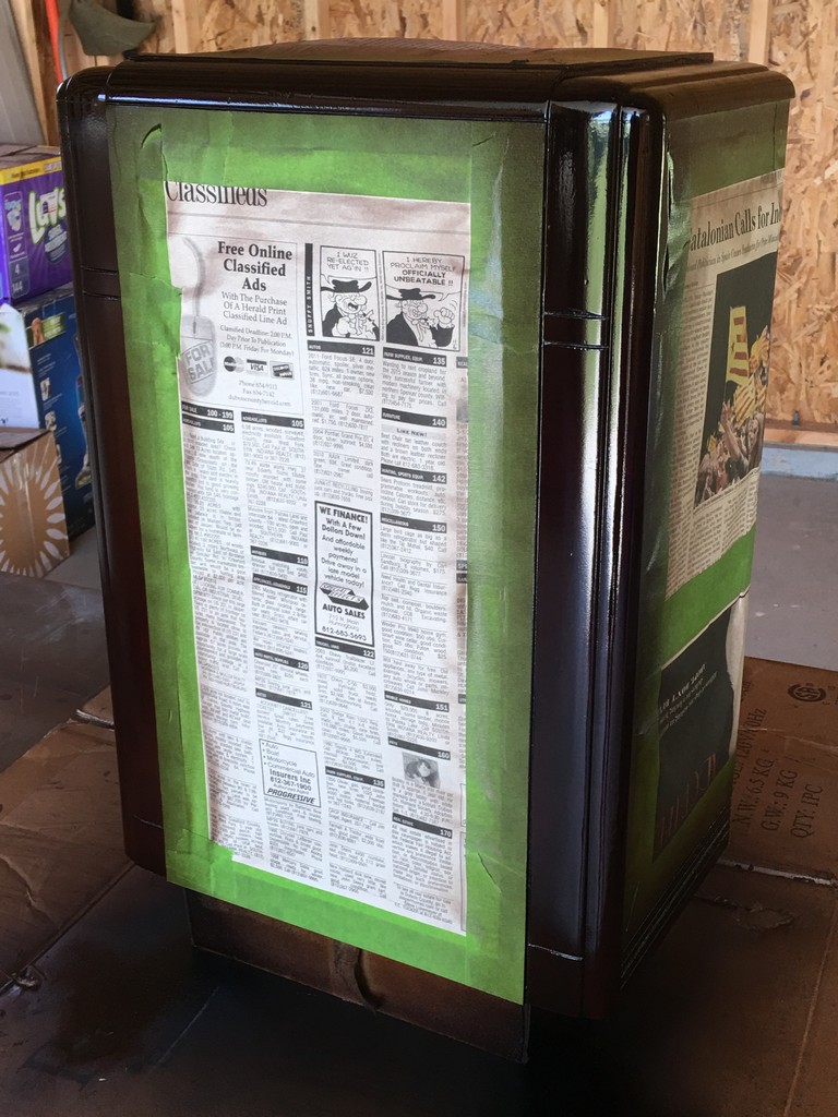

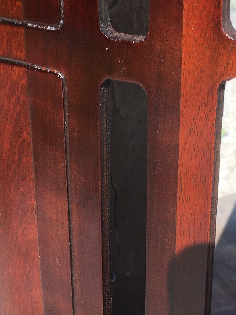

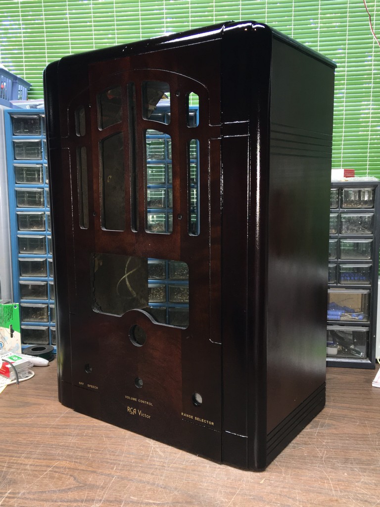

After staring at more 6T2 pictures, I decided that the "white wood" on this cabinet needed to be darker than it was.
So...
[Image: http://www.philcoradio.com/images/phorum...T2_019.jpg]
Yup...I masked off the cabinet (no easy chore) and sprayed two coats of Mohawk Extra Dark Walnut on the "white wood" areas.
[Image: http://www.philcoradio.com/images/phorum...T2_020.jpg]
What appears to be blushing on the right side trim is just a reflection of something. The cabinet is fine. I've been fortunate so far, having had no issues with blushing lacquer in spite of the 90+ degree heat and high humidity here. I'm doing my spraying in our standalone garage, where my truck normally resides. And unlike those dummies who are killing themselves using methylene chloride strippers indoors with no protective gear, I'm using a respirator when spraying lacquer. And the overhead door of the garage is left open while spraying, as are the few small windows this garage has. I think the fact that this garage is rather large and has a high ceiling is making a difference in how my work is turning out.
I'll post a photo of the cabinet with the masking removed later.

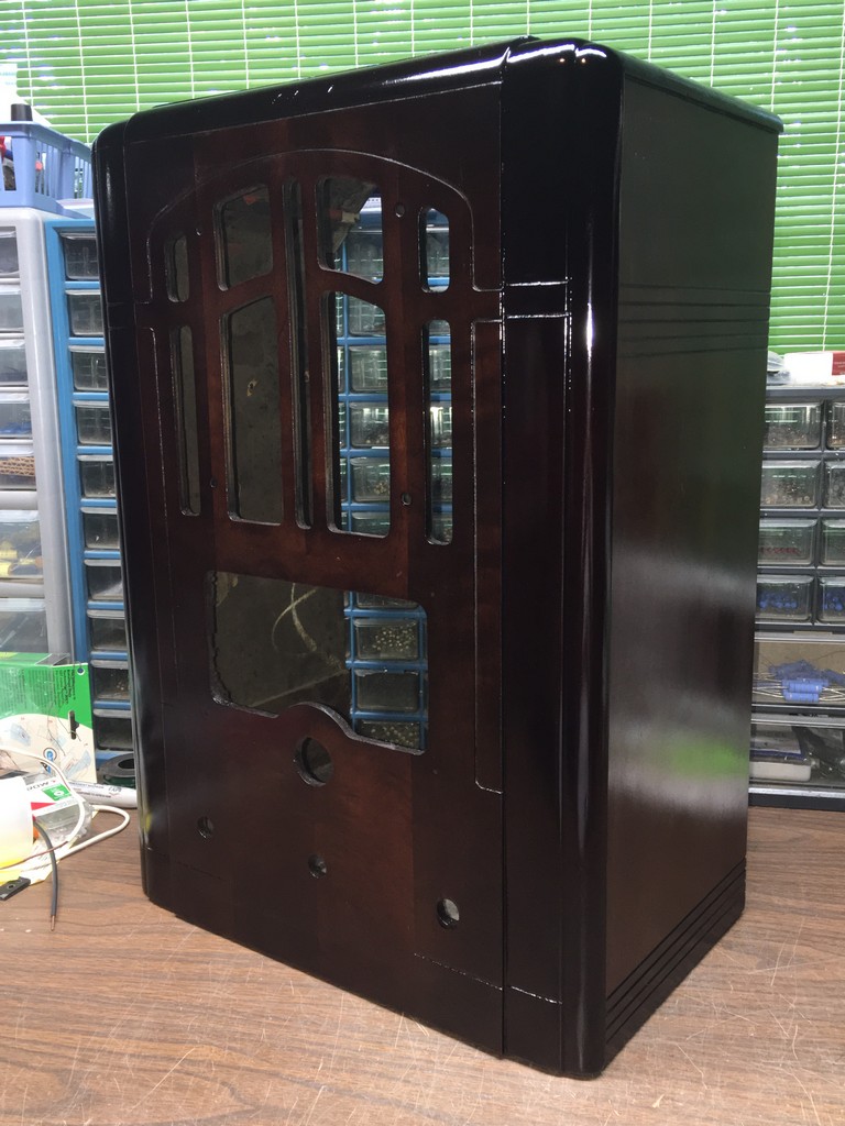

Here's a photo of the 6T2 cabinet with the masking removed, with flash:
[Image: http://www.philcoradio.com/images/phorum...T2_021.jpg]
I think the coloring now more closely resembles the original finish.
Next up: To add the decals, then to begin spraying the cabinet with clear lacquer.

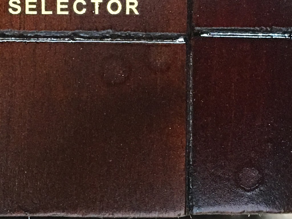

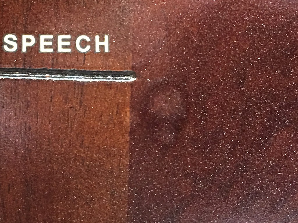

Oh, I managed to get the decals on with little trouble (save for messing up one OFF - SPEECH decal and having to remove it and apply another).
But when it came to applying the first couple coats of clear lacquer...
[Image: http://www.philcoradio.com/images/phorum...T2_022.jpg]
Doesn't look too bad, eh? Take a closer look:
[Image: http://www.philcoradio.com/images/phorum...T2_023.jpg]
[Image: http://www.philcoradio.com/images/phorum...T2_024.jpg]
Somehow I managed to get some big drips of lacquer on the front panel.
Well, I am hoping that with some careful wet sanding, that I will be able to compensate for these errors without having to strip and start over.
