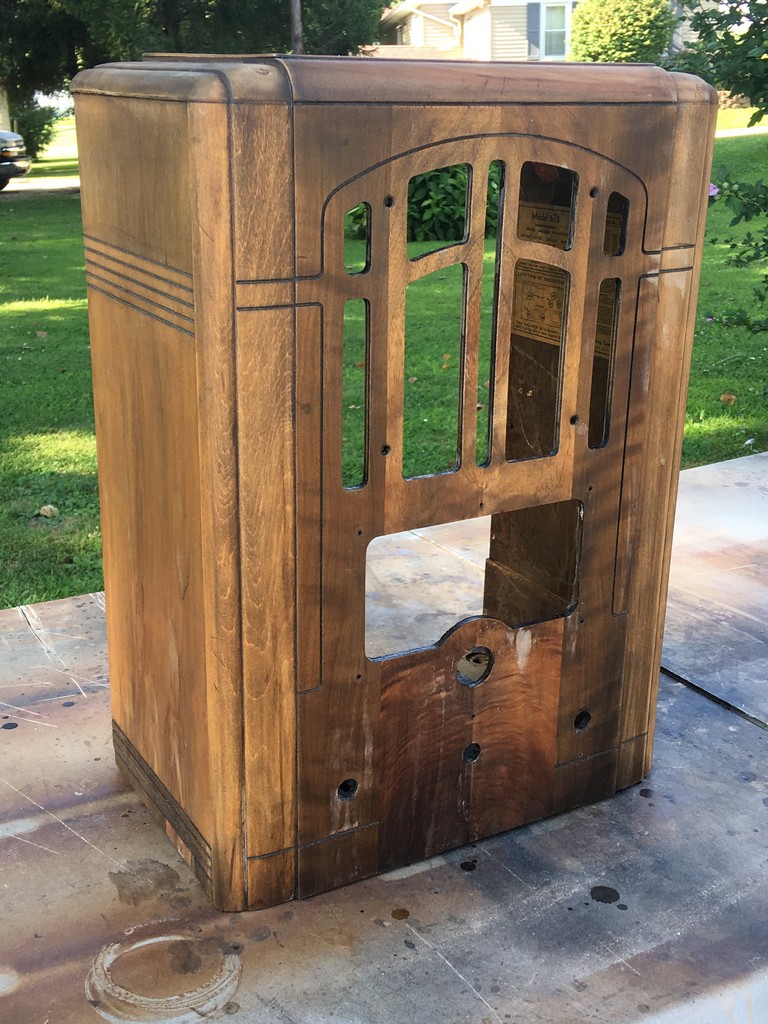

I had to work this morning, but this afternoon I completely stripped one cabinet.
[Image: http://www.philcoradio.com/images/phorum...T2_009.jpg]
My RCA 6T2. All it needs is a quick veneer replacement on the bottom left side as shown, then it will be ready for finish sanding, sealer, grain filler, and lacquer.

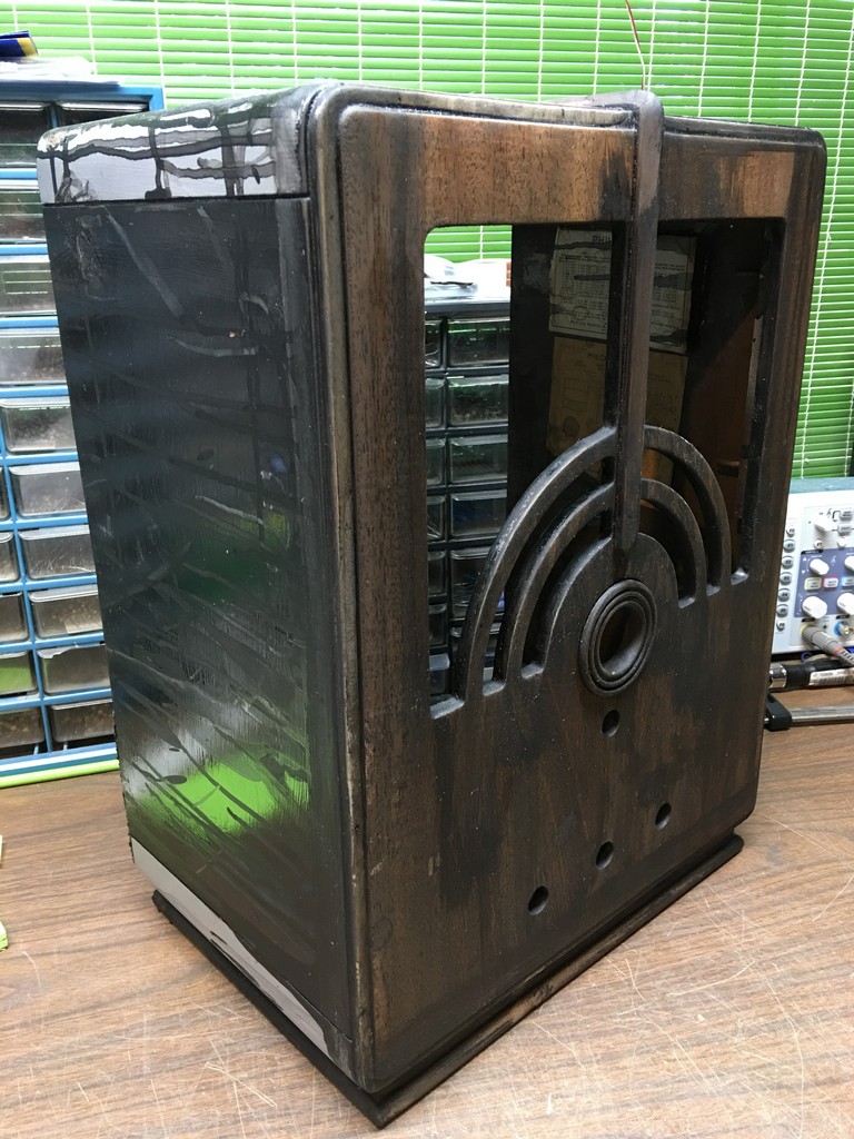

Well, lest youse guys think I have abandoned this thread...here's a brief progress report.
I finally acquired some butyl rubber gloves and tried again.
Success.
[Image: http://www.philcoradio.com/images/phorum...18_008.jpg]
Kirk, I can finally see the wood of the front panel and the top of this Philco 66B.

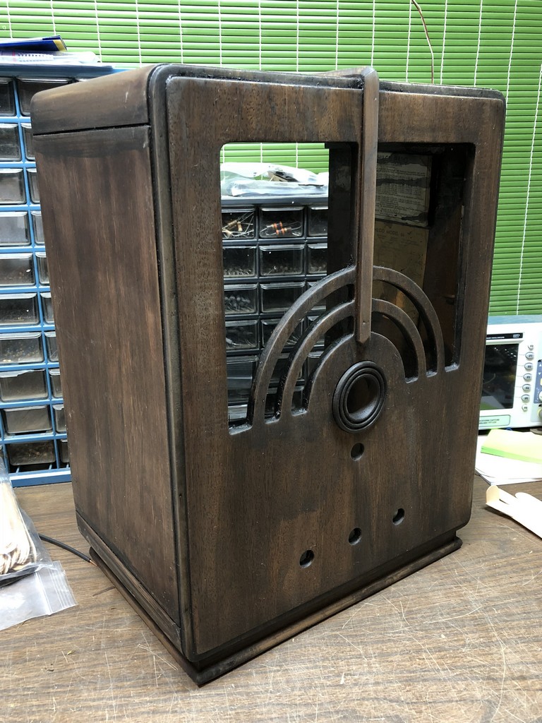

[Image: http://www.philcoradio.com/images/phorum...18_009.jpg]
It still needs a lot of stripping on the sides. Once the worst of the sides are stripped, I think going over it once or twice will take care of the remaining paint residue.
Butyl rubber gloves are the thing to use with the acetone/lacquer thinner recipe, or with straight acetone. At least they held up longer than five minutes.

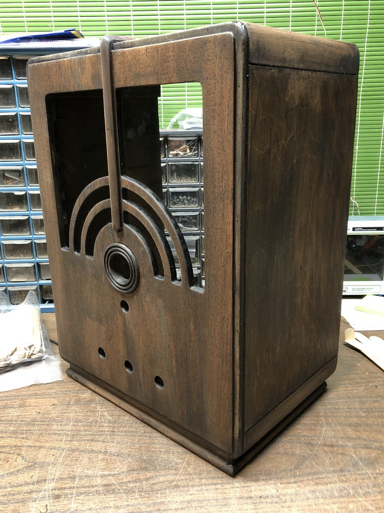

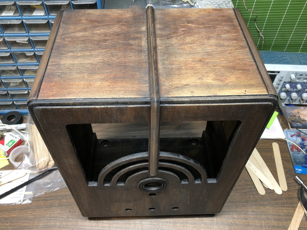

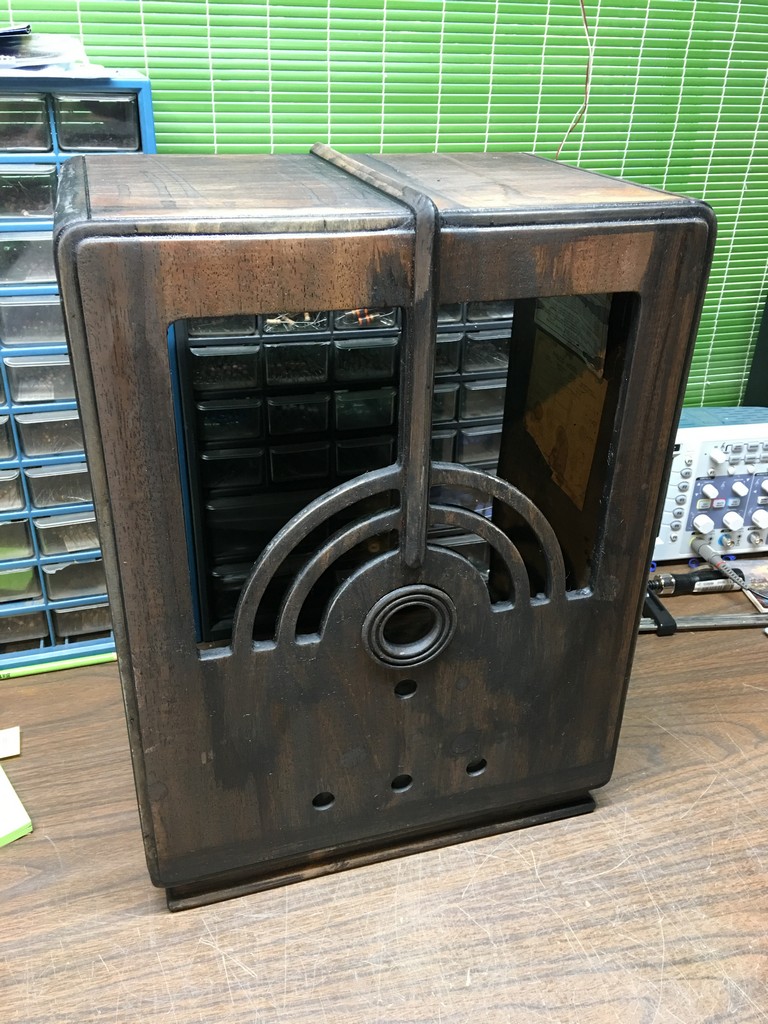

So...after using the paint stripper on the sides, bottom trim, and the trim that goes from top center almost to the escutcheon...and then washing it off with acetone...here is how the 66B looks now:
[Image: http://www.philcoradio.com/images/phorum...18_010.jpg]
[Image: http://www.philcoradio.com/images/phorum...18_011.jpg]
[Image: http://www.philcoradio.com/images/phorum...18_012.jpg]
A big difference from how it did look!
The paint stripper did not remove every trace of paint, but it did remove a majority of the stuff. Acetone is taking care of the residue. I think after two or three more washings, the 66B will be ready for sanding and sealing.
