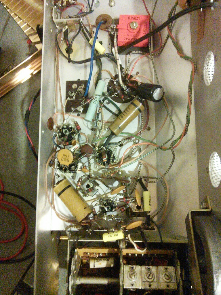

I was able to desolder the quad section twist-lock yesterday.
The sections are 40-40-40-60uF and measure at 60-60-60-80uF.
I am tempted to re-form it instead of re-stuffing. I would buy one but no one, it seems, makes this or close in 1-1/2" body; I see one 4x40uF in 1-3/8" but am not sure it will fit.
The two tubular axials, 10uF-100V and 200uF-10V will be replaced by Sprague Atom types.
All resistors are right there, exactly according to their values, I guess the resistors technology improved in 1950-s.
The bumble-bee caps are off, there are 4 of them, all 47nF, some being 60nF and some - 330nF which means leakage. I won't sweat this and will simply install Illinois capacitors sunny side up Icon_smile - without restuffing anything.

Today I recapped the chassis with the exception of the band switch bay and the rotor.
I read it was involved, and involved it proved to be.
The chassis was easy: I got the quad twistlock 4x40uF from the AES, and it is a perfect mach size-wise, and as for the value, only one cap needs to be 60uF so I added a 20uF underneath.
Two axials went in the cardboard shells from the old ones, with some brown plastic potting.
I had to replace the Bumblebees with yellow caps: I will not restuff the bees, it is not easy and I had tried it before.....nope.

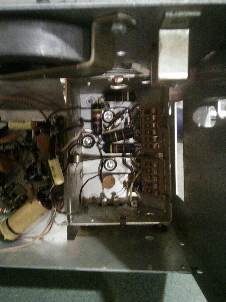

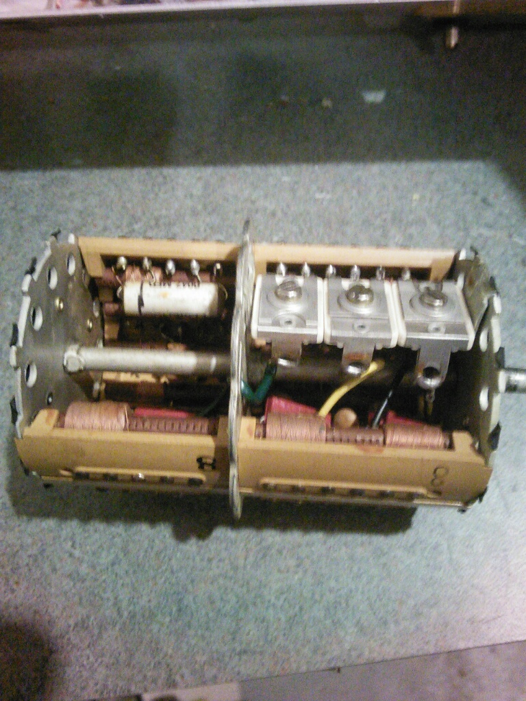

The real challenge came when I decided to recap the nand switch bay, it has 4 Bumblebees.

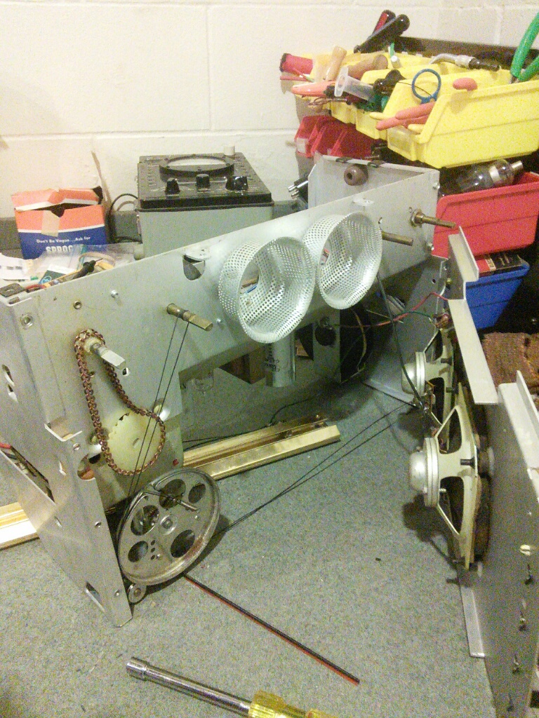

I had to take off the chain that rotates the drum and for this I had to take the rest of the radio apart.
I'm chipping away at it every day. Little by little.
Putting it back together.
