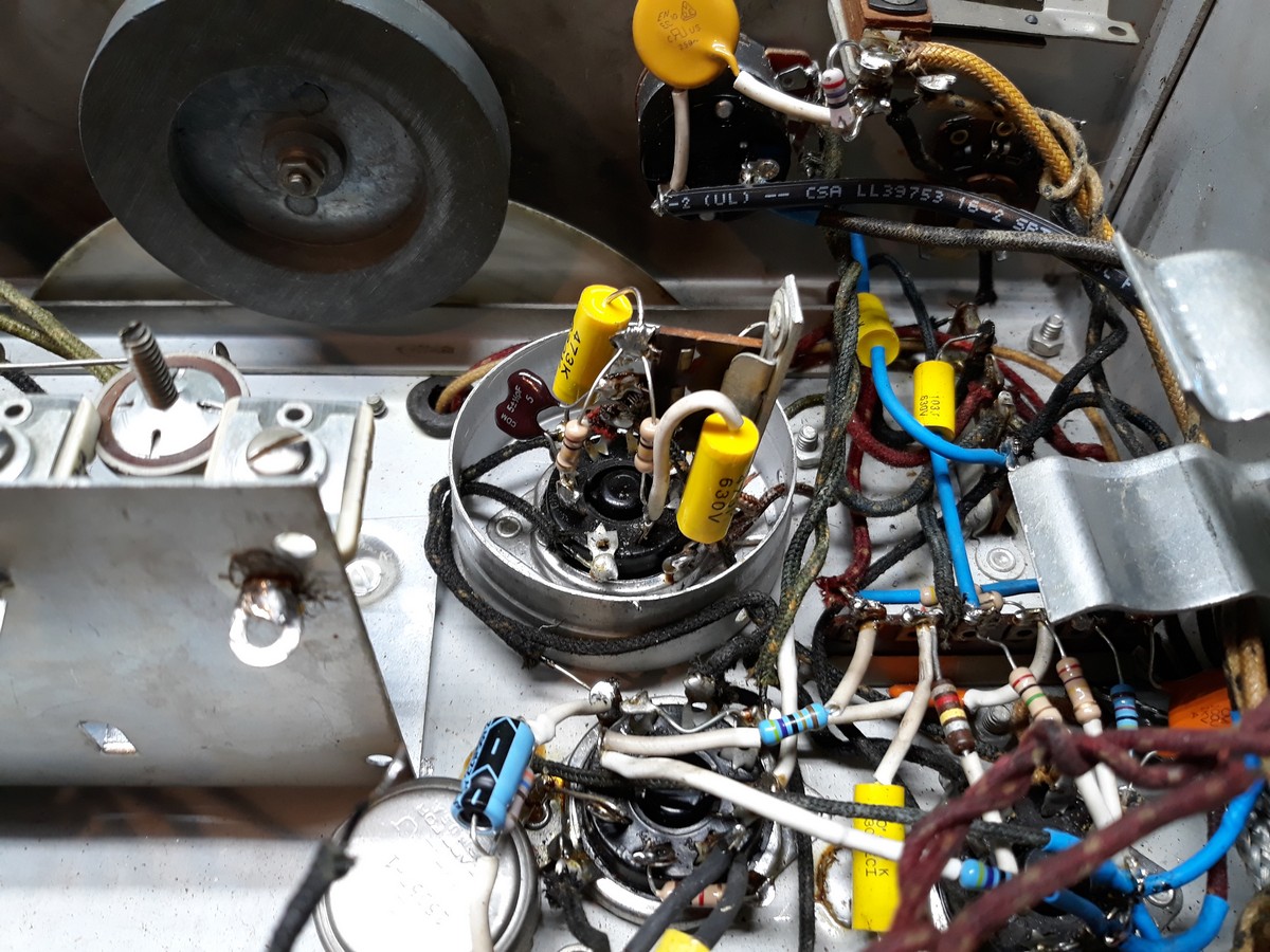

So it seemed that I had replaced all of the set's paper capacitors which had been missed by a previous owner.
Or had I?

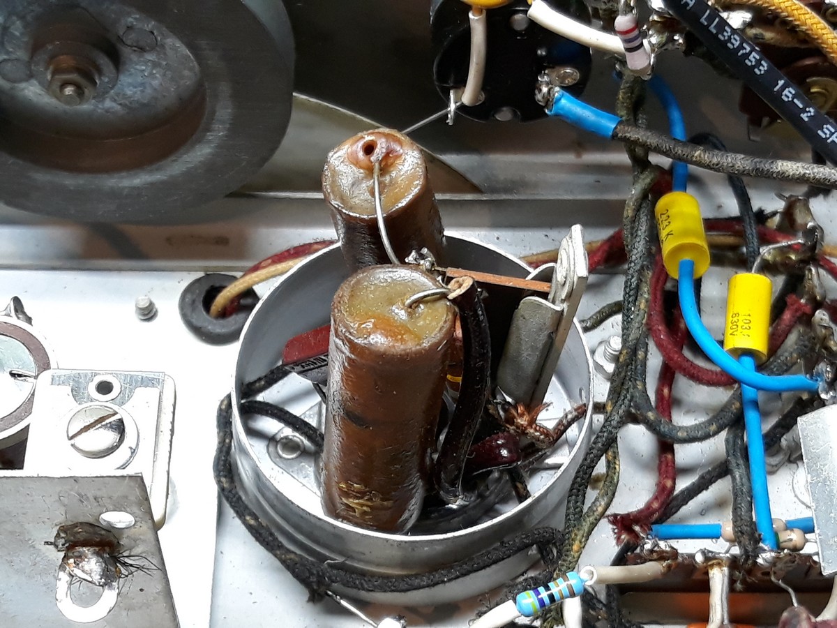

Hmmm...what could be inside this round can under the 6SJ7 tube?

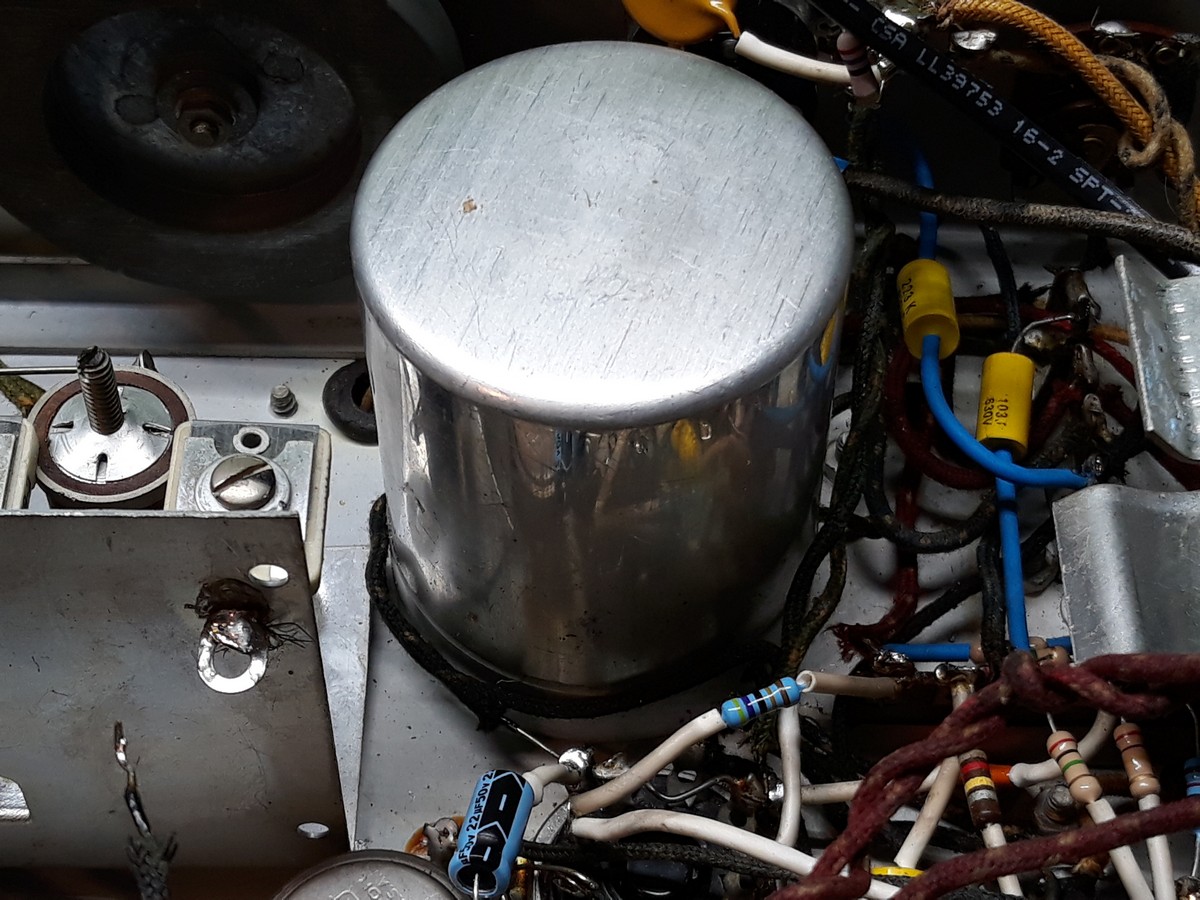

Let's see if we can remove the round shield. Yes, it pulls right off with very little effort:
Surprise! Two more old .05 uF paper capacitors and a few other components.
It turned out to be easier than I thought it would be to replace these.

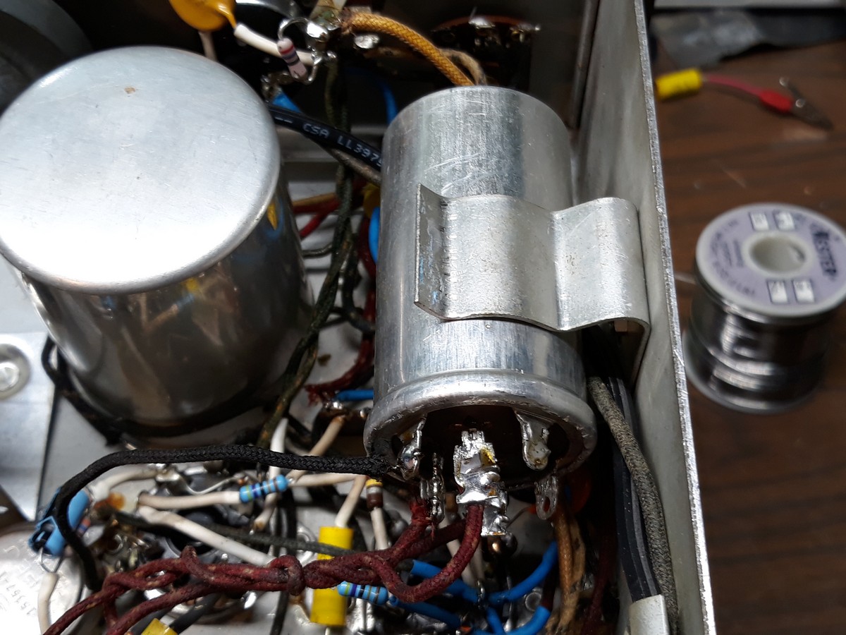

Now, having replaced the power cord and reattached the round shield under the 6SJ7 to cover those new components, let's hook up that restuffed twist-lock electrolytic can.
Looks MUCH better than that jury-rigged set of electrolytics...

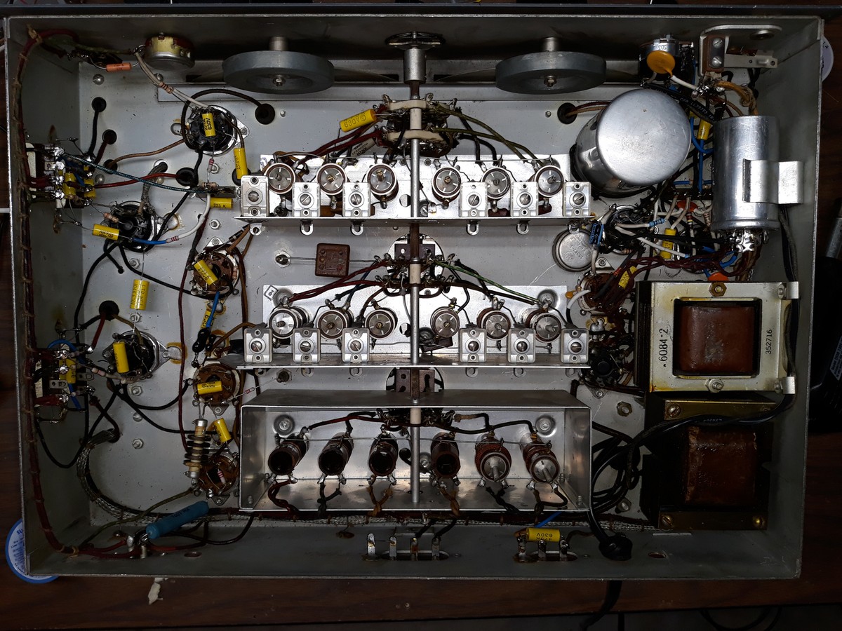

Some of the Super Pro sets have foil bypass caps inside the IF transformers.
All done under the chassis.

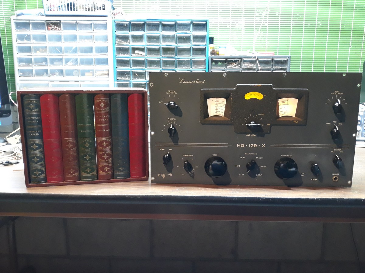

Oh, by the way. What looks like a box of books to the left of the radio is actually a speaker! Debbie has had this box for a while - I think she bought it at Kutztown a year or two ago - and gave it to me. I removed its 8 ohm 6x9 speaker and temporarily installed my little 4 ohm 3x5 speaker using only one of the mounting studs. Parts Express sells a replacement 4 ohm 6x9 speaker for $8.95 plus shipping and I plan to get one to put into this speaker box.
Who needs a $50-75 or more Hammarlund speaker when this will work just as well?
