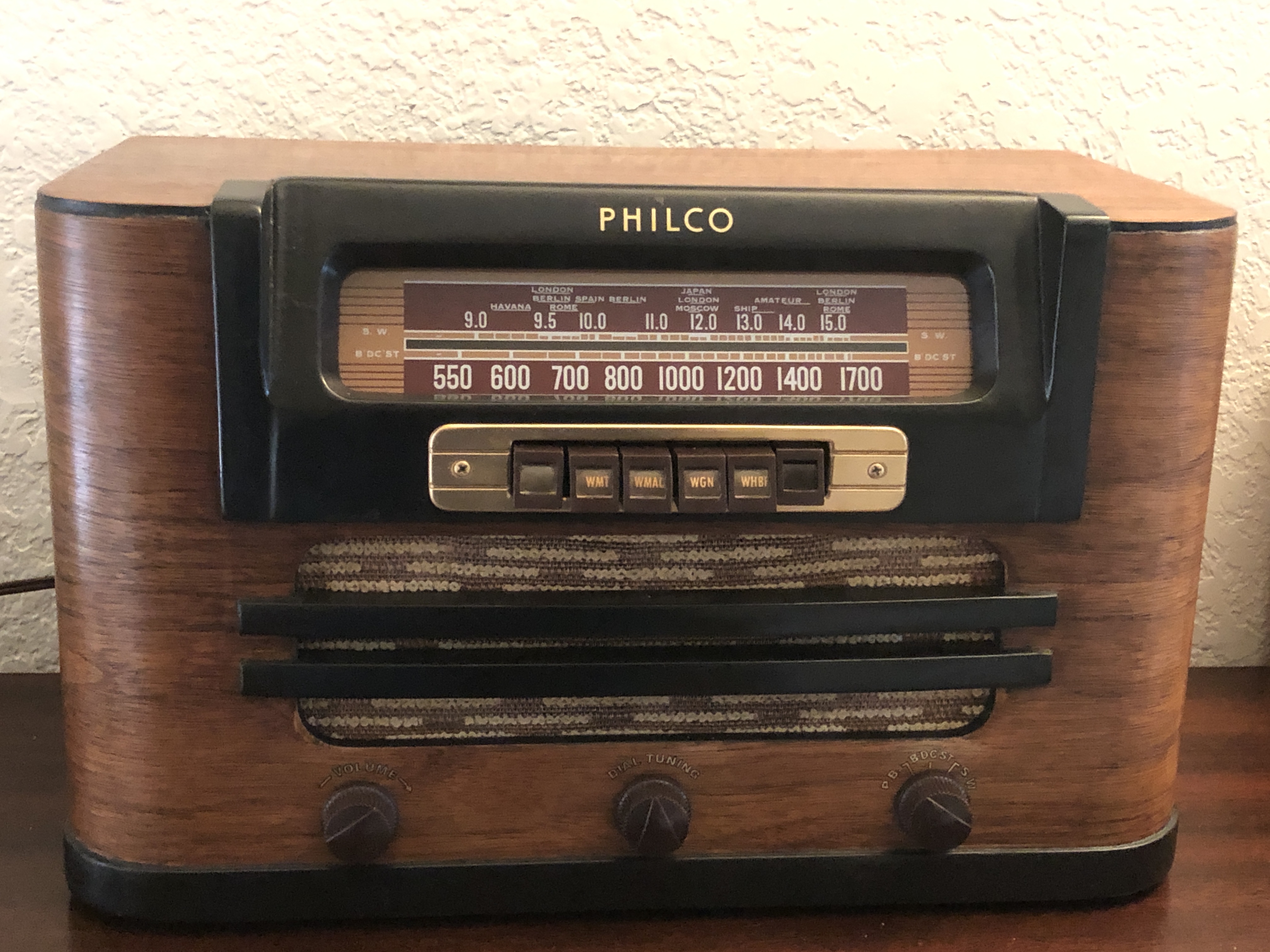

Hi,
I finally re assembled the case everything is still working.... but the SW band due to the Oscillator coil. I learned that after the recap I must check all the coils continuity before other troubleshootings.
Thank you so much again for all the great suggestions.
 In attach some picture.
Camillo
It displays very nicely, excellent job!
