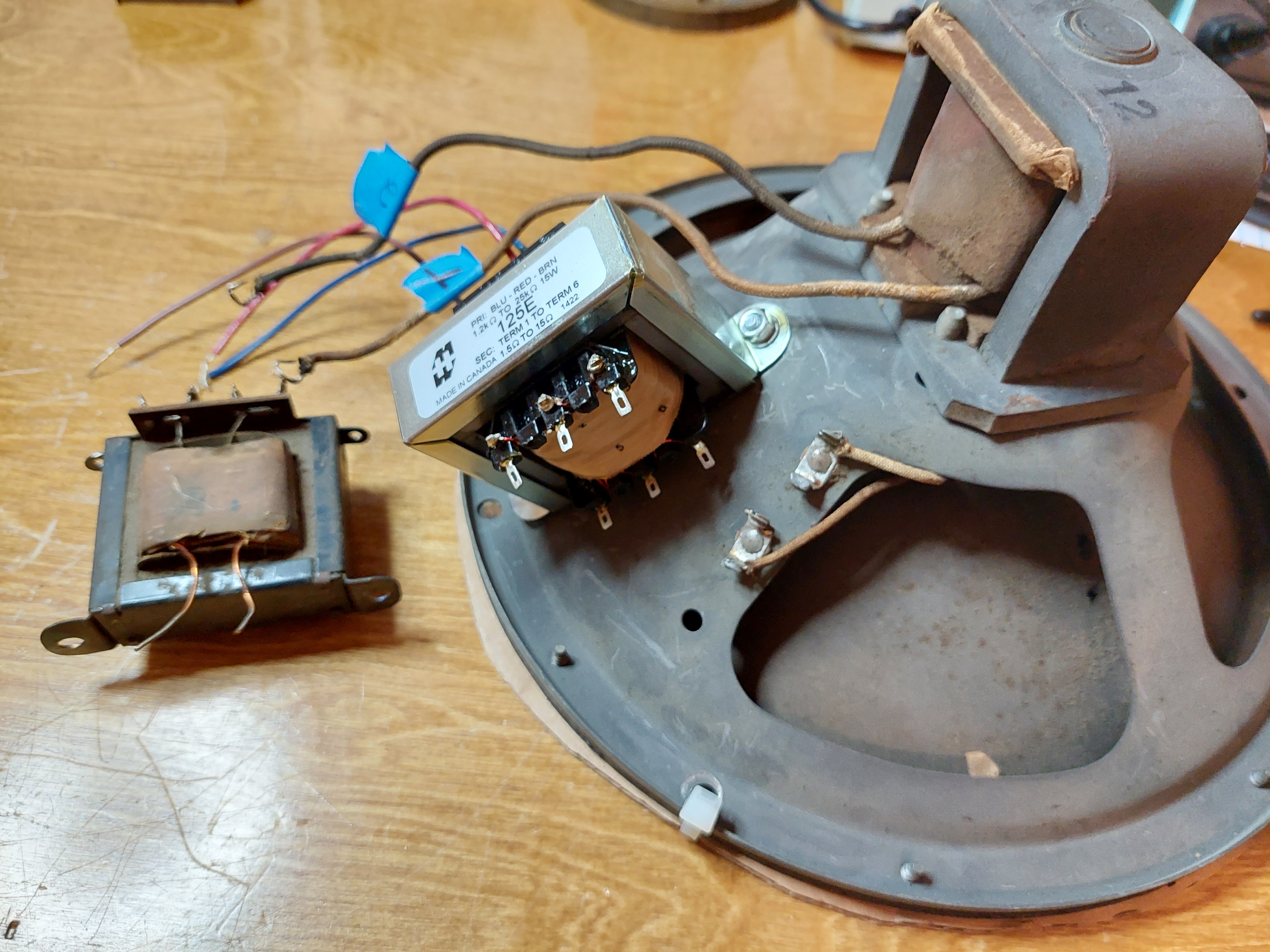

Finally got the 125E and mounted to speaker frame. I thought I had it figured out on how to hook up, but now I just don't know, do not want to burn up or short anything. Sure could use some help.
Thanks,
George
Voice coil connects to 3 and 4 on the transformer. Blue and Brown wires connect to pin 2 of the 42 tubes, one per tube. Red wire connects to one of the field coil wires. That in turn goes to the + side of the 2nd filter capacitor. The other end of the field coil goes over to the B+ side of the drive transformer or terminal 1 of #46 volt divider resistor.

Hooked up the trans like you said, turned it on and got some background type noise out of the speaker that changed in loudness with the vol control. Noise is not a hum or anything like that, more like in between stations. Did not get any reception, so need to look into that. Will try some more checks.
