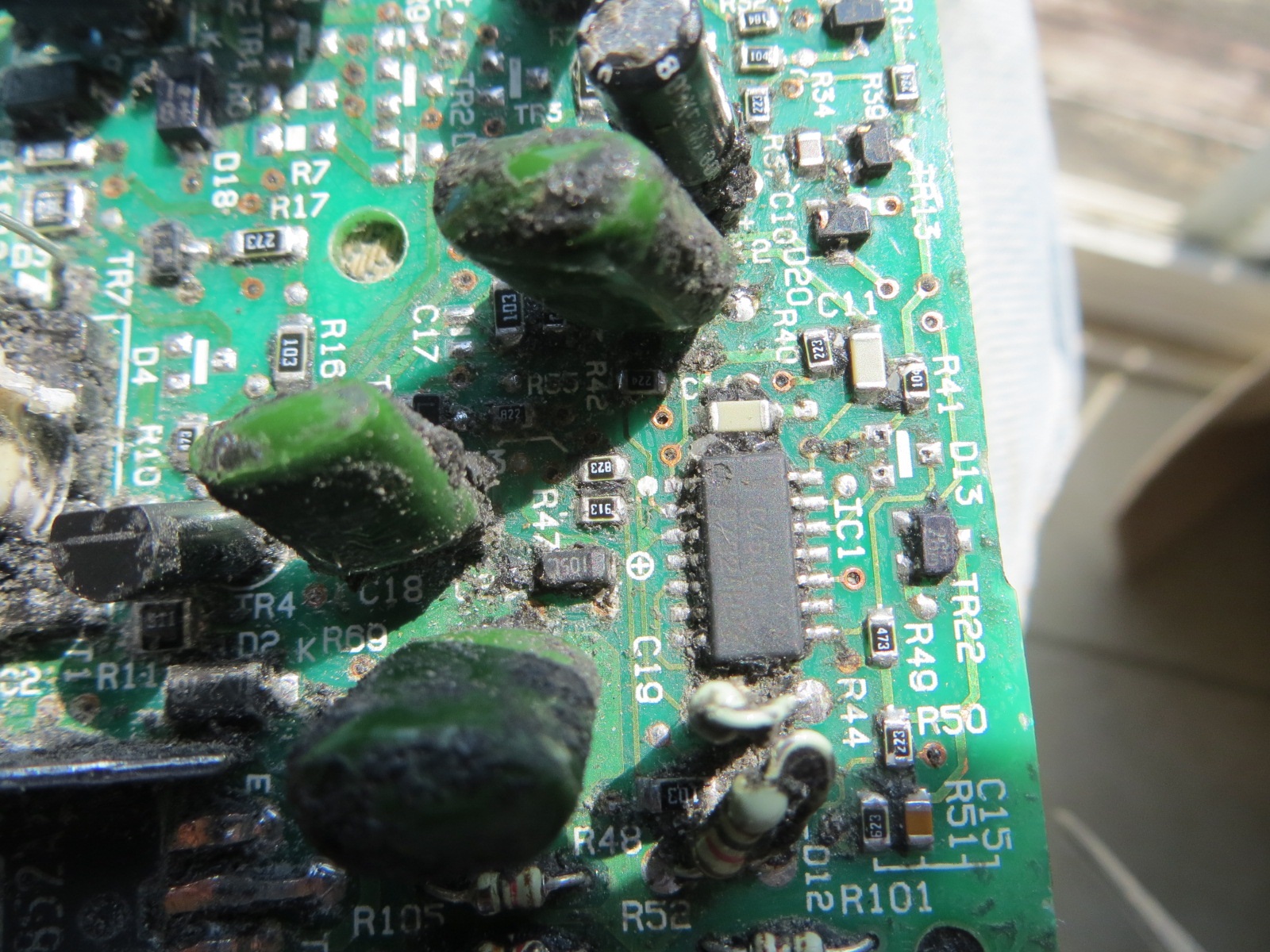

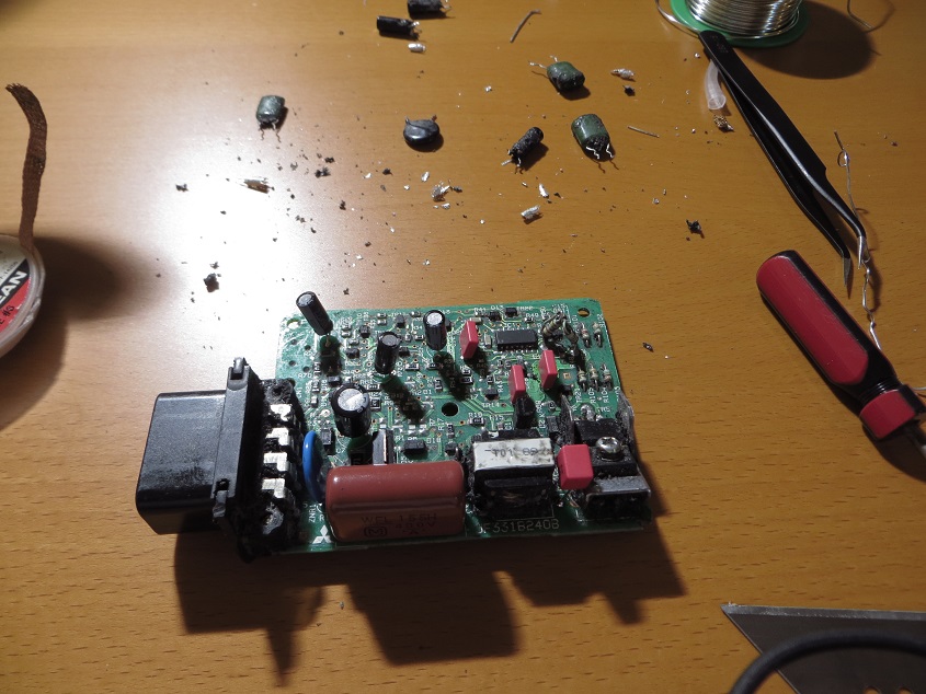

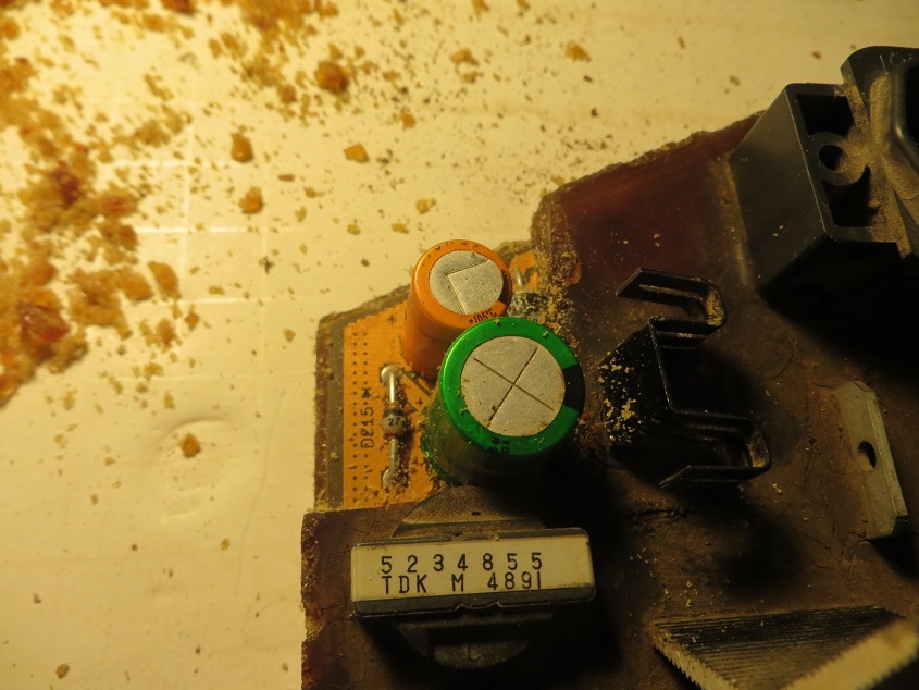

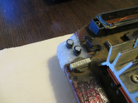

I'm used to digging out resin and silicone to get to components.  Repaired the CDI on my neighbor's KVF 400 4 wheeler, and the PCM on my 92 Dodge Dakota.  The Bakelite tar was rather easy. Would have been worse if I had to save the capacitors.

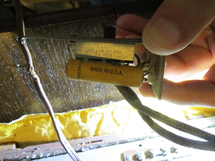

The RCA jack and switch connection in the schematic did surprise me. Here's some number on it.

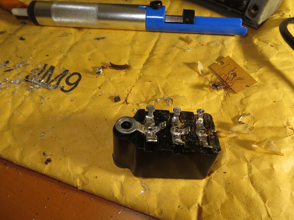

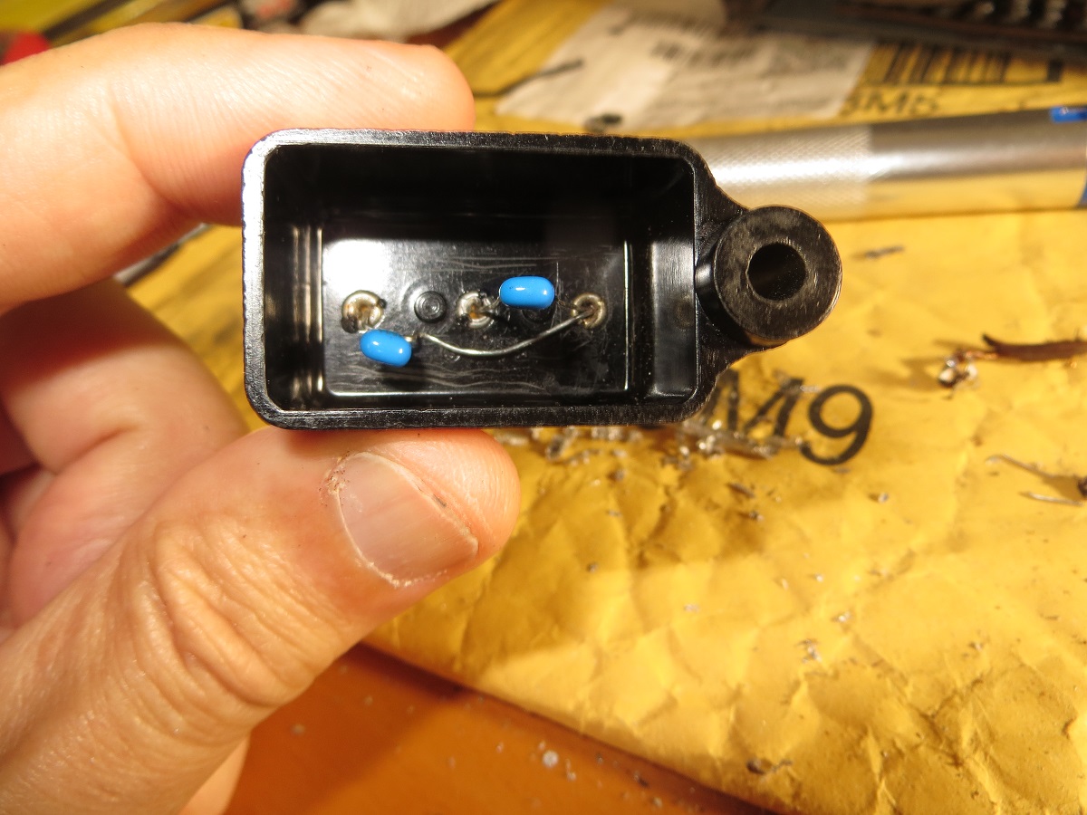

Little more work on the Bakelite.  Got the old wires off with my solder sucker. Put 2 ceramic caps in, I could have better thought the routing but hey..  Will solder them in, and do the outer wire terminals about the same time. The caps should stay in place, just will have to check that the solder doesn't drip out when I do the outer stuff.
Debating whether to silicone (888) the caps in. Not like a car with moisture outside.
Don't use silicone. Some of them secrete acids as they dry and can rot things.
Right - under no circumstances should you ever use silicone in an electronic device.
A fellow I know showed me a box once that had been filled with electronics, then potted with silicone. The silicone had eaten away all the wiring. Not pretty.
Hot glue is a much safer solution. If the components can withstand the heat for a short period as the glue cools down, it will not affect the wiring at all.
As a matter of course, I pot every AC line bypass bakelite block I rebuild, to ensure the wires do not short together. I also dress the leads in such a manner that they are as far apart from one another as possible, and are also placed away from the terminal holes (unless the particular lead goes through a particular hole).
I knew about not using regular silicone since it has acid in it. I've been using this stuff which is supposed to be okay. The right number was 388, not 888.
I still wouldn't use it -
but it's your radio, do what you wish.

When I do those bakelite blocks I just add the new capacitor and don't worry about filling in the bakelite shell there no need to.

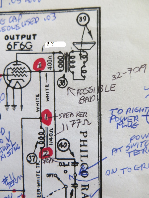

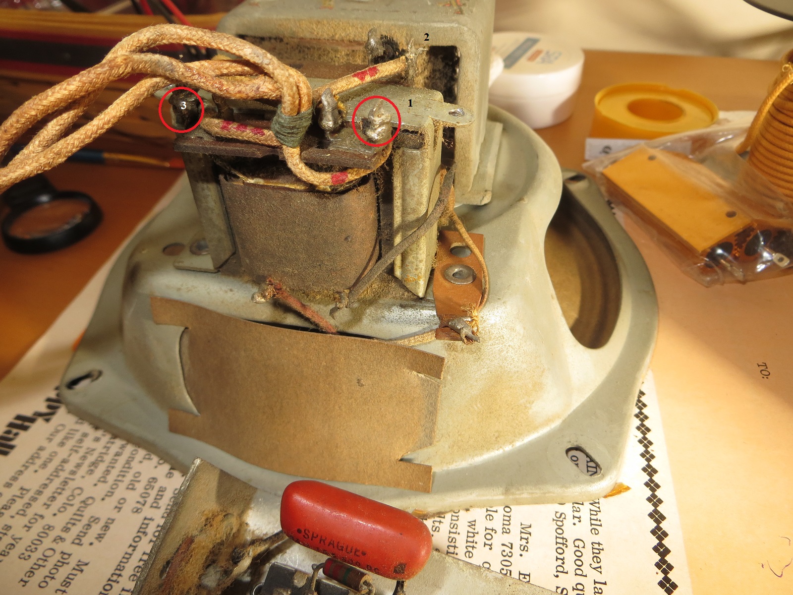

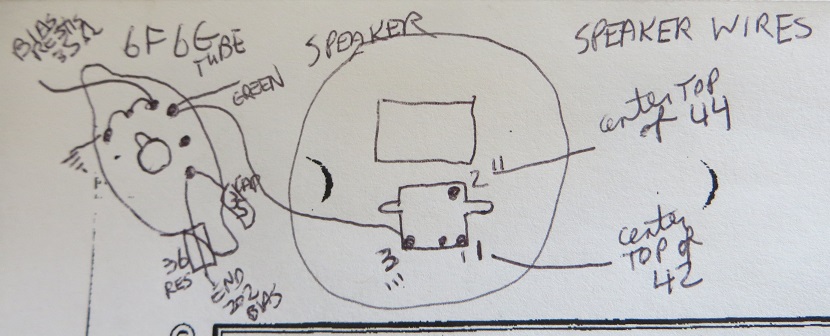

BUT, got another question. Since I was in the area of the 6F6G tube messing with the block, I noticed the speaker wires were in the way. They are very brittle and have broken outside the cabinet.  I got off on a tangent and started checking the resistance values of the speaker.
The 400 ohm part 38 output transformer looks open.  I measure between 1 & 3 (my markings) and get nothing.  Am I measuring in the right place?
Between 1 & 2 I get 1177 ohms which looks correct for part 37.
Bryan
Hello Bryan,
you should get 400 ohmsa between that red circled one 3 !

Further, be aware that the schematic indicates the speaker has a hum buck coil, do not separate the connection of that coil to the voice coil. Do not exchange the field coil wires. You "may" have to swap the series combination of the hum buck and the voice coil if there is residual hum. That is the only place to make that exchange.
