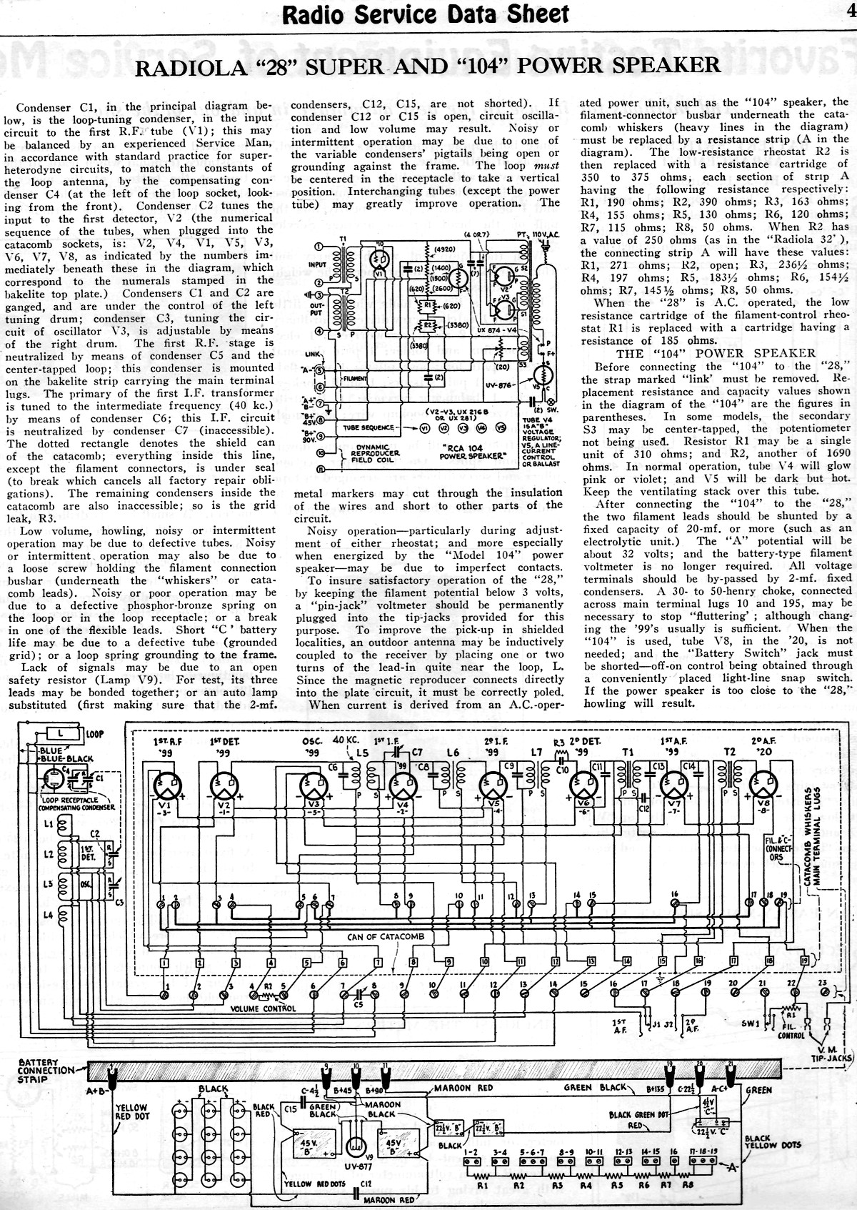

This is a Radiola 28 schematic re-drawn by Gernsback.
It has info on the DC and the AC, but no internal component values. Can clearly see the jumper strip and the resistor strip connections. The values of the resistor strip are in the text.

Look carefully at the RCA schematic that has the jumper strip. Then reference the terminals in the continuity chart, follow the circuit through the jumper strip schematic to the whisker numbers. I showed the whisker numbers in one of the images.
Since you do not have a jumper strip, the chart is not valid for a check list with a resistor strip...
As said in an earlier post, an ARBE will NOT support series filament operation (resistor strip) of the Radiola 28. The filament voltage is 34 volts at 60 ma. when in series.
The resistor strip purpose is to connect all the tube filaments in series AND provide bias, as the 104 supply does not provide the bias.
With the jumper strip the filaments are wired in parallel and connection brought out to provide bias via battery via the whiskers to the terminal strip...
With the resistor strip removed, referencing the terminals follow through to the whisker number, then complete the continuity test.

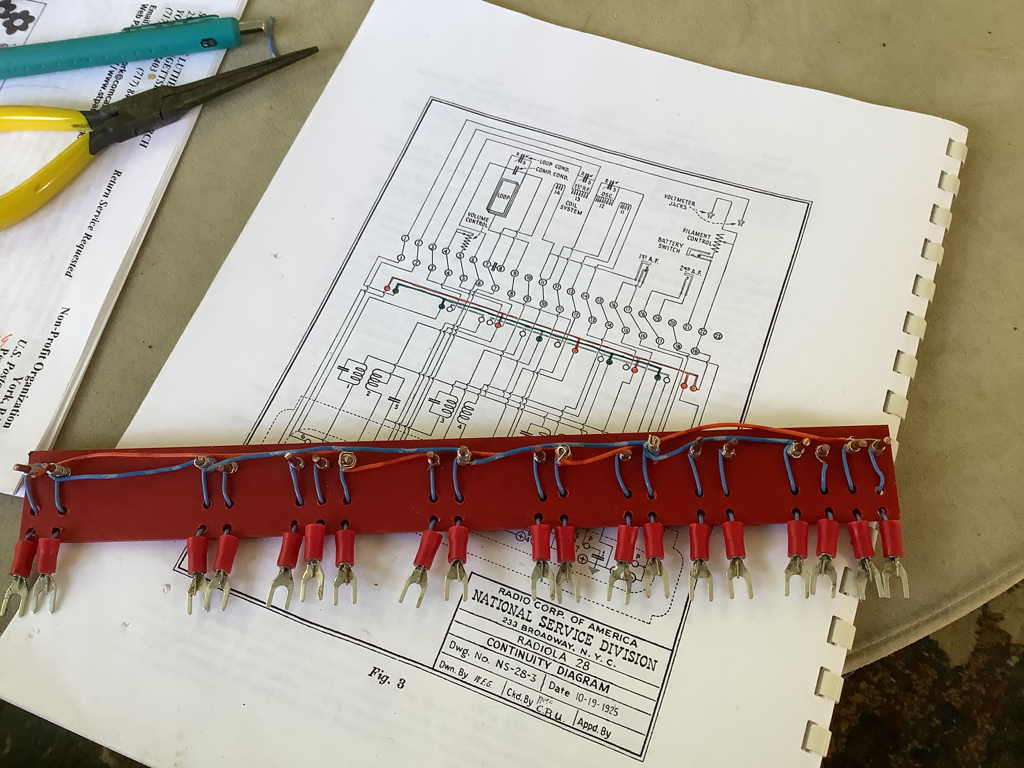

This is my attempt to replace the wire resistor strip. It’s not finished yet but the main idea is there. If this works I plan to move on to replacing the open transformer.
Nice, I had considered forked lugs. What would plague me is the potential for shorts...

I took a second look at the "DC" jumper strip ,NO nothing changes in making the one you made, KUDOS.
It has occurred to me that the entire strip could be a PC board fabrication, double sided so circuits can pass with through hole jumpers to combine multiple connections. Holes through the board with contact rings for the screws. There is ample clearance to make the strip wider to account for filament current flow... Since the strip is unseen in normal installation, the "modernization" would not be noticeable.
I kinda wish I had thought of this sooner, like 20 years ago. As it would be inexpensive to fabricate multiples. The circuits could be sealed or not with a conformal coating. Seems all too slick, but my minds eye says it would work a treat. What a blessing for those who find 28 AC and no power supply Icon_angel

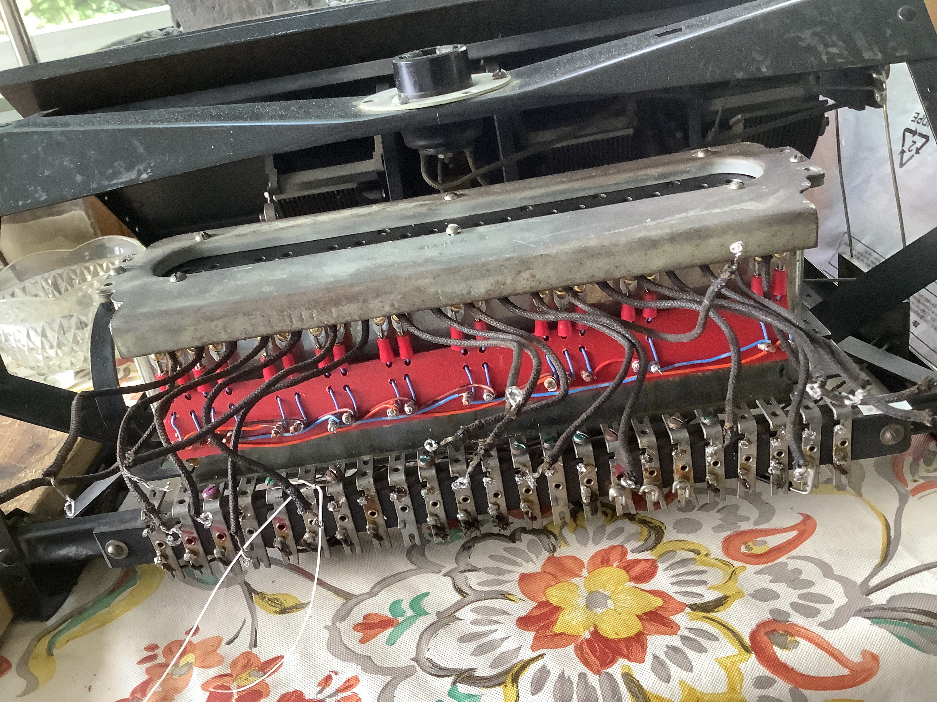

Sending a photo with the strip installed. I used #6 spade terminals and they are narrow enough to keep from shorting.
The transformerectomy and subsequent installation wasn’t bad.The most delicate part was getting the cloth insulation off the transformer leads. I ended up touching the wire with the soldering iron and then carefully cleaning the bare wire. If the bolts attaching the transformers to the frame are stuck just touch them with a soldering iron for a few seconds.
Your idea for a PC is a good one. That would be a nice time saver.
BTW what did you get for a grid leak resistance, 8 to 8.2 megs is fine, much higher say 10 megs and volume may be too low...Or the detector will cut off and the radio will go Putt-putt sound.
#6 O.K. but the screws were #4, so long as there are no shorts...
That's a great technique, a little heat and the rosin gives way...
