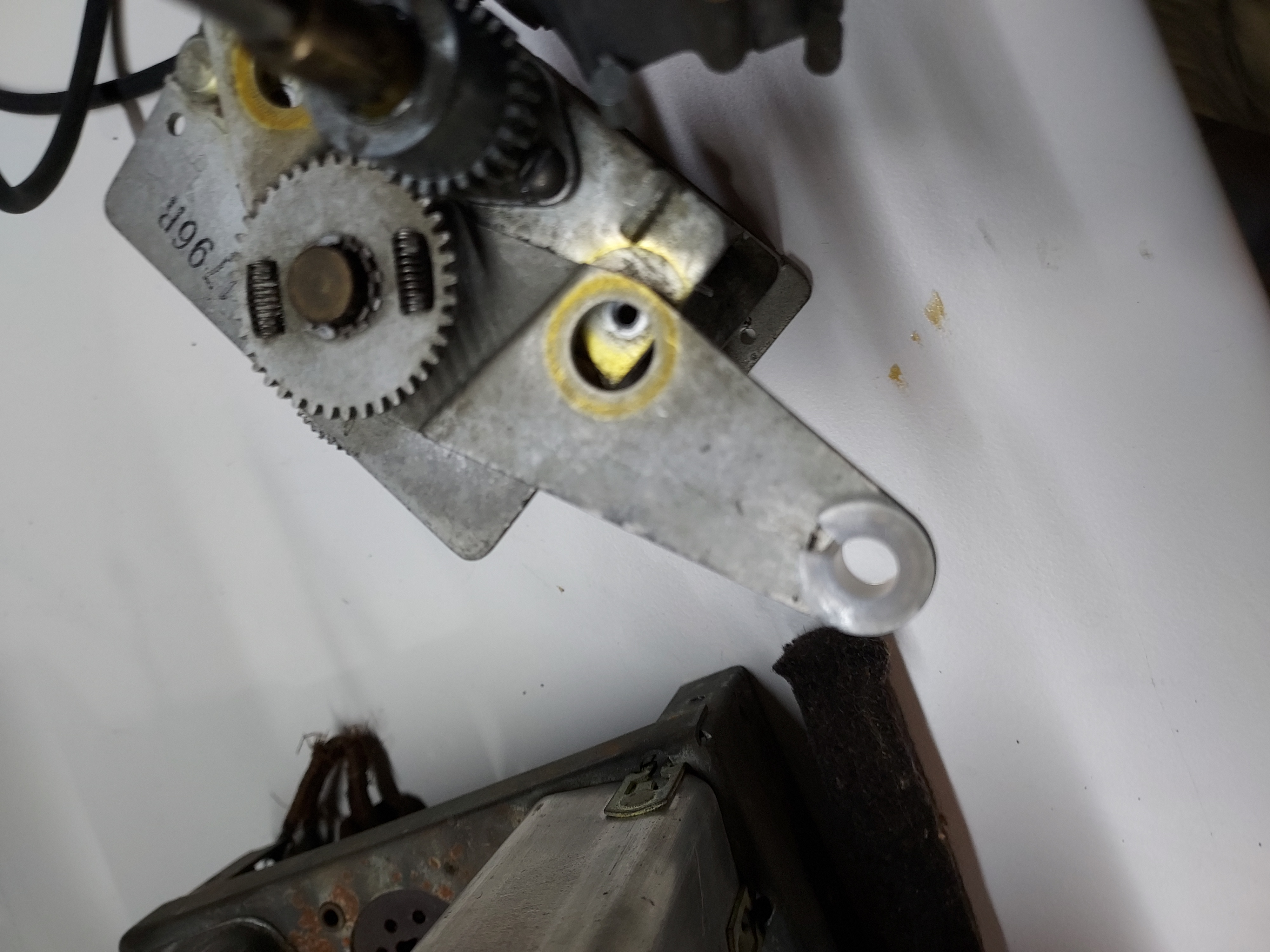

Tonight I took apart the tuning cap gear, which worked fine, but I figured it would be all gunky inside, which it was.
It took me 5 minutes to remember how to get the gear back together, after I had cleaned and re-lubricated .
the whole thing.

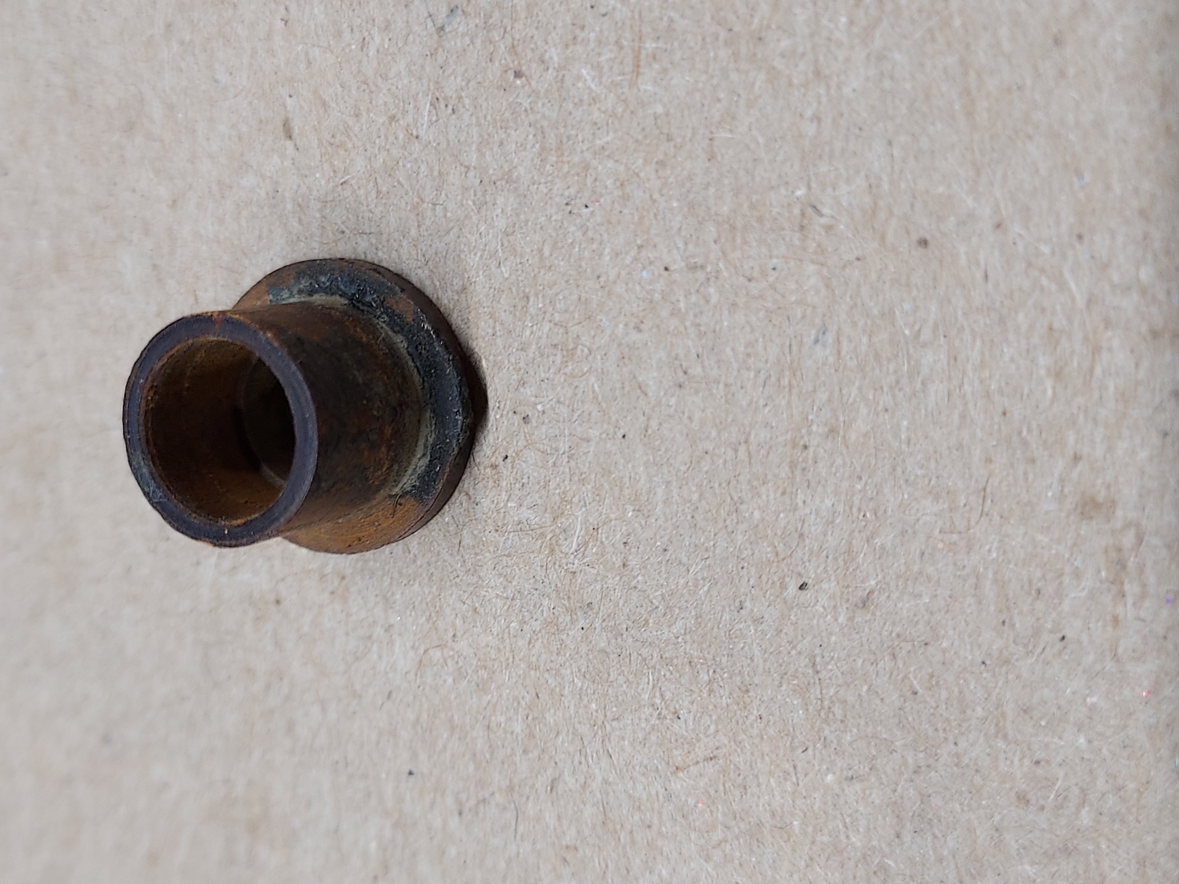

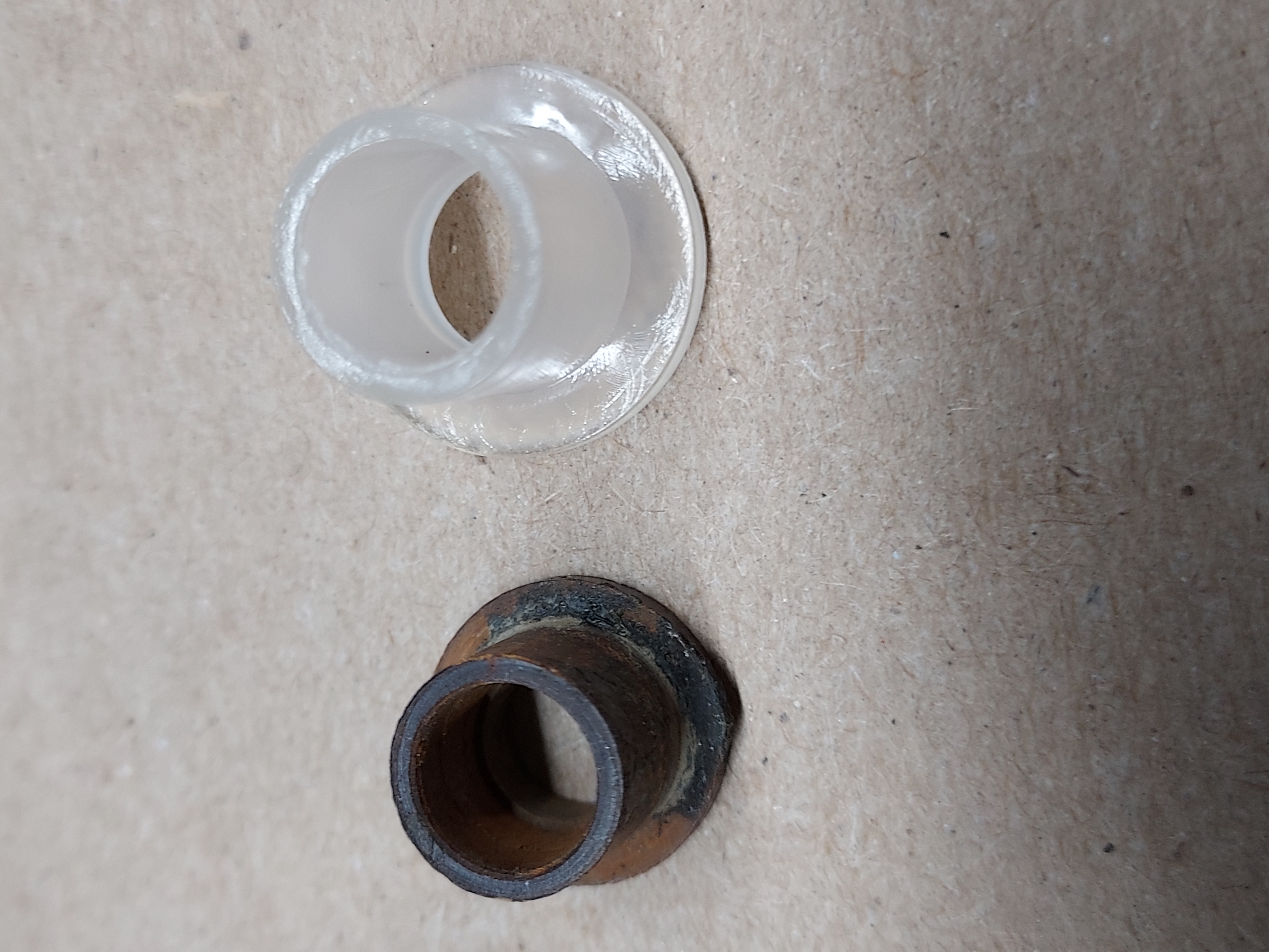

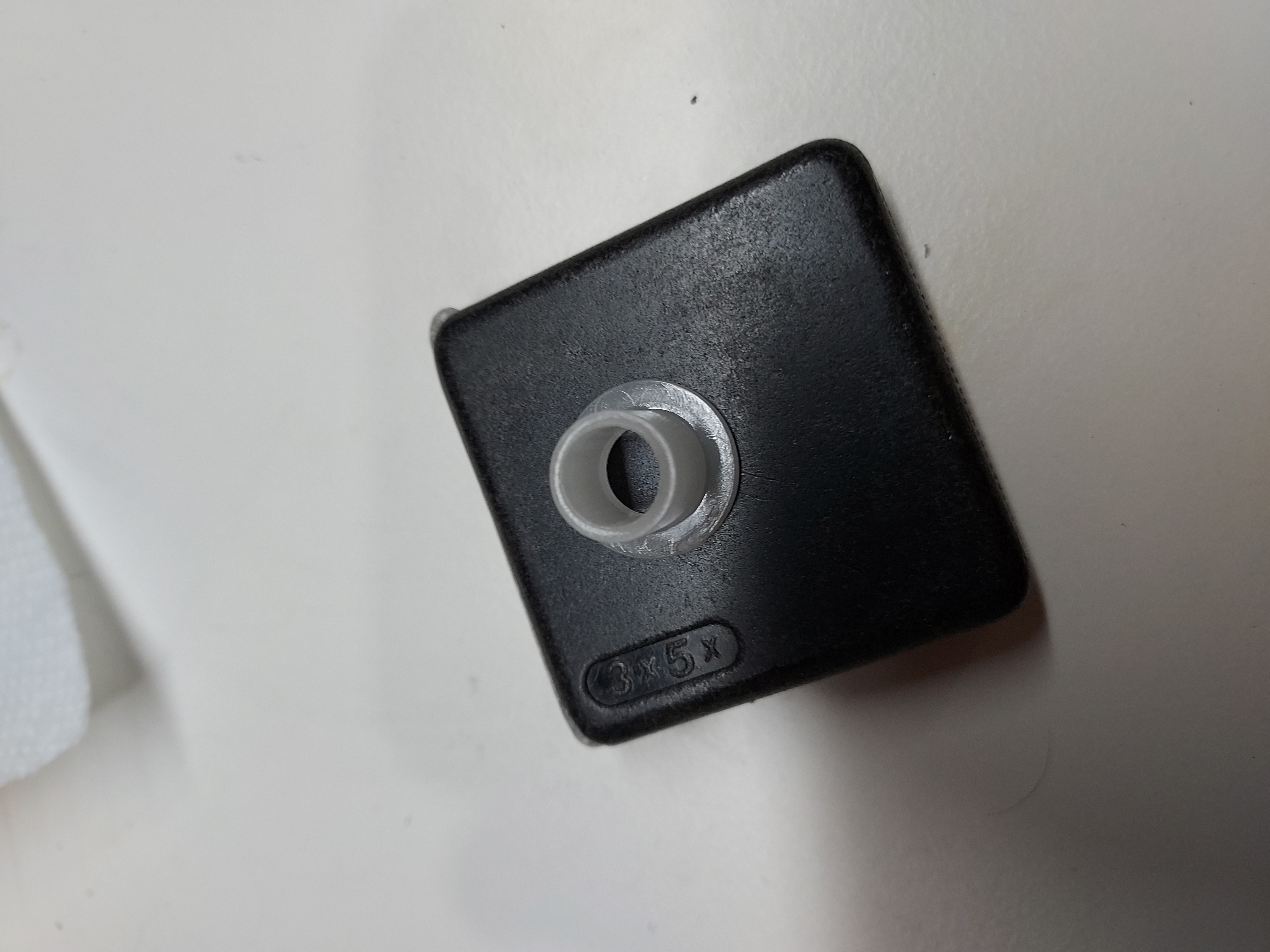

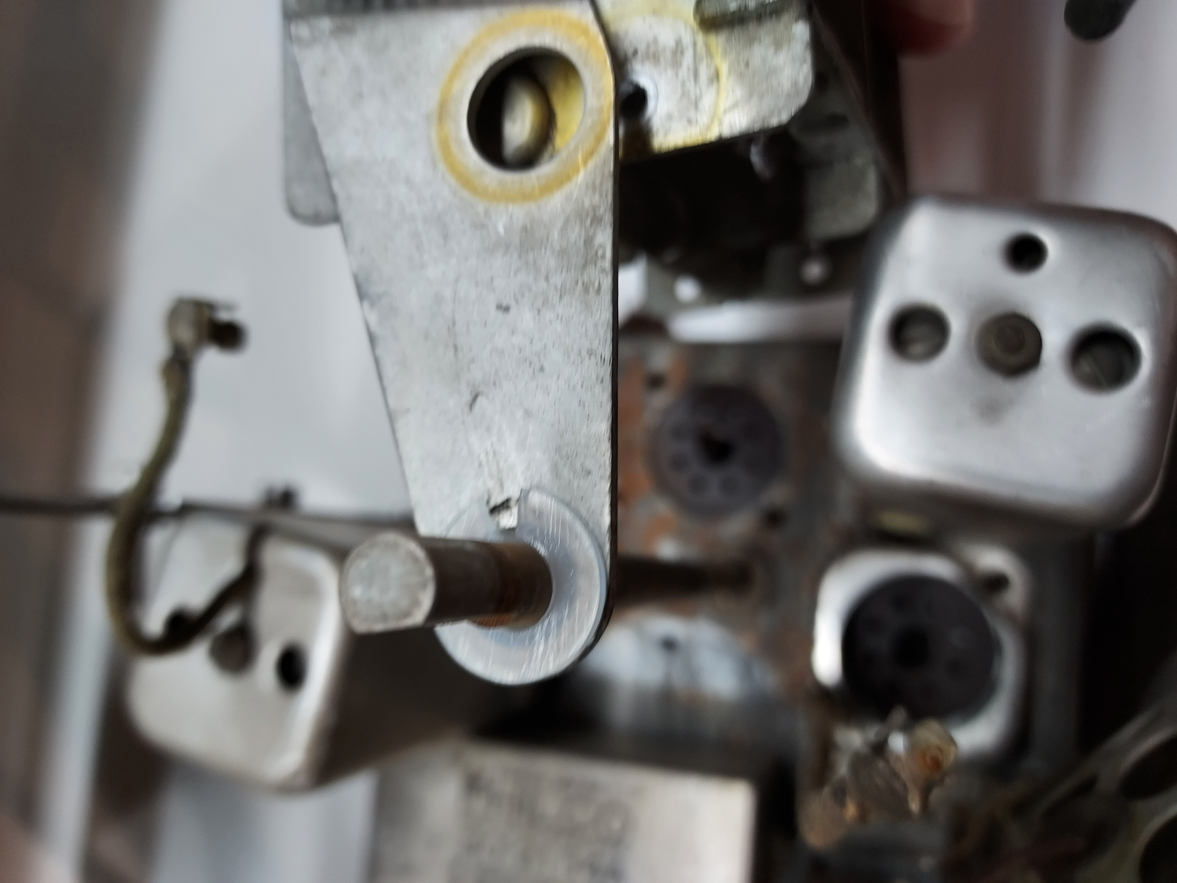

OK, coming back to my workaround for the shaft bushing.
So, since the 7mm bore / 9 mm OD bushing seems to not be in existence, I ordered 8mm bore / 10.6mm OD nylon bushing, which comes in qty of 10 for $5.
Now, thought I to myself, I need to diminish OD by 1.3mm (the original seems to be 9.3mm OD).
To do this I would have to cut a sector such that the outside lengthe would be 3.14 times that, which is about 4mm.

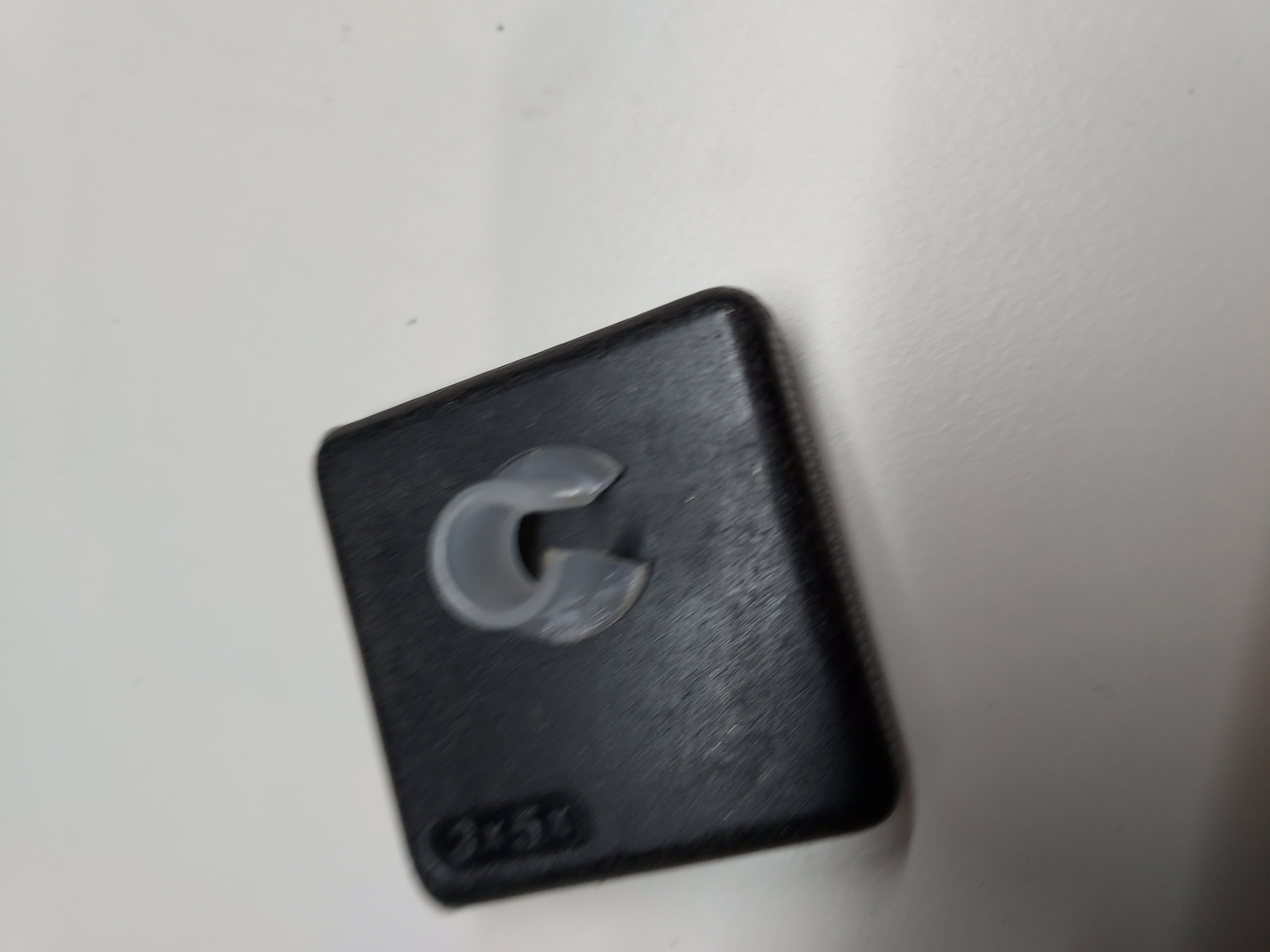

So, this is the bushing
This is the bushing with 4mm section cut out.

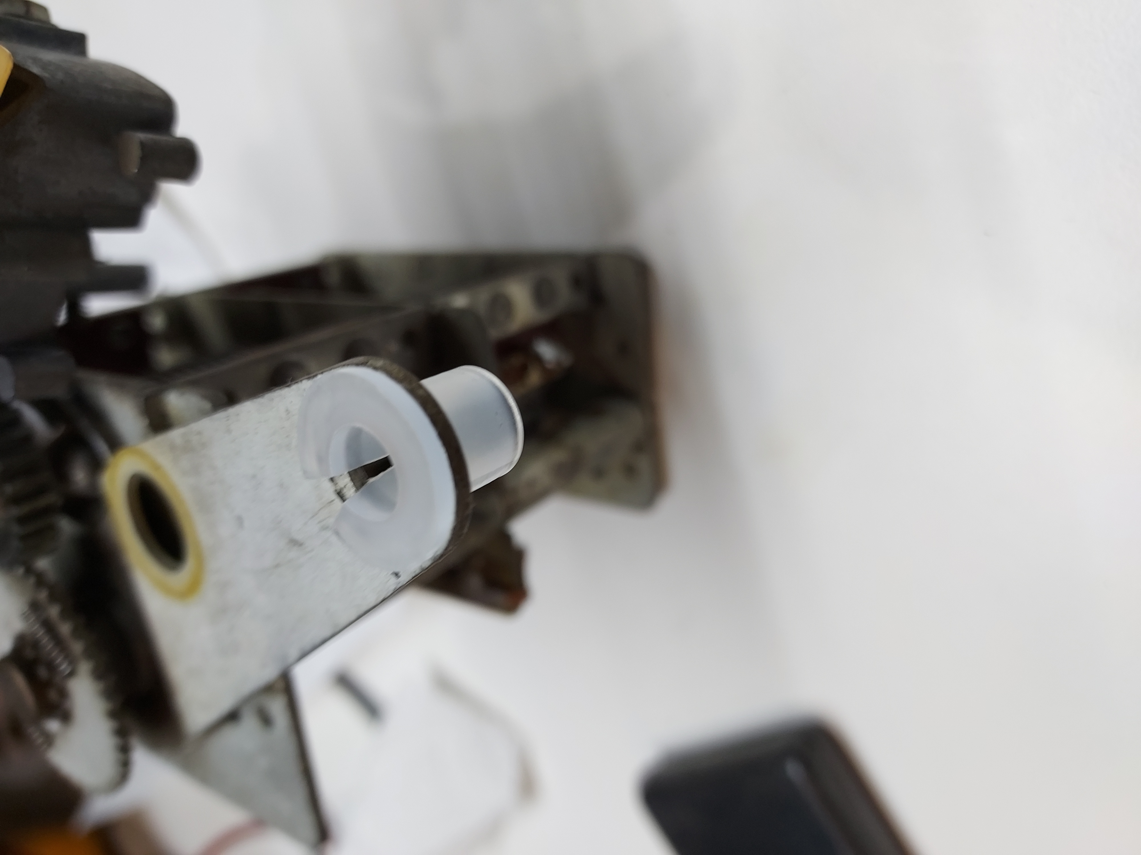

This is the bushing that now fits snug into the hole in the bracket.
An this is the shaft going through with good, not tight but properly restrained fit. Plus this nylon is more slippery than the original material.

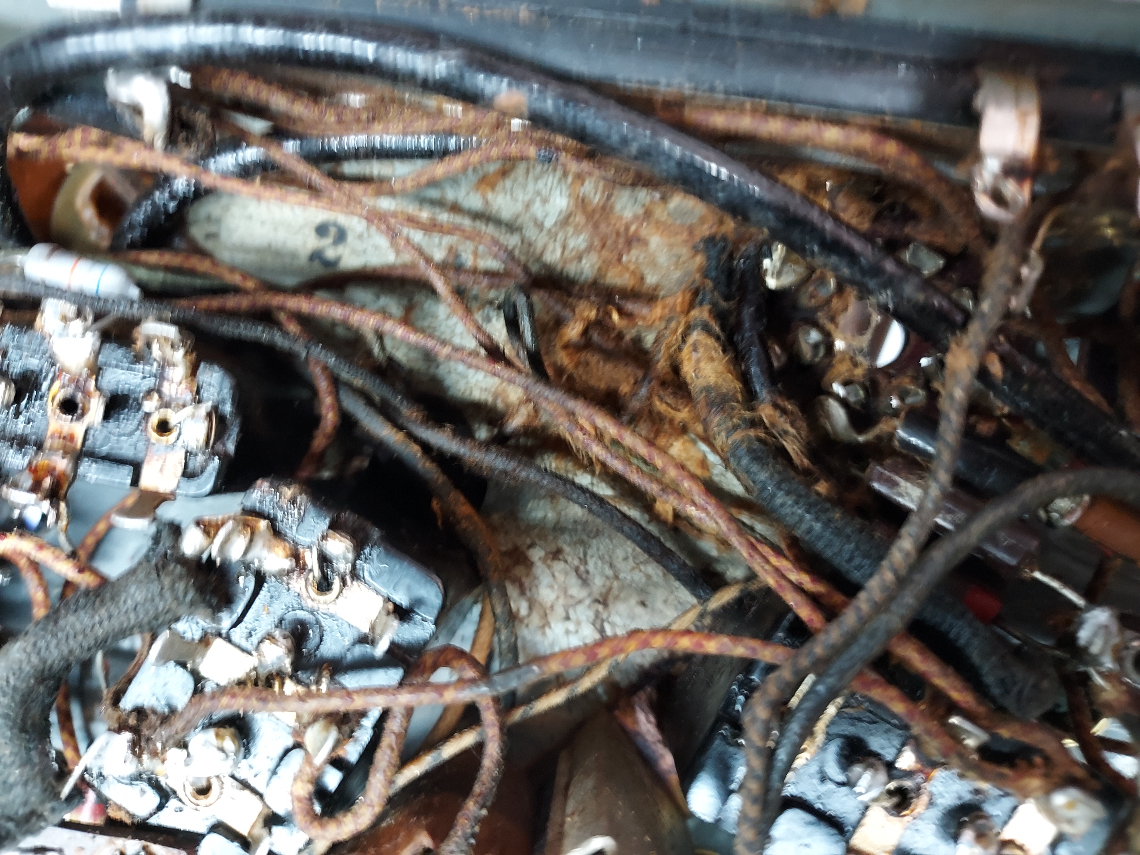

First of, I need to clean the mushed wire insulation stuck to the chassis and things in it.
THis is how it looks. I do not think this was an animal activity, as there is no droppings and such, but also this is only near the candohm, which was supposed to be hot as heck. As I said, this will be replaced by a capacitor, and it just so happend I have exactly the value, 8.2uF film Solen caps (8.3uF was the calculated one). I stocked up on thos a few years ago as this seems to be the one often needed to replace the curtain burner wire or a candohm in these 5-tubers.

That bushing you had to replace, what did it have there originally, a rubber one?
No, it is some sort of fiber epoxy something. Brown-orange. Same exact shape.
It cannot be rubber: it would impede the shaft rotation. It needs to be solid non-friction material.
I think it is vulcanized fibre.
This is why I chose nylon.
