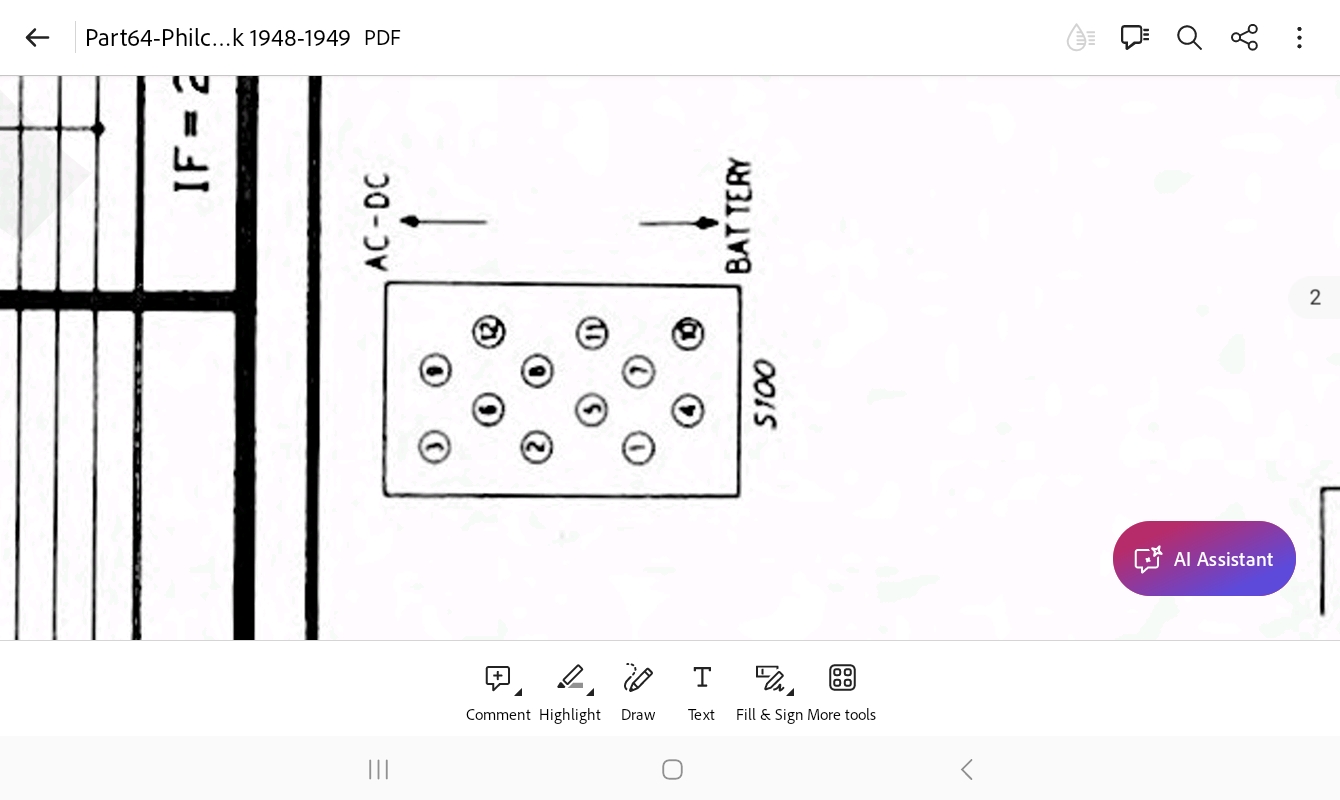

I dont know the pin number system of the ac/battery switch.
Could that be that your On/OFF positions are switched? Not sure how it is possible, as it is part of the potentiometer.
Yes you could short it, but I would try to take a good look at the pot, possibly open it (with most it is not a big deal).
Can someone tell the pin numbers on the ac/battery switch?
Does this look like it might be correct?
Rob, that does look right.
