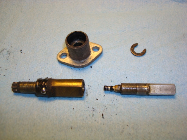

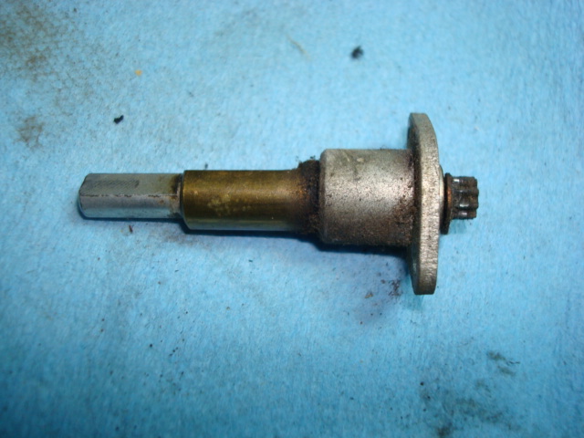

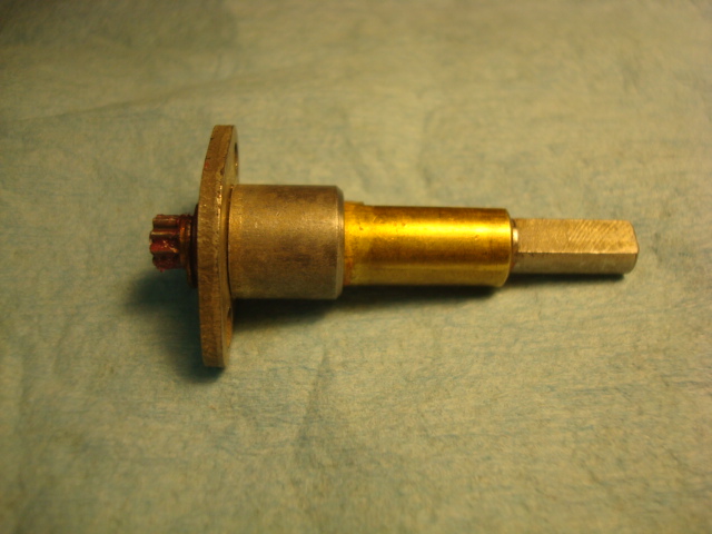

I have 2 RCA 6BT Farm sets that have a similar concentric dial setup. Funny, the condenser looks similar to the Philco. This setup may have been common to several sets, even a lowly Arvin 4 tube "Rhythm Baby" job that I have the chassis from. On that one, someone got frustrated and soldered the 2 shafts together.I think that the 3 ball bearings act as the planetary gears in this setup. In reviewing TV Man's thread, I think that there may be a clip that is supposed to hold the thing together. the following pics are from the thread from TVMan. Is it only the inner shaft pulling or both the in er and outer. If both the inner and outer, then the clip is missing. If only the inner, then there is something else wrong.
Hope this helps.

MrFixr55, those photos are the ones I have been using and the instructions on putting it back together.
I put the ball in, than the spring, than the ball. Put the shaft part ways in, than slide it into the outer tube, compress the spring and click the whole thing together.
The outer course control works perfectly, and the fine control works perfectly, slowly rotating the end gear. Turning it it's smooth than POP! It barfs the shaft out and I'm back to square one.
I am at a loss and I'm steamed
