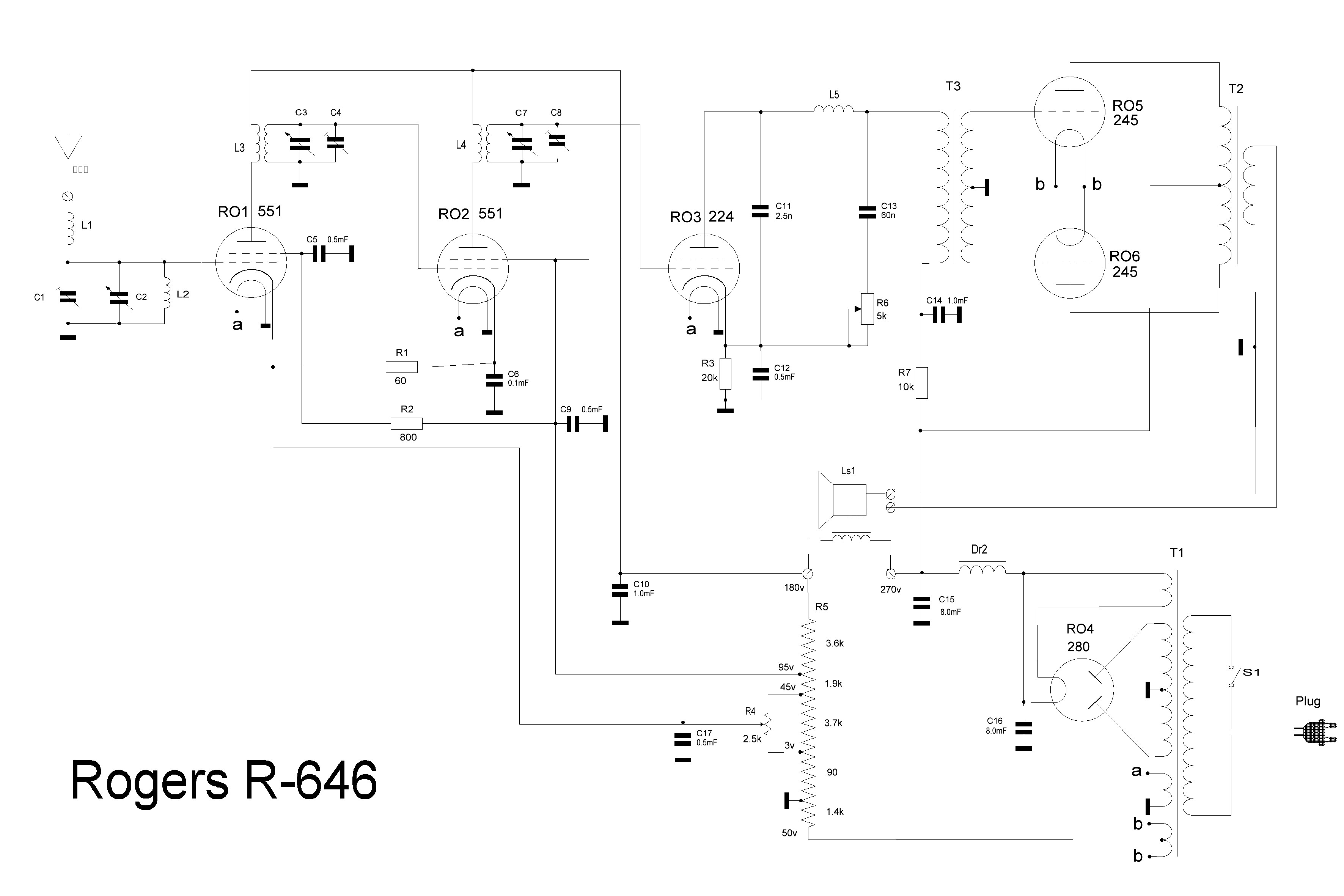

Since the original schematic was in an old unreadable style, I created a new schematic diagram.
Owners of this radio can use it.

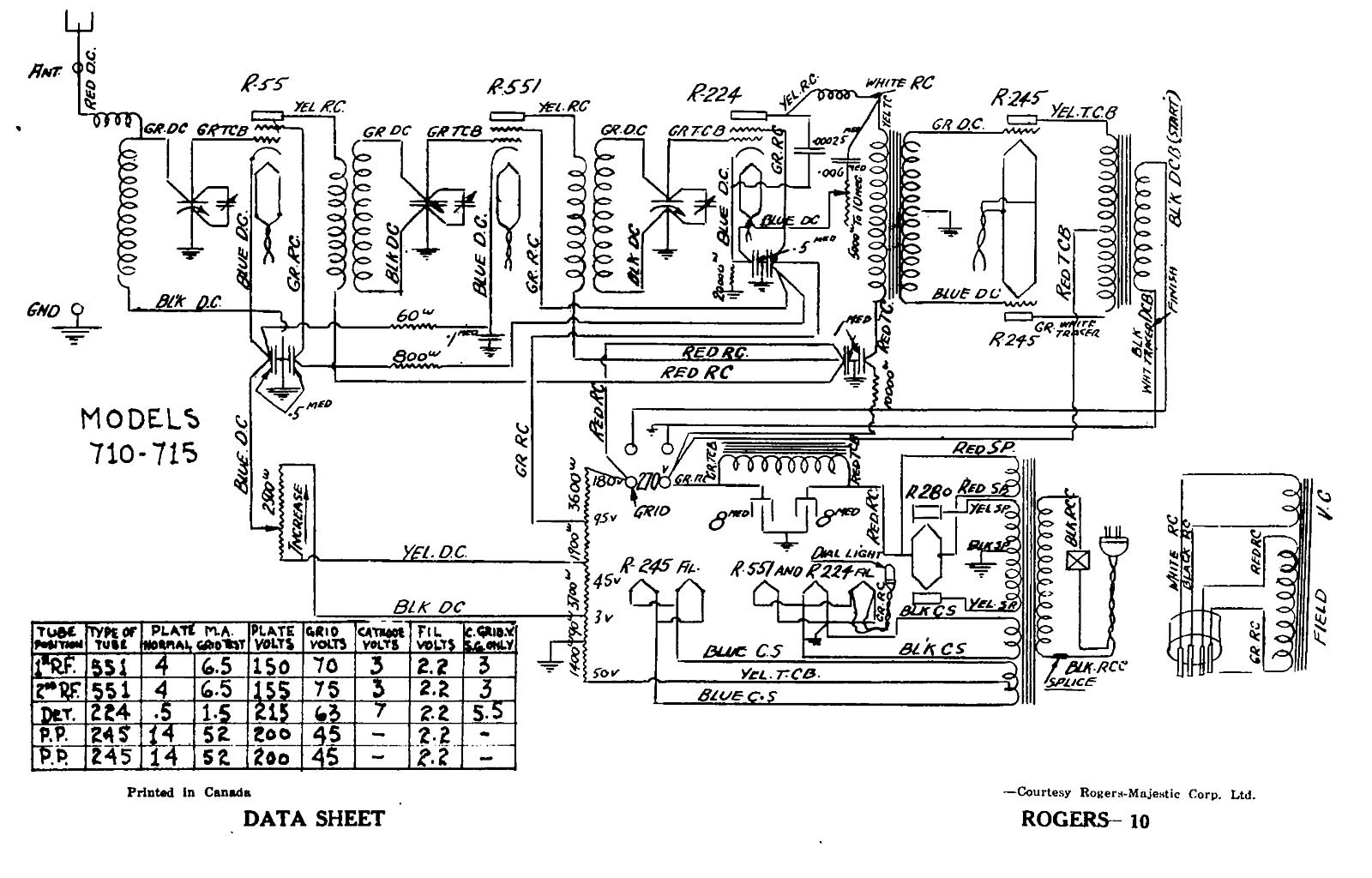

The original schematic is also attached for reference.
The diagram have been updated based on the latest data from current work with my chassis.
