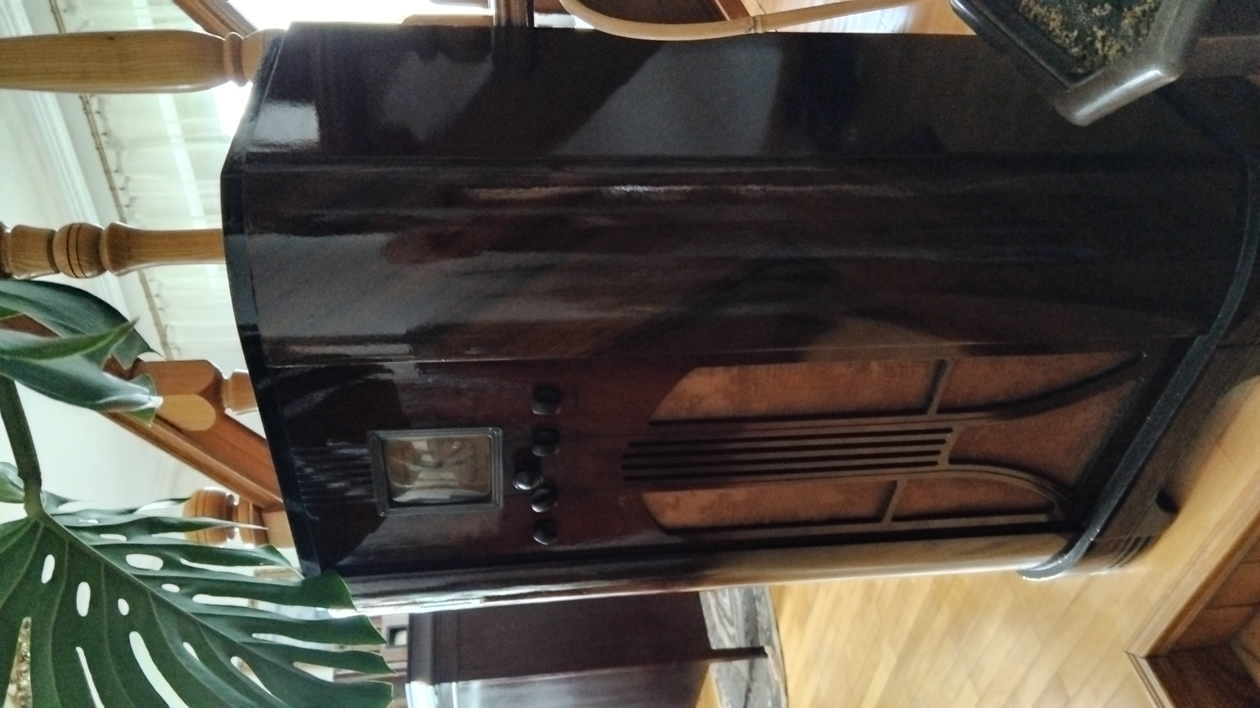

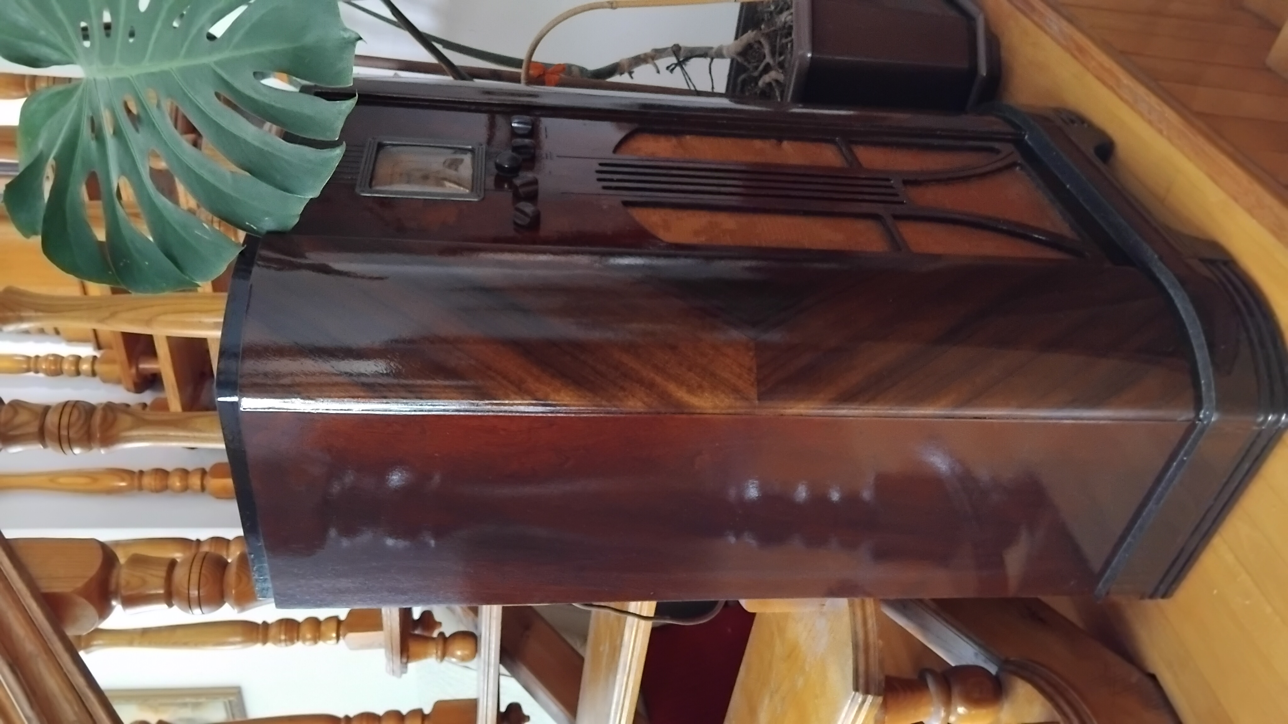

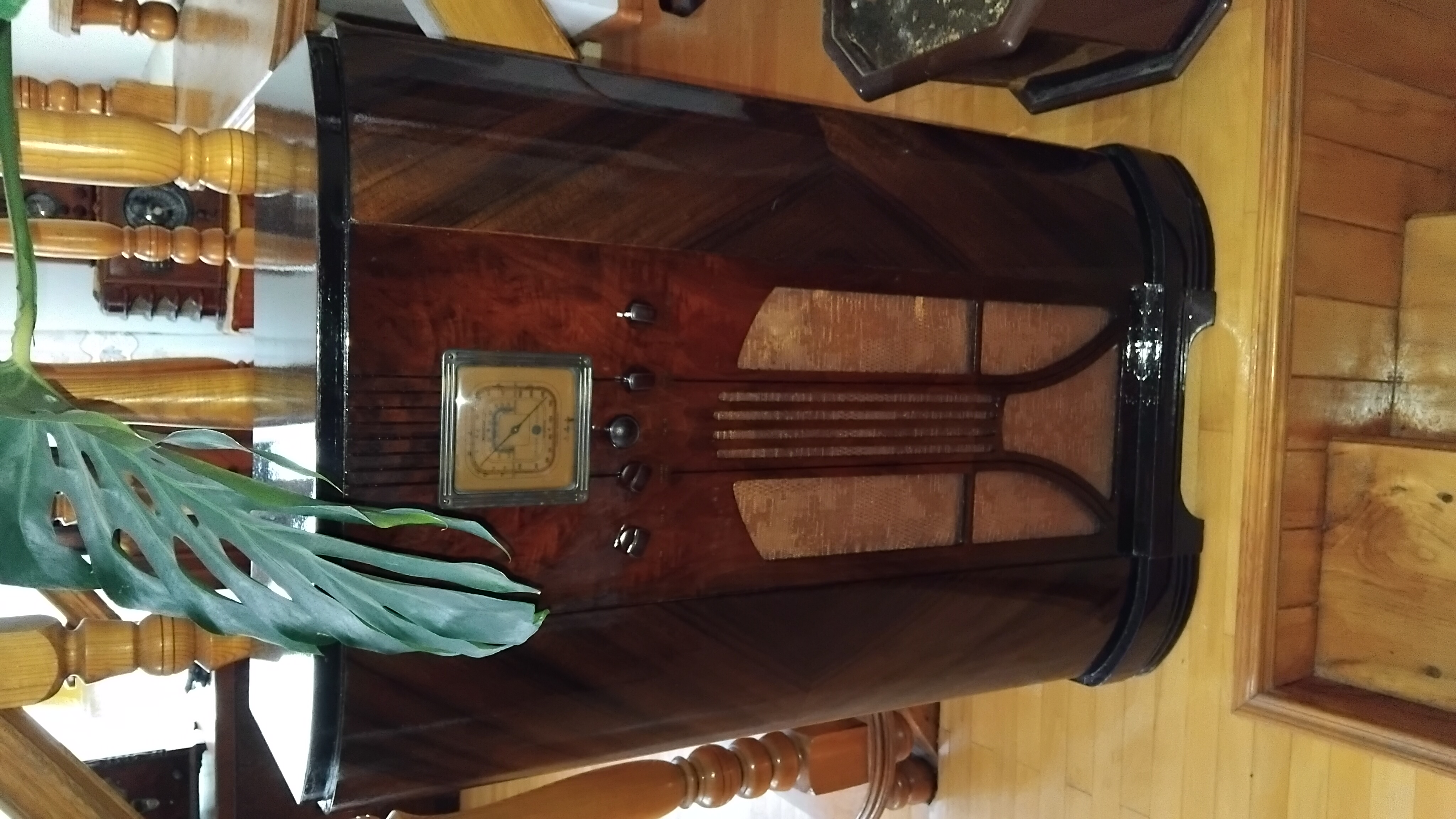

Well... The body is varnished, now it's repaired... Last Saturday I aligned the bands and assembled this radio console. To be honest, I don't really like this design, but in the interior among other radio consoles it looks quite stylish. Here are a few photos, in the near future I plan to create a video test about the quality of this radio.

Nice job on the cabinet, I like the case itself but If I was GE I would have designed a sharper dial. Nice work. Paul B.
Boy oh boy, you can't tell the players without a scorecard. Fisrt off, really nice job and a really nice radio, Peter.
Looking up a GE A-87, that is a GE-designed set with 2 6F6s, but a Canadian GE A-87 is the equivalent of an RCA T8-14 or in your case, a C8-15. Yeah, dunno why they used a 5Z3 but the power transformer looks big enough for it. Usually, you needed a 20watt or higher output stage to justify these tubes. Also don't know why the shield on the 5Z3 rectifier. RCA used shielded type 82 or 83 mercury vapor rectifiers in their high power consoles in 1933 / 1934 because they were mercury vapor and needed to shield the tube to prevent radiation of noise interference from the rectifier.

Thanks Paul. I don't like this scale either, it looks very cheap and unattractive. In my opinion, it strongly dissonants with the overall design of this radio console.

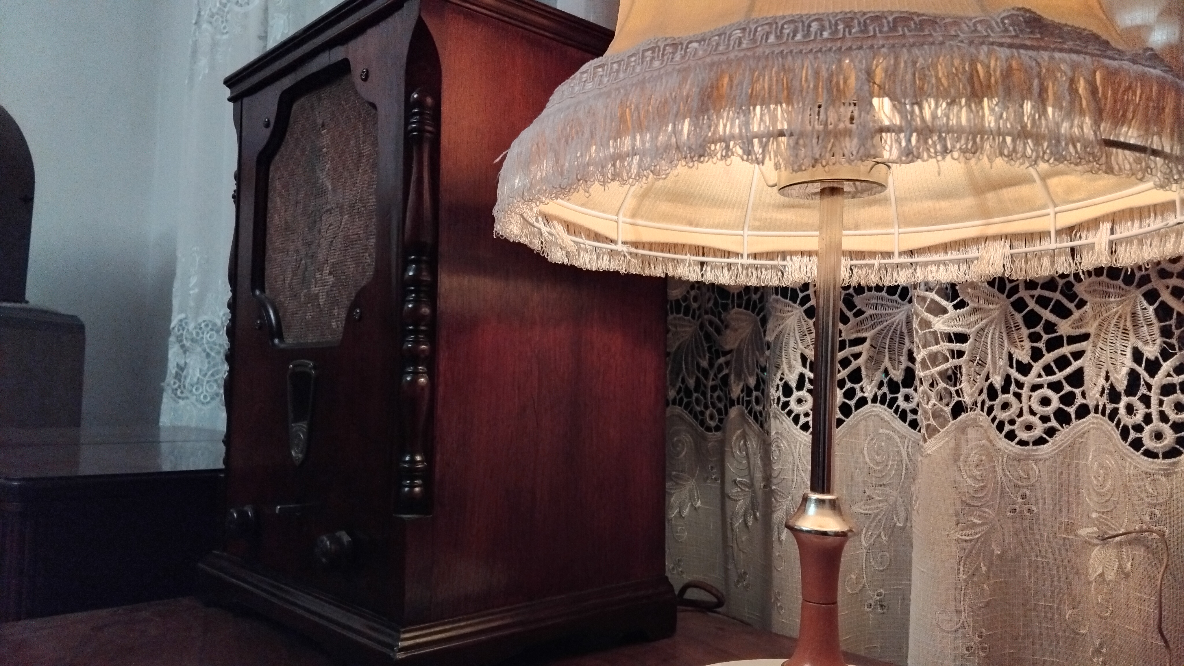

RS. I completely agree with you that the General Electric Junior S-22 is much more beautiful and aesthetic than the RSA P7 Superette. Recently I was lucky enough to get acquainted with this wonderful radio. I adore its design.

Yes, that's the one, the GE S22.  Mine is the S22A with the 47 pentodes in the output stage as opposed to the 45 triodes.

BTW (By the way), the color of the finish on your GE S22 is very nice, mor 'red' in it than mine. Mine is pure brown mahogany colored.
