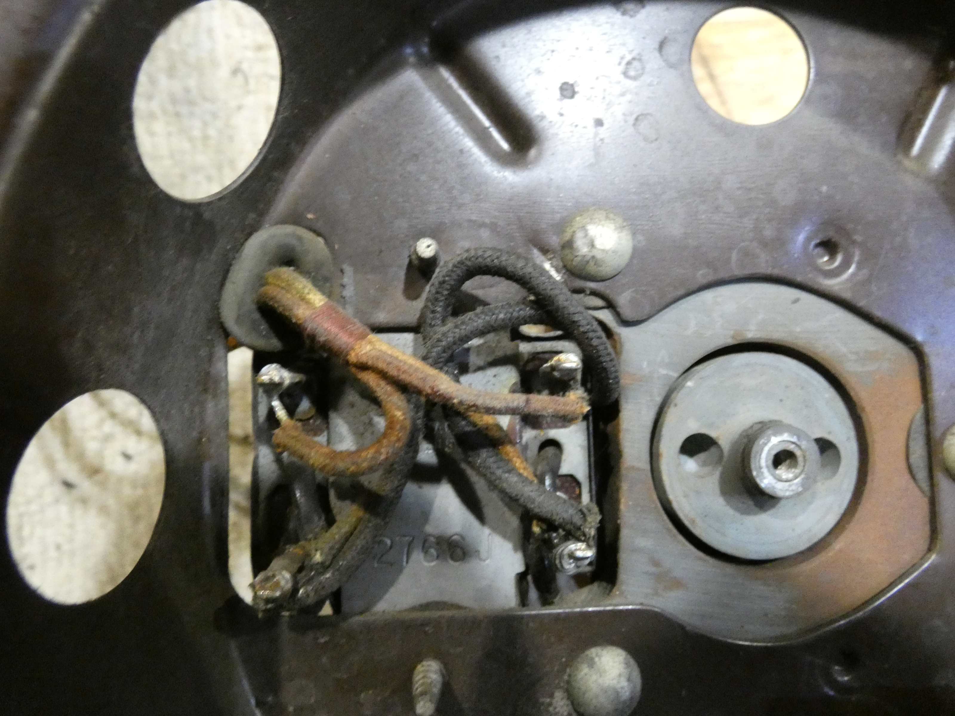

Worked on the speaker assembly last night. Clipped my ohmmeter leads to the connector pins and found that with slight movement of the cable I would get some intermittent readings. Found that at the speaker end of the cable there were some very dodgy solder connections so, reterminated the connections and am now getting resistance readings of 265 ohms and 5.1 K. I expect the new resistors and capacitors to arrive this week and am hoping to power this radio using variac and dim-bulb tester after new components go in. Wondering if I leave the speaker assembly as is could that result in a Maintenance-Induced-Failure of a serious nature.

You are supposed to see two readings of around 250 Ohms (one higher than the other, due to the windings geometry) and one reading of 3.1K.
5.1K is wrong and requires further investigation. It is encouraging but needs to be traced down to the reason for it.

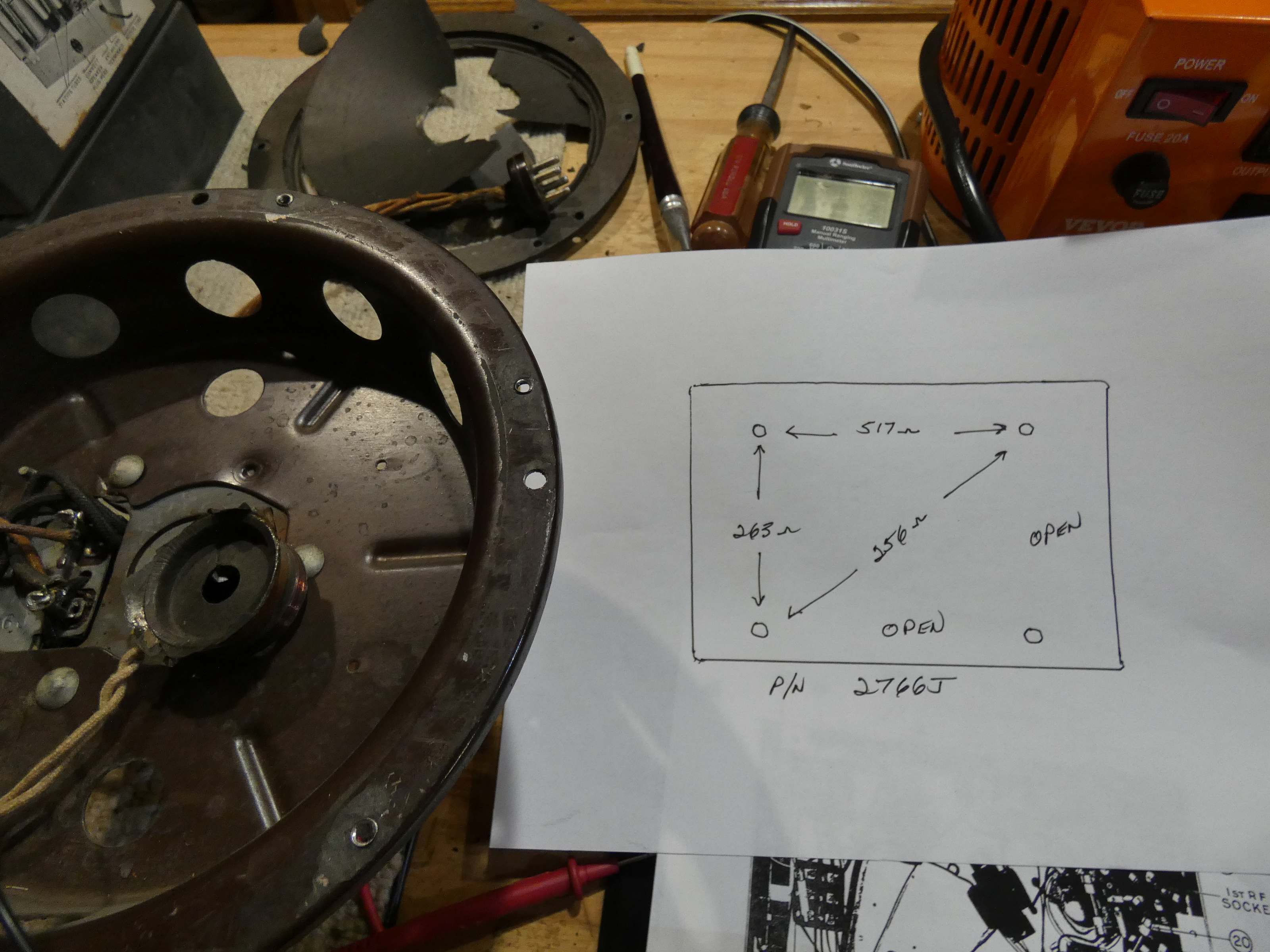

The pictures tell the story of my misadventure this morning.  The 5100 ohms was my misreading of the DVM.  It seems it was actually 517 ohms.  Safe to say the field coil is open?  I'm going to look into replacing with a PM speaker housed in separate box so that I might at least power this radio after power cord and component replacement.

Hi StoneyD,
I have put a PM Dynamic speaker into a Philco Model 20 with good results. You can install directly into the cabinet without hacking the cabinet up. You do have to hack the speaker. At the 4 speaker holes, cut a notch into the frame to make the holes into an open U. This and 4 washers will allow you to mount the speaker into the cabinet.
To deal with the field coil, merely place a 3.1K (a 3K will do fine) 5W resistor across the field coil leads. Temporarily transfer the transformer to the new speaker (most speakers have mounting points) or fashion a bracket to mount the transformer onto the speaker. There will be a mismatch as modern speakers are usually 4 Ohm or 8 Ohm and the Model 20 speaker is about 1.5 Ohm. However, for testing purposes, you should be OK. I used a Hammond 125D (I believe) which had 5KOhm Plate to Plate impedance and this seemed to work just fine.
