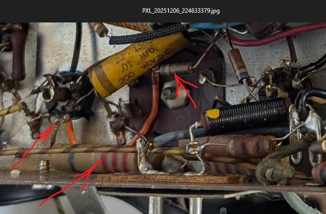

Another thing I have noticed: this radio is a bit different from the schematic.
For instance, 1st and 2nd IFs have some large resistors to GND from their pins 6 (SG) whereas they are only supposed to have 680 Ohms pullups to the Plates' Positive bus. They seem to be in 22K or so range.
(all points of interest are marked with red arrows)
You can seer that the pin 6 of this 12BA6 (left arrow) connects with the orange wire to the 680 Ohm small resistor (right arrow). As it should.
But also that same pin is connected to what seems to be 22K large resistor (middle arrow) the other lead of which goes to GND.
You could also see another resistor like this one to the right (for the other 12BA6 tube).
The resistors are a large ceramic kind; I suspect at least 1W rated.
I wonder if the SG voltage on these was a bit high and they used these to lower it just a bit.
The soldering seemed factory professional, so I do not doubt this is not a mod/repair.

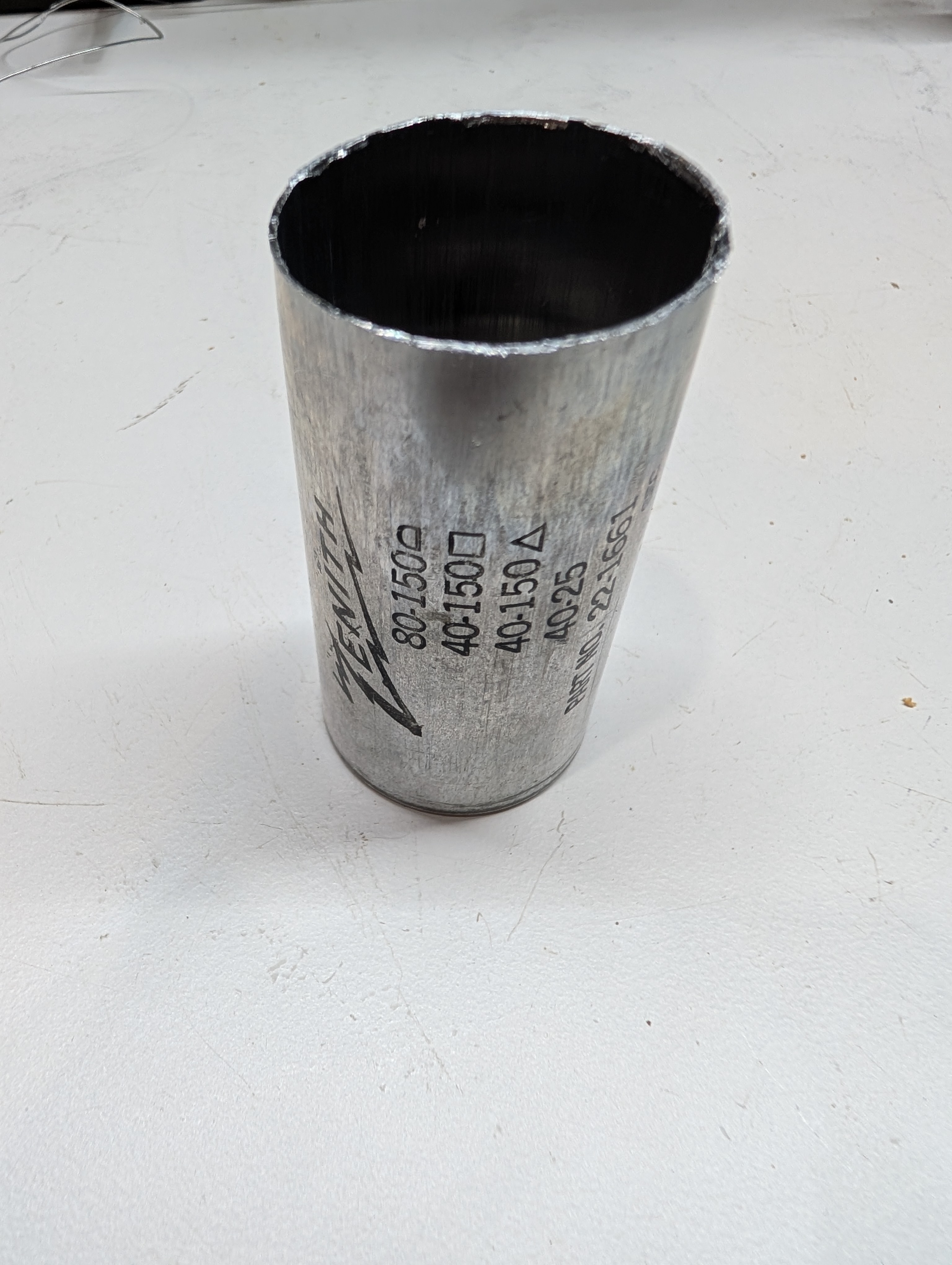

Finished the tubular recap today. Took longer trhan usual: Zenith cap's wax is hard to melt and quickly solidifying.
Also the way the wires are secured made it harder to free the stubs. In sensitive places like chokes I just clipped them close.
The bumblebee, as expected, is solid inside and is not really restuffable, unless I could drill the axial hole (doubt it).
The last thing I did today was freeing the twistlock cap. Not only it was soldered by one tab to the chassis, but these tabs have those small burrs, and it took me over 30 minutes to free it. I have a huge old style wood handle flat screwdriver, probably 0.4" wide and as thick. It eventually persuaded that cap to come out.
The caps are mostly 3 times the value, so they do need to be replaced.

They may be either a factory mod or a documented post manufacture mod.  Often, this info does not make it into third party service info such as Breitman's, Riders or even Sams, whether or not the documents were published in cooperation with the manufacturer.
In older radios, the use of "voltage dividers" to supply a predictable screen voltage that does not vary based on varying current was common.  I looked at the 920, 921 and 922 and can't find the resistors.  My guess is to measure the voltage for the screens.  If accurate and non-variable, then you are good to go.  if the resistors are out of spec based on their markings, replace them.  I used a 100V drop across the resistor, instead of the approximately 80V in calculating power dissipation which works out to be about 1/2 Watts.  1 watt resistors should be OK, 2W better.  Use carbon or metal film.  Since these are DC voltages that are likely bypassed by a cap, RF should not be an issue but do pay close attention to replacement.  Hopefully, you don't have to change them, as they look quite buried.
Mr. Fixr,
They are not badly buried and all is fairly easily accessed. But they seem to be close to their intended values (as are, in fact, all resistors I've checked so far). Hopefully, I won't have to do any resistor changing.

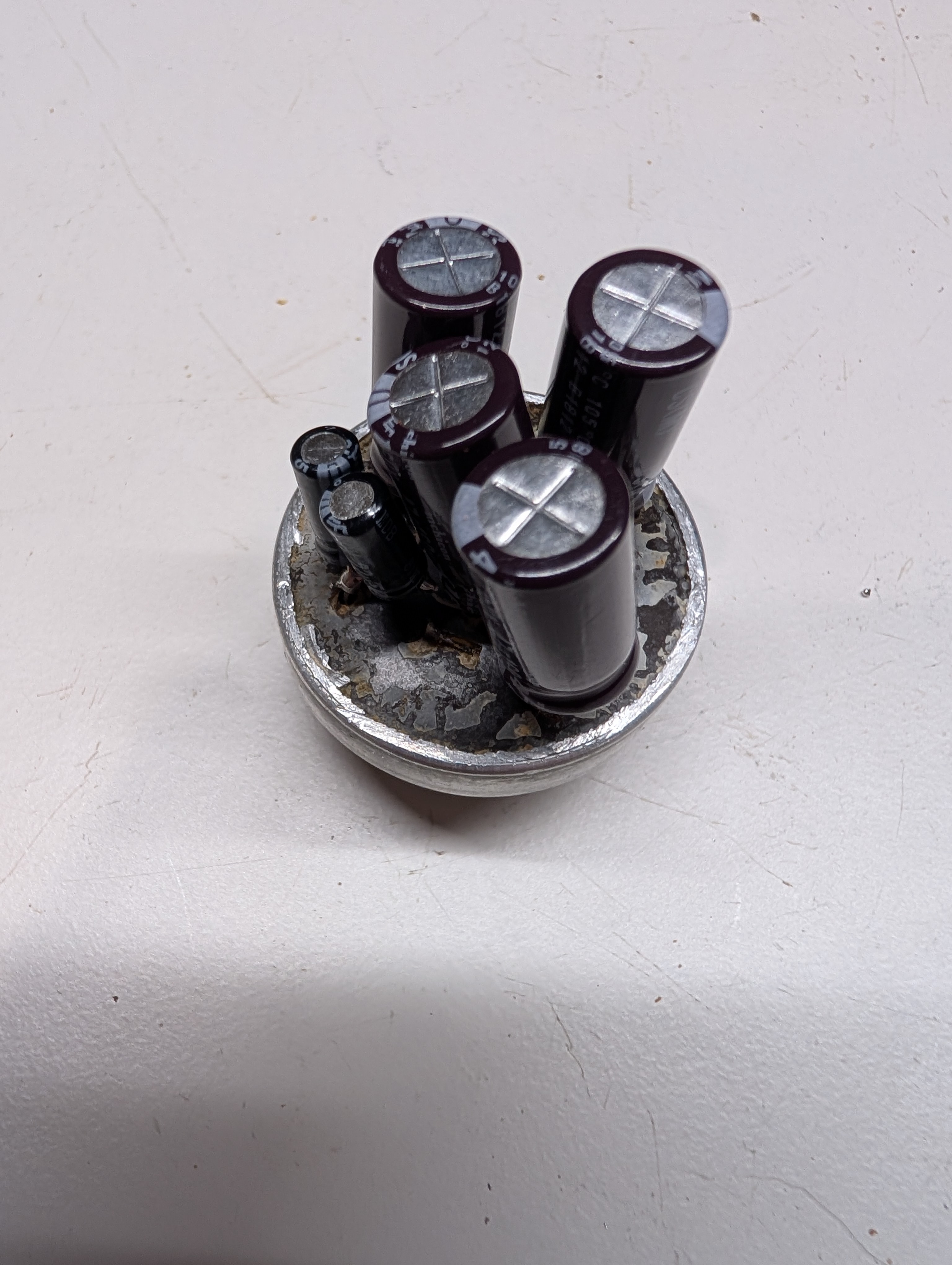

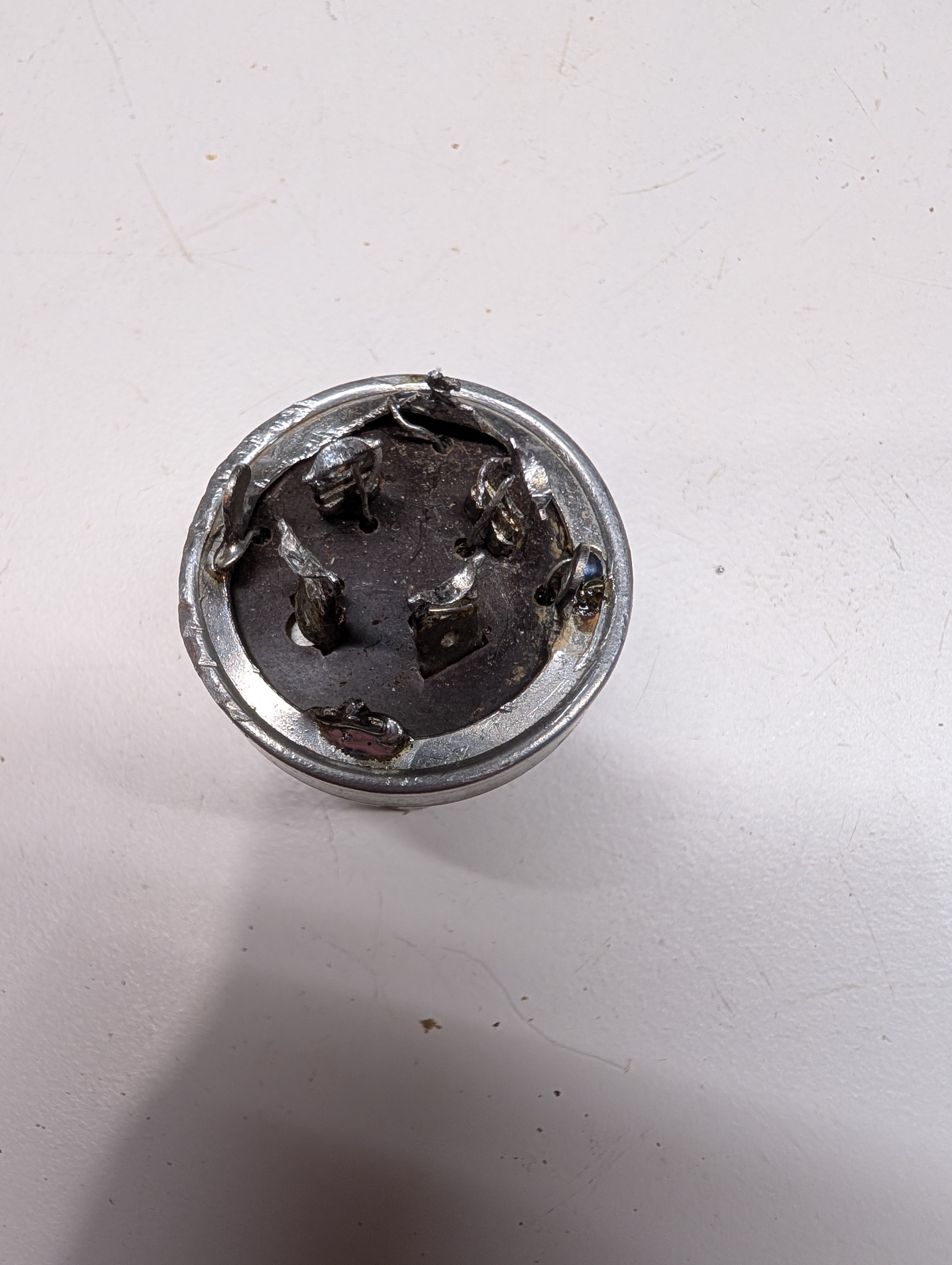

Finished the tubular recap.
Now I have rebuilt the 4-way cap, just have to glue the cap back on.
Will do that tomorrow when it is dried up inside.
Glueing the cap together. Hopefully if the epoxy behaves the way I want it to (run down while it is still gooeym bonding tthe cap to the base, and then setting), I could set the cap in place tonight. Usually it behaves (JBWeld).
