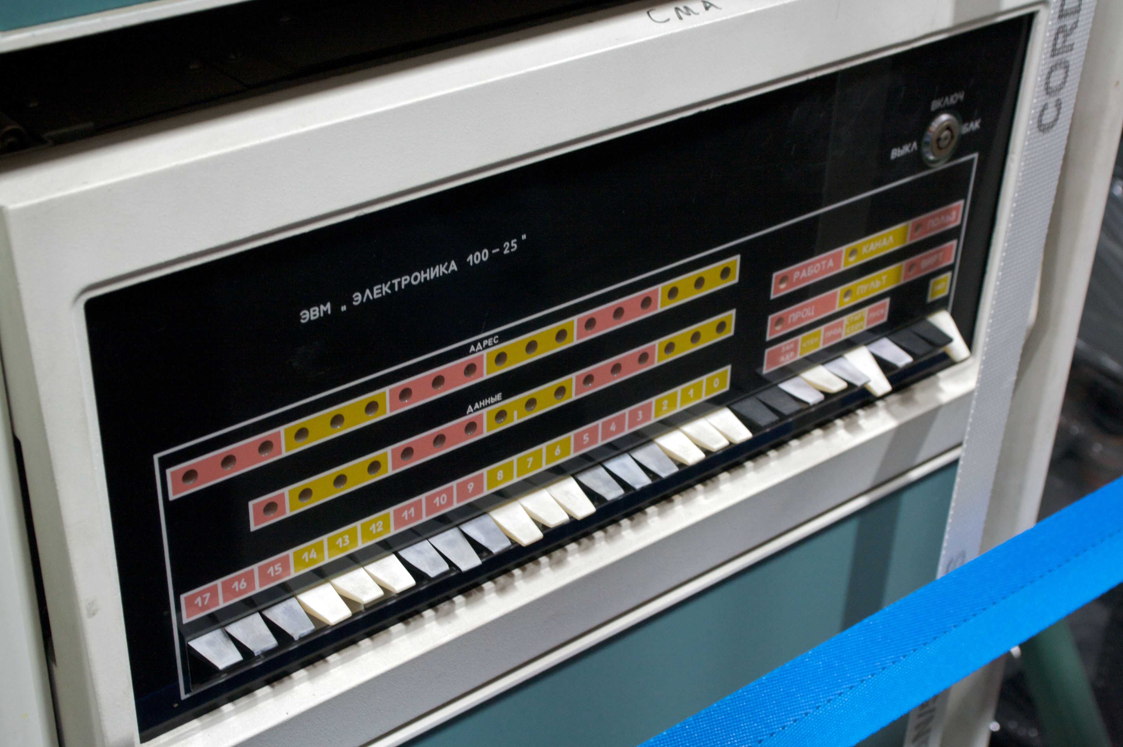

In the year 1986 I was servicing a Soviet-made (well, Soviet-Polish; the CPU was made in Ukraine and the rest of Mera-CAMAC computer was made in Poland) mini-computer, a PDP11-34 clone. The processor designation was Electronika 100-25. (This is its front panel).
The processor was mounted on rails in its stand and could be rolled out or back in. The boards were inserted on one side and the back was wire-wrap type.
Whoever have seen wire-wrap panels, knows that the pins of the connectors, that were wrapped with wire, were very rigid. And very sharp at their ends.
So, upon having serviced it (taking boards out, dusting the board edge connectors, cleaning the edges with some good quality grain alcohol) I rolled it back. It so happened that near the wire-wrap pins there was a cable that powered the cooling fans (220V of course). The cable was not jacketed - just the rubber-insulated wires.
The  wire-rap pins grazed it as the processor was moving back, and the computer stopped.
This computer (whopping 256kBytes of semiconductor DRAM, freshly installed to replace 4 cubes of 64kBytes each of core memory) was powering the whole research facility.

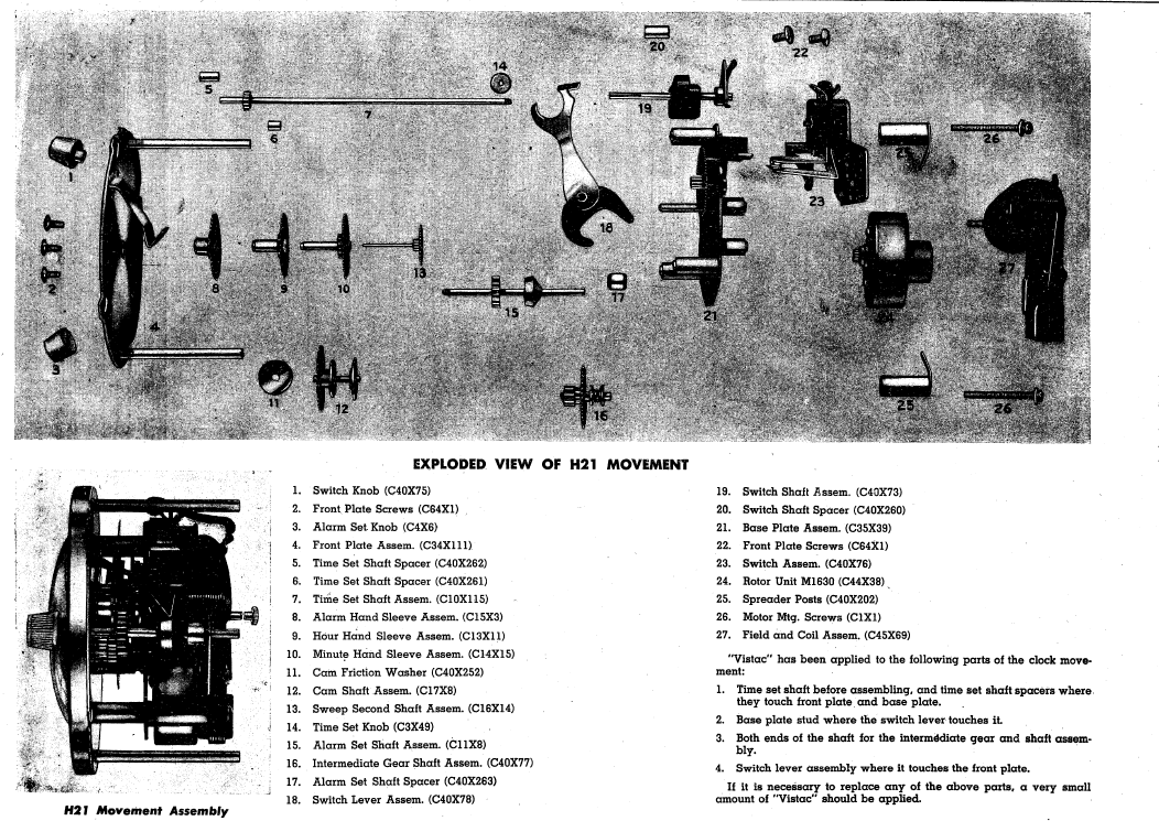

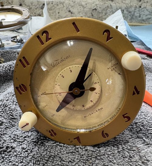

OK, back to the Telechron. Time to be a horologist and get the clock mechanism sorted out. I mentioned I had found an 8H61 Telechron Switch Alarm as a parts donor and possible drop in replacement. There were two main differences between the Switch Alarm and the Musalarm radio clocks, i.e. the dial face has different names on them and more importantly the time setting knob shaft on the Musalarm radio is about 2.5 times longer than on the Switch Alarm.

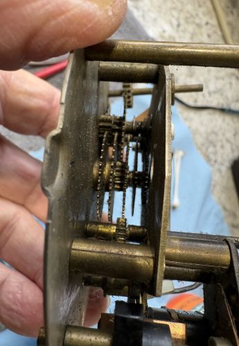

To swap out the Time Set Shaft Assembly (7) you need to remove knobs 1 & 3, the glass and front eschucheon (easy, a few metal tabs to bend up), Time Set Knob (14) and finally the Front Plate Assembly (4). Once the Front Plate Assembly is off, all the gears become loose so unless you want to rebuild the entire gear assembly you need to hold everything carefully upright. I don't have a pic of it in this state since I did not have a third hand but this is a photo of it before the Front Plate on the left comes off of the original Musalarm clock mechanism.
The Time Set Shaft can be pulled out what was the Front Plate Assembly BUT note that there are two spacers you need to watch for (5) and (6). Of course it never goes quite as smoothly as you would hope. I had thought I had finally gotten the longer shaft installed, all the gear and posts in their correct bushings, and the Front Plate snapped into place when I realized the Alarm Set Shaft (15) was loose and missing its spacer (17). Took it apart again and fixed that only to realize the Switch Shaft Assembly was missing its spacer (20). Icon_crazy I guess a few things fell off that I had not seen. Never the less I finally got it all back together so it has a better looking eschucheon, two knobs and hopefully, will work when put into the radio!

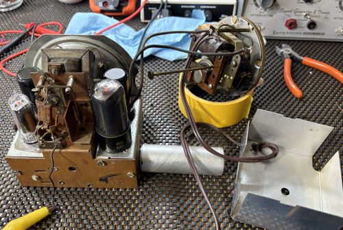

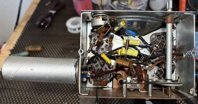

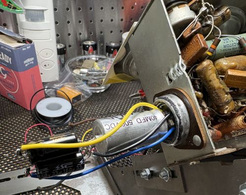

On to the radio, just a simple install of the 3 electrolytics into the space where the old can was.
I used the cardboard sleeve that covered the can to also cover the new electrolytics without trying to stuff them back into the old can. Paper caps were replaced.
The space was pretty tight to get down to the tube pin lugs but it worked out. Three of the 4 tubes were bad so those are now replaced as well. After temporarily rewiring in the clock, it all checked out on the bench and was working. A number of stations came in pretty well with a four foot wire antenna.
Now I just need to remount the clock and radio into the cabinet, check the alignment and this one should be done. I'll post a photo of the finished radio when it back together.

It's kind arare to see 3 outa 4 tubes bad. You should go and play some lottery.
Yes I thought so as well but 2 were stone dead and one was just into the bad reading ( on my Jackson 648R tester).

It looks like you were using some 450 vdc caps, yep you can't restuff the original can with those. I have a lot of photoflash capacitors, technically you are not supposed to use too high of a capacity for in input filter cap, but I used 150 and 160 uf 330 vdc photoflash caps in AC/DC sets all the time and never blew up a rectifier tube. The last rectifier tube that failed in a set I had was a 35W4, ironically in a late 60s Westinghouse clock radio, and the reason it failed was because the 50C5 power output tube was loose, so it would periodically loose contact, and regain it, with a bunch of static, and I think it blew out the cathode connection in the 35W4. I seated the 50C5 in it's socket firmly, replaced the 35W4, and it was working fine up until I quit using it as a daily driver radio.
As to why most of the tubes were bad in your set, my guess is that it spent it's time in a kitchen, or garage. running 24/7, and the higher line voltage and leaky caps probably did not help. The line voltage is something you may want to address, a bigger dropper in series would the tube heaters would likely help.
