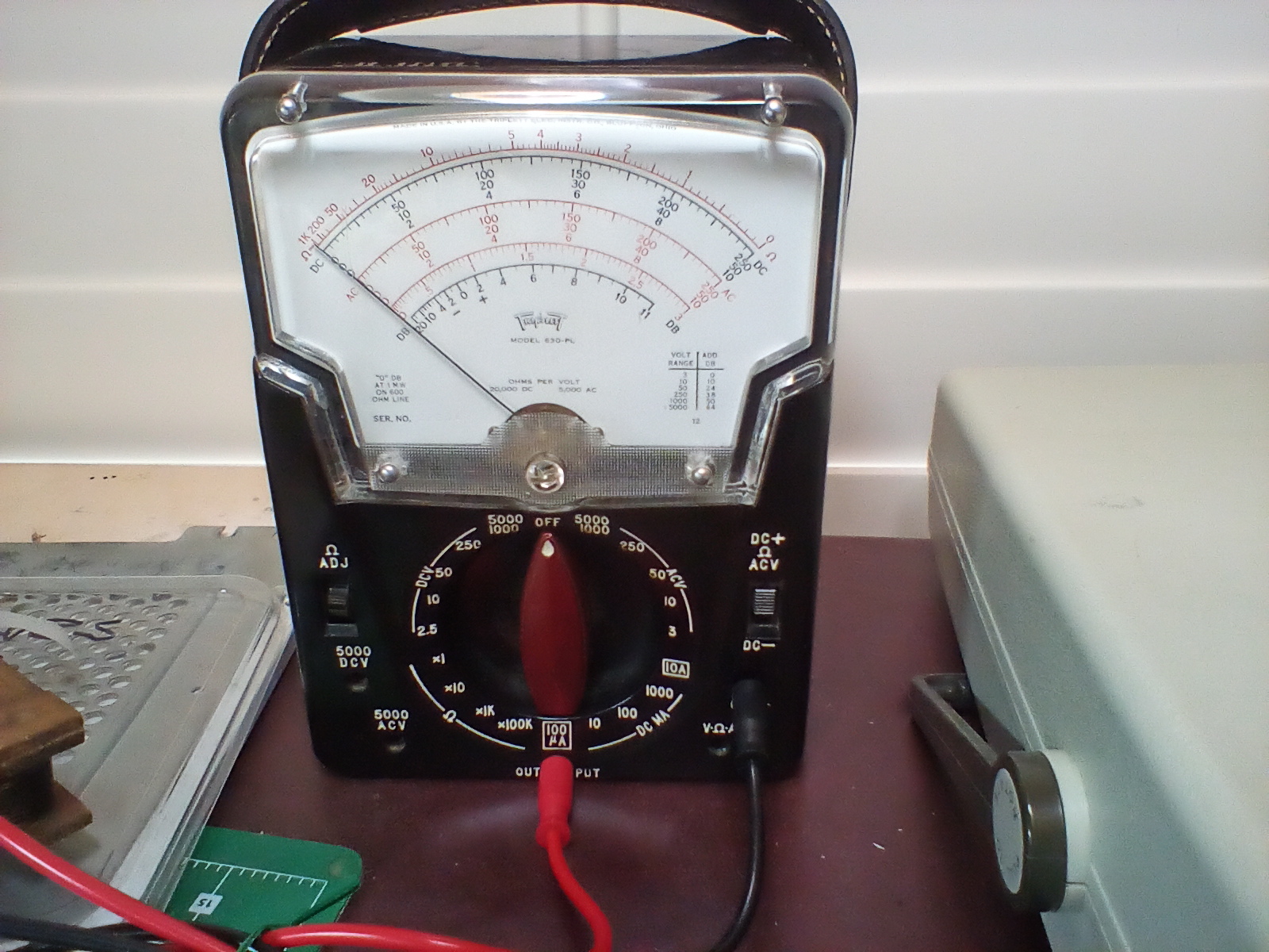

Ok, now I have run into a problem in trying to do the IF alighnment.  The meter I have to use is a Triplett 630PL.  I am following directions in the 37-640 and it says to set the meter to 0 to 30 volt range.  I assume that should be AC volts?  I do not have a 30 volt range and I including an attached photo of my meter if that helps.  Here is the first problem I am running into. I have connected up the meter to pins 3 and 8 on one of the 6F6G tubes as it says and when I turn on the radio, the meter pegs out to max when connected to the meter ac volts and common connection. But when I put the red meter lead in the output connection of the meter, it seems ok by not pegging to the max of the meter.  However, I do not get any results in adjusting 34S/34P, 33S or 33P.   During this time I had the sig gen connected up to the grid cap of the 6A8 tube with a .1 cap per the instructions.  I did however, have the grid cap connection from the tuner removed from the 6A8 while doing this.

You also should show the settings you use on your photos, else we only see it on "Off".

I am not sure what you are doing with this meter. If the meter is OK, (and the convention is Black is Common).
Your Black lead should be in your COM- jack.
Your red lead should be in your OUTPUT jack.
Your range should be set to appropriate AC Volts and your Polarity switch should be at the top (DC+, Ohms and ACV) position or else the polarity will reverse.
This is it. If it still pegs out, and stays pegged out, your DC blocking cap could be shorted.
