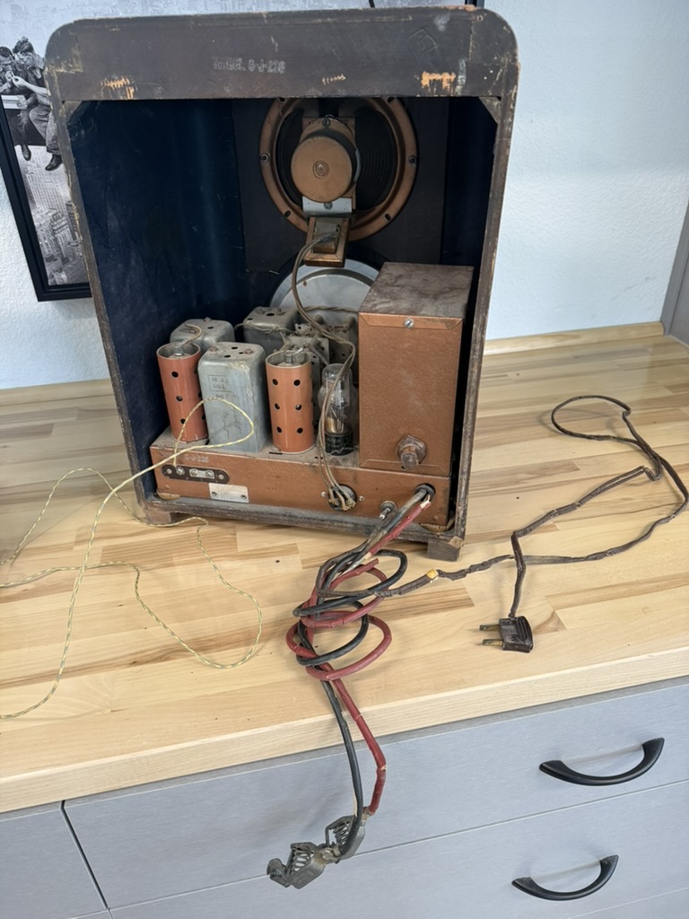

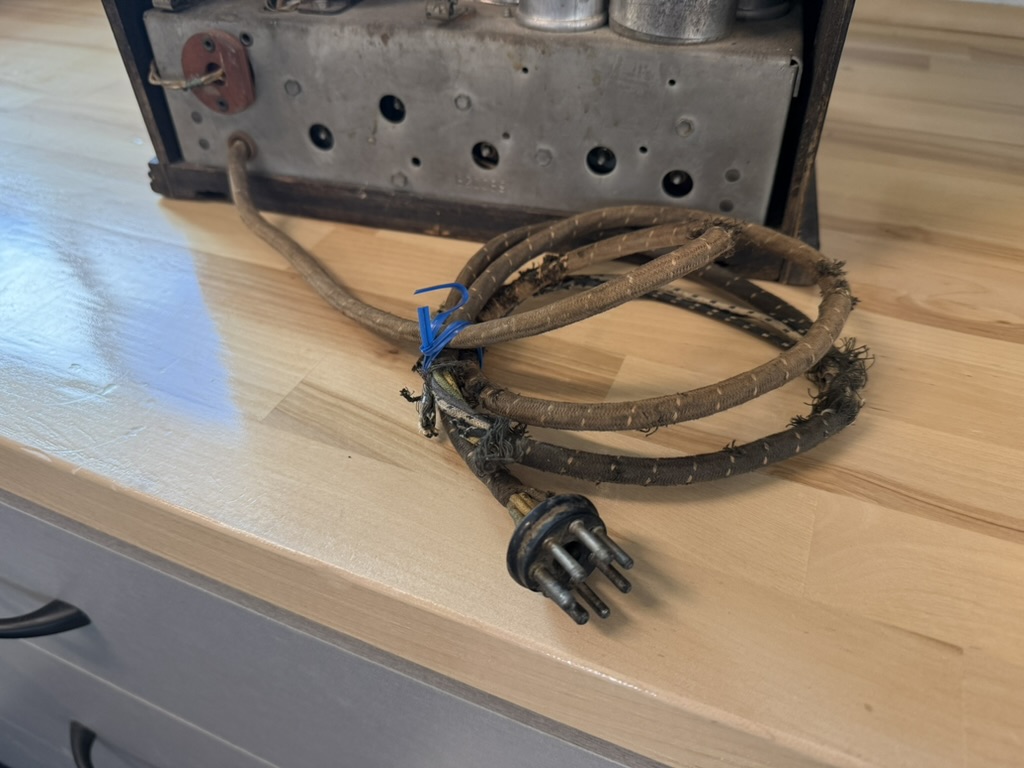

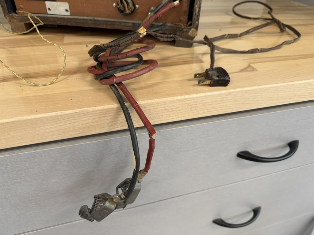

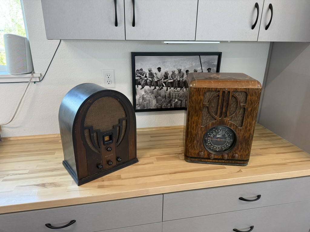

Hey all, I had a chance today to pull down the 2 farm units from my upper cabinet display today.  Some good news, and some questions for the group.  Here are the models I have and some details.  Pics attached also for reference.
1. Philco model 38 - built 1934:

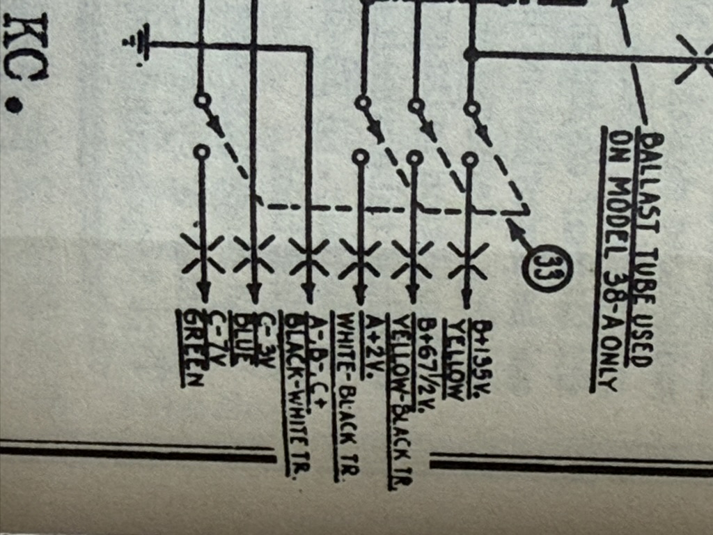

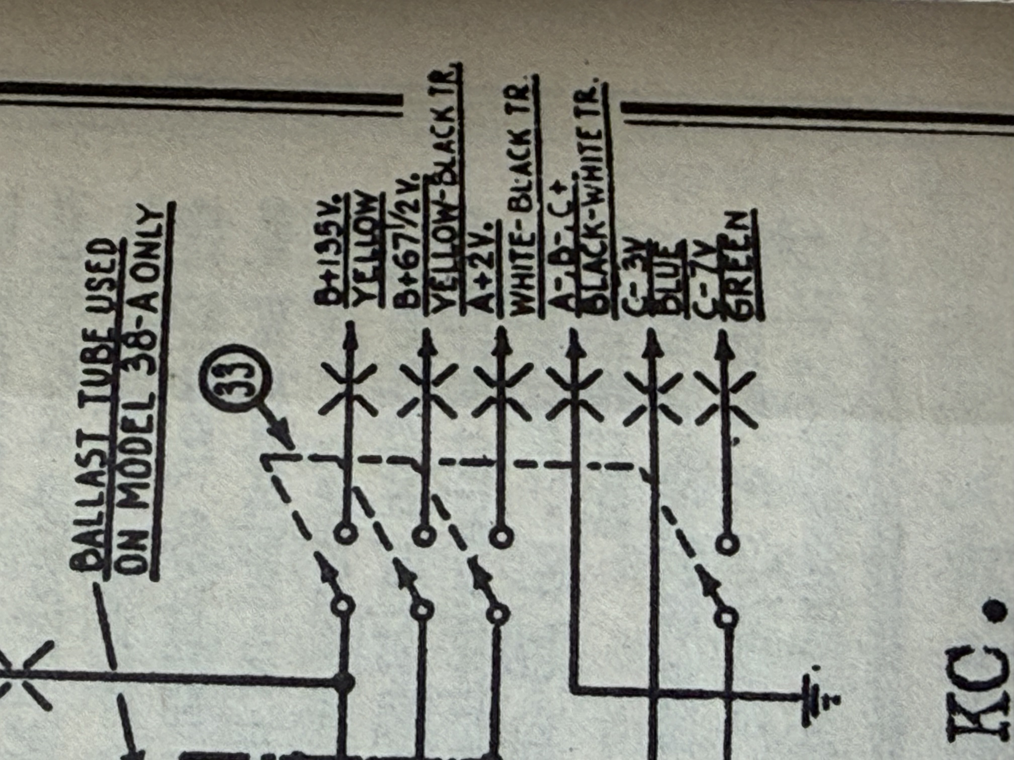

According to my Rider volume IV (the schematic on the Philco site was pretty hard to read, but I have all the Rider volumes which comes in handy now and then) - this unit needs;
a. A supply: 2V, type 172-R - I believe this type refers to the Philco 2 volt lead-acid battery from the 1930s
b. B supply: 90V, type P-962 - another Philco type reference for heavy-duty battery back
c. C supply: -4.5V? or -9V?  is that correct?
options:
- doesn't look like Rod's schematic design will work for this model
- doesn't seem like the Powr Shiftr will work either since it is 1.2v filament and no C supply - is that correct?
- ARBE-III will work - is that correct?
- one challenge will be hooking up the ARBE-III to the Philco 6-pin battery plug - is there a female plug end available somewhere that I could wire up to the ARBE-III, does anyone have a source for that?

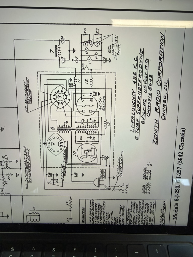

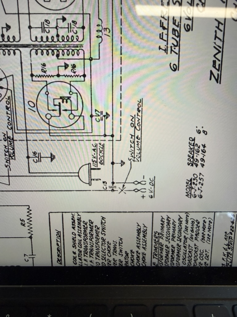

2. Zenith model 6-J-230, chassis 5646, built 1938:

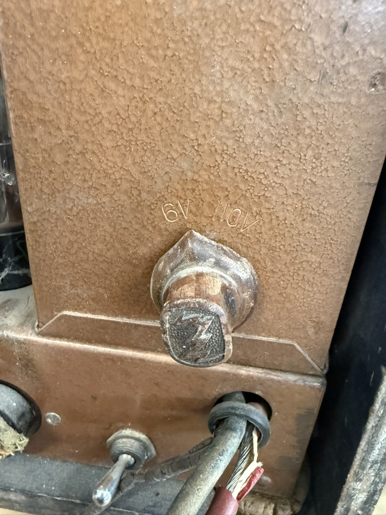

Here I lucked out - this unit is a 110V AC -or- 6 VDC unit.  When I was originally looking at it, I only saw the 6V battery connectors and I didn't see the AC cord stuffed in the unit.  It has a switch on the back to toggle between 110V and 6V.  So, I can work on this one in 110VAC mode.  I do have a separate power supply that can delivery the 6VDC if I wanted to test this out once repaired.  So I'm in the clear on this unit.  Well, in the clear for how to power it, but dang this unit needs some TLC haha. Gonna need to psyche myself up for this renovation.
Pics attached for reference.  I really, really appreciate the time and effort everyone here has put in to throw out input and feedback.  Super helpful.

Thanks Mike, I mis-read the pot value, my bad.  One thing that is still confusing me on the Model 38: the schematic shows the 6 pin connector for the input voltages from the battery.  It shows 6 inputs. The ground and 2v is clear. But there are two B+, one at 135v and one at 67-1/2v.  And two C one at -3v and one at -7v.
I get the different needs for plates vs screen grids, and different negative bias levels. But doesn’t this imply a need for 5 different input voltages? I’m not certain every pin is utilized on the connector I can double check that. But if there is a need for 5 input voltages what power supply provides that?
Craftsmanship is an ongoing cycle of learning fueled by patience, persistence, and care, where every project refines our judgment and challenges our skills, in the steady pursuit of the Path to Mastery.
Well, yes it seems like you do.
I never worked with these radios, but the 67V is the 2nd DET B+ (detectors are often supplied with lower voltages), -3V is the pushpull grids' bias and -7V is the pushpull driver and the DET-OSC grids' bias.
Good news is, the neg. biases as well as the Det B+ do not draw a lot of current, especially biases.
And 67-1/2 V is there for a reason - it is middle of the 135V, so they probablyt use two sets of the same batteries and take the 67-1/2V from where they connect to each other.
The end of the cable on that Philco looks like a tube base, unless it has more fat pins then usual. It also looks like it has seven pins, so basically the same base as a 6A7 tube, so an old style seven pin socket may work in the battery eliminator. One plan I saw for a battery eliminator was in an old magazine I have, they used the same trick they used in early AC radios by tapping into the negative leg of the B supply with a voltage divider resistor, basically the divider was between the B- point and the center tap of the high voltage winding of the power transformer. It's not actually a negative voltage as such, but that the B- is more positive, so it works out about the same. The more modern way would be to use a lower voltage transformer, and reverse bias the rectifier diodes. It isn't that it's that complicated to make with all new parts, but I think it's more fun to make ones out of salvaged parts if you can get away with it.
67.5 volts is 1/2 of 135 volts, but 135 volts is also 3 X 45 volts, so many sets used the configuration of 45, 90, and 135 volts as well, and if you look at the tube manuals many of the power output stages also have a 180 volt rating, which is 4 X 45 volts, and some higher end battery sets did do this, at least in Canada. I have no idea if any in the U.S did this, I haven't really perused through the Riders to find out, though Sears or Montgomery Ward may have. I think the logic may have been to just offer a 6 volt vibrator model to those whom wanted a higher performance farm set. Unlike solid state equipment I think that the B+ voltages in farm sets may have had more to do with configuring, and packaging multiples of 1.5 volt cells in series then critical operating voltages. Obviously you would not want to exceed the recommended filament voltages, but running the B+ a little high would no blow anything up, in three way portables the B+ was often as high as 100 volts in AC mode.
