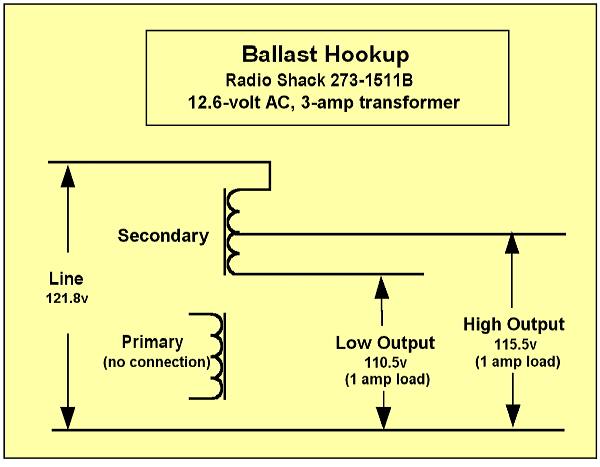

our voltages are about 10% high, and that does not bode well for tube life. I'd get a bucking transformer installed if you have room to tame it.
(03-15-2012, 01:25 AM)codefox1 Wrote:  our voltages are about 10% high, and that does not bode well for tube life. I'd get a bucking transformer installed if you have room to tame it.
A bucking xfmr should not be that large, should it? never saw one, but from the way it works, it may be made quite a bit smaller than the auto or a full step-down.
Do you know a good place to buy one, 120/110V type?
See attached. Many variations on this but this is simplest.
