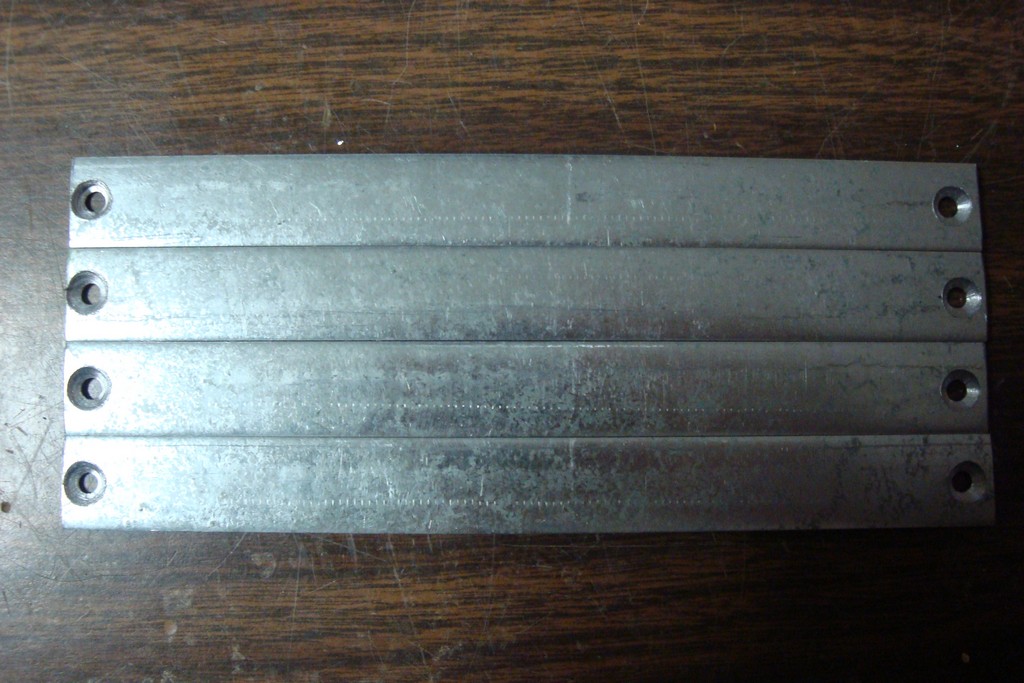

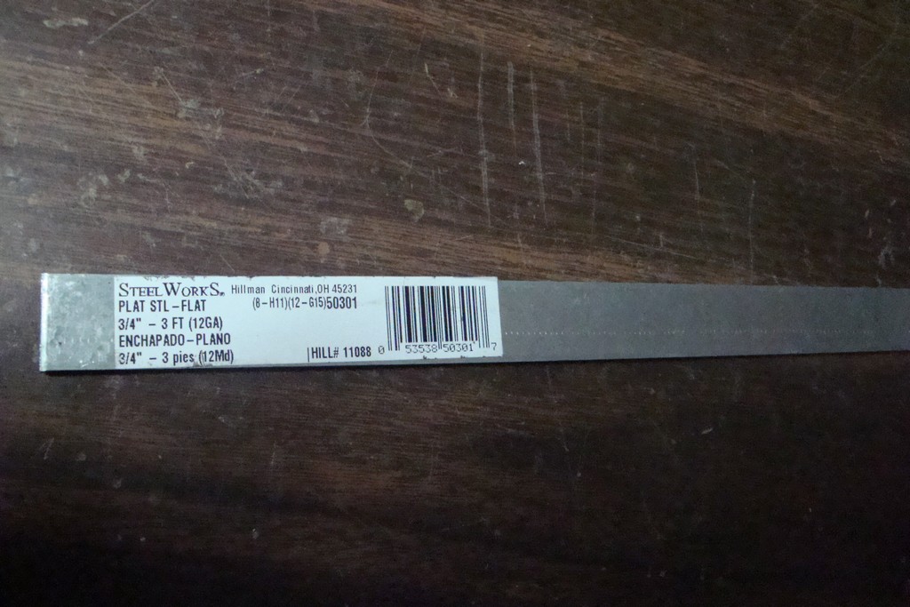

I started off with a 3 foot section of steel:
[Image: http://www.philcoradio.com/images/phorum...94b082.jpg]
and then cut four equal sized pieces, each 7-15/32" in length:
[Image: http://www.philcoradio.com/images/phorum...a76f39.jpg]

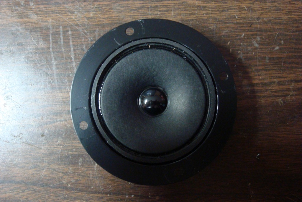

Here's the new 4 inch tweeter, with a frequency response of 3000-20000 Hz.
[Image: http://www.philcoradio.com/images/phorum...f5439b.jpg]
There are scratches on the mounting flange from my previous "test fit" of the steel pieces.

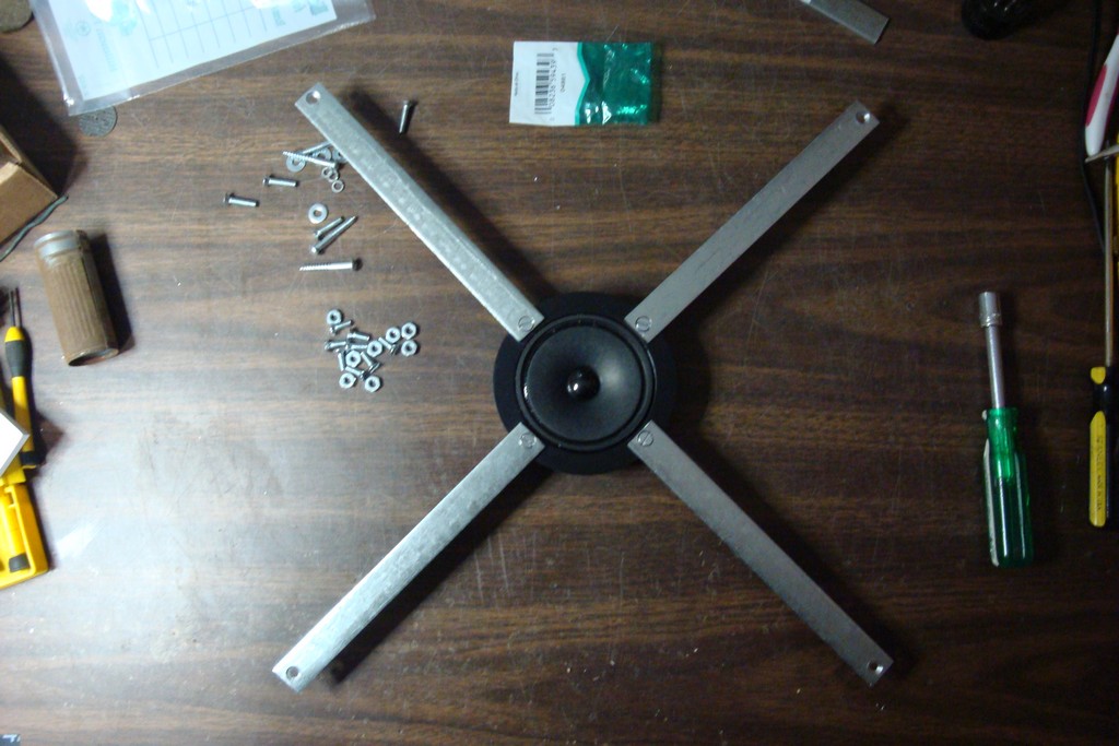

Add the steel to the tweeter, and we have this:
[Image: http://www.philcoradio.com/images/phorum...5d070e.jpg]

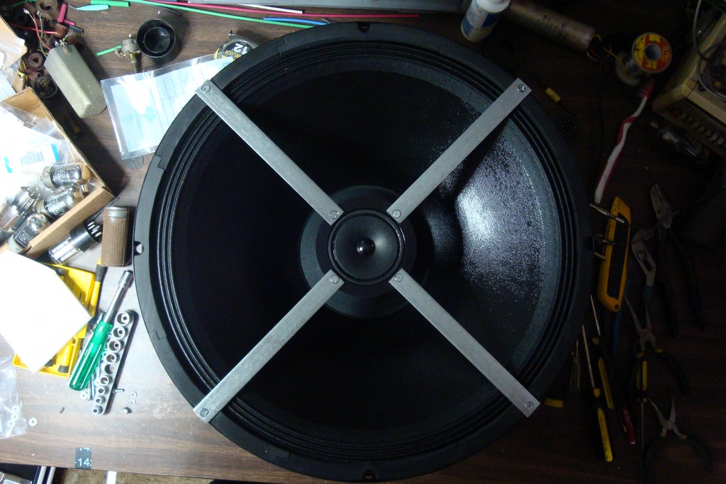

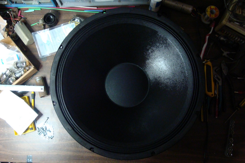

Now let's bring in the woofer. It has a frequency response of 20 to 6000 Hz.
[Image: http://www.philcoradio.com/images/phorum...430c5e.jpg]
[Image: http://www.philcoradio.com/images/phorum...79a0de.jpg]
This thing is as big as several of my radios and even bigger than others!
With a woofer response of 20 - 6000 Hz and a tweeter response of 3000-20000 Hz, using a crossover network with a crossover point of 4500 Hz, this speaker will produce the full audible range of 20 to 20,000 Hz. Certainly the radio will not be producing that kind of frequency response on AM or SW, although the McMurdo's audio amp is probably capable of producing that entire frequency range. Once the set is done, playing something through the McMurdo's microphone input should prove interesting.

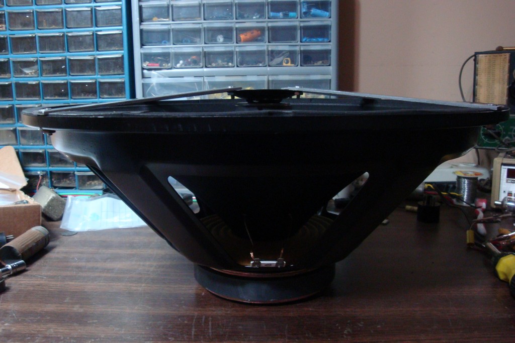

Anyway, the next step is to mount the tweeter coaxially in the middle of the woofer. I found that by simply laying the arms on the woofer gasket and tightening the screws/nuts, that the steel sank down into the gasket, making the steel rub against the outer accordion edge of the woofer's cone - not good.

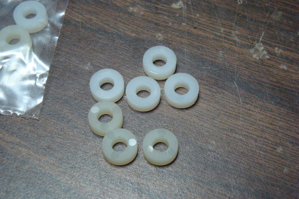

Then I remembered these:
[Image: http://www.philcoradio.com/images/phorum...1a7e5a.jpg]

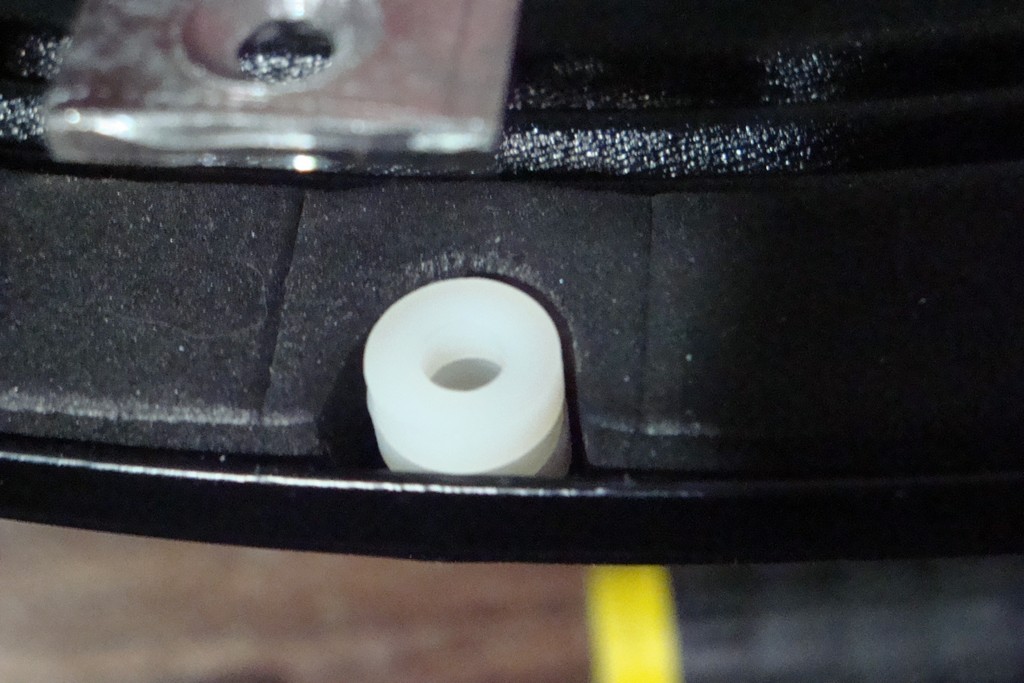

Nylon washers that I had bought at a hardware store, that turned out to be too big for use in lamp sockets. But now I can use them as spacers:
[Image: http://www.philcoradio.com/images/phorum...476a19.jpg]
These will keep the steel arms from sinking into the woofer's gasket and will keep the arms suspended above the woofer's accordion edge!

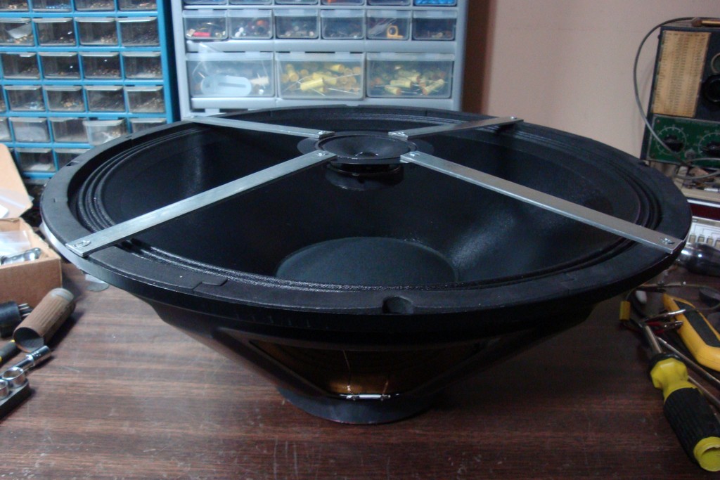

Finally, here's how the homemade coaxial speaker looks all together:
[Image: http://www.philcoradio.com/images/phorum...a2d482.jpg]
[Image: http://www.philcoradio.com/images/phorum...324b3f.jpg]
[Image: http://www.philcoradio.com/images/phorum...f99211.jpg]
The next step is to attach wires to both speakers, then attach the speaker inside the McMurdo's Clifton cabinet. I bought some stick-on gasket material to help ensure a tight seal between speaker and sounding board, and I'll be using some of this when I put the speaker in the cabinet.

Looking good Ron! I don't know anything about the cabinet you are mounting this in, but I am curious as to whether or not the tweeter sticking up above the edge of the woofer will interfere with mounting or not.
I'll have to look into that for certain. I could flex it downward, too, but this might increase the chance of the woofer cone's accordion edge hitting the steel on loud passages.

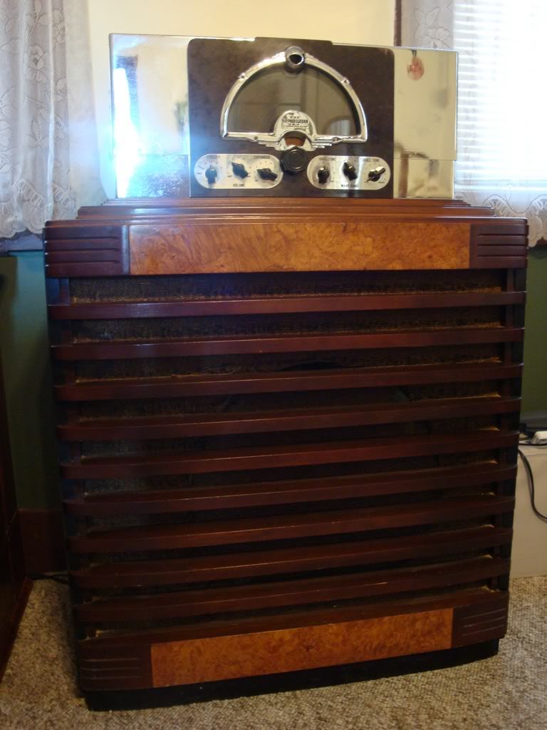

Here's what it will be going into:
[Image: http://www.philcoradio.com/images/phorum..._00002.jpg]
Back view of the Clifton cabinet:
[Image: http://www.philcoradio.com/images/phorum..._00003.jpg]
Yes, that is a Scott Philharmonic speaker sitting in there, too small for the opening. It came with the McMurdo when I bought it. The Scott speaker will be going into my Scott Allwave 23 as it has a Philharmonic amp/power supply.
I didn't want to cut a hole in the sounding board to mount a tweeter separately, since this is such a rare and desirable set. It's bad enough that I'm using modern speakers, but like I said at the beginning of this thread, I'm just not going to pay $6700-9000 + for the original. I can't afford it, for one, and besides, that sort of price for a speaker is ridiculous - in my opinion.

Hey Ron...nice adaptation of modern speakers for a magnificent radio. Why don't these fall into my lap? BTW ...You might want to add a drop of threadlock on the nuts and bolts you're building the coaxial speaker with on the steel spans. I'd hate to have to pull the speaker back out a few months down the road because the vibration worked the bolts loose and are humming now. Regards to all. Gary

I would have used lockwashers as well as threadlock, but your experience may vary.
