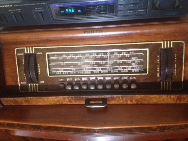

by the way. I finished the messed up escutcheon this weekend. I had a little trouble with the yellow frog tape sticking properly around the edges. but as long as you don't get too close... ;-) I'm happy the brown model paint I used to touch up the missing original paint blended in so well after I sprayed on the clear acrylic. btw, note that the screws holding in the escutcheon are actually Phillips head. I didn't realize anyone used those in 1941.

Bret that looks dang good. I have 3 consoles with the wood grained/gold trim and none are anywhere near that shape. All have badly faded gold lettering and trim. What did you do to restore that? The wood graining touch up I can see but to get the lettering and trim back to some reasonable legibility confounds me...

I ordered the lettering decals from Radiodaze. they were slightly larger than the originals though.
for the touch ups of the missing paint/ink/whatever they used: I used GI light brown from testors. I thinned it out a little bit to cover up the existing lettering on the tone side. the rest of the lettering was all rubbed off. didn't look like Philco put any kind of top coat over the lettering. It may have been sprayed on with a stencil. It looked like the same brass paint they used around the edging. for the edging, I masked it off with yellow frog paint, however, it did not stick very well and the lines are not very crisp. I didn't want to try the green. that faux finish would flake off if you looked at it wrong. the paint for the edging was model master brass. it matched the gold lettering. the paint was a real pain. you have to dab it on, it didn't want to adhere to the metal very well. took a few very careful coats and touch-ups to even it out.
I removed the felt from the back (just had to get the old glue wet). finished it off and sealed in the decals using 3 light coats of Krylon crystal clear acrylic in satin. I took a bit of a gamble trying that acrylic out. I didn't know whether or not it would ruin the faux wood grain. I figured acrylic would probably not affect it but enamel probably would.
I glued the felt back on using aileens tacky glue.
of course, as a disclaimer.. your results may very!

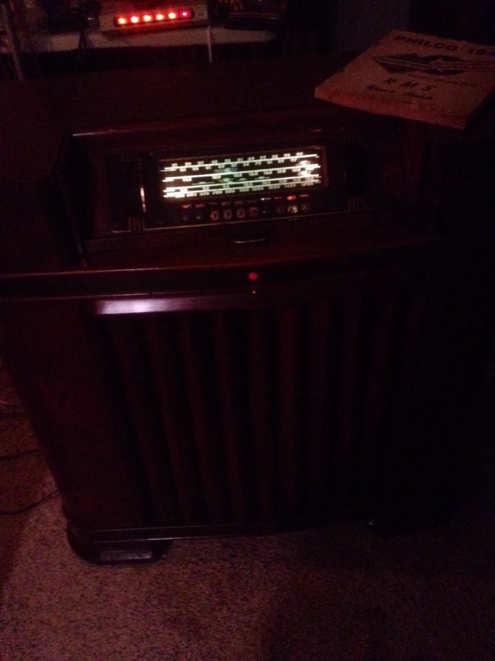

Picture of the 42-400...with the pilot lamp lit nicely. There must be a pin hole on the bottom of the lens or hole as i get a small red dot below the lamp... Running great...with the exception of the old FM dropped and wired for phono (button on the control head). Using the rebuilt phono jack for internet radio etc etc. Tommorow I'll give a shot at painting the escutcheon. I picked the paints up so ready to do it.....

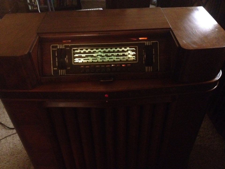

Escutcheon nearly done...Now to a job I have not looked forward to. The station tabs. I see Ron had posted the original font...unfortunately does not work with Mac...at least at this point of digging anyway. Thinking I may just download a scanned sheet, laminate and go with it. I have to look on here too what others have done.
Need to put a coat of lacquer on the plate as well.
thanks again Bret...the painting was tedious and the decals do not match for the far left and right thmbwheels but still far better than what was there...the gold paint matches the decals perfectly.
