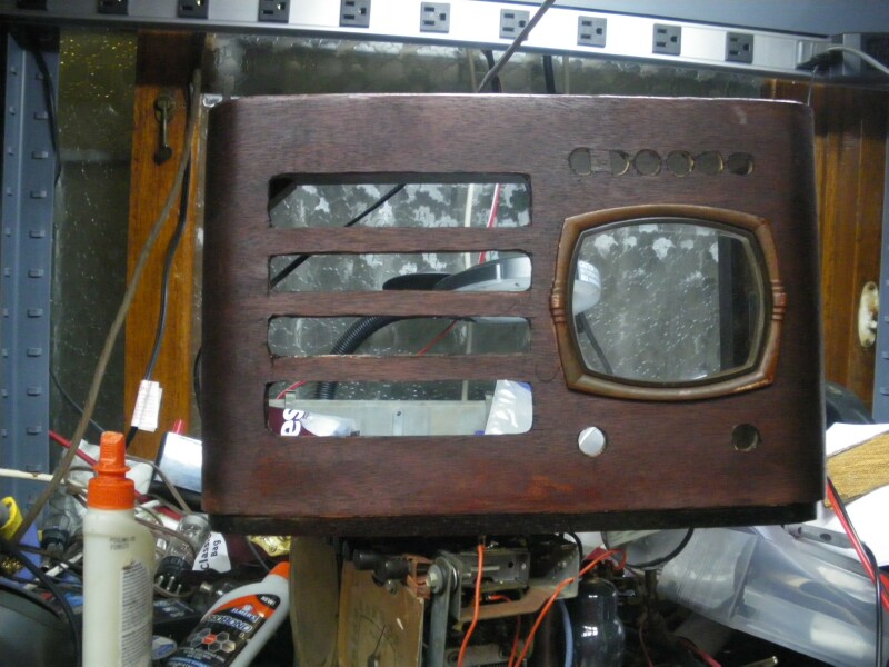

Well.... I fixed the escutcheon, I put a patch piece of veneer between the first two buttons (still needs to be trimmed), cut out the last of the holes for the speaker, painted the base with black enamel (similar to the original), and applied stain to the rest.
*sigh* rather than helping to make the thing look better overall, to me it brings out all the flaws in my work. Icon_sad Tomorrow, I'll trim the patch on the buttons, mask the escutcheon and apply a coat or two of lacquer to the whole thing. When that's all set, I'll try to find all the chassis mount screws and the knobs (which once again I have put in a container in a safe place, safest of all from me.. *g*), and reassemble the beastie.

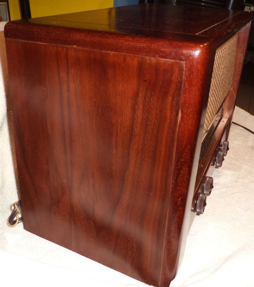

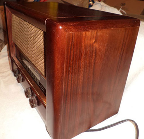

You're welcome Brenda. Here is my first try with their veneer on my 49-909. It was just both sides. No bending and no holes!

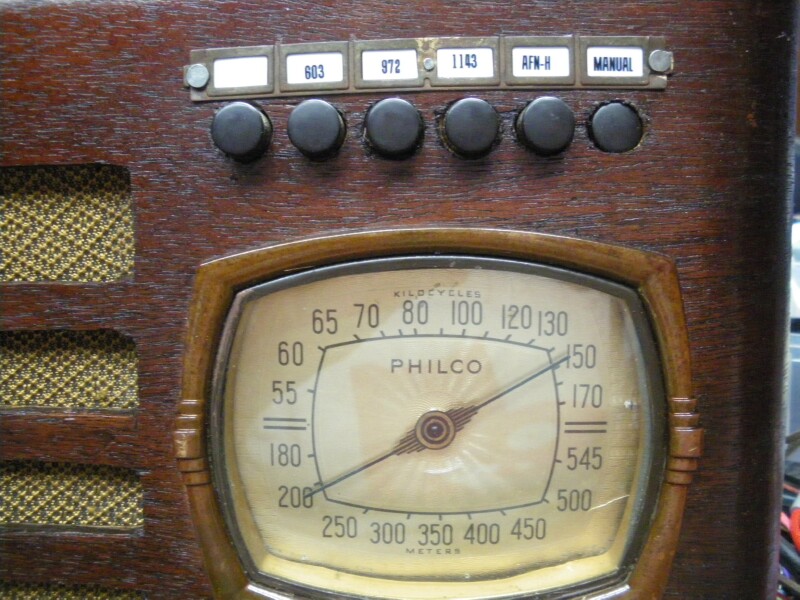

OK. Here it is, warts and all. I've all but finished it, I need now to find some small screws or nails to reattach the trim where the station tabs go. Tonight, I'm going to make some new station tabs, printed on photo paper.

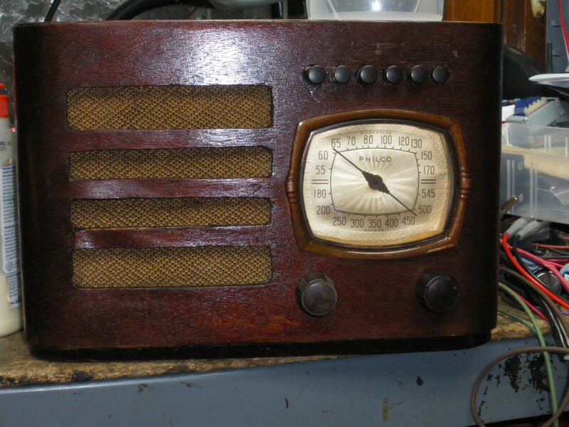

This first pic is with flash. It really shows up the flaws in the application of the veneer.
The second is without flash. The radio looks better in this one. I guess all in all, I guess it doesn't look all that bad. It's for sure better than it was when I bought it. Lots of electronic restoration; replacing or recovering crumbled rubber coated wires, recapping, replacing rubber grommets, replacing antenna coil, two tubes. Replacing dial string, realigning. Lots of fun.
Cabinet work was: Stripping off what was left of the old veneer, regluing the cabinet, replacing and regluing the "bones" that form the curved corners, replacing the grill cloth, applying the new veneer, reattaching trim pieces, etc.
I am not sure how the 39-7 should look.
I have a junked one and the rest of the veneer on it looks a bit smoother than the one you got.
But it is a cute little radio the way it is.
Indeed, the original veneer was a lot smoother. I suppose I should have sanded it with some 300 grit. Live and learn, I guess. Maybe I'll try that later, anyway.
