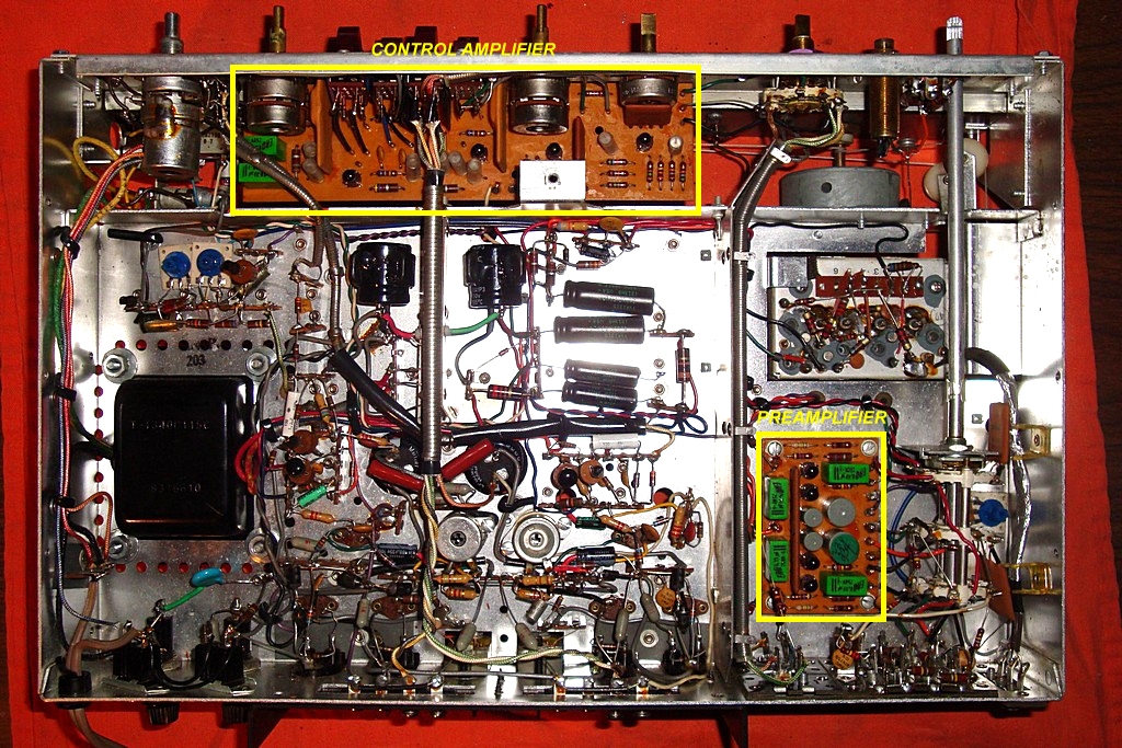

I don't have a photo of the top side of the chassis right now, but here is a clarified photo showing the control amplifier board (where the tone controls and balance control are mounted) and the preamplifier:
[Image: http://www.philcoradio.com/images/phorum...e00007.jpg]
The control amplifier appears to only have a few 1 uF electrolytics, but the preamplifier has several electrolytics of various sizes.
It looks like I can easily unsolder, replace and solder any electrolytics I need to replace on the control amplifier board without removing it from the chassis. The preamplifier is a different story - it would have to be removed to replace components, and it does not look like a fun job.
On top of the chassis reside the FM tuner, the IF board, and the multiplex board. Both IF and multiplex boards have electrolytics on them. Those boards also would have to be removed to service them.
I get it...I need to replace those electrolytics, also...right?

Well, if you have to place another order anyway, you might as well order all the remaining electrolytics. Even if you don't choose to replace them all now you will have them available as needed.
As I recall, those plastic cased electrolytics in the preamp board were the most problematic. They tended to dry out and develop high ESR. The larger ones are in the low impedance feedback circuit and an increase in ESR will cause a loss of gain, especially in phono mode.

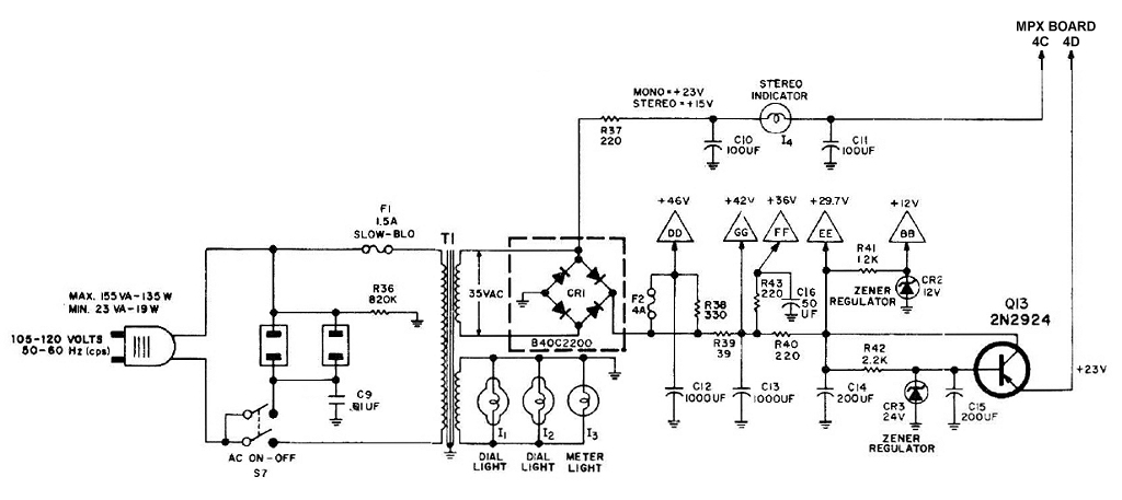

[Image: http://www.philcoradio.com/images/phorum...-T_MPX.jpg]
This is the 440-T multiplex board. Notice one end of the Stereo Beacon bulb connects to point 4C on the MPX board.
Now, the 440-T power supply:
[Image: http://www.philcoradio.com/images/phorum...0-T_PS.jpg]

You should be able to replace the lamp with a LED with a few conditions.
The transistor Q404 just pulls the lamp to ground to light it, but it also controls bias for the demod driver Q403. When the lamp is off (mono) the voltage at Q404 collector is pulled up to +23v, removing bias from Q403 and shutting down the demodulator.
So you need a series resistor to limit the LED current and a shunt resistor to insure that the off voltage rises high enough that bias is removed from Q403. The original bulb drew about 36mA, but you really don't need that much current with a LED. I would try a 1.5 K in series with the LED and maybe a 10K across the combination as a pullup.

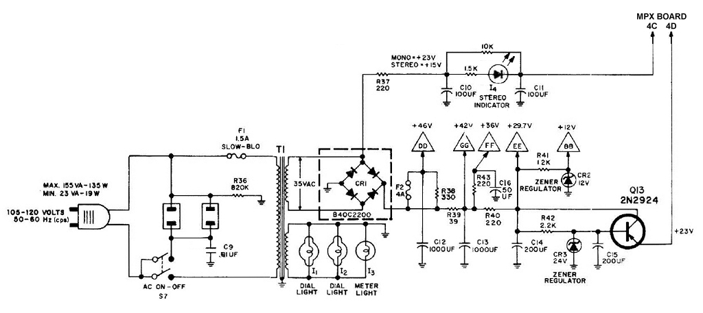

Should the cathode end of the LED go to 4C on the MPX board, with the anode toward the power supply?

Yes, anode to the power supply and cathode towards the MPX board.
The LED is far more sensitive than the incandescent bulb, so it may tend to light up on noise even with no stereo signal. In that case, just decrease the value of the shunt resistor so that more current bypasses the LED and reduces its sensitivity.
Because the LED draws less current, the power supply will not drop as much as it did with the bulb (23v down to 15v) so you may only see a couple of volts drop.
Is this the proper hookup?
[Image: http://www.philcoradio.com/images/phorum...S_rev1.jpg]

Yes Ron, the hookup on your schematic looks good.
