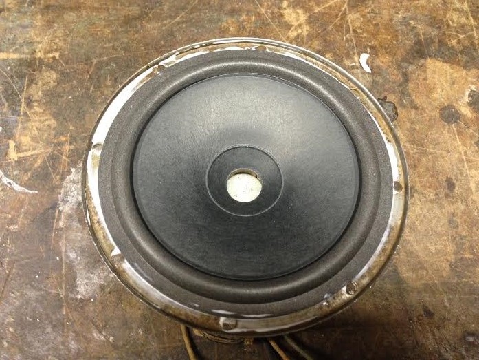

Speaker came with zero cone. I actually re-coned it last night after finding it in a box in a pile under a few totes, in the corner by some raios in the garage. Icon_mrgreen
If I did it right, it should work but I cant test it.
I will try to get it in the mail to you if the ice ever melts. I will include the speaker for the silvertone 45 that I re-coned last year.

(02-03-2015, 09:22 AM)OldRestorer Wrote:  Speaker came with zero cone. I actually re-coned it last night after finding it in a box in a pile under a few totes, in the corner by some raios in the garage. Icon_mrgreen
Kirk
Kirk;
  As long as you slipped some shims, such as some strips of old film negatives, in-between the voice coil and the pole piece before you glued the cone down it should work, that is if the field coil and voice coil are still good.
