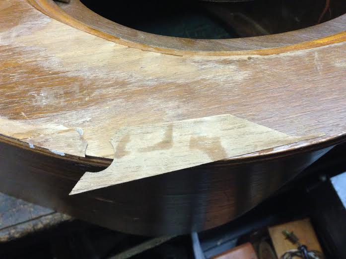

Kirk, are you using the veneer repair method where you tightly clamp a slightly oversize piece of veneer and then sand off the excess?
#34
I think Kirk at some point described his method and it was different. The only oversize is the one outside the external wall (bezel) contour, unless you mean this oversize.
#35
Yes,
I am trying this method since it is the face of the radio. If it works well, good!
If not , it is Mikes radio so what the hockey stix do I care!
Kirk
#36

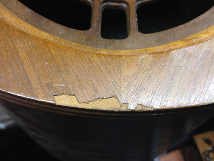

Please take some pictures before the sanding; that's a technique I've been wanting to try.
#37
Will do!
Kirk
#38
Unclamped, sanded with block, and they look pretty darn good!
Toner will hide all the little imperfections.
A few more repairs and the face is DONE!
Here are the pics:

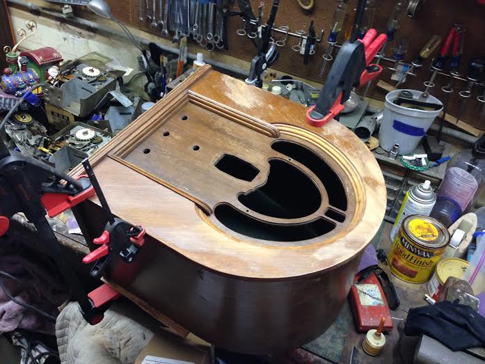

#41
Almost done with the face.
Gluing number 5 today and a last one tomorrow if I have time.

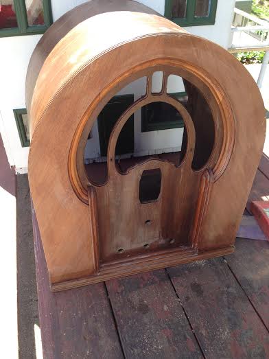

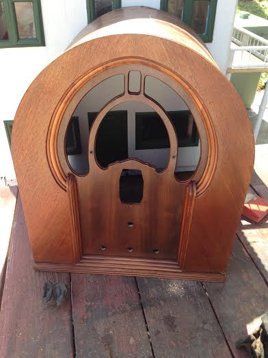

Face is done and stripped.
The stripping was a pain. For some reason the thinner was not working.
Had to sand most of it off.
Next is to re-attach the arch to the front and then try to repair all the veneer and the gouges and the punctures.

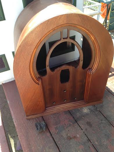

Any ideas on those?
I will try water and the heat gun first to see if I can get any to raise.
Here she is now.
#44
Looks like new. New unpainted IKEA furniture Icon_smile
#45
I could always paint it. That would make the repairs easier. Could use wood filler all over and give it a nice white and black lacquer finish.....
Should I? could I? Would I?
