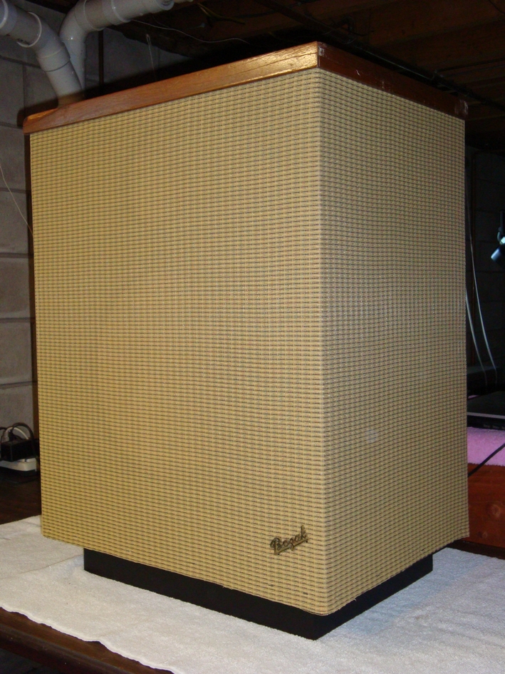

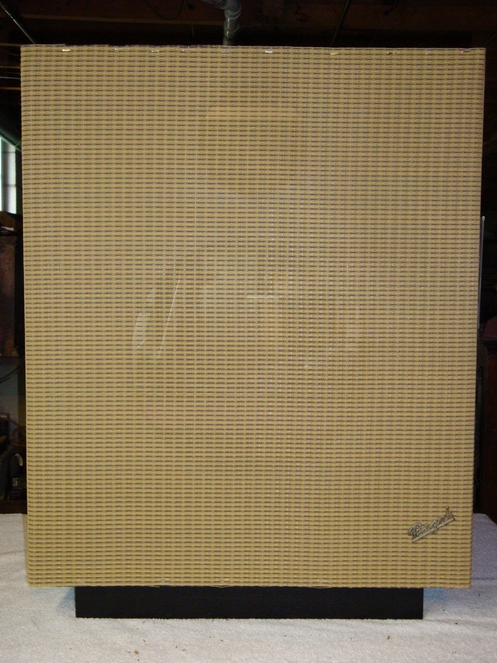

not helped by the fact that the new grille "cloth" is actually made of plastic fibers that resisted bending around sharp corners...
but the cloth is on one cabinet.
[Image: http://www.philcoradio.com/images/phorum/bozak_019.jpg]
[Image: http://www.philcoradio.com/images/phorum/bozak_020.jpg]
The old top is shown here on this cabinet to give an idea of what it is going to look like when finished.
Mistakes:
The cloth is uneven at the top...and you can see it in the photos above.
And when I went to cauterize the holes for the Bozak nameplate, I didn't get them exactly on center. So, if you look from underneath, you can see the two holes in the cloth under the studs that hold the Bozak nameplate on. Fortunately, that mistake can't be seen from above.
And to top it all off, that was the Bozak nameplate that was broken...and it broke again. You can't tell in the photos above, but it is broken in the photos; I just have it lined up properly so it isn't too noticeable.
Oh well.
I still think it is looking better than it did with the previous cloth...and since this cloth is more acoustically transparent (open weave), it should sound better.
One down, one to go...then the tops and trim...
I failed to mention that the old top/trim no longer fits well over the top of the cabinet with the new, thicker cloth - I had to press them down in place to take the photos above.
I looked at the new tops today, and I am definitely using the new tops instead of the old ones. The new ones are microscopically larger than the old ones...by tiny fractions of an inch...and because of the new, thicker cloth, that is a very good thing.
I'm calling it a day. Tomorrow I plan to start cutting trim to size and, hopefully, will get the cloth on the other cabinet as well. Then I'll need to glue trim to new tops...stain new tops/trim and bottom trim pieces...apply finish...add grain filler somewhere in there...if all goes well, these babies might be finished (or nearly so) next weekend...

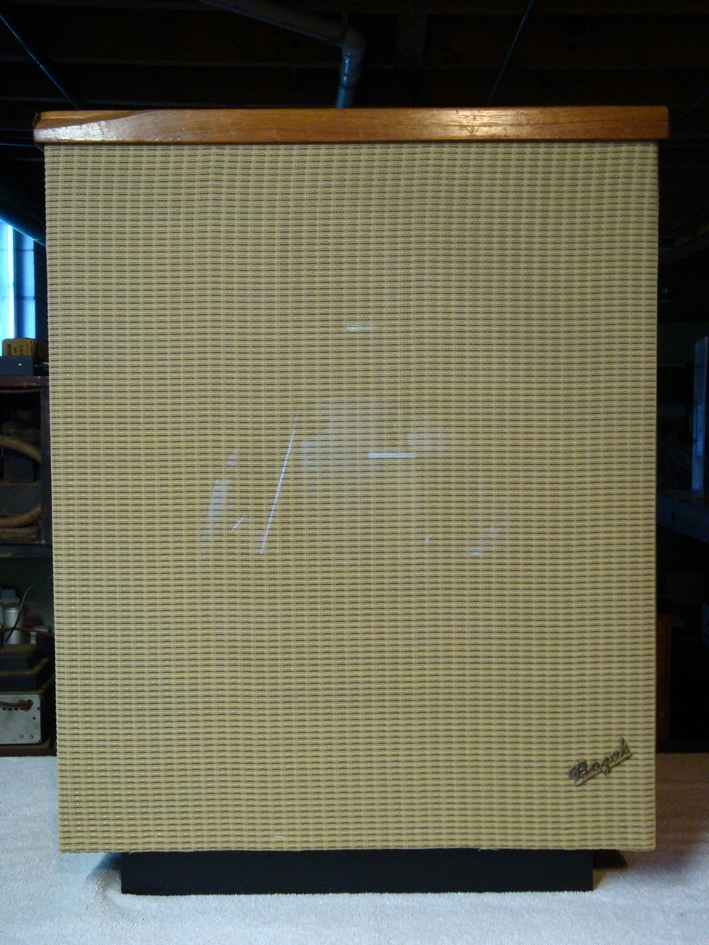

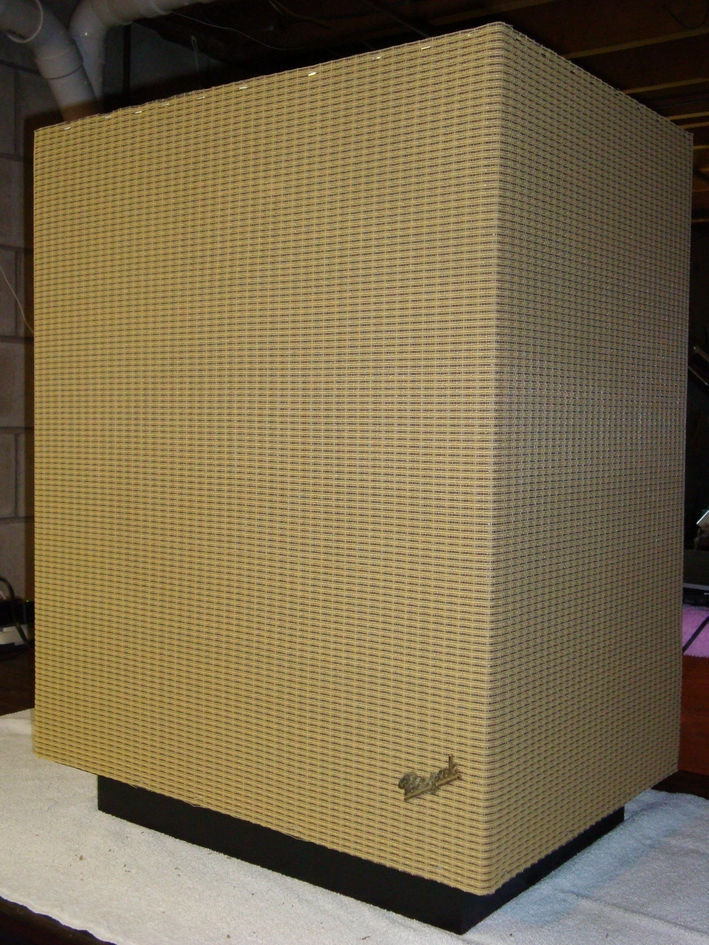

Installing the cloth on this cabinet went much smoother. There is only a very slight misalignment of the cloth at the top edge, and most (if not all) of that will be hidden from view once the tops and trim are in place. This time, I think Debbie and I both knew what to expect, and worked accordingly.
Cauterizing the holes for the Bozak nameplate went smoother as well. I made a slight error on the first (lower) hole, but the nameplate hides the error. The second (upper) hole went perfectly.
Slowly, these are transforming back into the nice speakers they once were circa 1957-59.
