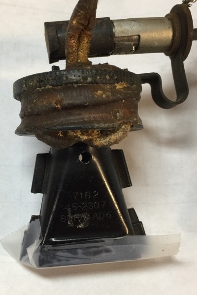

Got the bulbs. Next question... the insulators for the tuner are a blob of hard plastic. Are they for mechanical isolation/cushions or for electrical insulation? Where is the best place to get them from? Anything else in general supplies that supplier is good for, since that is the only specific thing I need?

http://www.renovatedradios.com/parts.html
Scroll down to rubber parts. Measure the size of your old one to be sure of proper replacement.

Terry,
My old one is a blob of black junk. Can't even be sure where it fits.
(Another Terry)
TerryMSU
#37
Found the correct one. This is not a round one, but rather rectangular and black. Part number PHS38-10. Ron verified it in a PM I sent to him.
