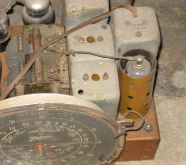

Well, I kind of liked the look of it.. But however .. Another problem cropped up...
The Radio will motorboat at approx 1/2 way on tuning.. For a very small area.. This is on AM band. I do not think it does it on the other bands But I will check..  Also saw this on top of tuning cap that goes from cap to the 6A8 tube..
Doesn't quite look right..
[Image: http://i292.photobucket.com/albums/mm38/...ol1rig.jpg]
[Image: http://i292.photobucket.com/albums/mm38/...k3vssw.jpg]
The wire marked L doesn't go anywhere.. Only wraps around other that goes to Grid of the 6A8..
Does the 6A8 Need a shield?
Skip...
#36
It should have a shield and there is a shield clamp around it..
See Pic...

I believe the wire is a gimmick wire that you asked about that does not connect to anything. Here is a thread about it on a philco.
http://philcoradio.com/phorum/showthread.php?tid=655
#38
I don't think that the 6A8 , [in the first photo] needs a shield as it is metal. please correct me if I am wrong.
 If all 6A8 tubes are to be shielded I will do that in the future.
 Dan in Calgary.

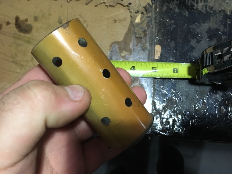

I dont know about the metal ones but the glass is original for the set and does need one.
I would like to know too now, Icon_e_geek
This is the shield if you want it just to have a complete chassis...
4" tall x 1 3/4 wide and fits perfectly over my 6A8
Message me your address Skip..
Icon_smile
#40
Regarding the shield if you are using a metal tube and pin 1 of the socket is connected to chassis ground then all is well. Metal tube w/pin 1 not connected to ground needs a shield. Glass tube needs a shield.
Wire L like Mike sez is a gimmick capacitor. In this circuit it's used the couple a little bit of signal from the local oscillator into  the input of the mixer.
