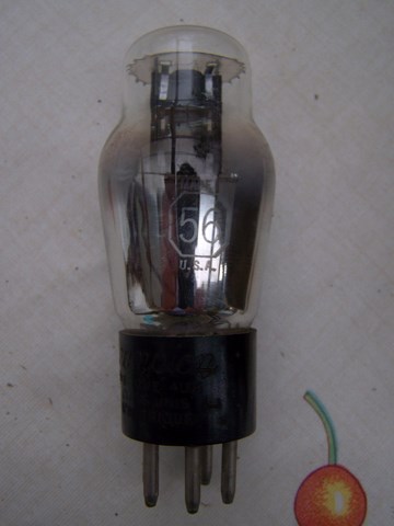

I checked my reading , could be I made wrong one , but not , the tube is really a 56 one .
Sure it has been put there when intervention manipulation , but wrongly by the operating people . Unfortunately , this kind of mistake can be often noticed in old radio sets .
#33
http://www.radiomuseum.org/tubes/tube_56.html
This is what the 56 is.
Pin-wise it is the same as 37, but the Vf is 2.5V so it will either burn out, or take down the transformer's winding as it can withstand much more current and will draw way more current than the winding is capable of.

#35
As the only triode in the chassis, this 56, I suspect, could be the detector (diode connection) and was put there instead of 37, which is, what I think, should be there.
What do you think, Ron?
PS. Looking at the photo of the underchassis - yes, one could see how both the cathode and the plate are riveted to the chassis, so yes, it is the detector and should be 37.

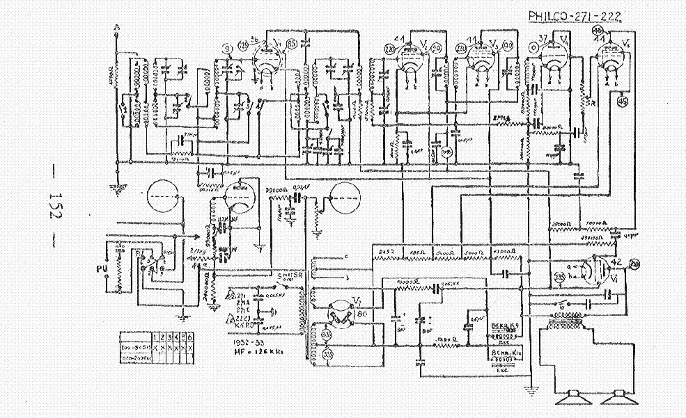

I believe what you have is a model 223, not a 71.
You can find a schematic here (not very good quality but better than nothing):
https://elektrotanya.com/philco_271_222_...nload.html
There is also a partial schematic shown for versions with a phonograph pickup.

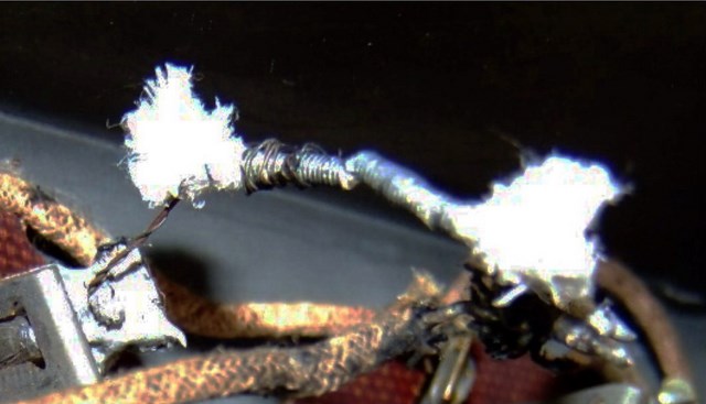

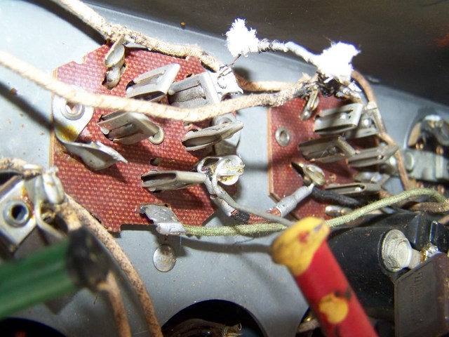

really , indeed , no , not to plug a hole . but as a lamp replacement
I checked under the chassis .
in fact the 56 has been set there, I suppose ,  as replacement of the right lamp , but, we can say ,  correctly .
You can see on the followig photo, one of  the  6.3 V ring wire is not directly connected to the lamp socket , but via a small wired resistor on a steatite rod, so  placed there to absorb the 3.8 exceeded voltage .
you can see this resistor  beetwen the  two white " tassels " on the photos )
It appeared that tis resistor is cut , not burned it seems , but just brocken .
If the radio was used innthat configuration , the limited consumption of this fitting limited the current of the 56 heating at normal valu , so 1 Amp , so only 700 mA more could be with the rignt lamp ,  instead of 2.5amp if the 56 were connected directly to the 6.3 Volt , so possibly not enough to overload the 6.3 V transformer output .
Perhaps also the 56 were under heated , using a resistor of more value il the calculation was made to maintain a 0.3 Amp consumption
#41
Yeah, I was about to ask if there is some dropping resistor, but then I did not see it there, (given the size and the resolution of the photograph, though there was something there...whitish), plus it would need to dissipate quite a bit of heat (3.8W, that would require a 10W-capable resistor there, which is quite large) so I did not think they would do that.
They probably did not have a 37 so this is how they worked around the problem.
The sch shows 37, so I would restore the circuit to the original and buy the 37 tube.
