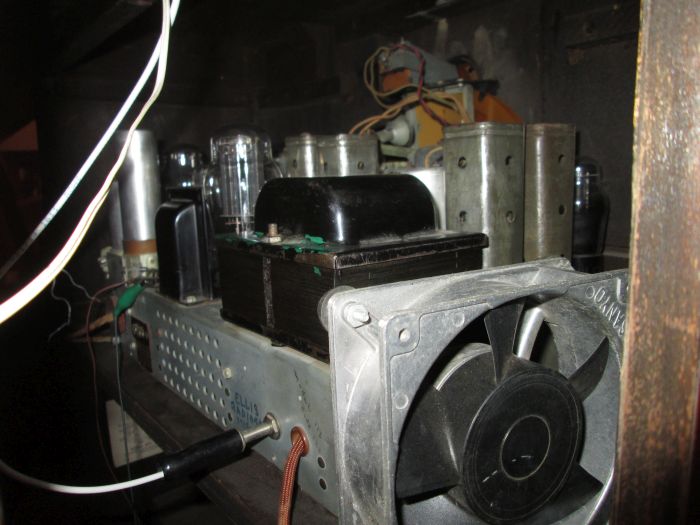

A new development. When I measured the coils and transformers, specifically, the main TXFR, the secondary was a little off. It now measures 92.5 ohms. It should measure 125 ohms.
I had noted some wax that looks like it came out of the TXFR.
It runs very warm after about an hour or two. Icon_cry
How warm is too warm?
Unfortunately, I can't measure the secondary voltage. Paperwork states it should read 830v on the secondary. My meter won't go that high.
I currently have it running off of my variac at 100v. I also have a bucking TXFR or step-down TXFR that puts out 108v. It still gets very warm, but not as bad as straight from the wall, which is 120v.
Would appreciate some input: Should I consider replacing the main TXFR? Icon_question

Compare it to a xfmr from a similar radio (similar size xfmr and similar power requirements) while running for the same time. Transformers do get quite warm. But not very hot. However a real turn short (or many turns) will have a noticeable effect on the output voltage: if it is not there, then the xfmr is ok, and you might want to look at the load.
#40
Mine run a bit warm too. If it keep it on for more than several hour the fan comes on. Line here is about 118v haven't used a bucking trans to lower the input voltage. Because of it's current @ 165w would need about 12v 2A transformer.

I had been running it with my Variac with it set at 110v, and discovered after measuring, that it was actually putting out 120v at the 110v setting. Icon_wtf
I decided to try running it on my step-down or bucking transformer, with outputs 108v. It seems to do OK on that, but still runs hot. Icon_cry
I did run it for about 1 1/2 to 2 hours last night for my annual Radio Show party, and it performed fine Icon_thumbup , but still very warm.

(10-19-2017, 09:01 AM)morzh Wrote:  Compare it to a xfmr from a similar radio (similar size xfmr and similar power requirements) while running for the same time. Transformers do get quite warm. But not very hot. However a real turn short (or many turns) will have a noticeable effect on the output voltage: if it is not there, then the xfmr is ok, and you might want to look at the load.
What kind of difference in output voltages should I be seeing? Running it at 108v out of my bucking transformer, I measured about 725v to the plates of the 5Z3, where the paperwork states it should be 830v. Which seems odd to me. If the resistance of the secondary is low (92.5/125 ohms), I would think the voltage would be higher on the output, not lower.
As a side note, I had forgotten that my step-father gave me his old Micronta analog meter, which is capable of handling 1000v, so I was able to test the secondary output voltage. My digital, I was worried I might top the 750v max and blow it.

Hi Jeff,
You might want to measure the AC voltage from each of the small pins (plate) to the chassis w/o the 5Z3 in the socket. Voltage should be half of what you see from plate to plate + the 400 ohm tapped bias resistor. The important part is that the two voltage (from each plate to chassis) are pretty equal by a few volts. If you have a large difference then I would be thinking about a PT.
By measuring the resistance of the winding from the center to each end doesn't tell you much as one side is always longer than the other.
