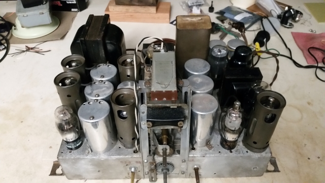

Here's a quick shot of the chassis after reassembly. I left the dial scale off for the time being to keep it safe.

Well that wiring check was worth the effort. I plugged in today, and instantly the valves were warm, there was some hiss from the speaker, and a loud buzz report when the #77 valve's top cap was probed.
Twiddling the tuning cap changed the noises.
I turned up the volume
I attached a 2ft clip lead to the antenna terminal
Stations - lots of them
Madam 16X lives again!
