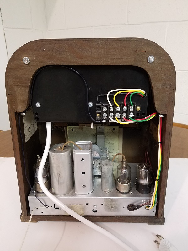

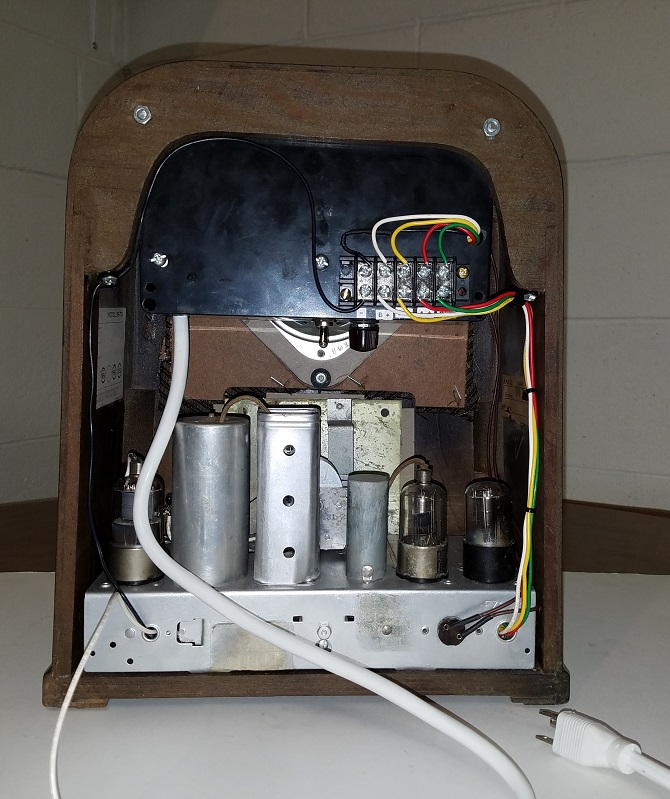

It took a lot of finagling to get everything to fit inside the enclosure box I got from Amazon:
https://www.amazon.com/gp/product/B06XSQ...UTF8&psc=1
But I got it all in, plus added a toggle off/on switch and an indicator lamp.

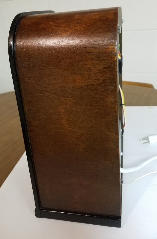

Best of all, it fits nicely inside the cabinet!!
It's even flush with the back of the cabinet too:

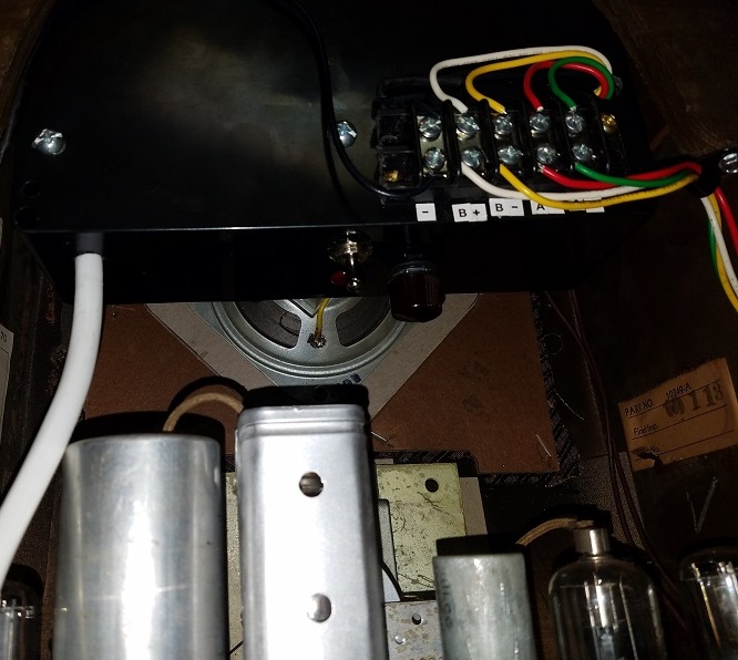

Here is the bottom side of the box showing the toggle on/off switch, light and potentiometer to adjust the A voltage:
You need to use a 3 prong plug and connect the ground wire from the radio chassis to the ground wire in the cord to eliminate buzz (unfortunately I only had a white colored cord on hand but that's a minor detail).
I'm very pleased with with this power supply and would recommend it to anyone who wants to convert a 90 volt "B" / 1.5 volt "A" battery powered farm radio to run on AC.

I should also mention the speaker in the radio is a smaller diameter replacement 4 ohm permanent magnet speaker I had on hand. The original was blown... the cone was bowed outward and it had no volume. Because the replacement speaker is not quite as tall as the original, the box fit nicely in front of it in the cabinet. With the original speaker you may have to leave the cover off of the power supply box to get it to fit in the cabinet (if you use the power supply in a 39-70 cabinet). Of course, if you leave the box outside the cabinet, it's not an issue... plus you'd have the option of using it for other battery powered radios as well.
