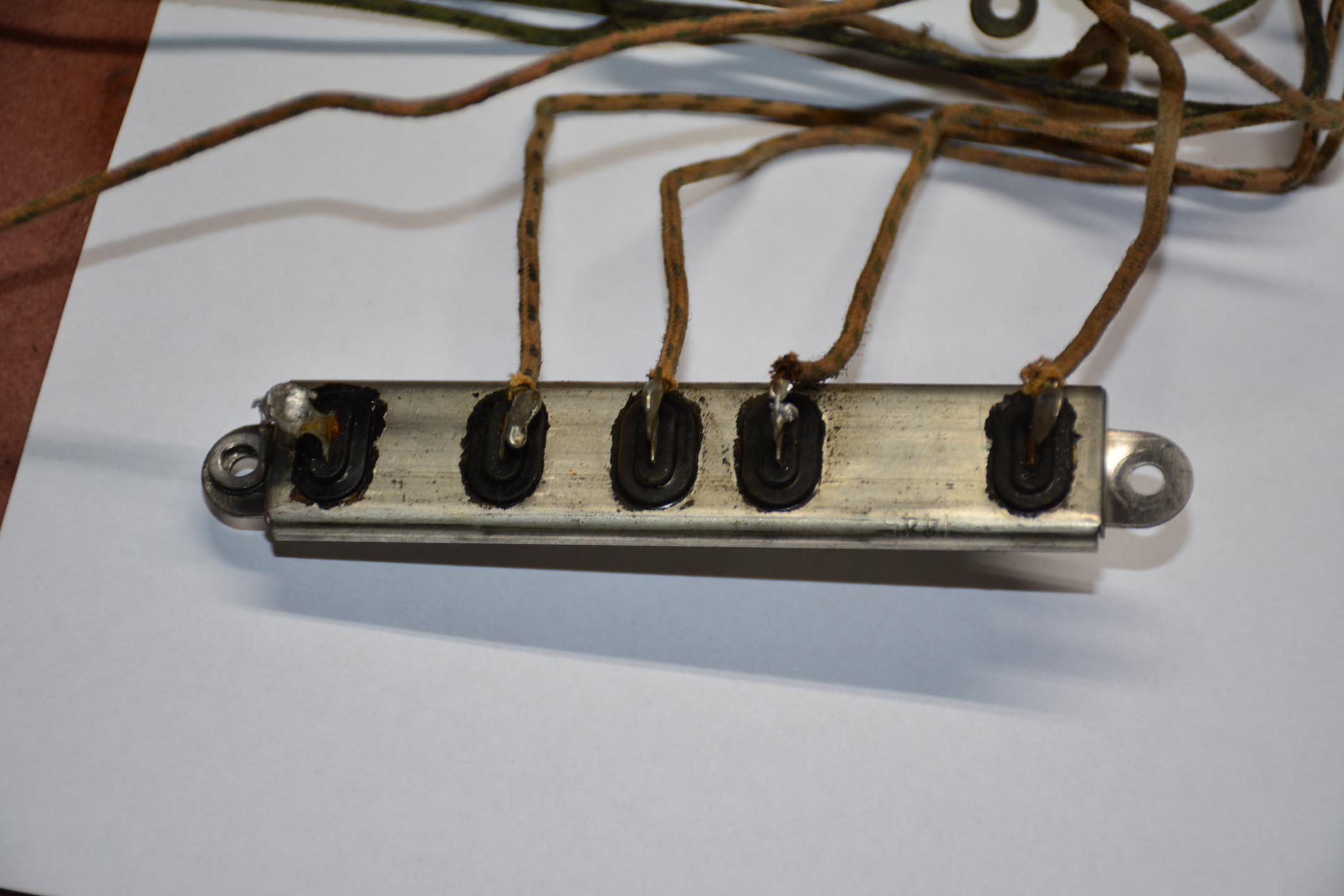

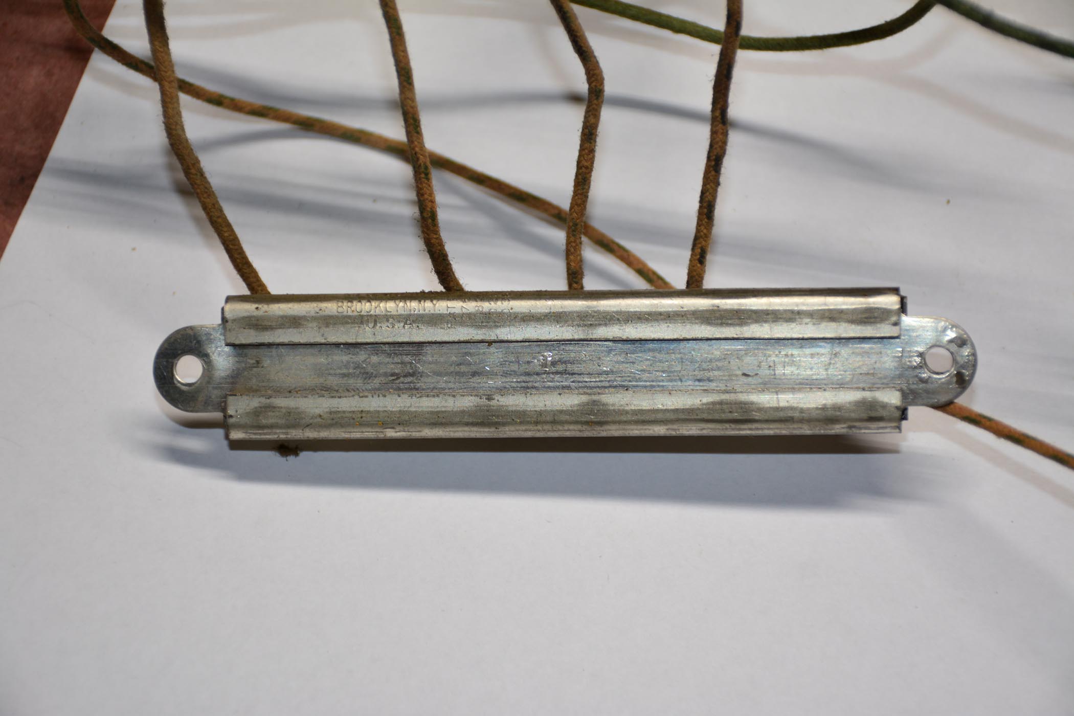

This one doesn't have the normal seam to get a knife through to cut the windings. My concern with using the good sections are the very connections you mentioned. As you say, the taps are pressed onto the resistance wire, leaving the great possibility of future failure at the remaining crimped connections. The more I consider it, the more inclined I am to disable all sections and use the taps as terminals for the Dale resistors that I have ordered. Disabling the sections will require taking the candohm apart and then bending it back together, as you can see in the photos. Not a big problem, just need to be sure the terminals are well insulated.

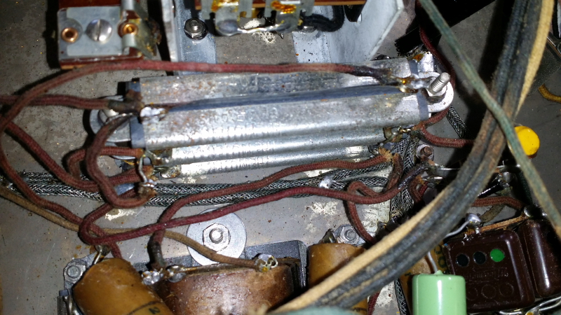

Here is a picture of the stacked candohms in a strat for comparison (seam at the top). In this case the replacement WW resistors are hidden between the stacked originals.
This is a "before" picture.

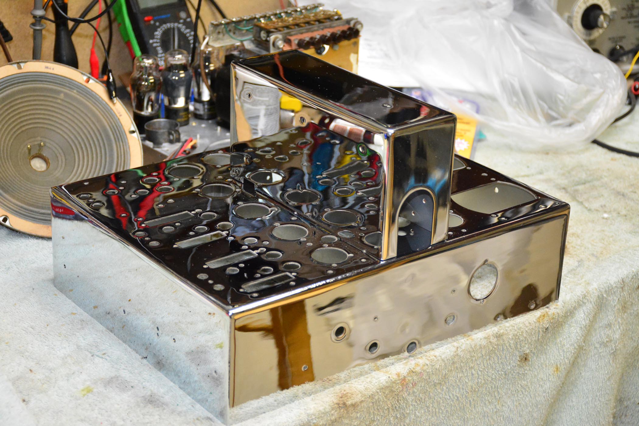

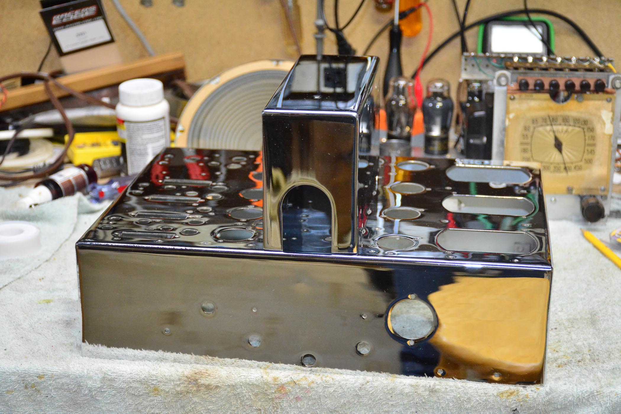

That is pretty, I would be afraid to work on it!
Posts: 1,222
Threads: 50
Joined: Oct 2017
City: Allendale, MI

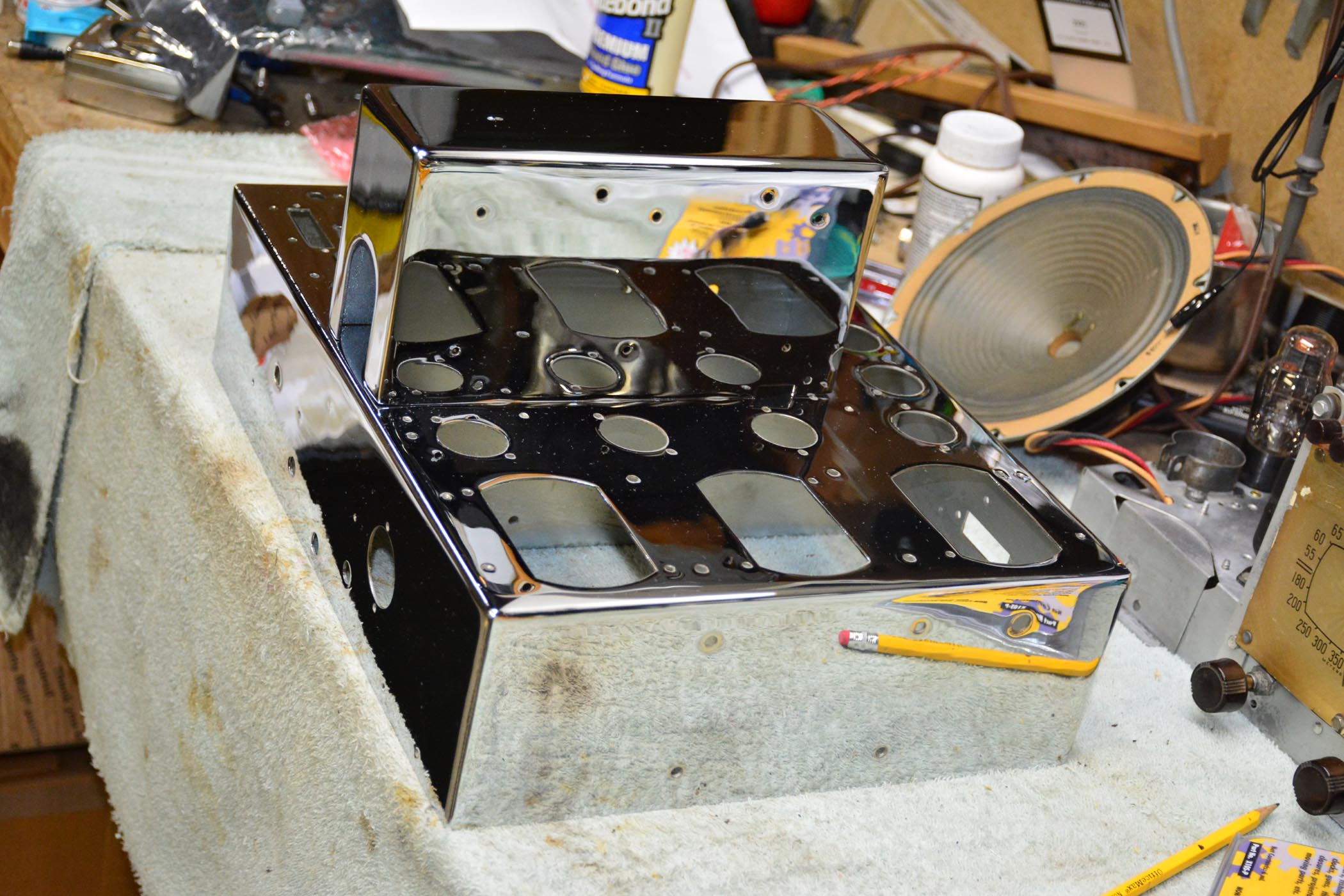

Yes it is! My biggest concern is scratching it during the riveting process.
Posts: 2,118
Threads: 112
Joined: Jun 2010
City: Medford OR (OR what?)
Hit that sucker with a hammer - HARD! Just don't miss the rivet.
I have a piece of foam that I put on the bench to work on these. But, you need a dense, hard surface to drive the rivets. I have an old delta table saw with a SOLID steel top, great for pounding rivets.
