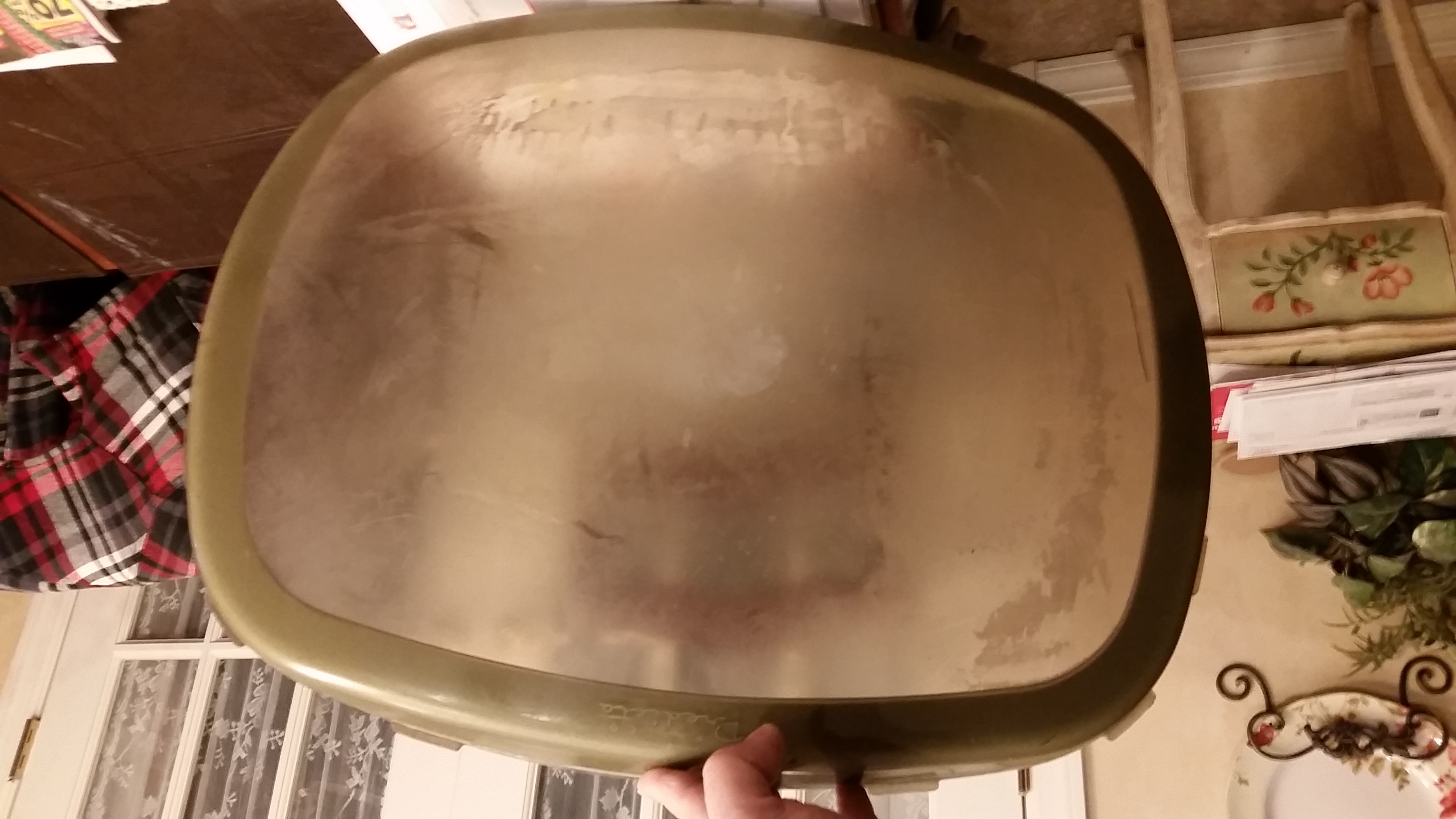

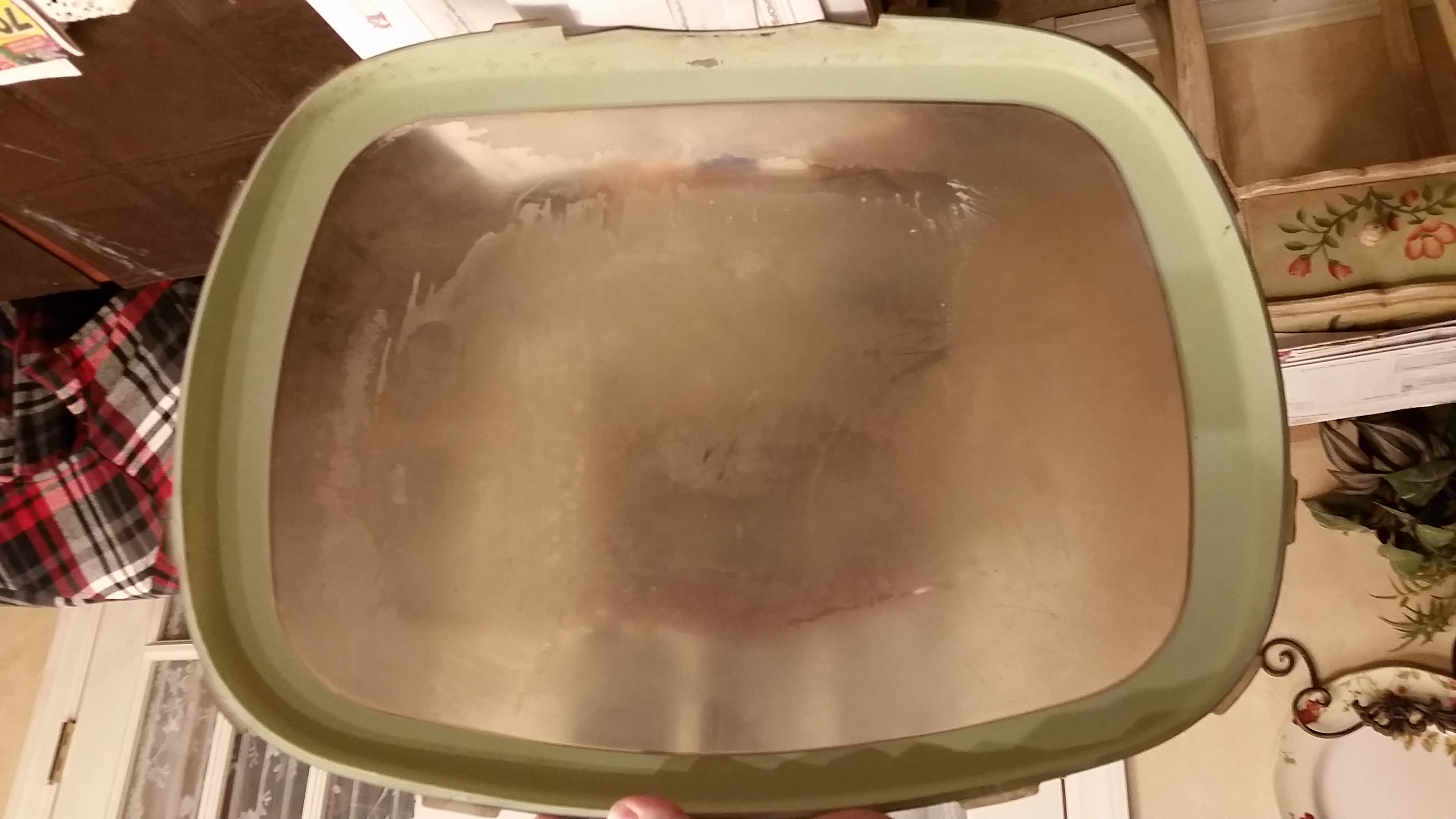

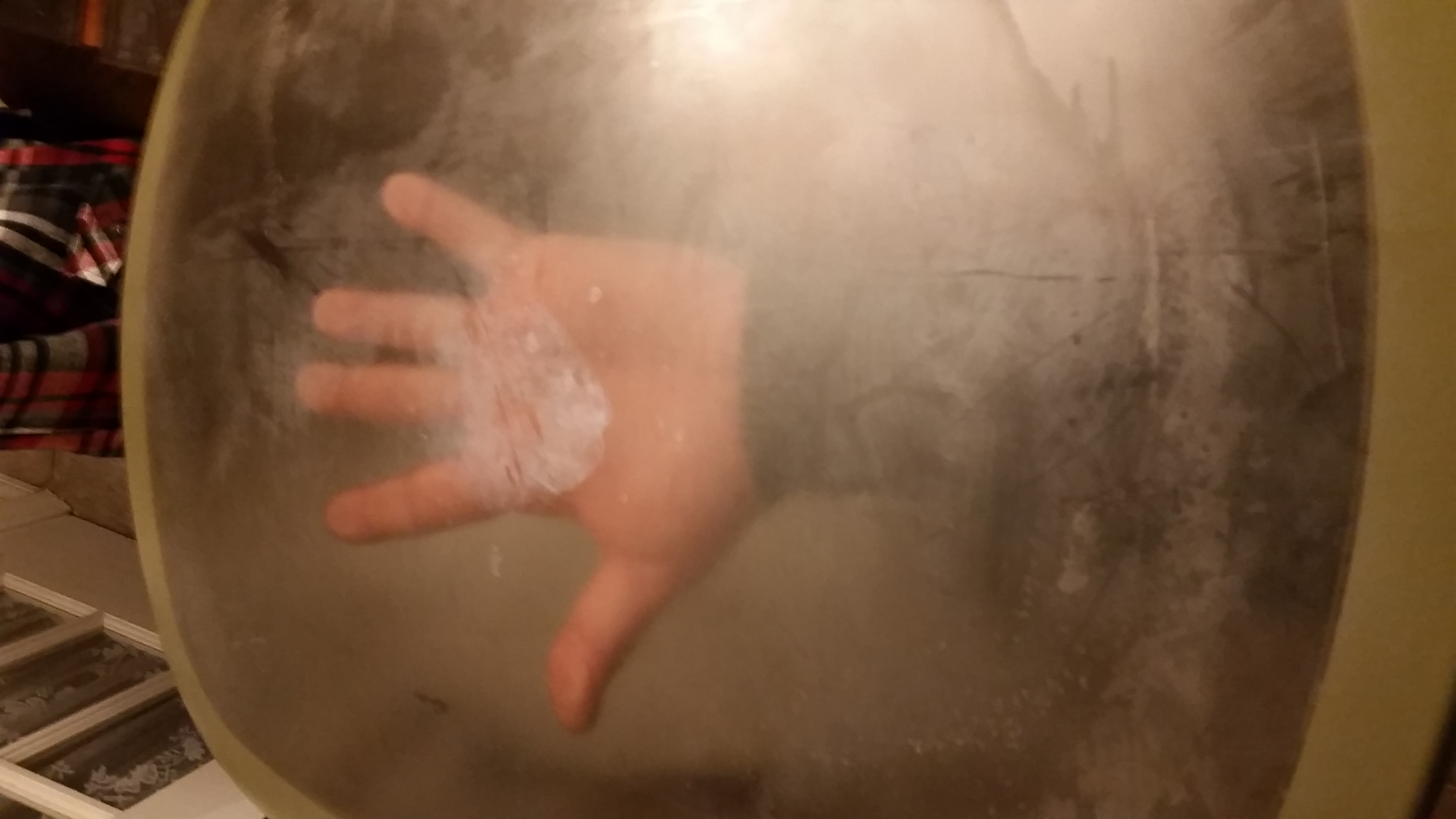

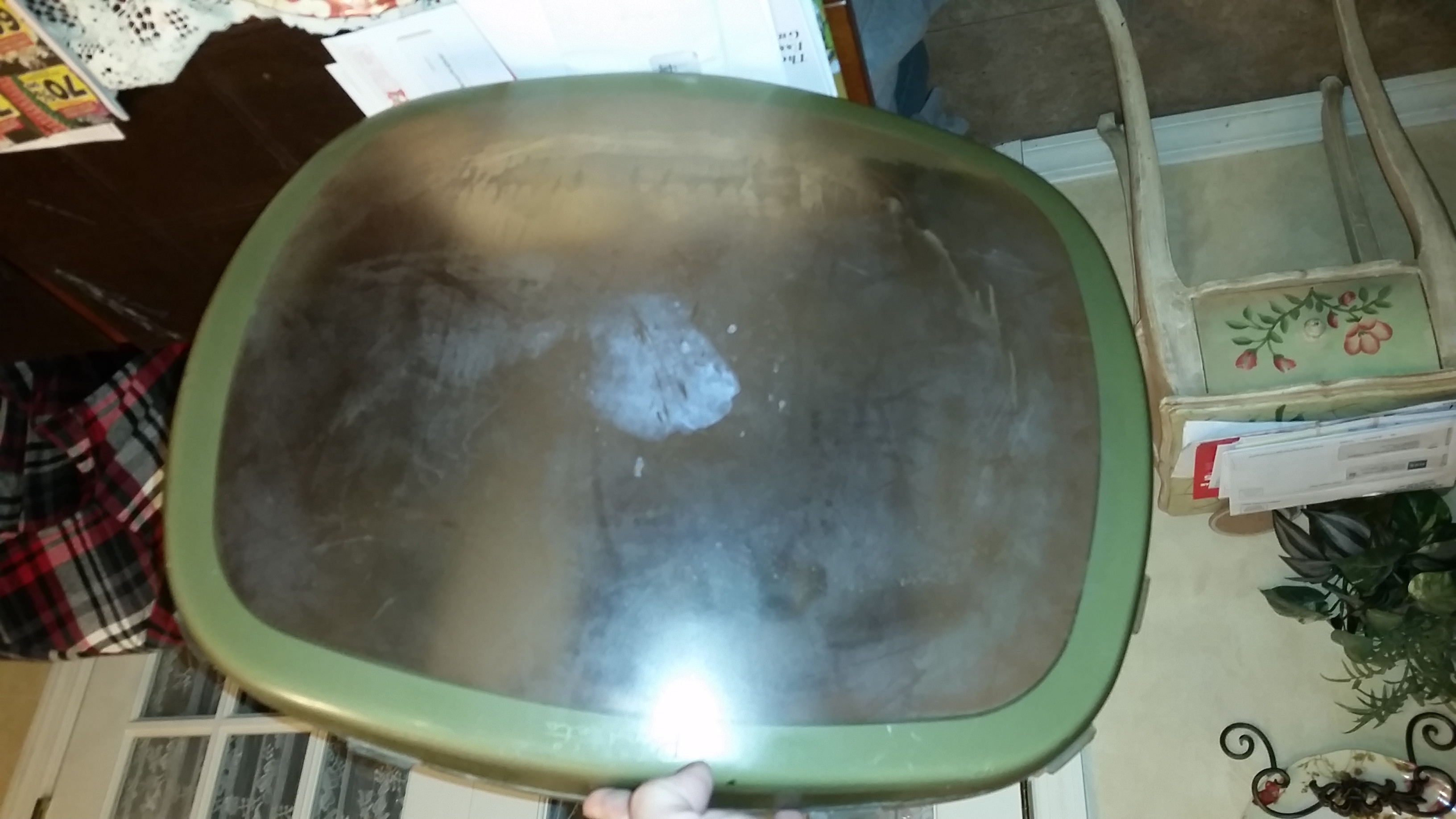

I'm actually picking up a 17 inch Predicta tonight, and possibly a 21" table top next week, Ill let you know if they smell too. Also I work for an electrical company and we often have to get replacement lenses made for weather proof outdoor light fixtures. Usually all they need is a sample, sometimes we bring them 2 halves and they make us one solid one that's identical. I am going to see if maybe they can do my screen cover. Heres what My screen looked like before cleaning.... I have to put some after pics up tonight.
