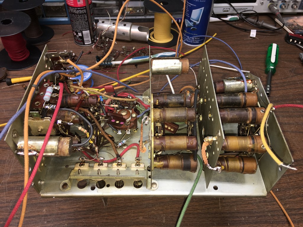

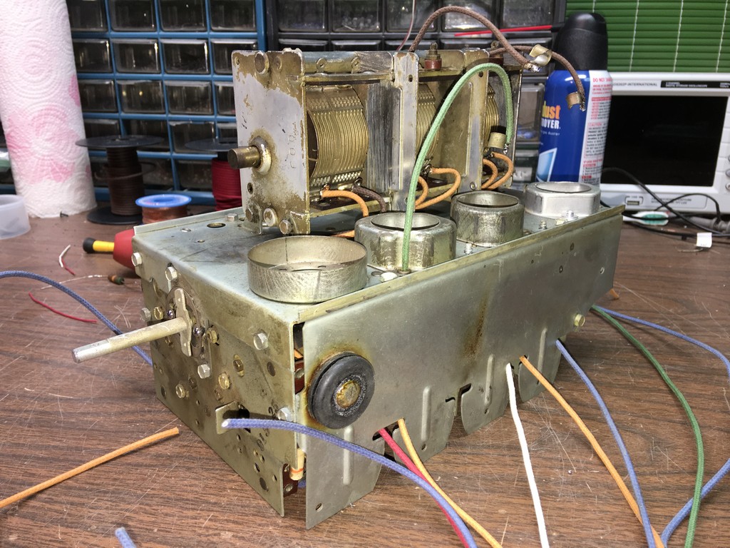

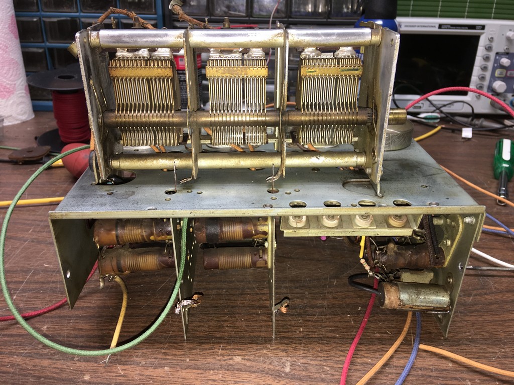

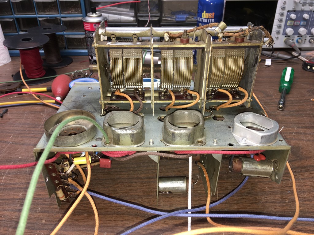

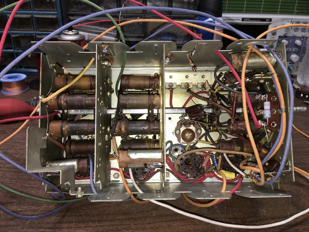

Time to reassemble the RF unit.
After working for 2-1/2 hours, it was mostly together again:
[Image: http://www.philcoradio.com/images/phorum...90_081.jpg]
[Image: http://www.philcoradio.com/images/phorum...90_082.jpg]
[Image: http://www.philcoradio.com/images/phorum...90_083.jpg]
[Image: http://www.philcoradio.com/images/phorum...90_084.jpg]
I still need to replace the two grid cap leads which you can see in the third and fourth photos, attach a grid cap connector to one green wire which is already in place, reattach the sides, install the band switch shaft, and put the whole thing into the 38-690 tuner chassis.
Getting closer...

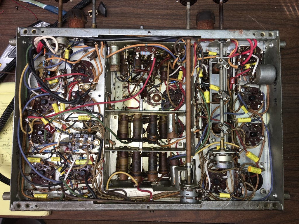

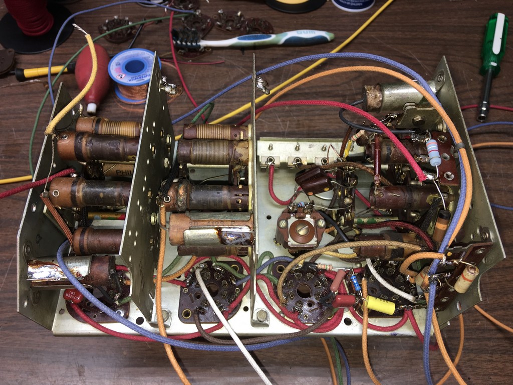

Nevertheless I still had enough time this evening to put the finishing touches on the 38-690 (formerly 38-116) RF unit:
[Image: http://www.philcoradio.com/images/phorum...90_085.jpg]
[Image: http://www.philcoradio.com/images/phorum...90_086.jpg]
[Image: http://www.philcoradio.com/images/phorum...90_087.jpg]
It will be connected to the 38-690 tuner chassis tomorrow evening, most likely, barring any more downed tree limbs - it's past my bedtime as I type this and I can hear thunder again

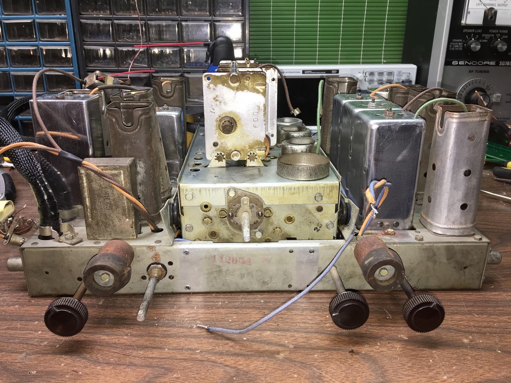

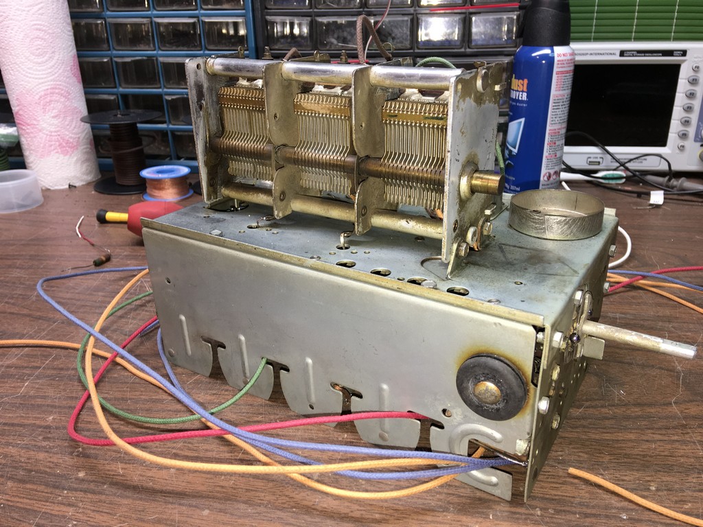

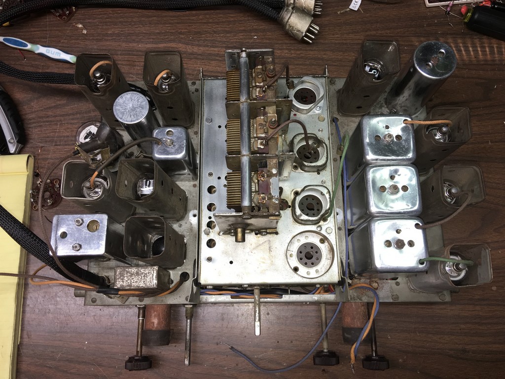

Silly me...I thought I would have time to install the RF unit into the tuner, set everything on the bench, and try it out tonight.
Not so - the RF unit took longer to finish up and install than I thought it would.
First off, I discovered that I had forgotten to attach two wires to the RF tube socket in the RF unit; this was soon taken care of.
After two hours or so of work, the RF unit was in the tuner. I went ahead and mounted it in proper rather than trying to connect it loosely.
[Image: http://www.philcoradio.com/images/phorum...90_088.jpg]
[Image: http://www.philcoradio.com/images/phorum...90_089.jpg]
[Image: http://www.philcoradio.com/images/phorum...90_090.jpg]
I not only went by the other RF unit and my notes to make sure each of the 16 wires was properly connected from the RF unit to the tuner, I also double-checked by comparing the wiring to the schematic. All is correct.
So...tomorrow, I will find out if this RF unit is going to work correctly. With all coils having good continuity, theoretically, it should. But the other RF unit had good continuity on all coils also. We shall see.
