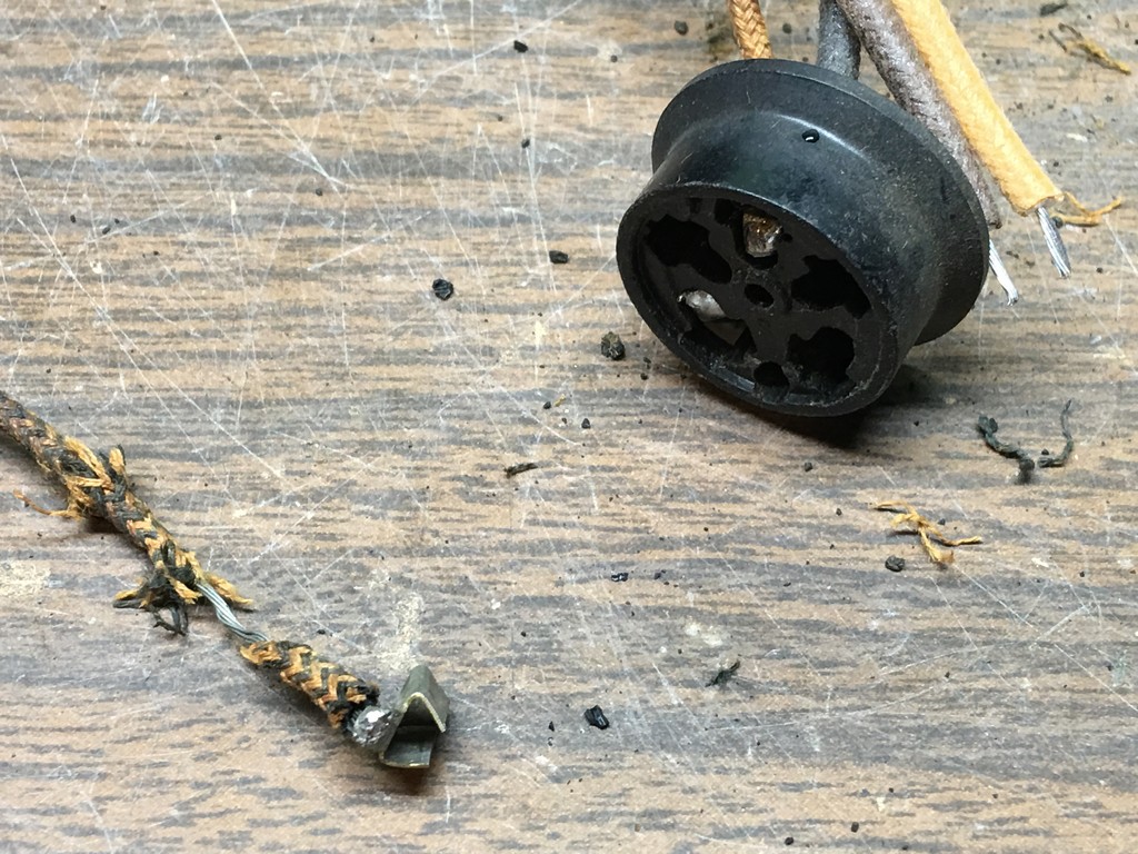

Take a good look at the RCA's speaker cable.
[Image: http://www.philcoradio.com/images/phorum...-5_021.jpg]
Someone cut the original speaker wires and substituted AC zip cord for the original wires, joining them at each end with wire nuts and electrical tape.
I want the speaker cable to look original. So let's do this over and do it right.
You can see the new speaker cable in the background of the photo above.

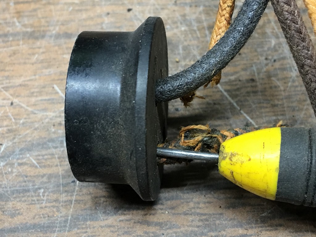

The hardest thing to do is to remove the insulator from the end of the speaker plug. That is, it is usually the hardest thing to do. Removal of this part often involves drilling out the center rivet and when finished, resorting to glue to hold the insulator in place when finished with rewiring the plug.
Fortunately in this case, though, both insulator and rivet merely popped off...

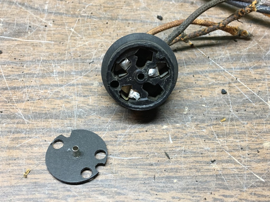

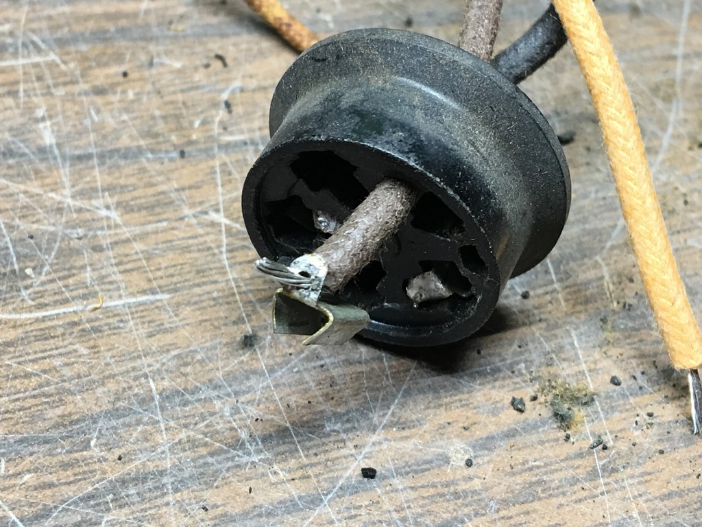

So now we need to get the connectors out of the plug.
You should do one wire at a time so you do not get confused on which wire goes where.
I found that using a tiny screwdriver to push the connector out of the plug worked fairly well.
[Image: http://www.philcoradio.com/images/phorum...-5_024.jpg]
Be careful doing this. There is a chance that you could break off the solder tab of the connector.
Once pushed free of the plug, things look like this:
[Image: http://www.philcoradio.com/images/phorum...-5_023.jpg]

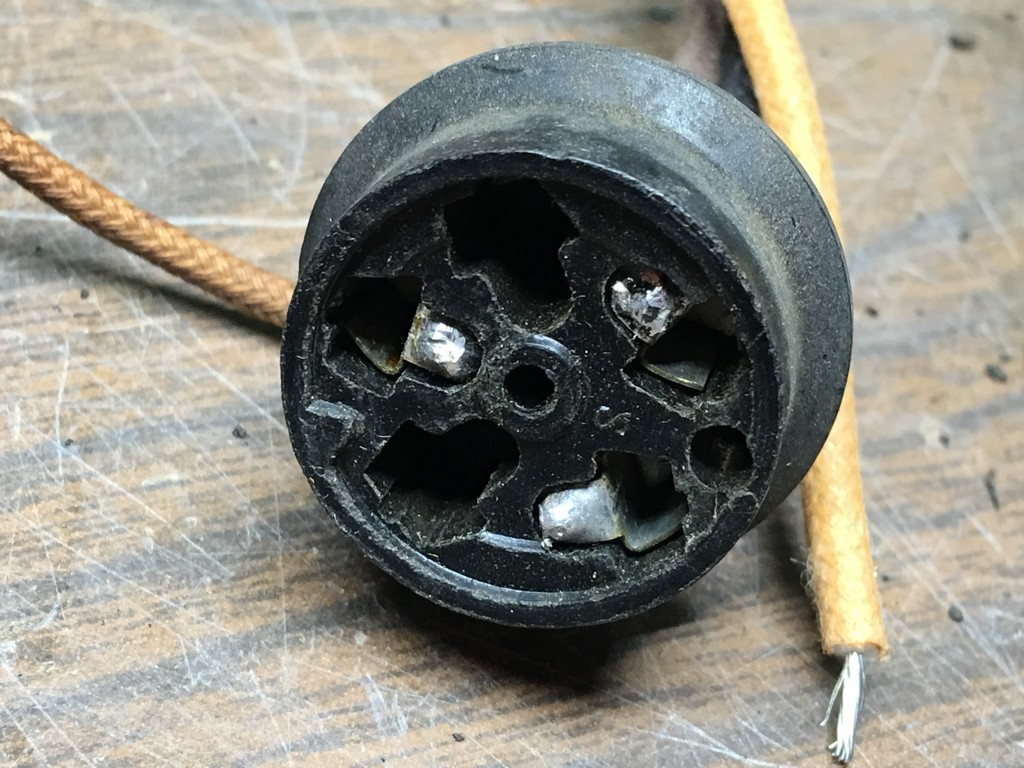

Now pull connector and the piece of old wire out of the plug.
[Image: http://www.philcoradio.com/images/phorum...-5_025.jpg]

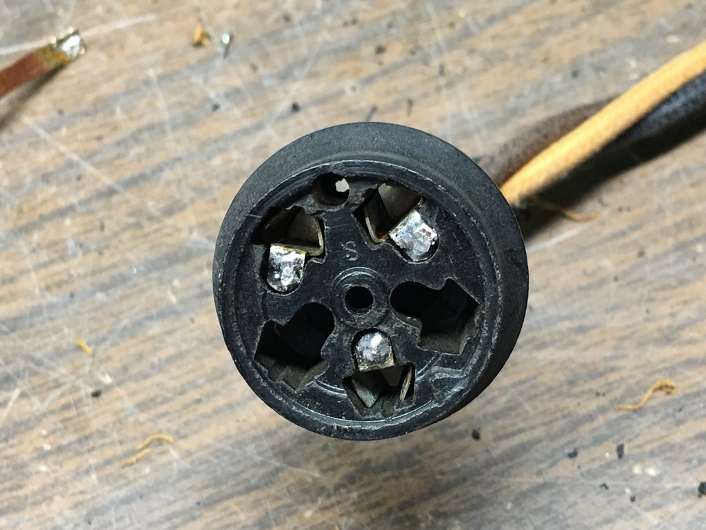

Unsolder the old wire from the connector and you are left with this:
[Image: http://www.philcoradio.com/images/phorum...-5_026.jpg]
The solder tab needs to be at a 90 degree angle to the connector; it gets bent when you push the connector out of the plug with your tiny screwdriver.
Take a pair of needle nose pliers and carefully bend the tab back to a 90 degree angle so it looks like this:

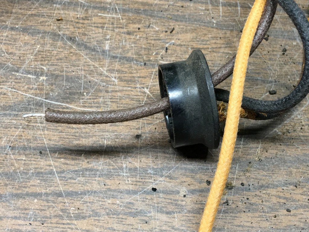

Now push your new wire through the hole in back of the plug where the old wire was.
[Image: http://www.philcoradio.com/images/phorum...-5_028.jpg]

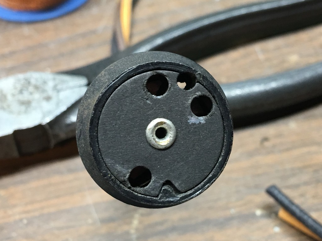

Solder the new wire to the solder tab of the connector. Cut off any excess wire. You do not want to leave hardly any excess wire/solder here at all. Leaving a large blob will interfere with getting the insulator back in place on top of the plug.
[Image: http://www.philcoradio.com/images/phorum...-5_029.jpg]

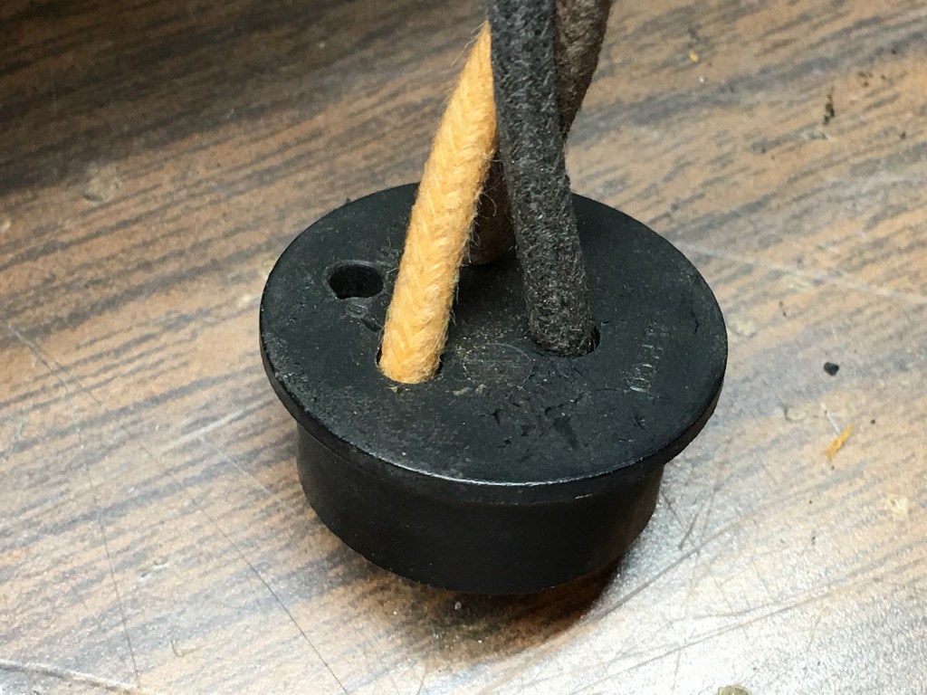

Finally, replace the insulator on the end of the plug.
[Image: http://www.philcoradio.com/images/phorum...-5_033.jpg]
Voila - new speaker cable! And it looks like it came from the factory this way.

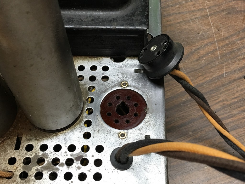

Saturday's Progress, Part 4

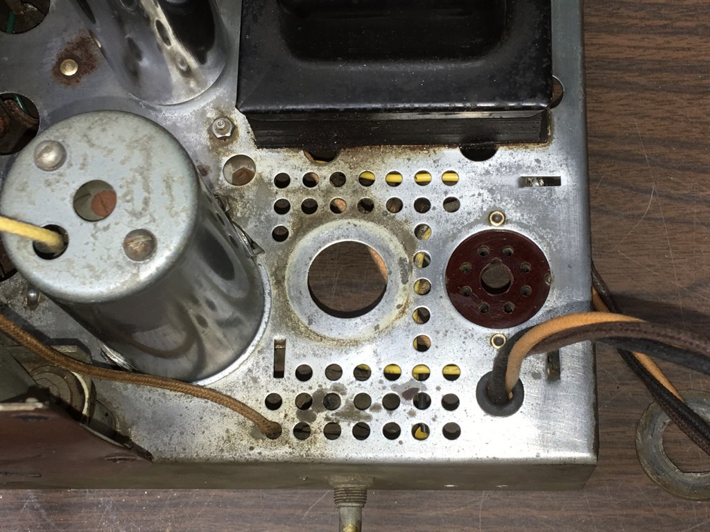

There was no grommet in the chassis where the speaker cable came through, which likely contributed to the demise of the original cable.
There is one there now.
[Image: http://www.philcoradio.com/images/phorum...-5_034.jpg]

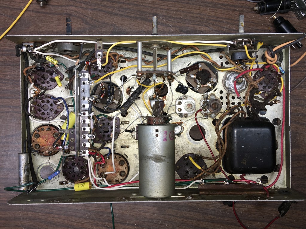

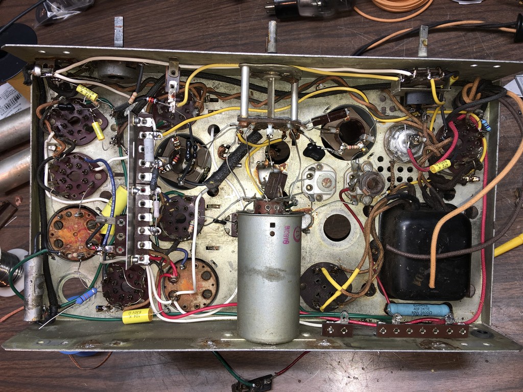

I replaced some above-chassis wiring, three resistors, and two mica caps. I also cleaned the top of the chassis as best as I could using a can of the orange hand cleaner with pumice. It wasn't really rusty, but was very dirty/grimy/grungy.
I removed another electrolytic can as well. But try as I might, I could not get the nut of the third electrolytic to budge...so I made an executive decision to rebuild that can in place.

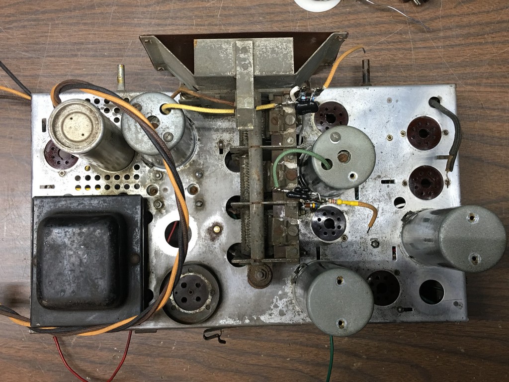

Here's how the top of the chassis now looks:
[Image: http://www.philcoradio.com/images/phorum...-5_035.jpg]

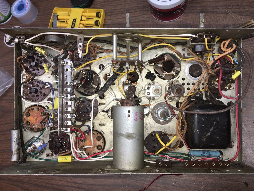

Most of the attaching screws for the coil/IF transformer cans are missing in the photo above. They have been sitting in Evapo-Rust overnight, along with the grid cap connectors. After their Evapo-Rust bath, I will reattach those screws and lockwashers.
Here's how the bottom of the chassis now looks:
[Image: http://www.philcoradio.com/images/phorum...-5_036.jpg]

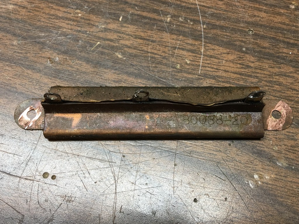

For openers today, I removed the two-section Candohm.
[Image: http://www.philcoradio.com/images/phorum...-5_037.jpg]
The rivets which held this on the chassis were very stubborn and difficult to remove. I ended up having to grind both sides to get them out.

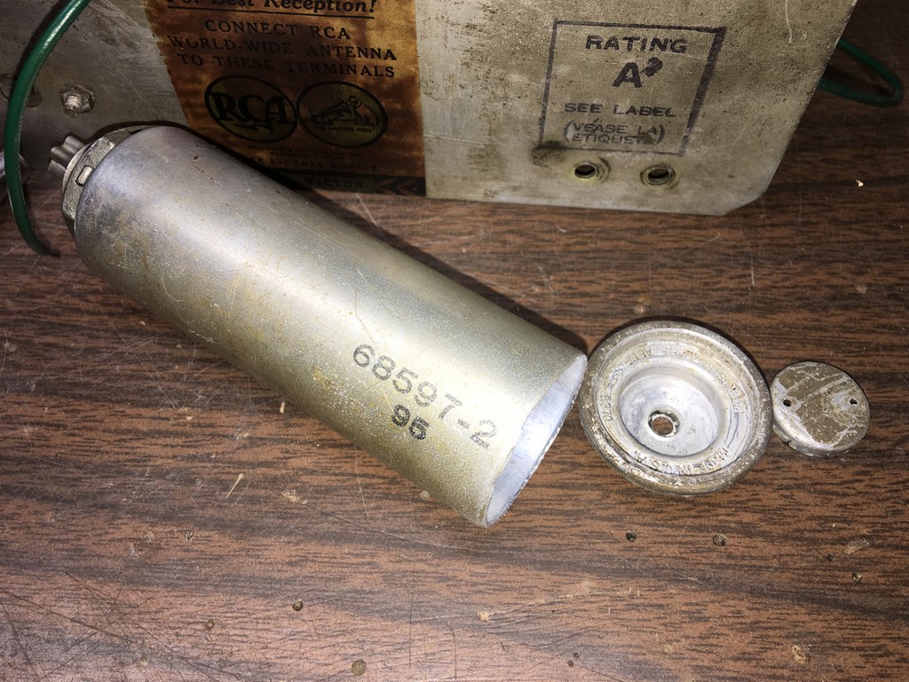

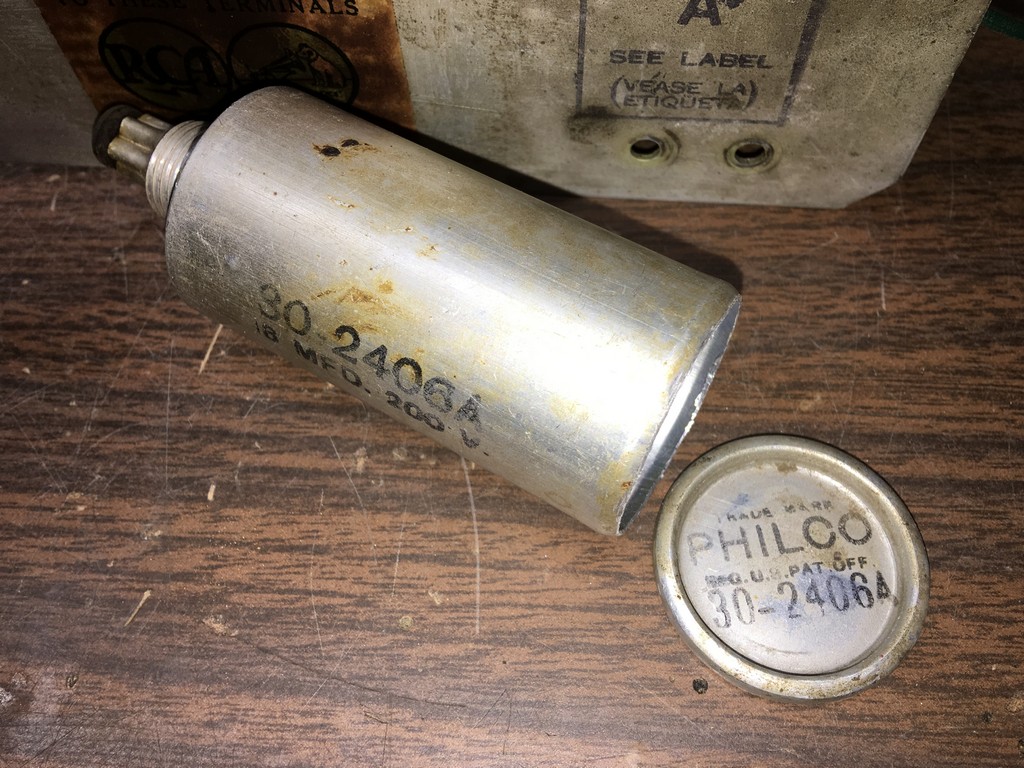

Next, I prepared two of the three electrolytic cans for restuffing.
[Image: http://www.philcoradio.com/images/phorum...-5_038.jpg]
[Image: http://www.philcoradio.com/images/phorum...-5_039.jpg]
Yes, the second one is a Philco part. The can that was on the chassis was a replacement, with wires coming out on the end. The original electrolytic had a solder lug on the end. This Philco electrolytic had a solder lug on the end and has a threaded stud for mounting, so this will result in an original-type unit. Once I polish the can, the lettering will disappear and no one will know the difference but me (and you guys reading this thread).

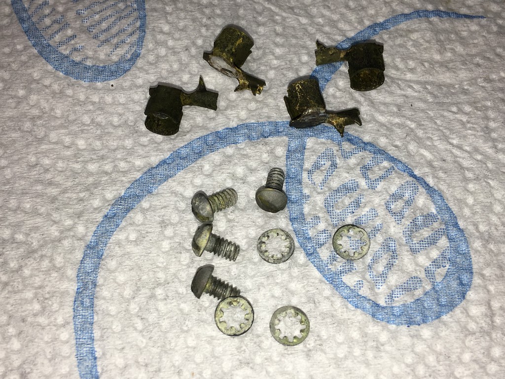

After doing all of this, I remembered the parts that had been soaking in Evapo-Rust overnight. I washed and dried them, and here are the results:
[Image: http://www.philcoradio.com/images/phorum...-5_040.jpg]
The screws look great, as do the lockwashers.
Unfortunately the grid caps still look grungy. There was a good reason for that - I discovered that just enough grunge had come off in the Evapo-Rust bath to reveal that the grid caps are brass, not steel.
So the grid caps are now soaking in ammonia.

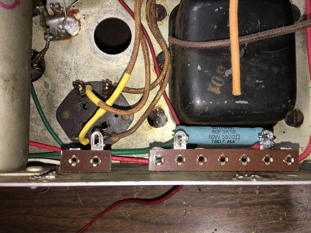

I attached some more terminal strips to the chassis to replace the two-section Candohm.
[Image: http://www.philcoradio.com/images/phorum...-5_041.jpg]
[Image: http://www.philcoradio.com/images/phorum...-5_042.jpg]
I have a problem. I misread the value of R20 - it is 13K, not 15K. (I had ordered a 15K resistor.)  I'm tempted to use the 15K anyway, but until I make up my mind, this is how it will remain.

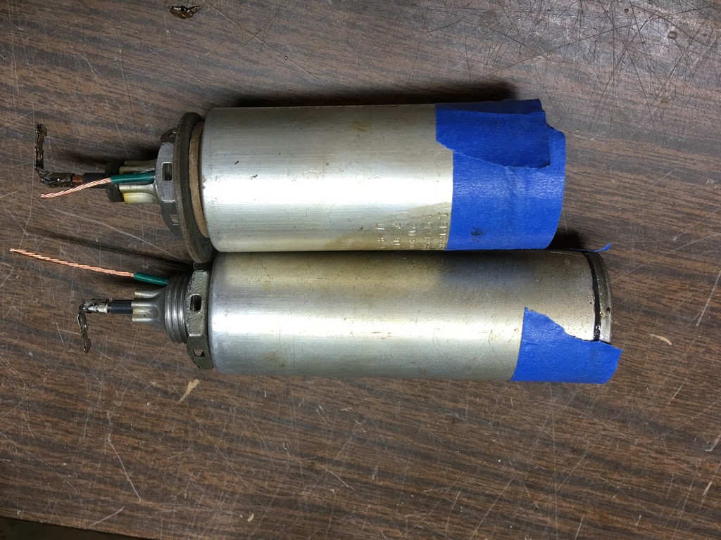

Tonight, I managed to mostly get two of the three electrolytic cans restuffed.
Here's one:
[Image: http://www.philcoradio.com/images/phorum...-5_043.jpg]
and the other:
[Image: http://www.philcoradio.com/images/phorum...-5_044.jpg]
and now both, mostly finished save for allowing the glue to dry on the top caps:
[Image: http://www.philcoradio.com/images/phorum...-5_045.jpg]

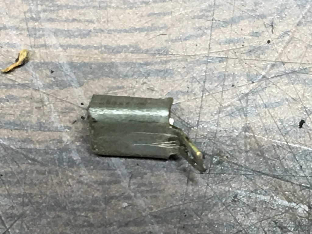

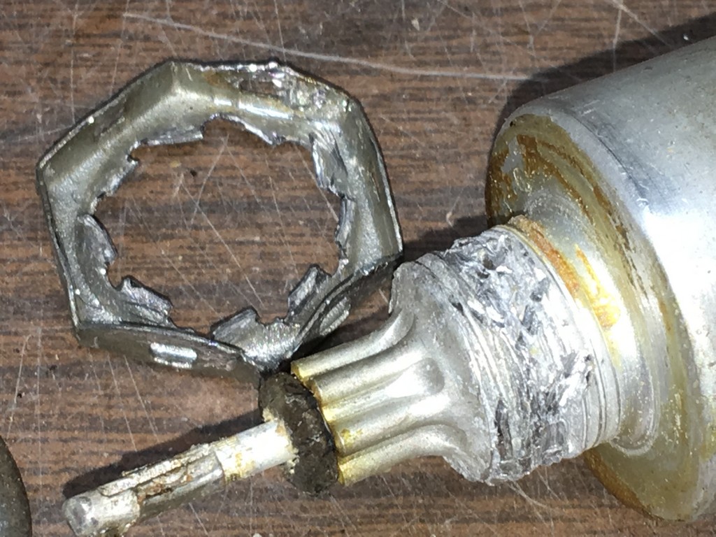

And Arran, I did try your suggestion on the "ears" of the nut holding the third electrolytic. After considerable hammering and bending, I was finally able to remove both nut, fiber washers, and electrolytic.
[Image: http://www.philcoradio.com/images/phorum...-5_048.jpg]
[Image: http://www.philcoradio.com/images/phorum...-5_049.jpg]

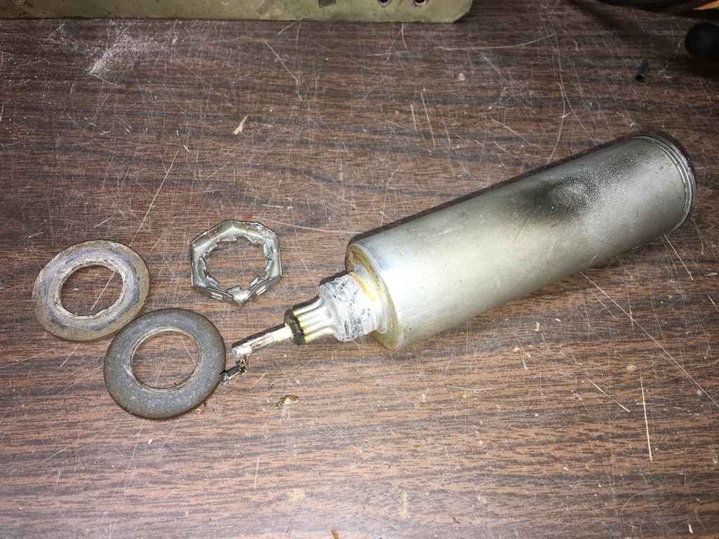

As you can see below, the threads at the bottom of the electrolytic can are badly mangled. I know that I caused some of this damage, but I believe the threads were already bad - which is why the nut refused to budge previously.
[Image: http://www.philcoradio.com/images/phorum...-5_050.jpg]

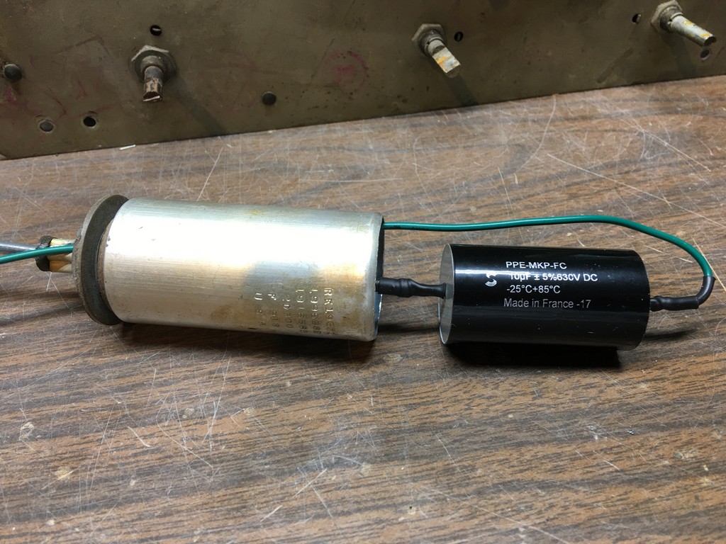

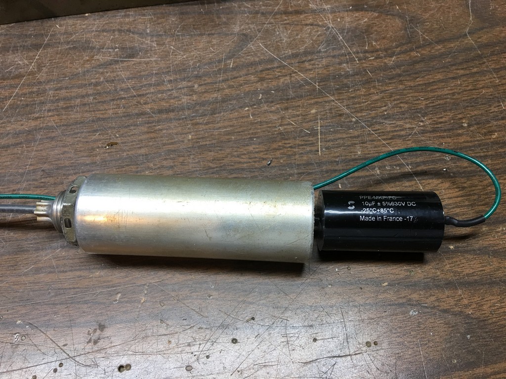

After considerable searching through my stash o'stuff, I managed to find one more stud mounting electrolytic can so I will be able to replace the original can. This is C35, 18 uF. I'll save this can for future use in a Philco with clamp mounting, where the damaged threads will not matter.
Hopefully I can manage to squeeze both 10 uF and 8.2 uF Solen Fast caps into the replacement can.
We shall see...
