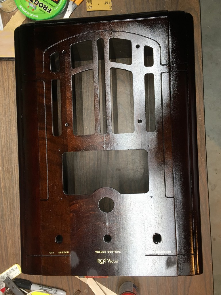

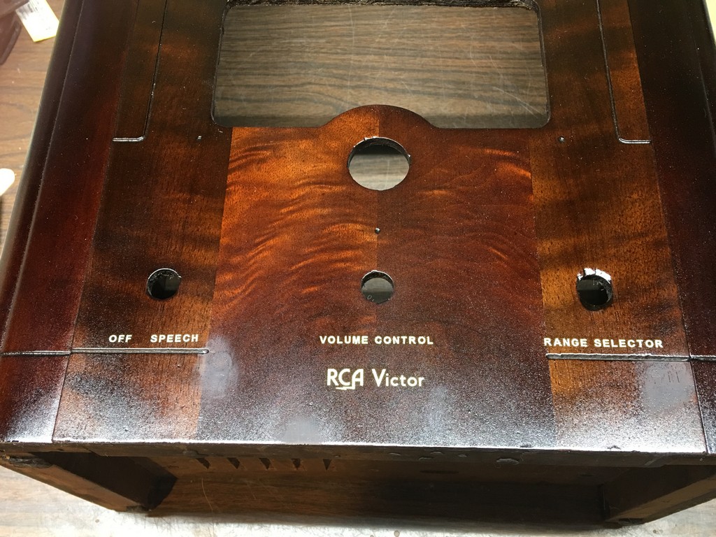

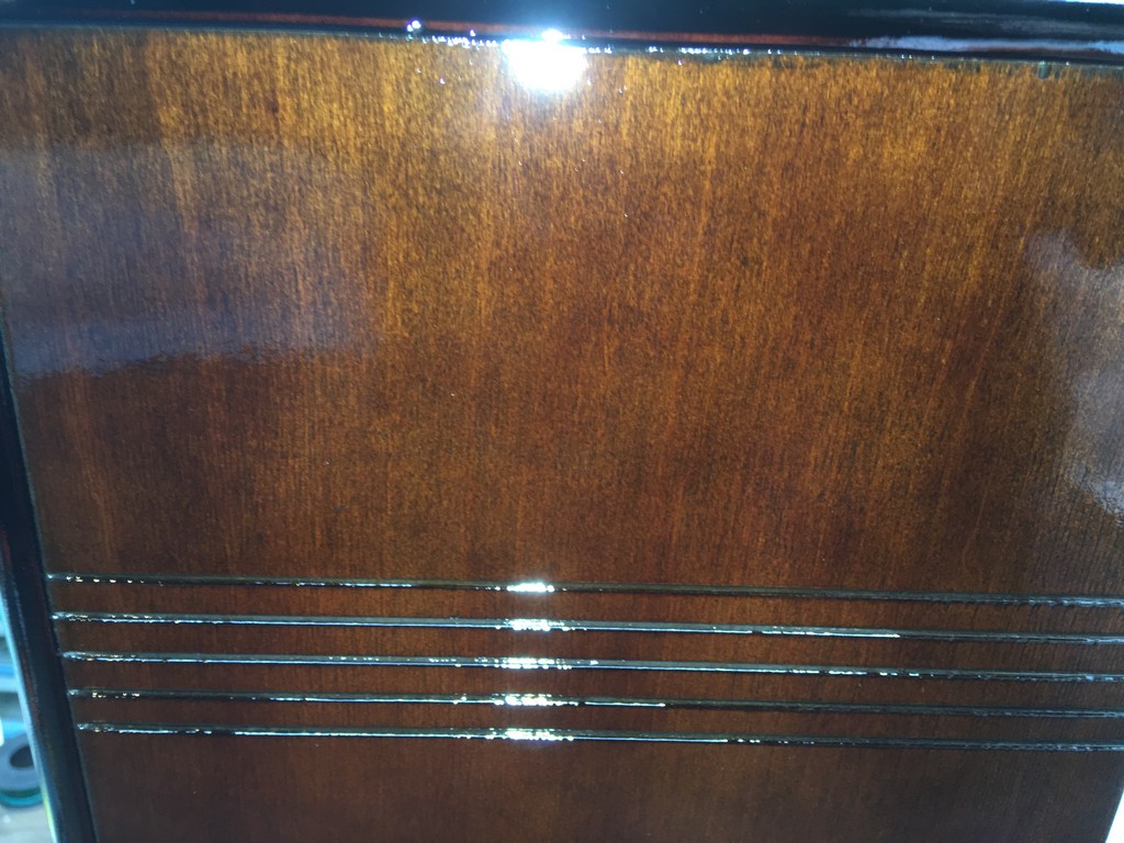

So...
Success.
[Image: http://www.philcoradio.com/images/phorum...T2_025.jpg]
Sorry for the glare. This photo was taken with the cabinet face up on my workbench, with my LED shop light directly overhead.
I used a scrap piece of 1000 grit wet/dry sandpaper and carefully sanded the areas with the drips.
I think it turned out very well indeed. I managed to knock down the drips to the point that they are (almost) level with the remainder of the surface, without burning through any toner...which was my goal.

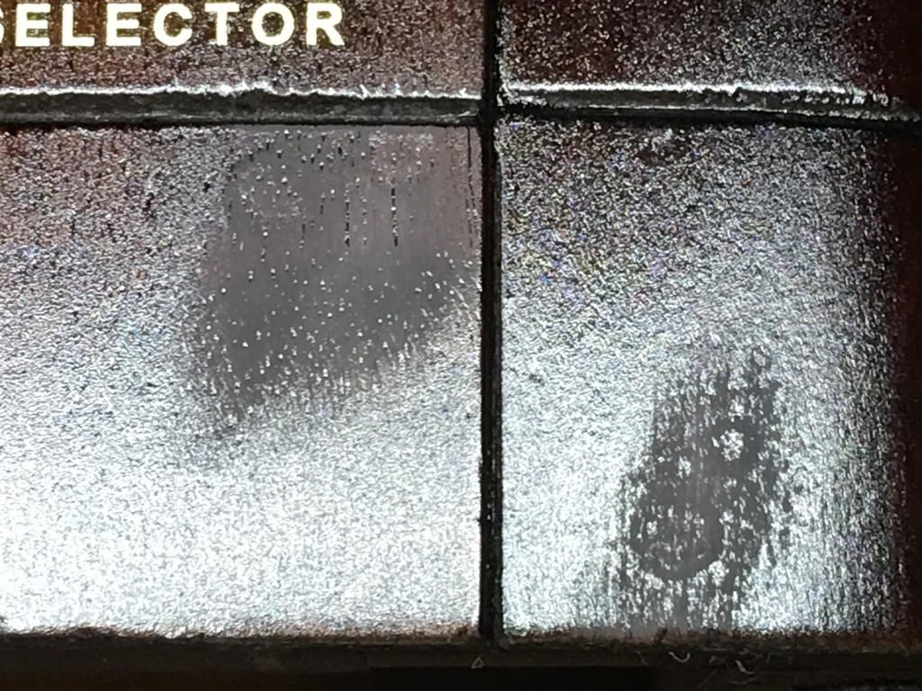

[Image: http://www.philcoradio.com/images/phorum...T2_026.jpg]
[Image: http://www.philcoradio.com/images/phorum...T2_027.jpg]
[Image: http://www.philcoradio.com/images/phorum...T2_028.jpg]
I'm glad I had that scrap piece of 1000 grit paper on my workbench. I believe it was the perfect choice for doing this. I think that anything coarser would have burned through the toner.
The remnants of the drips are showing up more in the close-up photos under the bright LED light than they do when just looking at them.
I'm very pleased with how this has turned out. I feel that now, with subsequent coats of clear lacquer and careful wet sanding, that I will be able to get these areas to the point that they will barely show up if at all.
And I don't think I will need the Blender Flow-Out after all (even though I have it if I need it).

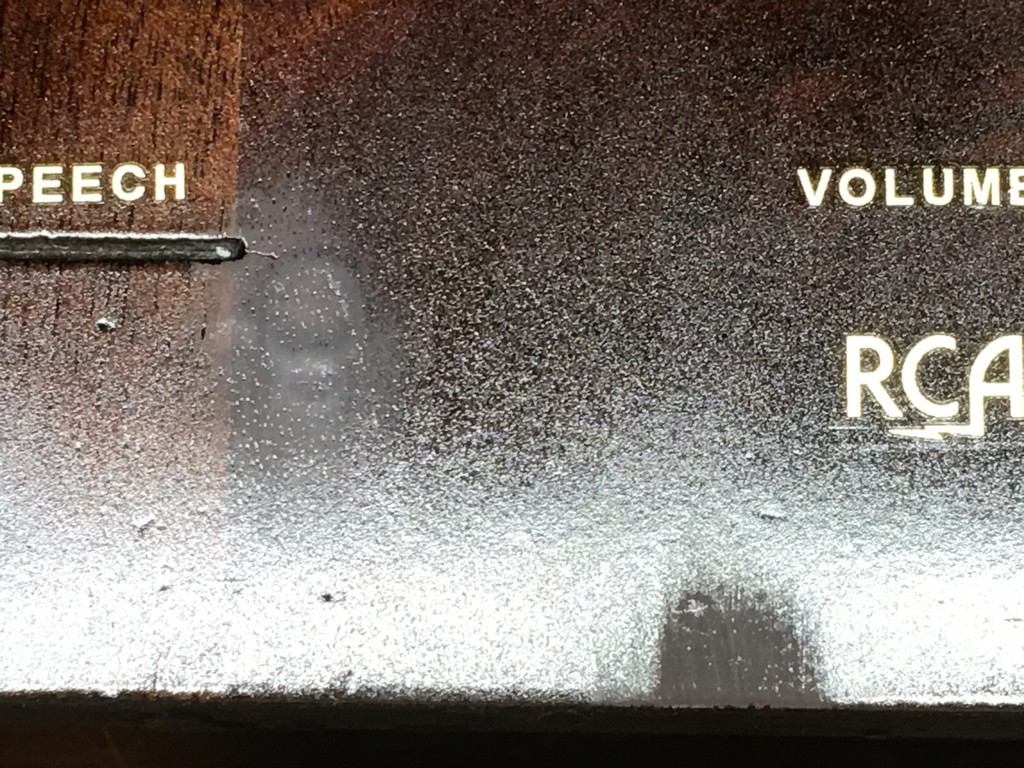

...unfortunately, spraying the next two coats of clear revealed that the drip spots were still showing. Icon_sad
In addition, it was really hot and very humid when I sprayed the second two coats, so the finish did not turn out well - it had a powdery appearance in some areas of the cabinet. Yes, I know - it was the result of spraying lacquer when the weather is too hot and humid. The lacquer was drying in areas before it hit the cabinet.
I wet sanded the cabinet again today, going down to 600 grit and getting a bit more aggressive with the drip spots. Fortunately I did not burn through the toner (knocking wood), and the spots look better/smoother than ever now. Whether they will (mostly) disappear after the next two coats remains to be seen. The entire cabinet has been smoothed out by the wet sanding, although I need to wet sand the sides some more. The top and front are ready for the next coats.
The weather is supposed to be a bit milder tomorrow with less humidity, so I guess I'll try it again. I'm hoping the cabinet turns out smoother this time.

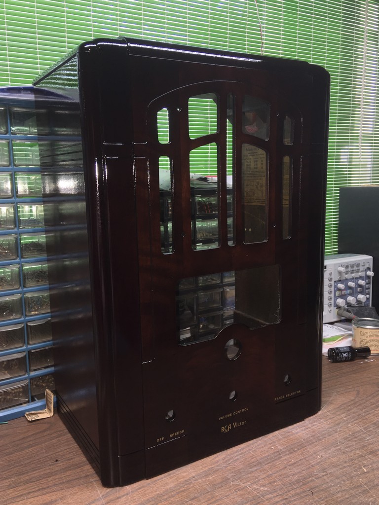

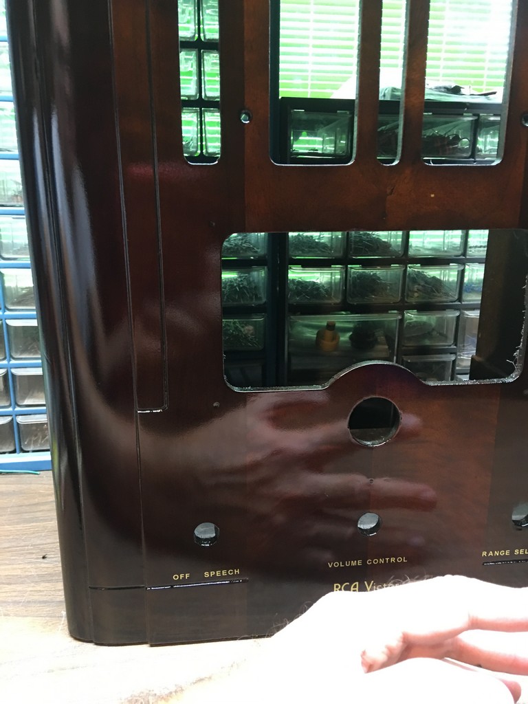

Two more coats of clear, and I think the 6T2 cabinet is almost finished.
[Image: http://www.philcoradio.com/images/phorum...T2_029.jpg]
Looks pretty good, eh? Take a close look at its problem areas:

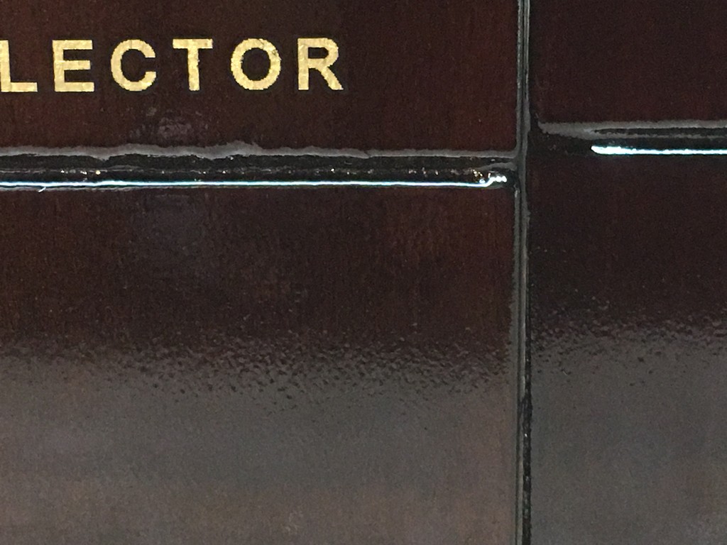

[Image: http://www.philcoradio.com/images/phorum...T2_030.jpg]
This is, or was, the worst of the lacquer drips. It is just barely showing now - and that is with very close inspection. I don't think the average Joe will notice it now.

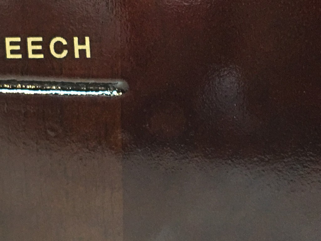

And the other bad one, on the right side:
[Image: http://www.philcoradio.com/images/phorum...T2_031.jpg]
GONE. Icon_thumbup Icon_biggrin oh_yeah
The shine is deep!
[Image: http://www.philcoradio.com/images/phorum...T2_032.jpg]
However...
Drip issues (mostly) fixed, another issue occurred. I was a bit over-zealous with spraying clear on the right side, and ended up with a nice run. This photo does not show it, but it is there just the same, near the top of the right side.
[Image: http://www.philcoradio.com/images/phorum...T2_033.jpg]
However, I am optimistic that a careful wet sanding will take care of it, just as it did with the drips.
I think that after I wet sand the run that I will mask off the rest of the cabinet and spray that side only, laying it on its other side when I do. I don't think the rest of the cabinet needs any more clear. I'm satisfied with it (other than the run, that is).

Wow Ron very nice! The radio will play just as nice when you finish it.
#43
Looking good Ron  Icon_thumbup
You're inspiring me to try finishing a cabinet or two when I get settled.  I have a Walton cabinet that only needs another two or three coats to be finished.
