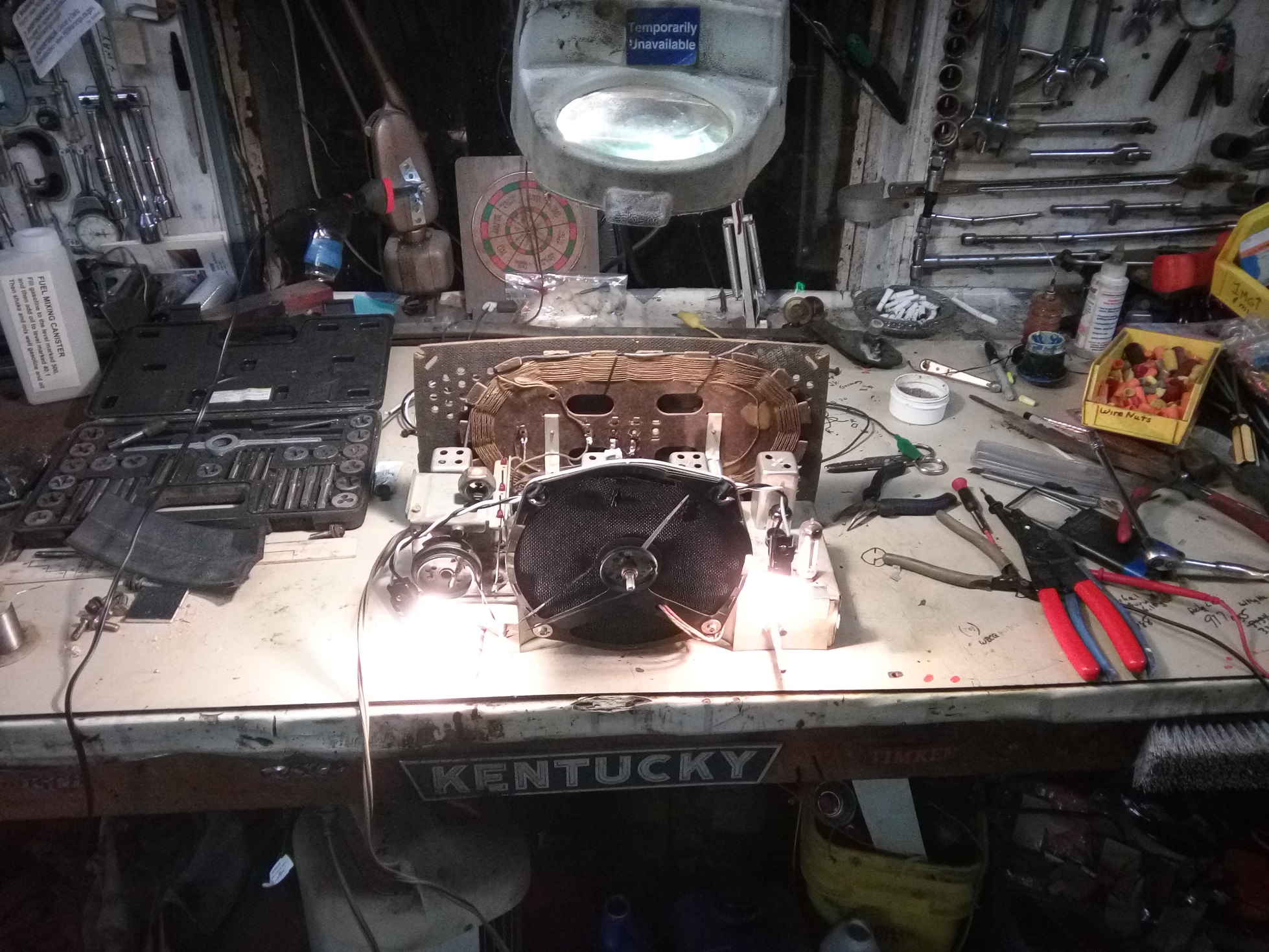

i attempted to train my dc out on the Sel Rect and was able to use 60mg parallel branch to get 14vdc to power 194 bulbs. the problem is when i power up,,,, the 194 bulbs blow. i will try a couple more things today but .... i need my new bulb to be very low profile to achieve what i am attempting to do.
#36
Could you add a LM317 adj. voltage reg to keep from blowing the bulb?
#37
i thought i had those but  i dont.
i reverted back to using 120v to power the lamp but now i can say "lamps".
i found the original bayonet bulb at lowes which the base is equal to an automotive 1156 bulb.... but i am using small screw in bulbs now with new sockets all soldered in and working.
two issues
-the left lamp is too close to the case and even with my metal tape on the interior to mimic the original design on the right side, the case just gets way too hot.  i will have to rework the lamp location or use a smaller profile bulb.  both new bulbs are 15watt,, the original single bulb was 45watt.
-the lower half of FM went goofy again,, i dont think i will ever have the smarts to fix it but FM 93 on up is golden even with no rabbit ears attached.

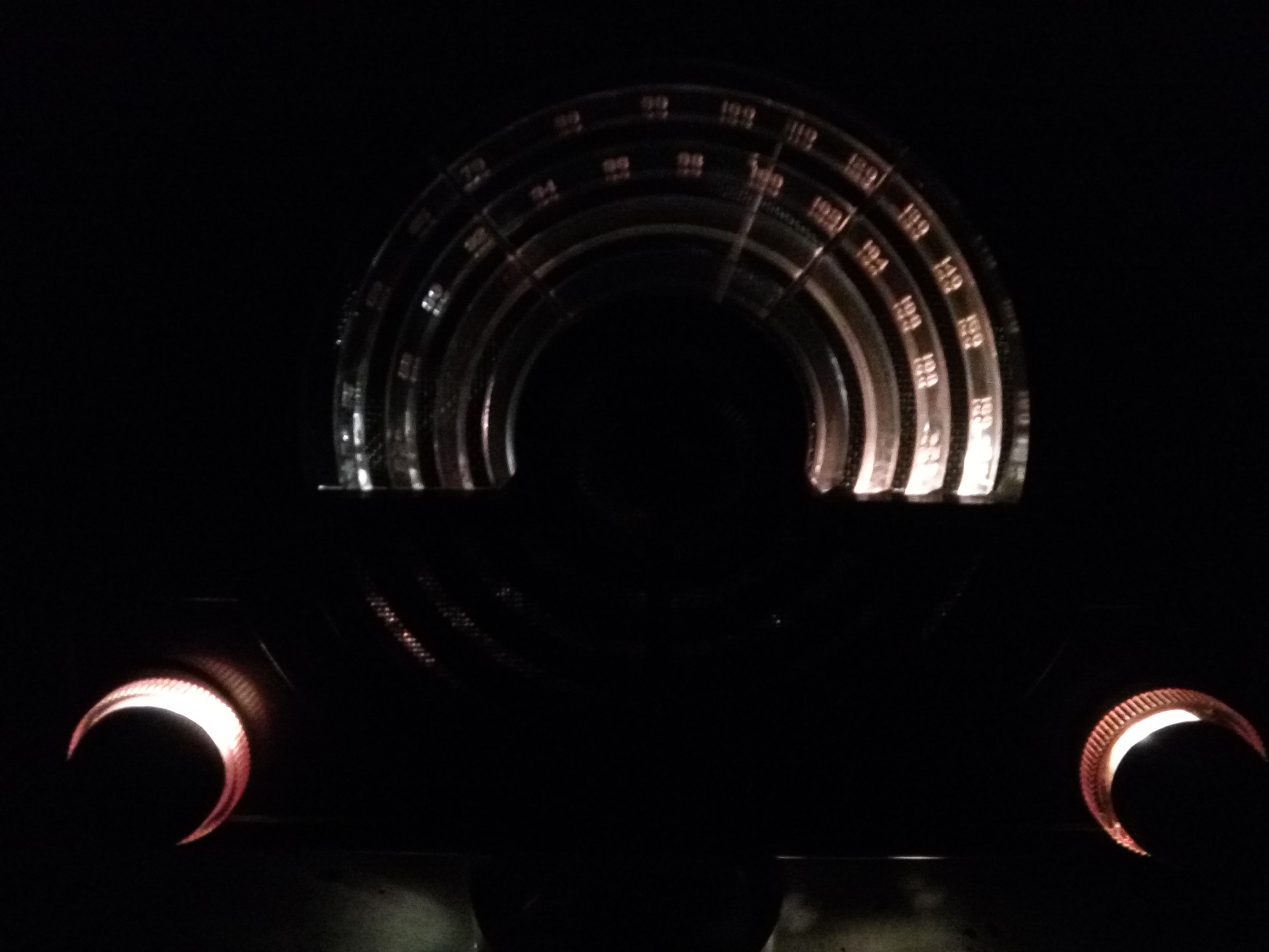

here are some pics of the final work to properly light up the unit like i think it should be. now atleast both knobs light up well enough and the dial glass is a tad off kilter on illumination but good nuf' for me.
#38
i adjusted the left lamp and added some more heat barrier material so all is well.
i cut away some of the rubber foam that seals around the dial glass to allow light in on the dial section from the left,, it was blocked off by the foam.

If those are candelabra based screw in bulbs you are using now, they make LED replacement bulbs that would run a lot cooler. You might want to try them in this application. https://www.bulbs.com/product/LED-C7C-CLEAR?RefId=788 .

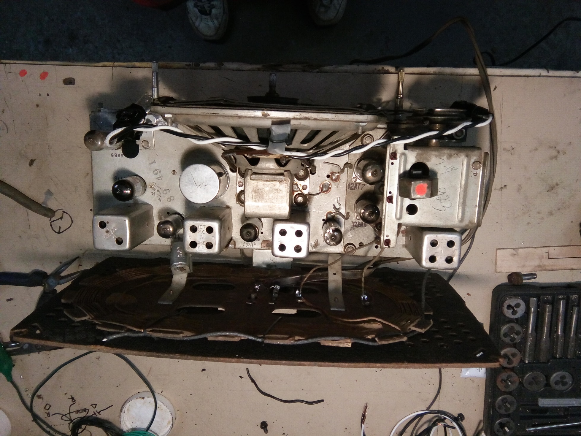

i am surprised no one noticed how i solved the "sticking" slug tuning issue.
i noticed that the slug tuning would sometimes not drop down all the way making me think something was broke,, a simple 5/8'' heavy nut and a zip tie fixed that. see the big orange dot on the top of the chassis.

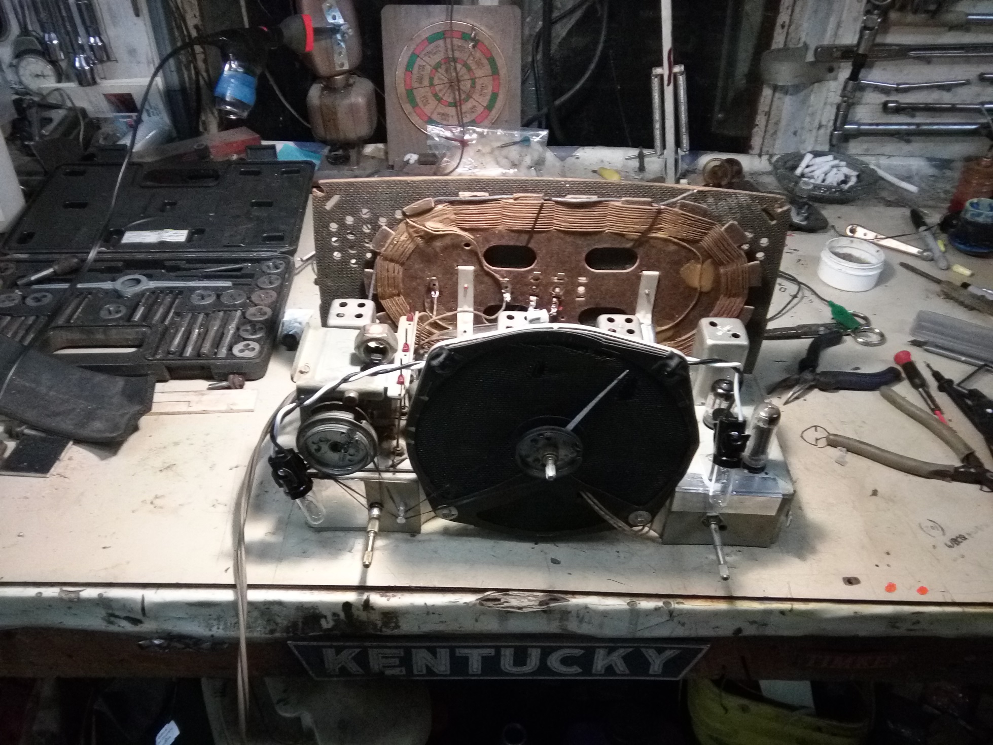

Update-- on FM
***the picture shows the radio when the left half of the full FM dial scale as inoperative.****
problem- the FULL left half of the dial scale produced no changes in channels while on FM only.
going from the needle 12 o'clock position ccw to the 9 o'clock, one barely audible channel would dominate this ccw full 90deg sweep.

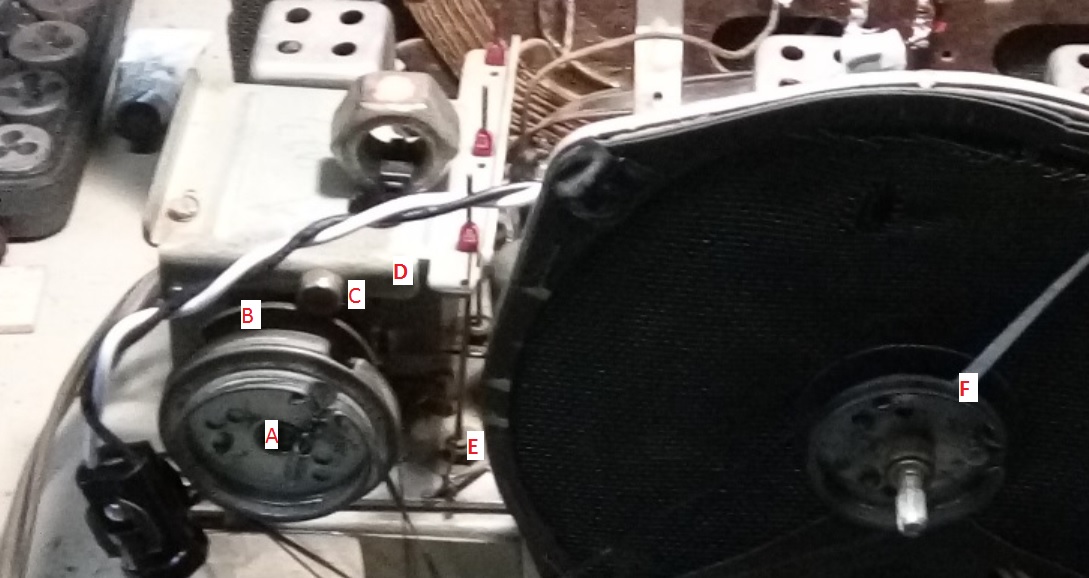

Item A consists of two dial string pulley's fixed to item B thee "CAM".  this pulley / cam system is slipped onto the tuning cap shaft and held in place by two lock screws once it is properly located and coordinated with the dial needle.
Item D is a hinged chunk of  flat metal with a round mated cam follower item C that will "follow" the item B "cam" as the tuning cap is rotated.
Item D carries three of item E FM slugs up and down into the FM coils as the tuning cap is rotated.
item F  the dial needle and pulley is currently shown approaching the max clockwise position.  note the location  of item E the FM tuning slugs are still poking up and out of the FM coils. just a tad.
I re-coordinated the tuning cap to tuning cap cam to dial string needle and now the lower half of FM receives properly throughout the 180deg needle swing.
while taking a long hard study of all the working parts, i found one item A lock screw was loose.  i also found that the pully item A was dressed too far up on the tuning cap shaft  and causing the main "driver" string to be rubbing the chassis.
i know most of you have experience working on slug tuned FM sets but this was my first go and i learned a lot but i still have a long way to go.
#43
Good fix!
