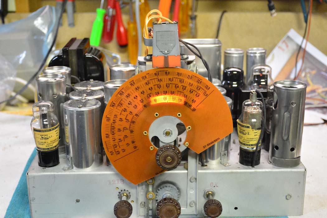

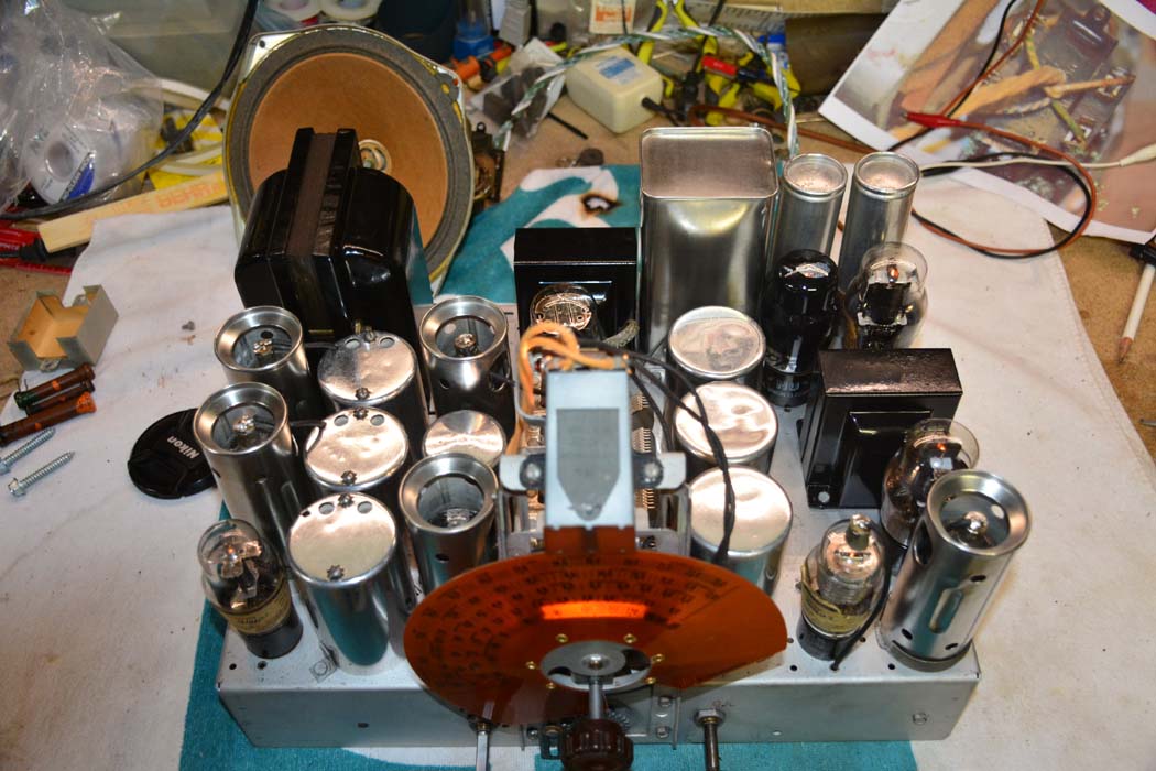

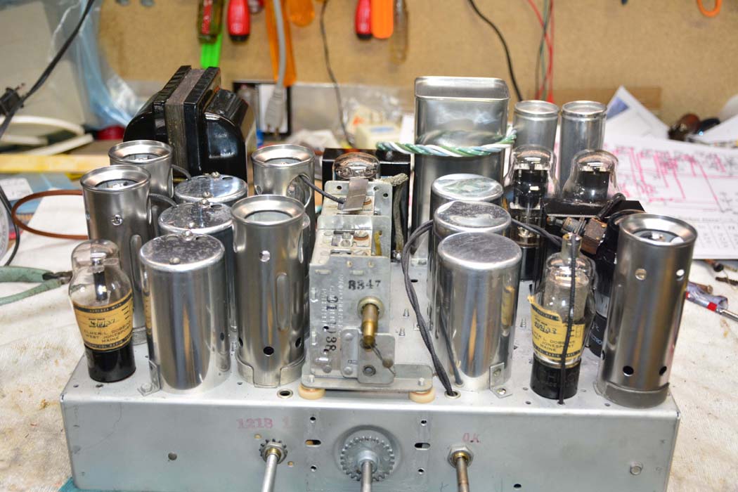

A couple of pics of my progress.  the tube shields and capacitor can look much better re-plated.

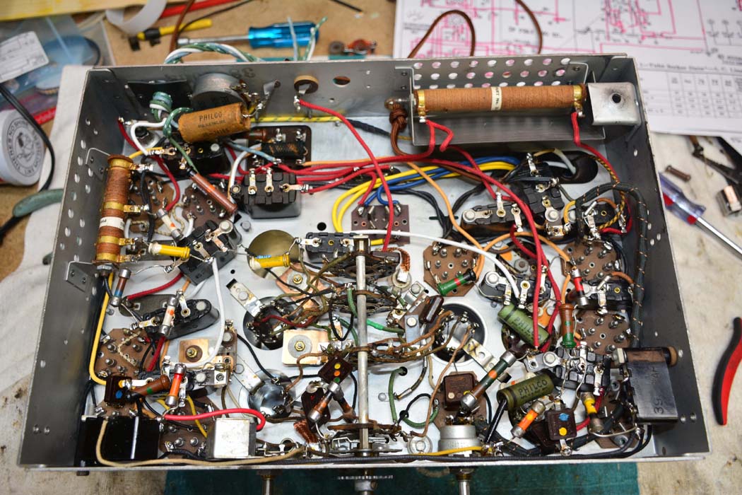

Under the chassis I have 4 resistors in the power supply section that still need to be replaced.  You can see a couple of examples where I've paralleled a resistor with the dog bone to bring it into spec.  The ones that need to be replace have gone down in value rather than up.  I haven't  attempted to mold or fabricate a dog bone look alike as yet.  I may try with the power resistors. Also, the antennal coil that was fried by lightning needs to be wired in. One slight wiring error necessitated a splice. I didn't feel like lifting  the whole tuning cap to replace the wire with a longer one.  The end of the electronic restoration is in sight!

It lives!  I've never been accused of being patient.  I temporarily reinstalled the out of spec resistors and the old RF coil with a new primary winding similar to what was on it previously.  Just a lot neater and closer to the resistance listed on the schematic.  I get stations all across the dial on all bands.  I will do an alignment when I get the replacement dial as the old one is unuseable.  I'm looking forward to getting Ed's original coil in it and the proper power supply resistors.  Woo whoo!

Installed the BC band antenna coil that Ed so kindly sent me into the radio.  That solved a tuning problem I had with my home-brew coil.  Re-aligned the radio using the procedure outlined in the Riders information.  All bands tuned up very close.  The BC band is within a couple of khz all the way until over 1450 khz.  Then it's off by about 5 khz.  I can live with that!  Bands 4 and 5 are lined up as a compromise between 10.8 and 21.6 mhz.  There was almost no compromise.  Both are very close at that frequency.  In reality I used 10 and 20 mhz as opposed to the suggested frequency.  The suggested frequency comes from the original Philco single frequency, crystal controlled generator using harmonics to tune the entire radio.  Sensitivity is good and the inter station silencer works well.  I like it adjusted so that inter station noise is greatly reduced, but not entirely eliminated.  The wire wound pot for that was open at one spot in the winding.  A thin, narrow, tin plated piece of metal forced in between the windings and the insulator jumpered the open winding.  I'll see how long it lasts.
I've replaced the grille cloth but will need to refinish the cabinet.  I'll put it in the que.  Not my favorite job and I have several to do.  I'm procrastinating!
I'm pleased with the results and especially like the re-plated capacitor can and the tube shields.  I'm glad that works as ugly, oxidized tube shields have always bugged me on other projects where I get the chassis looking halfway decent.  I'll probably be going back to other projects to remedy the situation.
