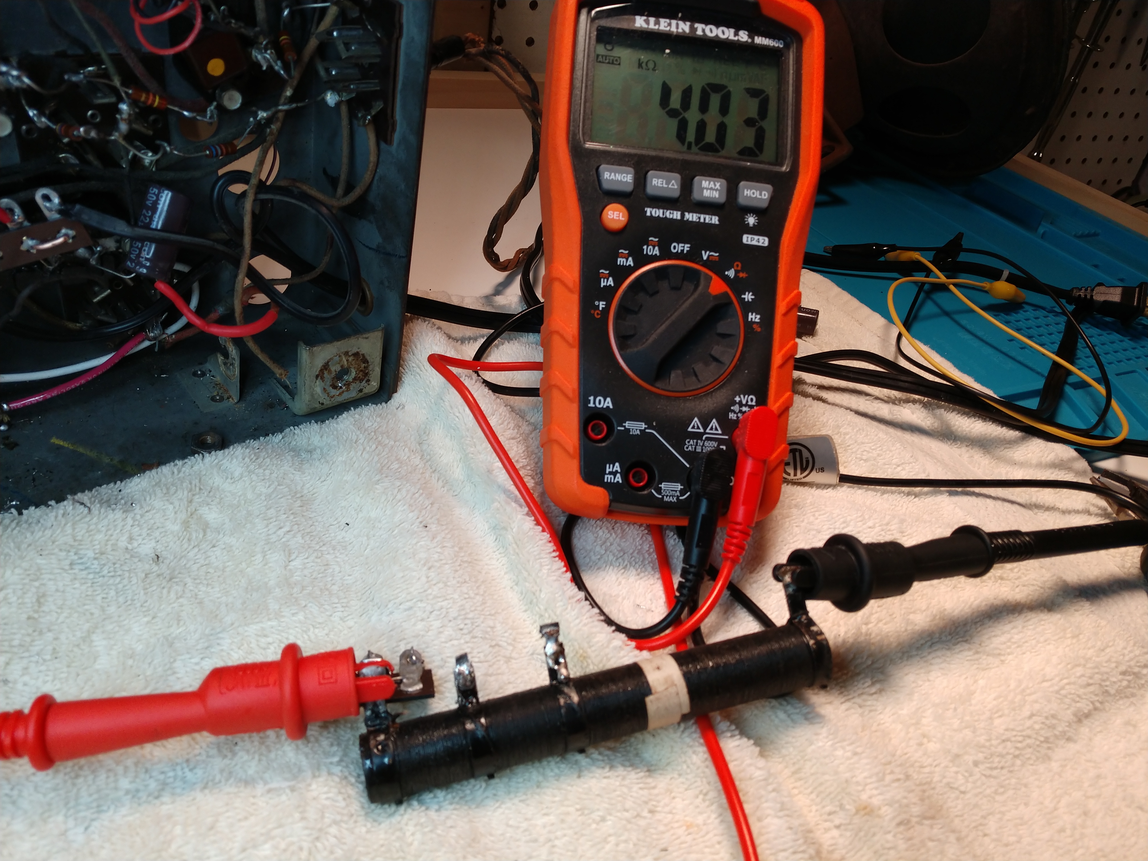

When I do what you just said, I get 1.75 kilo ohms 1750 ohms
#32
195 ohms from the first terminal to the chassis and from end to end of the resistor I get 1750 ohms
#33
Something is not right. The three sections of the BC resistor should add up to about 3740 ohms, may read slightly less because of the circuits connected to it, 1750 sounds low.

Hi Steve...hope you and your family had a wonderful Thanksgiving.  Thanks for not giving up on me here!!  I'm feel pretty discouraged and I'm afraid I'm getting close to walking away  Icon_sad
I think the resistor is fine...I took it completely out of circuit as you see below and measured it. 4k ohms from end to end.  From 1 to 2 193 ohms.  1 to 3 254 ohms.  The internal measurements make sense too.  From 2 to 3 60 ohms.  From 2 to 4 3.8k ohms.
Any suggestions as to what I should test or do next?  Thank you for your help...it's much appreciated!
