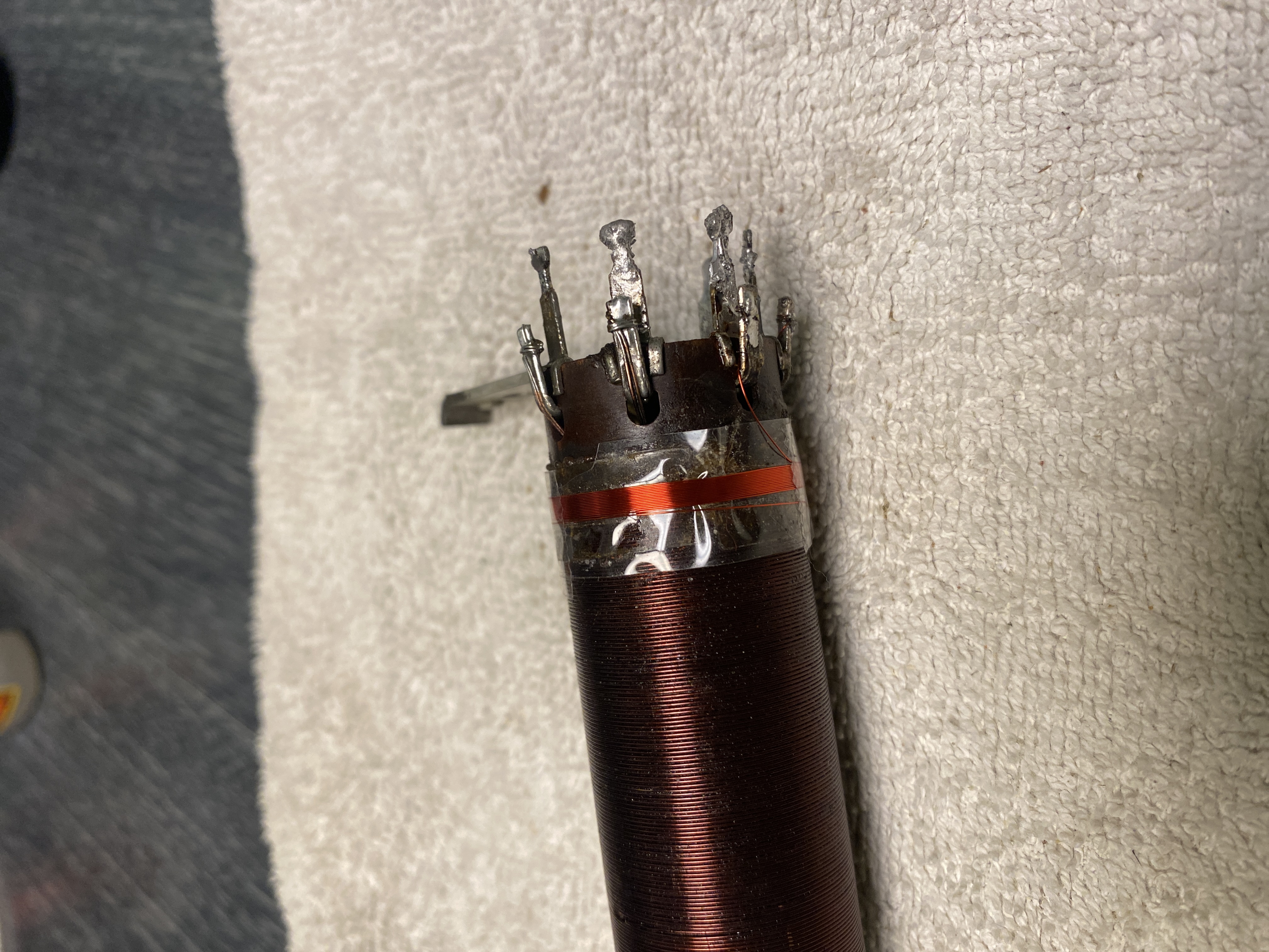

Thanks Richard! I just finished rewinding the oscillator coil! Measures exactly 2.5 ohms! Should be close enough to work I hope…

Okay folks, so pretty much everything has been wrong with the 60. A couple tubes were gassed, open oscillator coil, a few bad caps and resisters and so on. I have literally replaced every part I can think of, and I still get the same results. No reception whatsoever. Just a quiet hiss. I checked the voltages, and everything is fine. Re stuffed all Bakelite caps, replaced filter caps, and replaced the caps inside the metal can. Replaced bad resistors. Re wound the coil(the correct way and actually made it perfect. Looks like factory) I have re flowed all solder joints and checked wires for any shorts. I have literally done everything possible, and it won’t work at all. The weird thing is the radio worked perfectly fine before the coil opened. It’s as if everything went bad all at once. The ONE thing I did not do was replace the tuner grommets as they are rotted and the tuner wobbles around. I temporarily stuck some foam “shims” underneath the tuner it to prevent it from wobbling. Seems like there is a short somewhere because if I move the antenna around, I will hear loud popping sounds from the speaker. And if I hold the antenna, then I can faintly hear a station in the lower end of the dial. But it’s very faint. I am at a complete loss…. I think I will stick with my simple AA5 radios lol

Brandon, if you have a signal generator you can check most of the set by sending a modulated 460 KHz signal to the antenna. If you hear the tone from the speaker then the entire rf/af sections work to some extent. Then you can concentrate on getting the oscillator to function properly. My first guess is the oscillator coil is not wired for positive feedback. I assume you have the other components in the oscillator circuit checked out. Reverse the primary winding connection and see if that perks it up.
#43
Brandon, looking at the photo of your coil, it looks like the new feedback winding is wound backwards. I have not rewound a coil for a Philco 60 but, most Philco coils, looking from the bottom are wound in a clockwise direction, starting from the bottom going up. Try reversing the connections to the feedback winding.

I was thinking about reversing the leads to see if I wound it backwards actually! I’m going to give it a try and see what’s up. I got a better multimeter and a new soldering iron so I’m good to go! I just re wound the antenna coil as well since it’s only 6 turns. That one was worse than the oscillator! I’ll keep you all informed. Thank you all so much! This radio is going to be electronically restored before I even get it working!  Icon_lol
#45
So I swapped the leads around thinking I had it backwards, but I get the same results. No oscillation at all either way… I tried the two radio trick with my little transistor and there’s no oscillation at all.
