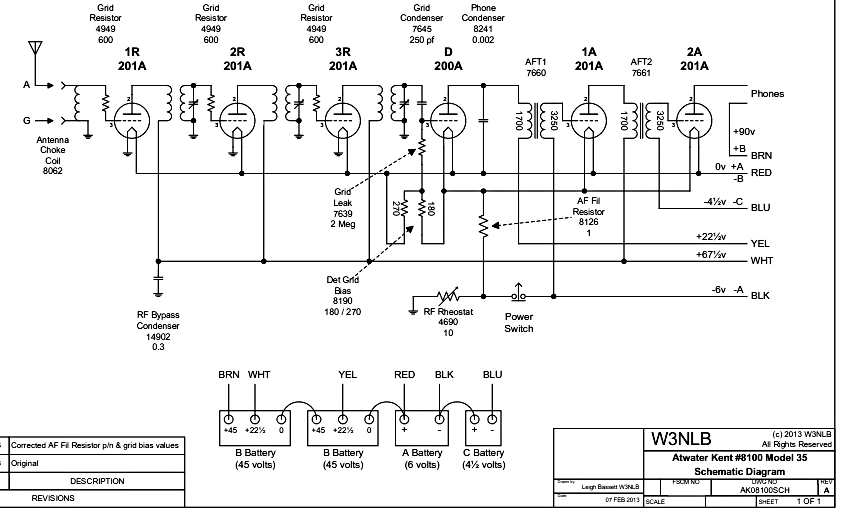

FYI, the '00 gas detector is for DX at the sacrifice in gain over the 01a. Usually the 1st AF transformer is 5:1 some of the voltage loss made up by the 1st AF transformer with a sacrifice in fidelity. Same '00 is fussy about its filament voltage and grid leak resistance to achieve full sensitivity. Many 20's radio fans found the '00 difficult to keep in good, sensitive adjustment.
I suggest lighting up the converted 35 with a known '01a with good emission, even if it has to be rejuvenated.
The change from '27 to an '01a in the detector will not be noticed as any shift in tuning will go away with capacitor alignment. The 1st AF transformer is likely different plate load.
BTW, the info for A-K lube came from some original service info I found at a local A-K dealer estate.
FWIR the coils in the doner radio are binocular. These should be fine if mounted as they were in the original set. No need for the orthogonal mounting as was the 35...
The info about changing the value of the grid damping resistors in the RF can be found in some repair histories for TRF radios in Ghirardis Radio Troubleshooters Handbook.
A follow up on changing the tuning condenser array alignment frequency. "Move the frequency from 1mhz to 950 khz" . Do the opposite if the radio is more sensitive in the other direction, ie: 1050khz.

Other than the detector, TRF sets are actually easier to figure out than Superhets.
The 4 big issues with TRF sets of this vintage (assuming you have it powered right):
First issue, Yes, very few TRFs had calibrated scales. I have a 1027 Federal 10 "Orthosonic" (Wonder if Victor smelled trademark infringement here) The scale was calibrated but was calibrated in meters. Back in the day, people kept logs as to station callsigns, frequencies and what number on the scale that the station appeared on. the "1 dial" sets started to appear in earnest in 1925 - 1926. This is why you have 3 separate caps ganged by pulleys and belts. A-K did not have time to arrange for a 3 section single frame capacitor; neither did anyone else except possibly RCA and Philco (?).
Second is selectivity. The A-K 35 was introduced somewhere between1926 and 1927, By then, there were at least 3 clear channel stations in NYC, WEAF (Later WNBC, now WFAN) at 660KHZ, WOR (710KHZ) and WJZ (WABC) at 770KHZ The TRF set of this type with 3 tuned circuits had reasonable selectivity but not as good as a superhet. There should be a reasonable amount of RF Gain from this system . Note that the 1st RF stage in this set is not tuned. The RCA Radiola 16 (battery) and 17 (AC) were very similar to this set. However, the A-K 35 has separate bias connections for the 1st AF vs the AF Output, and has separate B+
BTW, make sure that the 1K Ohm wire-wound "grid resistors" on the 2nd RF and 3rd RF (first and second tuned circuits) are intact. They almost always are open. If open, bridge with a 1K resistor, but leave the windings there. These resistors were there to help prevent oscillations in these stages (These sets were not neutralized (Neutrodyne) sets.
Third, the detector (the reason for the experiments) is certainly not HiFi. in addition, a 200 is much more distorted than a 201A tube, but more sensitive. You can use either.
Finally, the available tubes did not have earth shattering power in the Audio Output stage. A 01A at 90V and -4.5V Bias but out less than 20 mW. a 112 in the same condition put out 30 mW A 71A could put out 700mW but at 180 Deg and -40V grid bias (C-)
f you are using an ARBE III, their table assumes 01A tubes in all sockets, and does not follow Atwater Kent instructions.
Make sure that you are set up per the following chart:
For 01A and 112A, for 90VB+, Bias (C-)should be -4.5V. For 135V B+, bias should be -9V.
For the 71A (UX171 or 171A), there must be much greater bias. Per the RCA Receiving Tube Manual RC10 (Ca 1930), for the '71A, for 90V B+, bias is -16.5V. For 135V B+, bias is -27V. For 180V B+, bias is -40V.
Connections to power cable are as follows:
Red- A+, B-
Black- A-, C+
Yellow- B+ for detector, usually 22.5V but also try 45V
White- B+ for all tubes except Output, should be 67V
Green / Yellow- C- for output stage, set per above table.
Brown- B+ for Output stage. Use above table.
If using a horn or magnetic speaker, polarity of the speaker wiring is important. I lik to use an 8" dynamic speaker with an output transformer primary impedance of about 2500Ohm. One from an AA5 works fine.
Make sure that you have a long, high antenna and no CFLs, LEDs computers, etc.
Attached below are links for instructions from the Atwater Kent website:
https://www.atwaterkentradio.com/ak_booklets.htm
Download both booklets, they should be useful and are interesting.
Hope this makes sense (I am hopped up on cold remedies!)

When you get around to converting to a diode detector, I think that you can get away with just changing the cap from 0.00025 to 0.01. The Grid leak resistor can likely remein the same. You can crank the voltage up to 67V and apply the 4.5VC- to the leg of the grid leak that does not connect to the grid (usually grounded, lift the ground and put 3 1.6V batteries in place.
I have been meaning to test the quality of sound from 01As used as a preamp. Haven't gotten around to it.

Hi 462. My post just disappeared! A couple of questions:
Your Long Line Land Line, do u usually use this with 1930s vintage superhets or do you use it with TRFs also.
Is this your first TRF?
First TRF that uses 01As?
Are you using a 00 or a 01A in the detector stage? If using a 00, try a 01A. A 00 is more sensitive, but 01A is louder.
An interesting point that you made was that you had difficulty peaking and syncing the tuning caps.
Try the following.
Replace the Detector grid leak with a 3 MOhm Resistor. Replace the Detector grid Capacitor with a 250 pF (0.00025 uF) Cap. replace the Detector "Phone" cap with a 100pF (0.0001) uF Cap. Use an 01A in the detector.
If you have a '112A tube, us that in the output stage.
Per previous comments from a Phorum expert, if you have a good 6VDC Power supply of about 2A or greater, substitute the 5VPS with that. If you have 8 D Cells, hok them up in series parallel. They won't last long but should last a couple of hours.
Line up the tuning caps so that at 100 on the scale, all 3 tuning caps are fully meshed.
Connect your signal generator to the junction of the detector tuning cap and the detector grid cap. Set the frequency to a clear spot around 1200KHz, turn the modulator on and adjust the attenuator for minimum but hearable signal. "Rock" the dial till maximum signal is heard.
Adjust the "detector rheostat" (the one on the right) by lowering it till no signal is heard, then raising it till there is no improvement in volume. Retain all these settings and document scale reading on tuning dial.
Connect the signal generator to the junction of the tuning cap stator and the grid resistor of the rf RF Amp. without disturbing any settings. There should be a significant increase in volume of the signal. Lower attenuate the signal till the volume is low but can be heard. Lower the RF Amp filament rheostat (the one on the left) till the sound is minimized, then increase filament voltage to the RF amps till no further increase in volume is heard. "Rock" the dial as before. Attempt to sync the 3rd RF tuning cap (the one with the knob) with the detector tuning cap.
When peaked successfully, move the signal generator connection to the 2nd RF Tuning cap at the junction of the tuning cap stator and grid resistor. There should be significant increase in volume of the tone.
Repeat the "Rocking" procedure.
Leaving all settings the same, change the signal generator frequency to approximately 600KHz. Tune that frequency on the radio. If significantly louder, there may be an issue with one or more tubes in the RF Section.
Finally, connect to the antenna input. there should be increase in volume.
These radios are not loud by any stretch of the imagination. A 01A in the output stage at 90V produces only about 10mW. a 112A under the same conditions produces about 30 MW. a 112 at 135V B+ and -9V C- will produce 100 mW. For comparison, a pocket transistor radio produces 100 - 200 mW and an AA5 table radio produces 1000 -1500 mW.

I concur with all the operational procedures recommend and add.
Use a ten turn link to get the RF signal into the radio do not directly connect to any tuning circuit.
Modulate at 30% and keep the level low. If the upper part of the band is dead move the align frequency by 50khz in the weak direction.
Do keep the "A" supply at the radio at 6 to 6.6 volts. starving the radio will create a bias error. The rheostats provide an initial bias so result is 5 volts on filaments.
Reduced "A" will also paralyze the tubes over long term operation by not completing the thorium cycle, filaments not get hot enough so thorium is stripped and not renewed from the core of the filament wire.
Grid leak detectors must not be overloaded with an RF signal, so excessive signal from either the generator or the antenna must be avoided nor can they deal with 100% modulation without noticeable distortion.
Try: Reducing the RF grid squegging resistors, go as low as 200 ohms or until the stage "takes off" from self oscillation, then increase in 100 ohm steps. They do not have to be equal. Changing this resistor value is a recommendation for TRF's as found in A.H. Ghirardis Radio Troubleshooters Handbook.
https://en.wikipedia.org/wiki/Squegging
Get the radio working properly before experimenting with mods...
It has occurred to me that using a computer P.S. for "A" power not only is too low but the 5 volt return is both grounded to the case of the P.S. and to the "U" power line. That poses a problem if an external ground is used and could compromise the RF rheostat and the AF fixed resistor. As for the fixed resistor it is hidden in a length of varnished cambric as a strand of resistance wire. Can be overlooked as a length of rotted wire and inadvertently replaced with copper...
The common "A" source was a 90 ah L/A battery. This provided a low impedance and bulk of current drop occurs at the rheostats and not in any lightweight wire used for the "A" supply, generally 14 ga from the low impedance source.
Further, the grid return for the detector is via the junction of two bias resistors that are across the "A" supply, again, reduced "A" will effect the bias of the detector. Be sure the detector grid capacitor is not leaking and at the value given.
YMMV

Can we see what the "new model" A-K 35 looks like and where it is located during testing?
FWIW although the binocular coils have a confined RF field any metal closer than an inch can effect them. It could be that a metal bench, insulated, yet metal could be effecting the radio. Yes, I know the 35 has a metal can cabinet. I have one in my collection too. Place a block of wood or panel under the radio.
Try: Removing the bands from the tuners and tune each independently, if there is a tracking problem independent tuning will solve it. If the bands are too tight, the rotor of the outside tuners can be pulled out of the cone bearings. Obviously if your model has two bearings in each tuner then that is moot.
Keep the B+ for the detector at the rated voltage, be sure the two bias resistors across the "A" supply that are used to obtain a bias for the detector grid are in the right order or the bias will be wrong. The detector works because the tube is set up to operate in a non-linear mode, it detects at the plate as well as amplifies. If the values of the external circuits for the detector are wrong detection will be weak or non-existent.
Be mindful of that ground "loop" caused by the A- and that the A- is not connected to ground via the power supply ALSO! that the antenna is NOT grounded at the far end too.
The 201a is a rugged tube and can recover if paralyzed by a rejuvenation process. They won't last forever in use as the thorium is eventually depleted from the interior of the tungsten wire. Using the 201a outside of its normal operation does deplete the surface thorium layer faster than it can be replenished at normal operating temperature (voltage).
Radio fans of the 20's would ever so often do a "low level" rejuvenation by removing the B & C batteries such that no potential is on the plate or the grids. Then, fully charge the 6 volt L/A battery, of of charge a L/A 6-volt battery is 6.6 volts. Then, turn on the radio and turn up the rheostats so all resistance is removed and allow the filaments to burn for 1/2 an hour. Thus process works so long as there are no fixed dropping resistors in the radio or automatic filament ballasts. For those radio fans with that type of radio one had to invest in a "Tube Rejuvenator" or combined rejuvenator/tester (plate current meter)...
I often wondered why the ends of battery radio power cables were so frayed
Keep trying all the suggestions made. The problems will soon be discovered...
