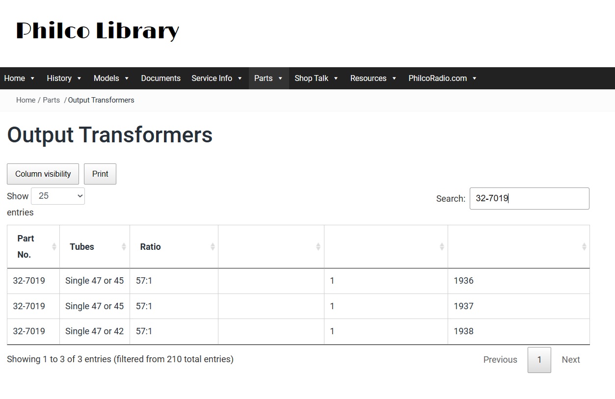

One thing confuses me.  In the Philco library for the 32-7019 output transformer (57:1) it list tube single 47 or 45 under heading "tube".  That's different than the 6F6.

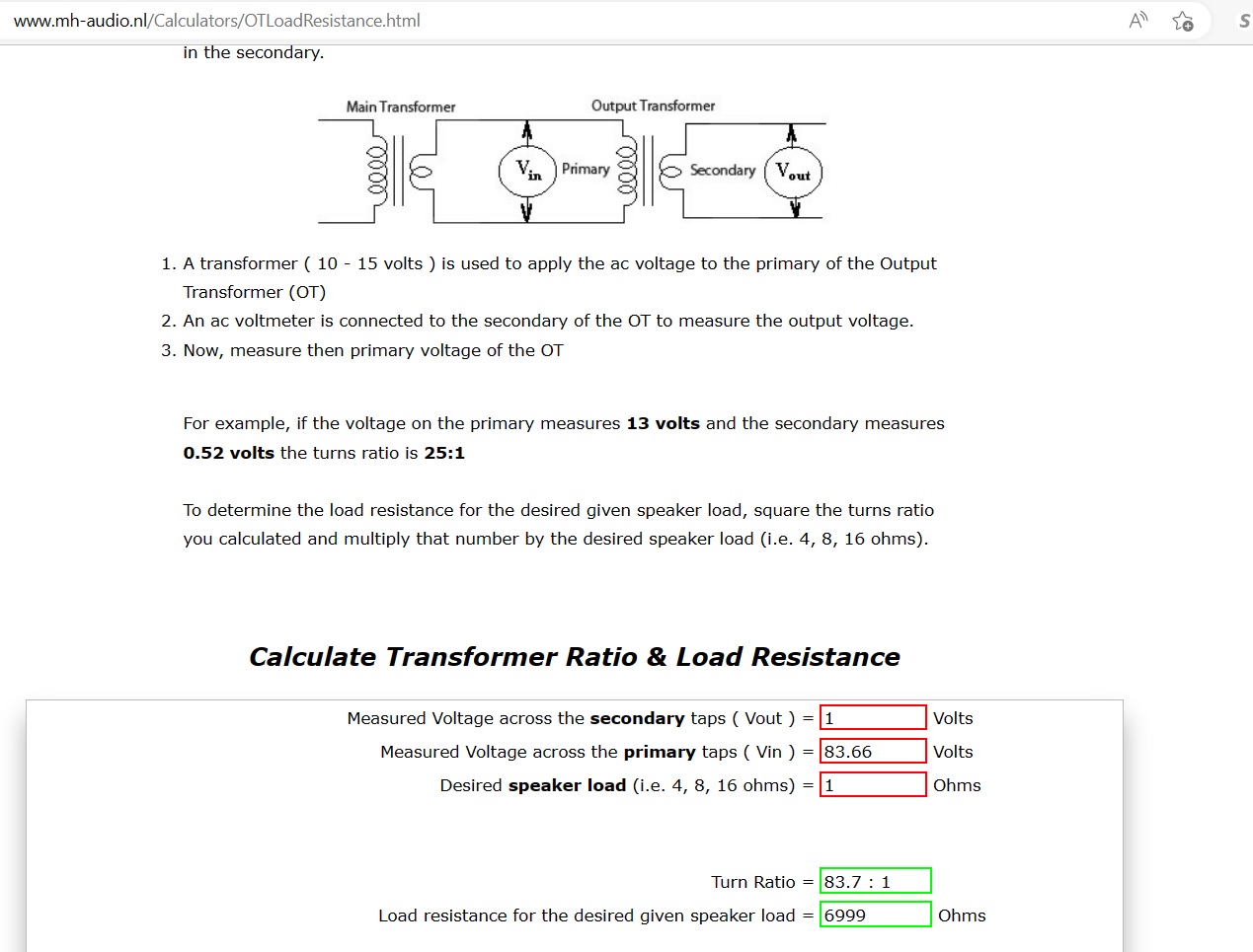

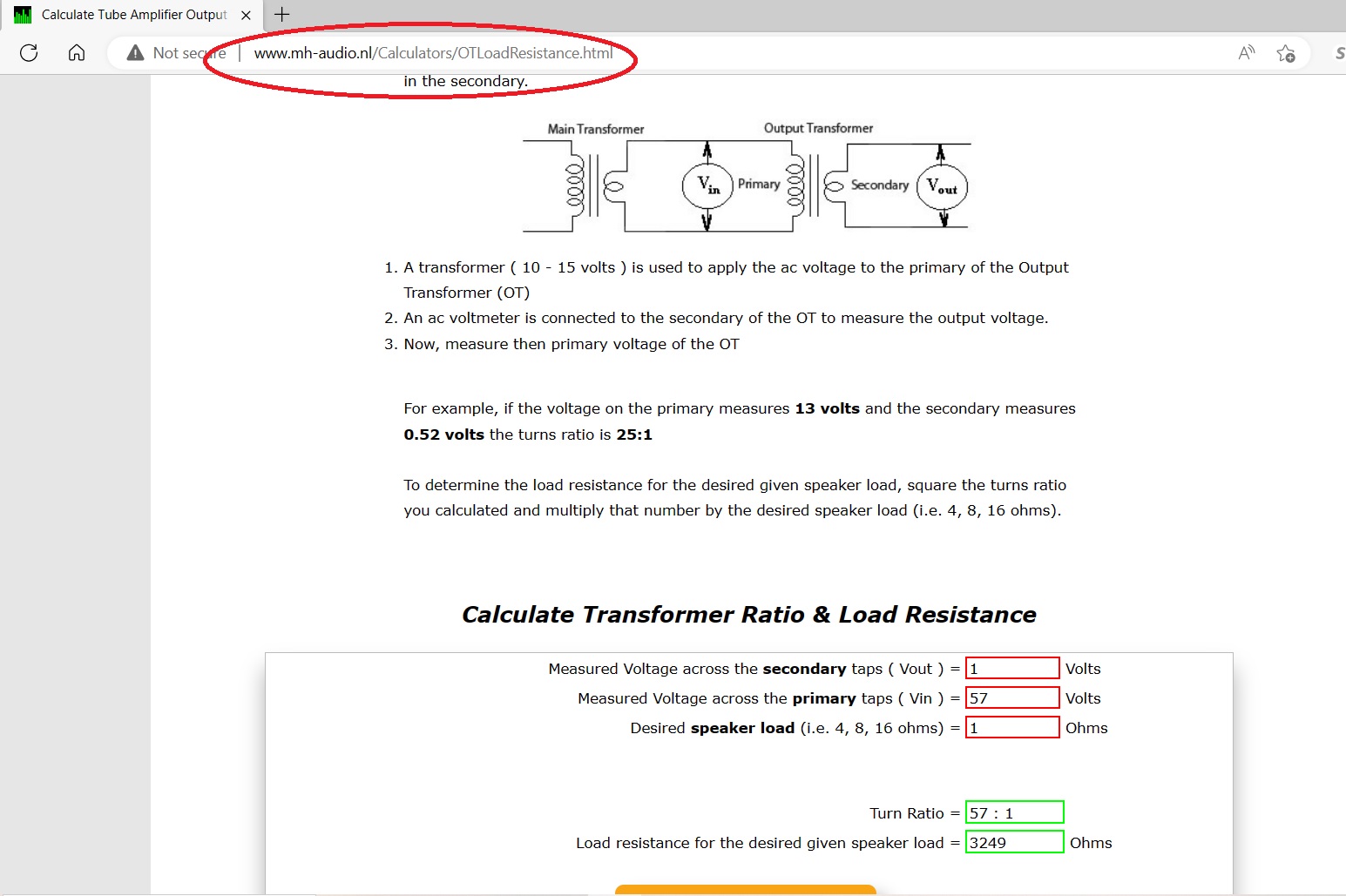

Chas -  another question is about the article & calculations. The 6F6 tube date sheets indicates 7,000 ohms.   Data for the 37-60 radio says an S-7 speaker with 1 ohm voice coil.
57:1 ratio for output transformer would equal 57 squared or 3,249:1 impedance ratio.  A 1ohm speaker would present a load of 3,249. That doesn't match 6F6 tube's 7,000 ohms.
Looks like the voice coil should be 2 ohms, or the transformer would be 83.6: 1 turns.  (Square root of 7,000).
Bryan

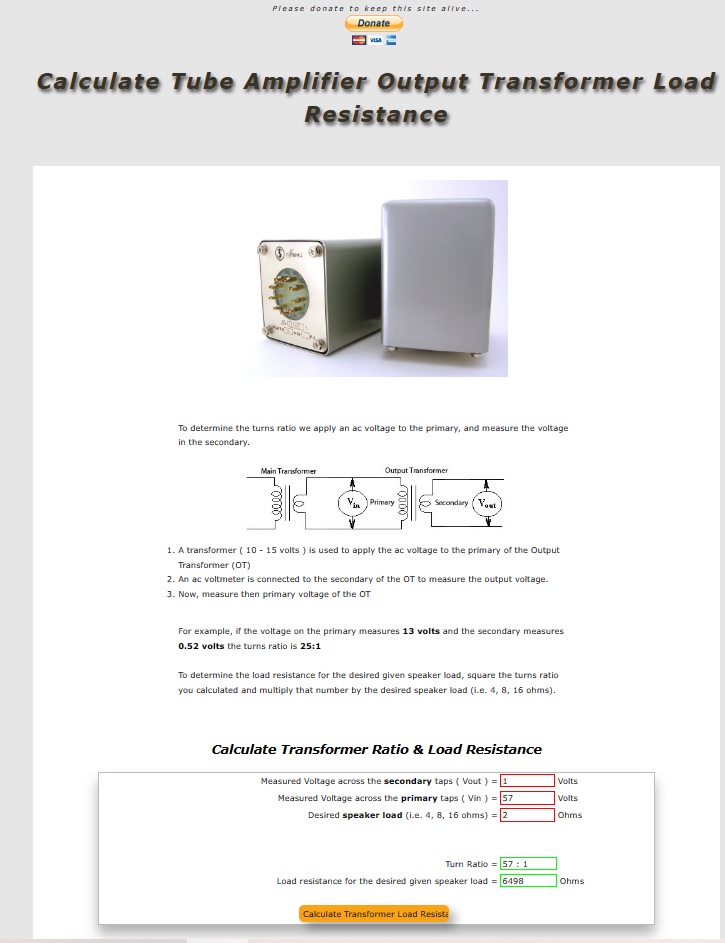

And last thing, I'll probably be out today.  Found this neat site later that verified my math.
So what is going wrong?  S-7 is not 1 ohm as listed?   Variable impedance according to frequency?  32-7019 not 57:1 ratio?

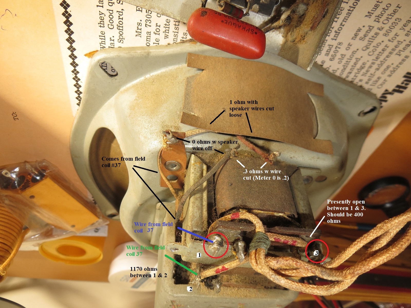

Little more time and the wife hauls me off to shopping.  I tested the speaker voice coil and other connections with the speaker coil wire cut loose. Figured I'd be replacing the transformer anyway. Voice coil is 1 ohm.

Just trying to find what ratio a new transformer would be.

Chas - Wasn't planning to run the speaker that way. I knew I'd have to at least replace the transformer, so I cut the voice coil wire at the terminal, then measured resistance with my meter. Got 1.1 ohms.
If I were to find an output transformer (single not push/pull type), it would have to be 7K impedance primary, 4 or 8 ohm (impedance) secondary rated 3-5W and hooked up to a NEW 4 or 8 ohm speaker (8 inches diameter mounting holes)??
