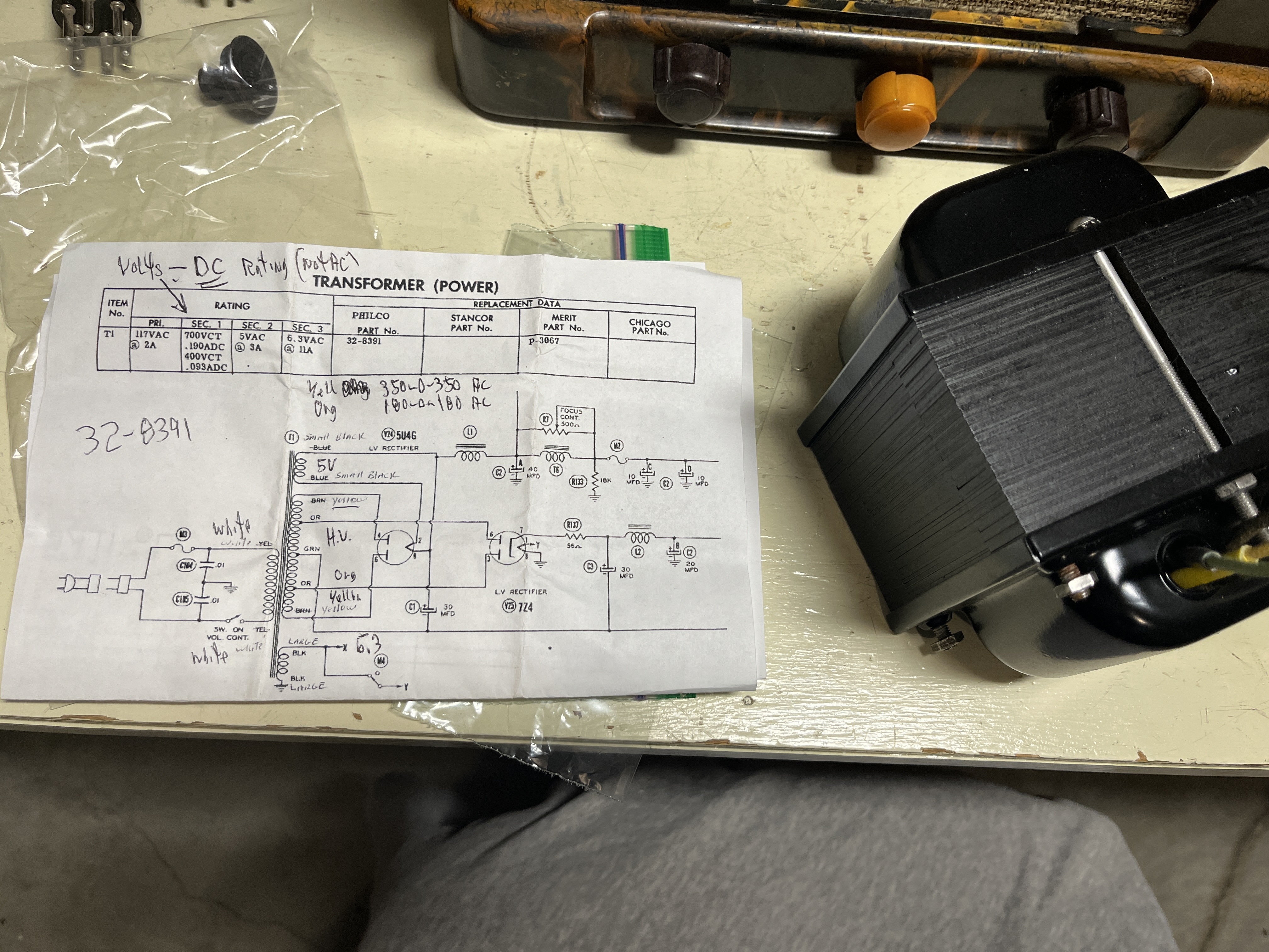

The transformer I located is from a Philco TV chassis, circa 1948. The part number is 32-8391
I do have the replacement transformer that was in the set when I bought it. It does work, and is larger than the original one. But it is an upright style, and therefore you would need to make an adapter plate to cover the hole. When I bought the set, the transformer was held in place by two bolts. The part number is PT-86

Hi Brad,
Thanks so much for the info! Do you happen to have the specs for the PT-86 transformer? I did not find a listing for that part number. At least you've given me some ideas on transformers to look for. I'll probably go looking on Ebay for some options. The upright style mounting doesn't bother me. There is enough room for that. I'm sure I could probably make a cover plate for the chassis. I'm not a purist, but I do like things to be neat and tidy as much as possible.
One thing does concern me though. The existing transformer has an offset center tap. I'm wondering if this was due to the biasing requirements and would some changes be necessary to use a true center tap transformer. Or am I just making more of this than is necessary.
