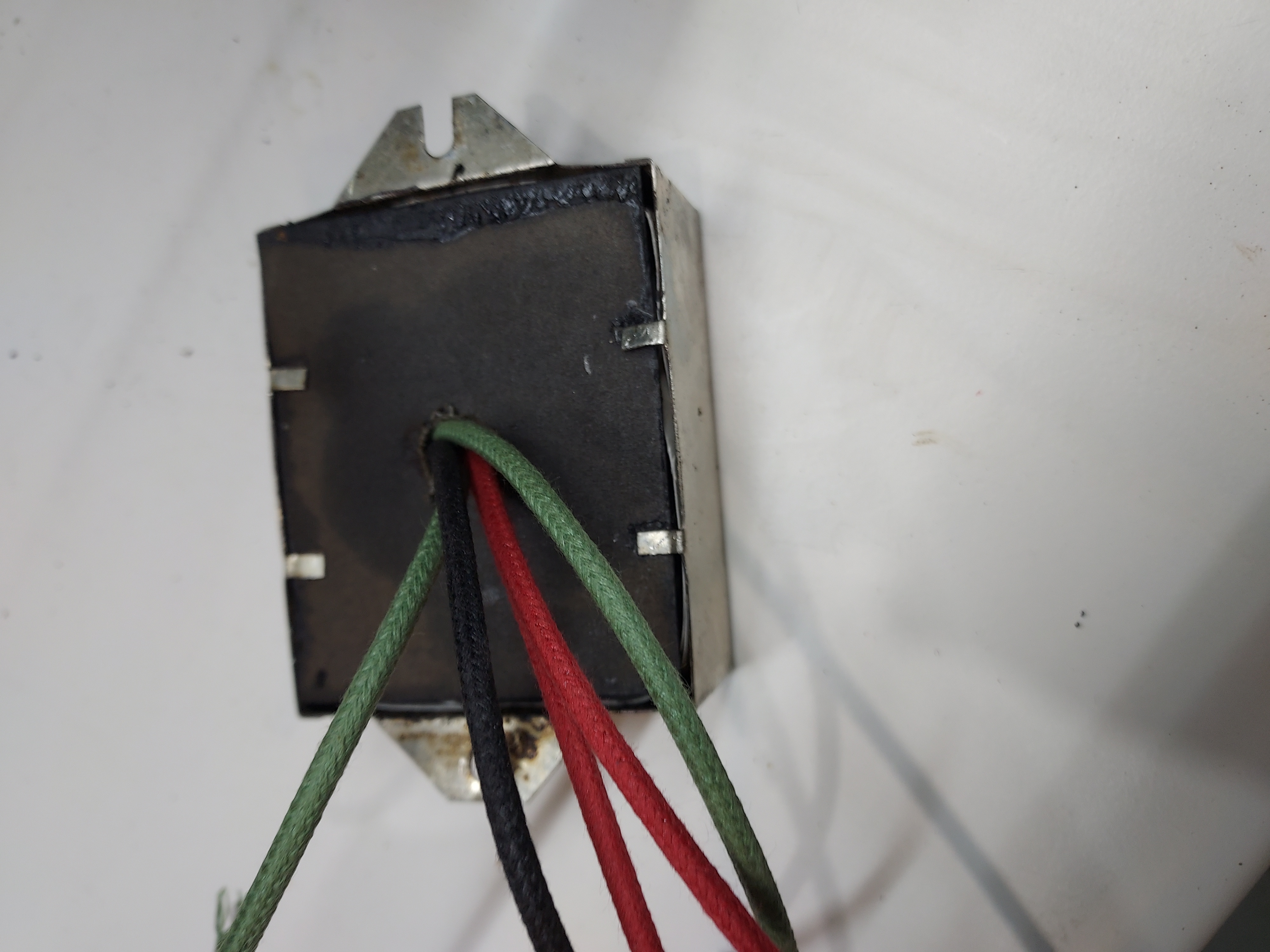

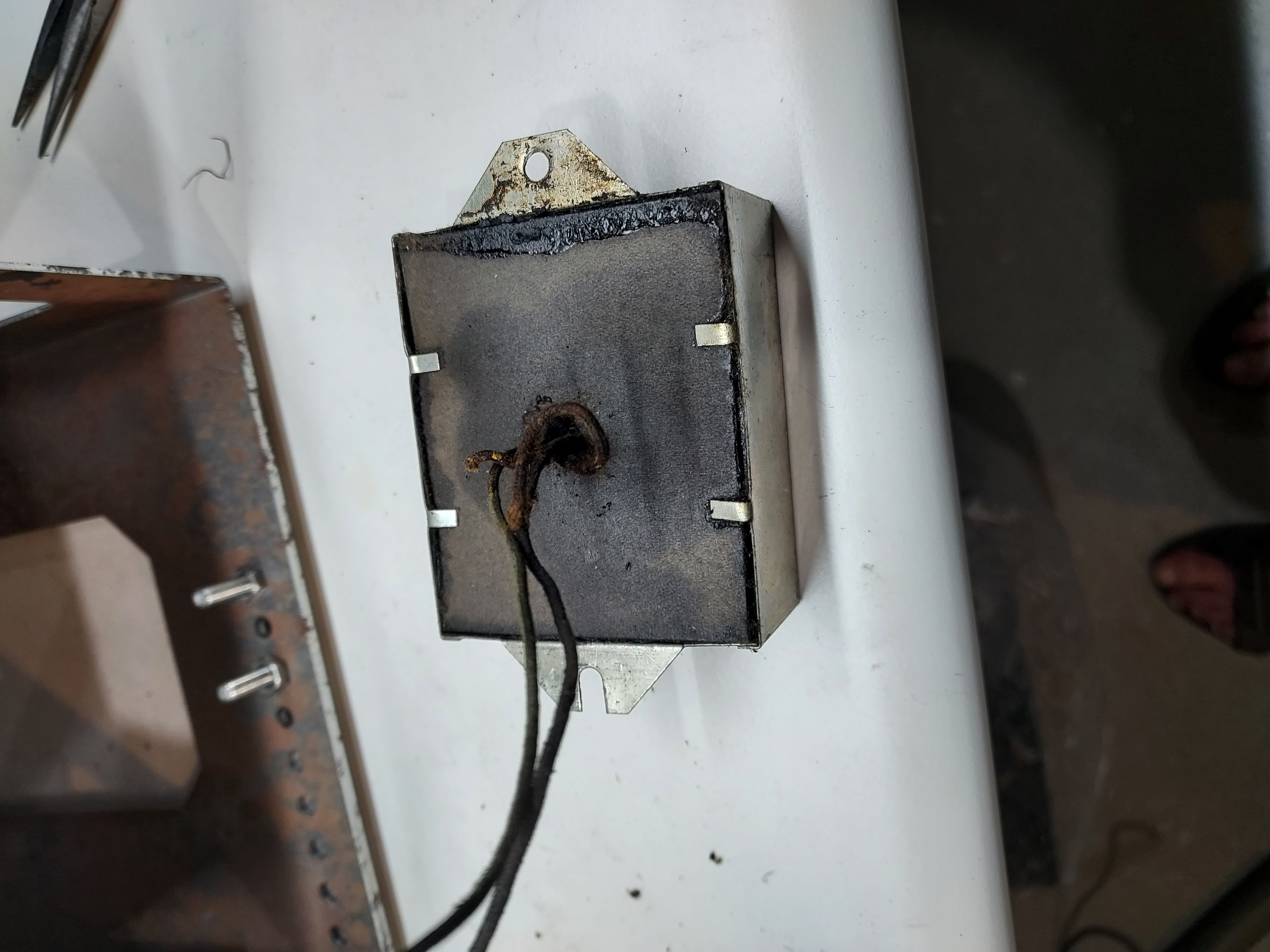

Have rebuilt the can.

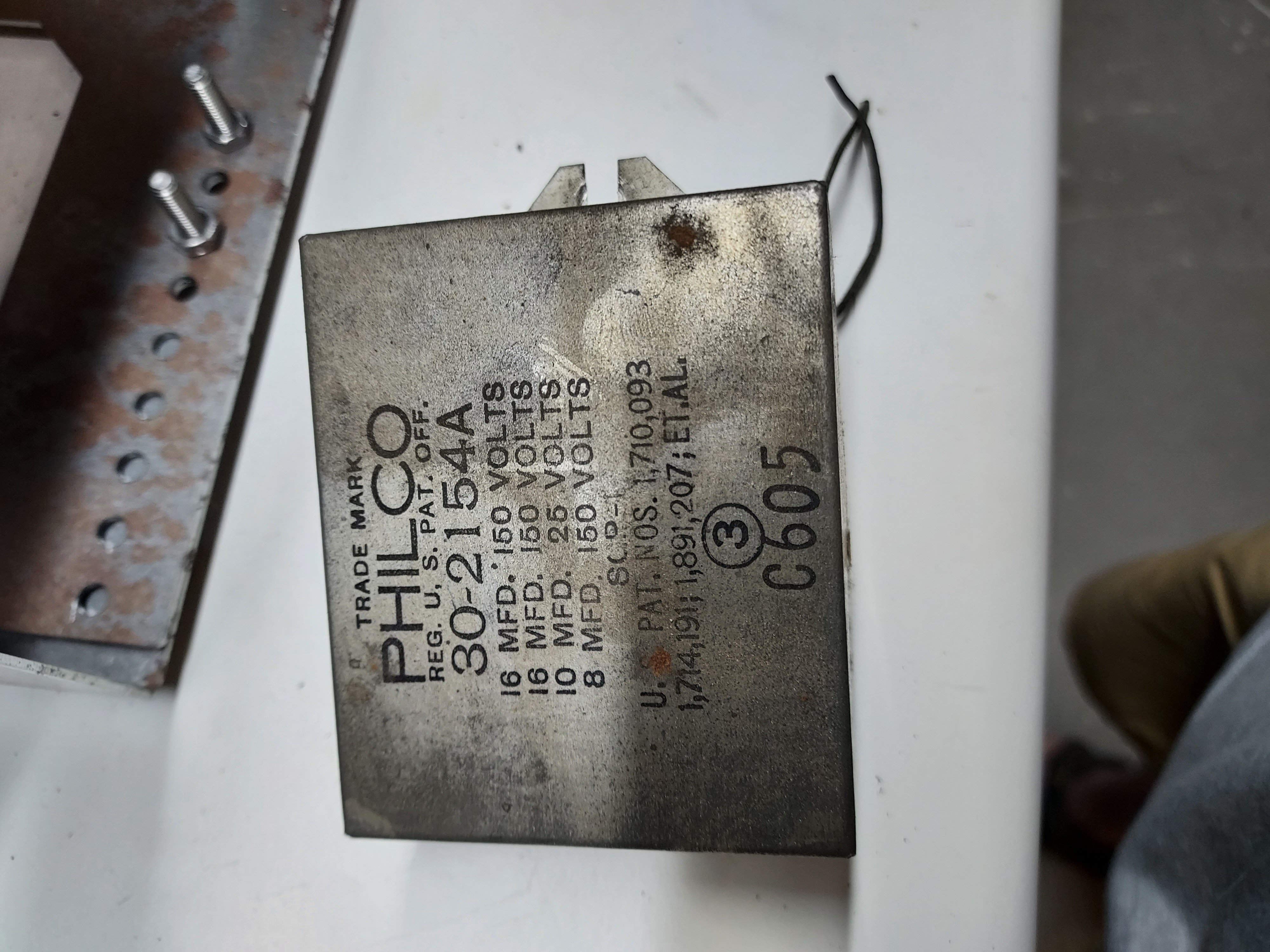

The can had 4 caps in it, 2x16uF, 10uF and 8uF.
I used a 15uF as the first cap, 22uF and 10uF as the two secondary after chokes, and another 10uF as the cathode feedback for the output tube.
The can is this

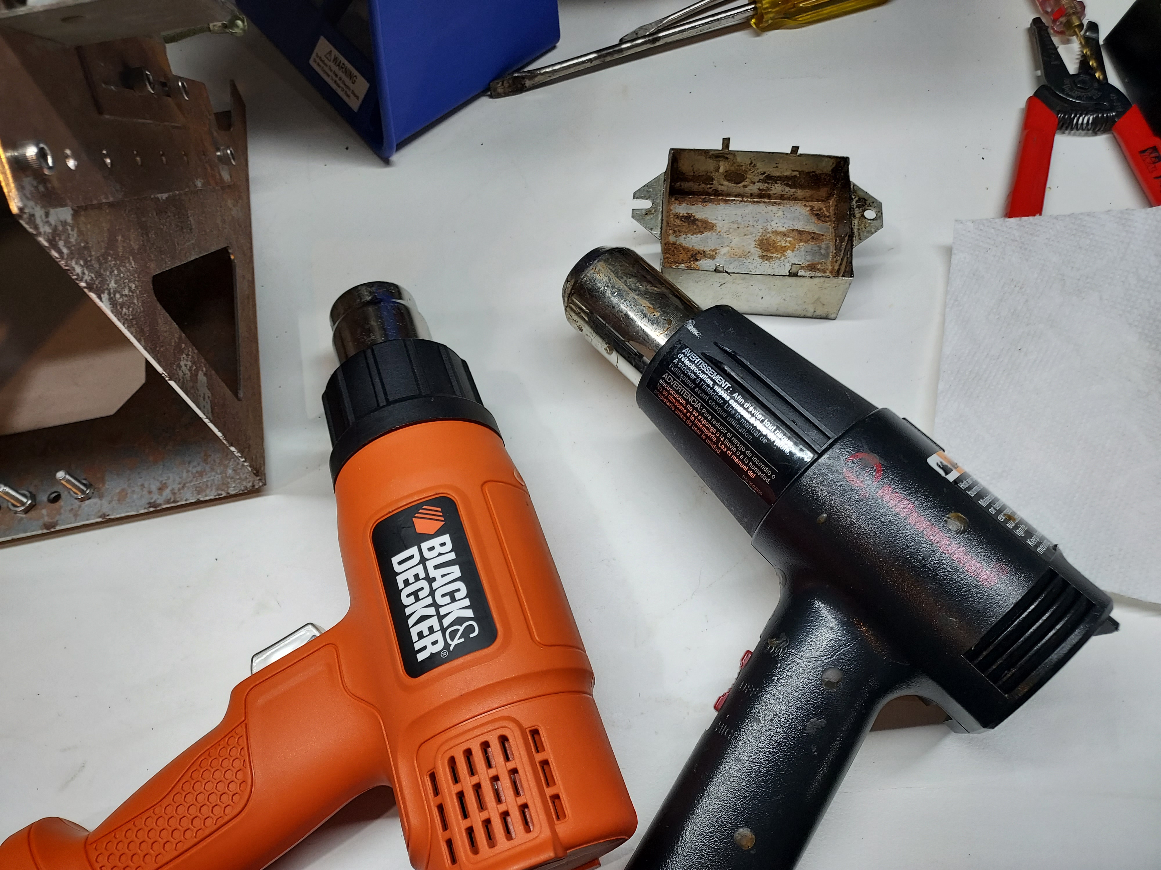

Took two heatgun to loosen the contents.
This is it rebuilt.
I installed it back, need to slder the rest of the wires, but it will have to wait as I need to clean that mess in there before I put everything back.
I also installed the choke. It is half-size of the original. I ordered 700 Ohm resistor to add up to bring it to 2200 ohm.

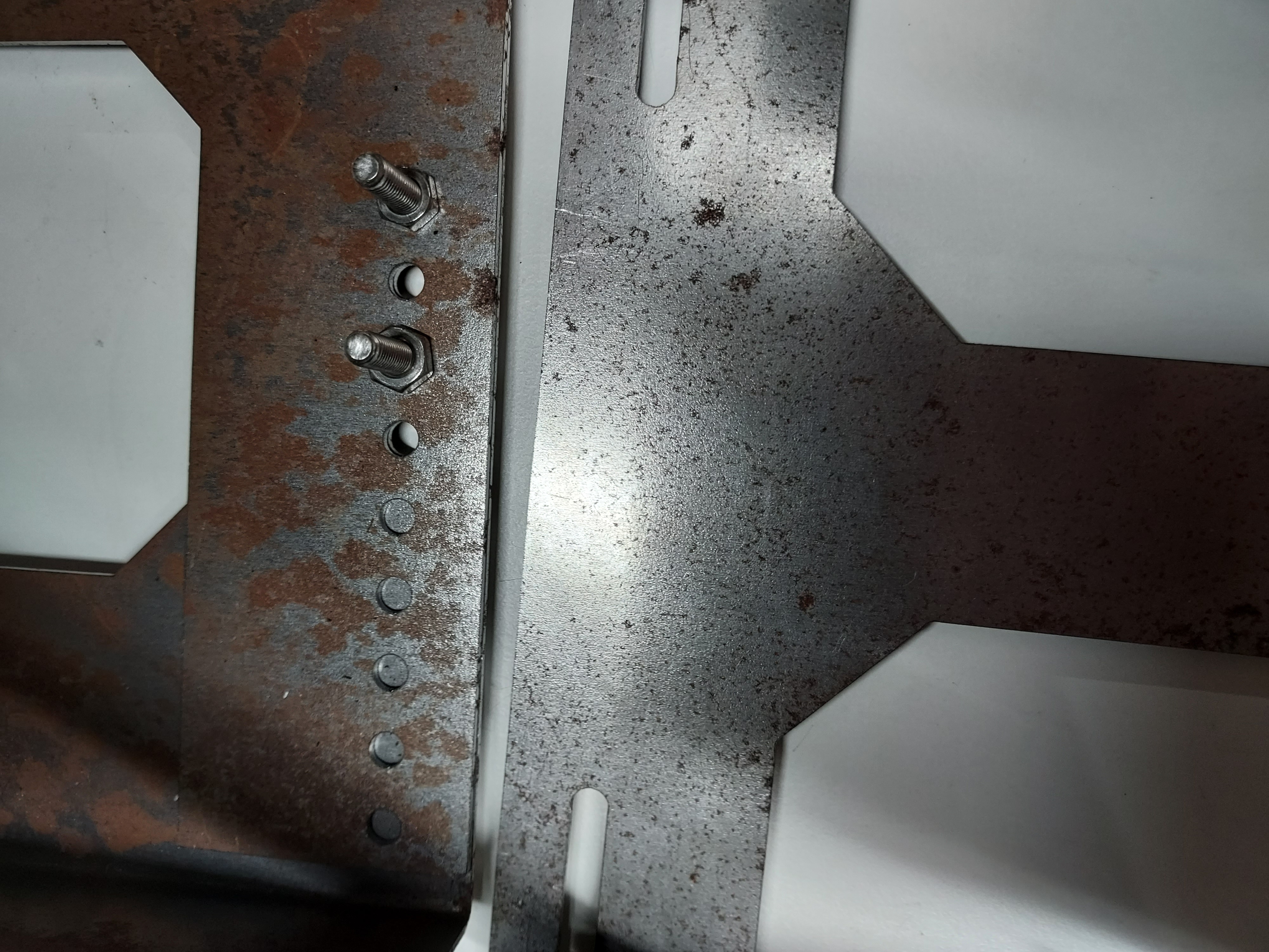

Hi Mike, the radio is coming along nicely but wow, you must have some serious moisture in your shop judging by the amount of rust on your chassis jig!
Ron

Here are the two of my jigs side by side. They have been with me about the same time (a couple of month difference possibly) and have been kept on the same shelf of the same stand all this time.
As you can see, they look fairly different. The bigger jig (I have just pulled it to put in the picture) look way bettrer, and has one dark spot which is, BTW, black, not brown, which indicates some different type of reaction. I guess, different type of steel.
This said, the rust is very superficial, no pitting.
The moisture in the workshop has never been really high, and now is even lower since they put the french drain, and after having faild to stop weeping, they also put a vapour barrier around.
Also I moved stereo out of the adjacent room with dehumidifier, which I kept close to keep the dehumidifier serving only that room, and now I have it open and it serves both that room and the workshop.
Also in the winter it is dried up by heating during the nighttime (the firnace is there, and so is a register in both roome), and in the summer by A/C, also during the night time (the cats live there, so they are locked during the night and so I run the furnace/AC).
But this said, in the workshop there have been no musty smell, I do not see anything else rusting/decomposing; this one was the only piece that showed the rust.
The only smell that is present in my basement is the smell of cardboard boxes, and I recently got rid of half of them (remember, I wrote about dealing with mice activity this August?), so it became much less pronounced.
Anywho, there is not anything superbad there. Green nefarious goo no longer drips on me off the ceiling, when I work there

Hello mike,
My Stand also has some very minor rust too and mine is used inside my heated house .

That is strange for there to be that much difference between those to jigs of raw steel! I know my basement has caused a slight rust coating on some of my carpentry tools, hand tools and table saw. I have moved my radio shop upstairs to my sons old bedroom just because it’s much warmer in winter. Gotta watch for the green goo

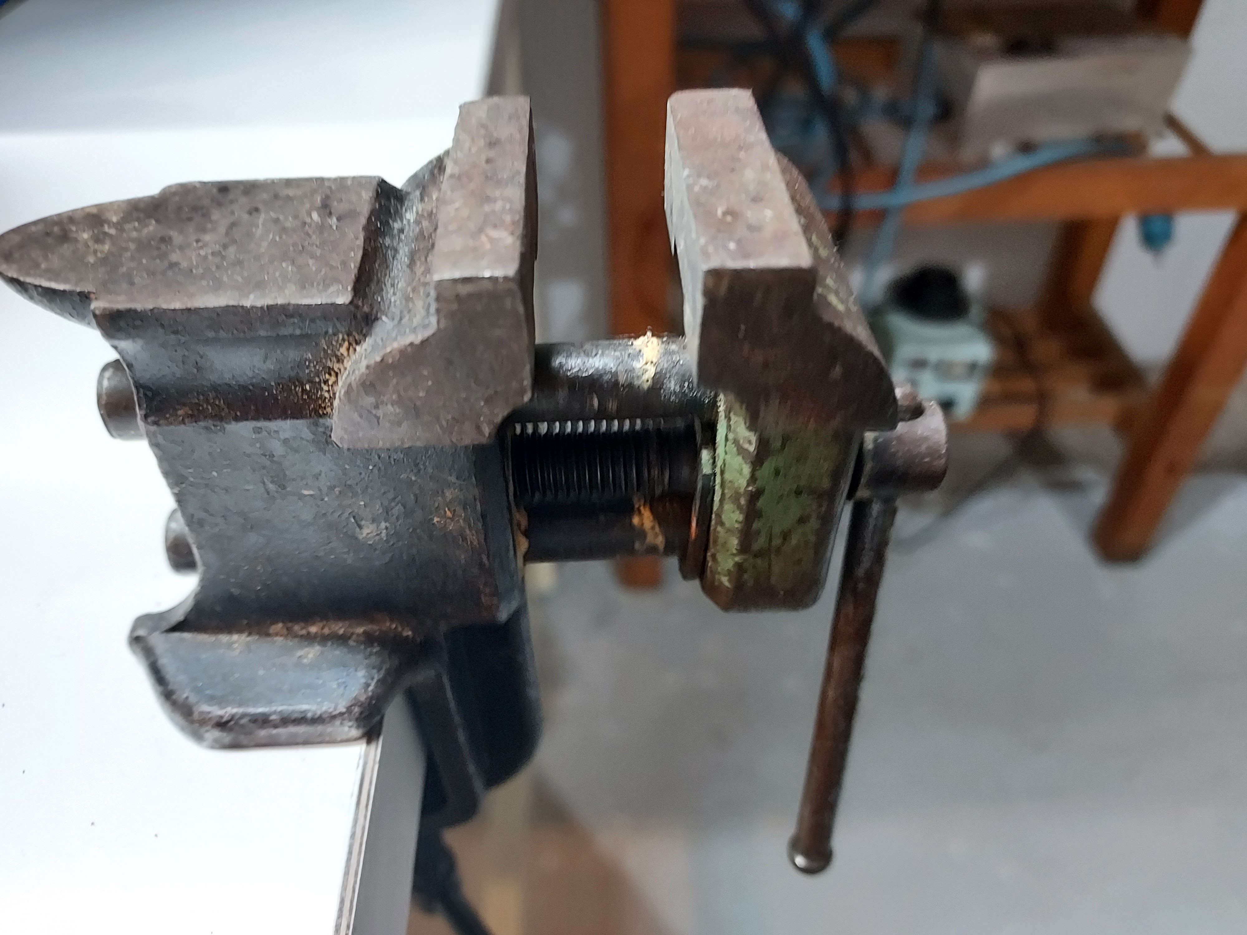

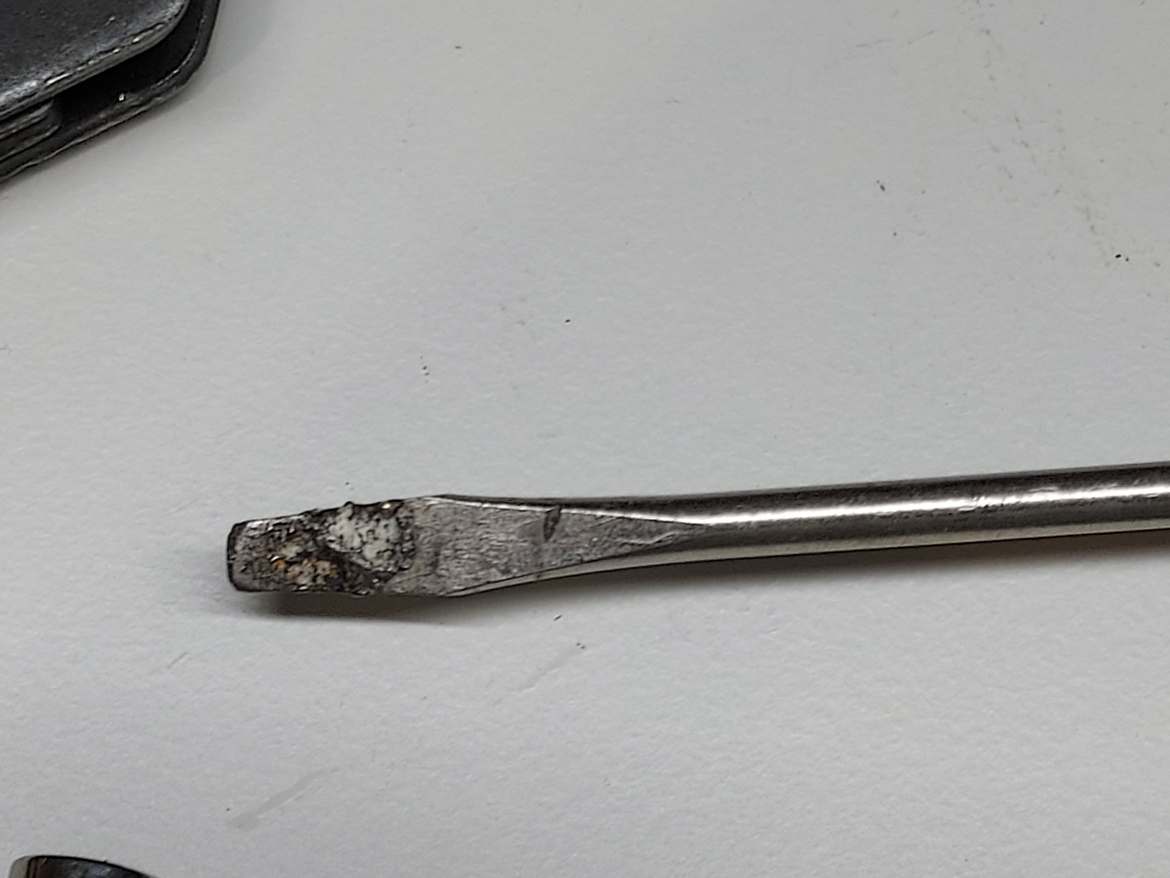

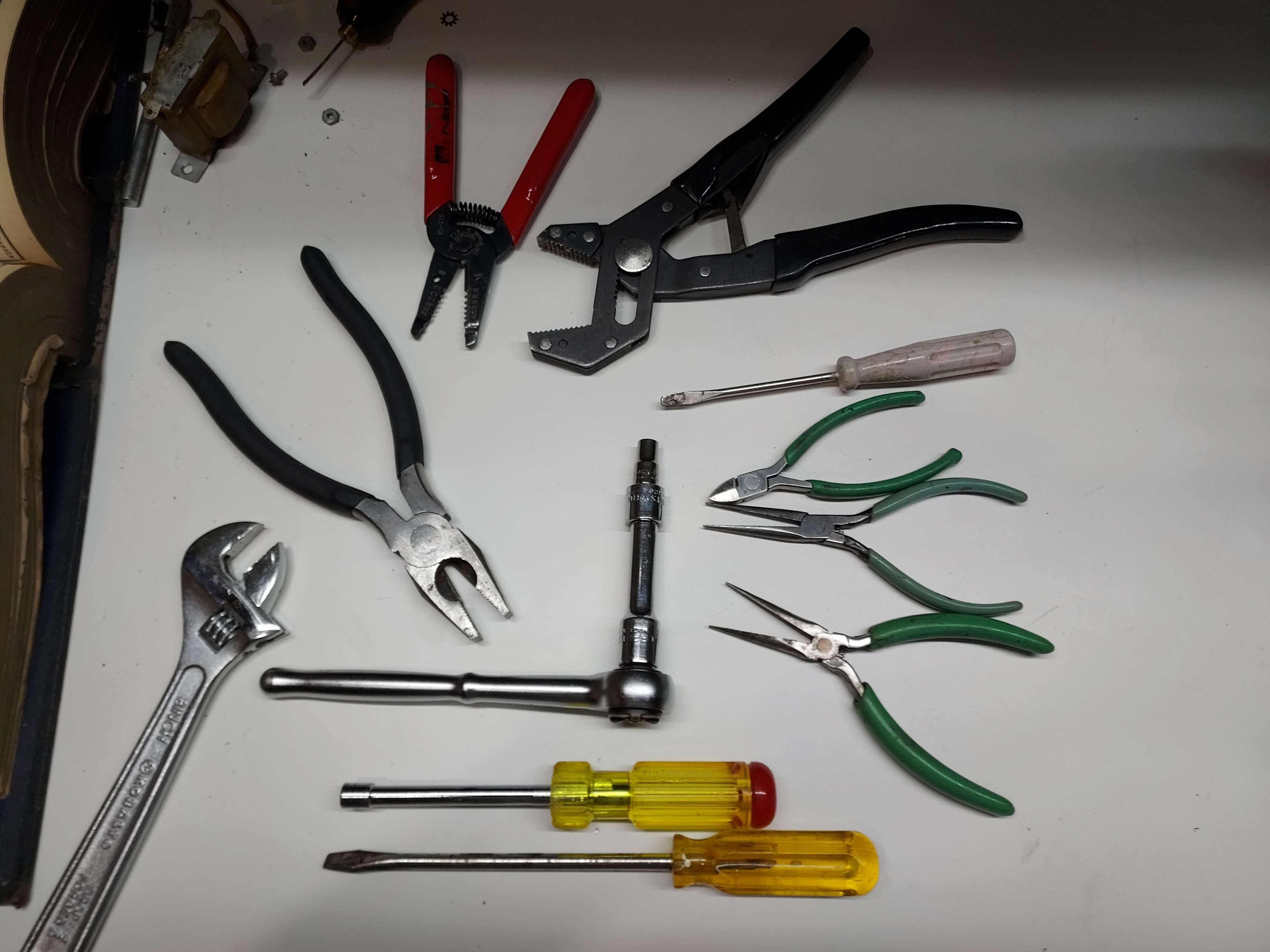

I have all my tools in the same shop, in the open, anything from spanners and screwdrivers to chiesels, pliers, drill bits etc.
None has it. Except one big old flat screwdriver, which is not rusted but pitted a bit, and I got it that way, long before moving in this place.
Dunno. A mystery.
Posts: 16,577
Threads: 574
These are my tools, have been in the shop for years.
This is the tip of that screwdriver.
It was given to me when I was 9.
The damage is from shortin 220V.
The vise is also from my childhood, given to me by my grandpa. Obviously, it has patina. But no rust.

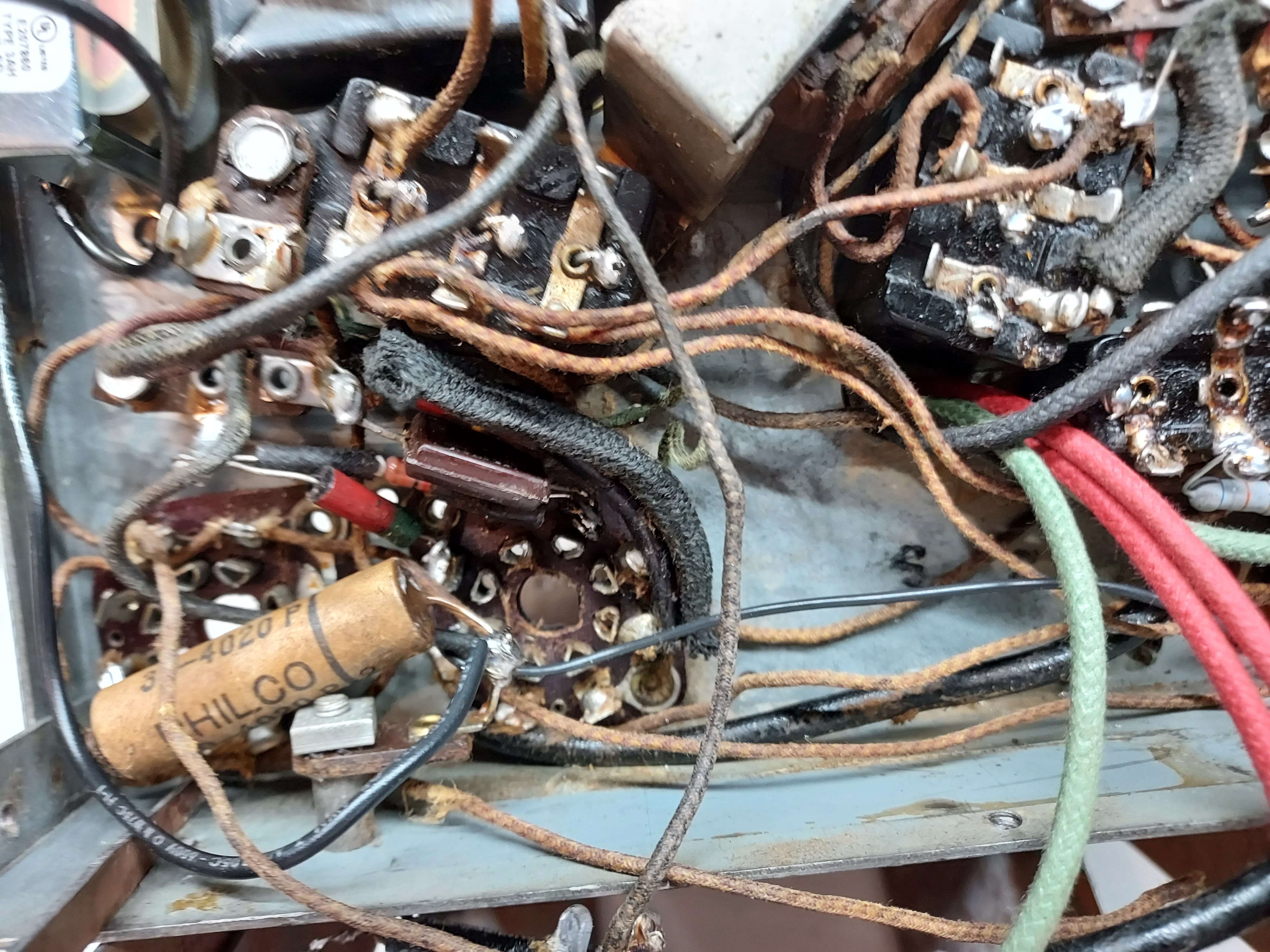

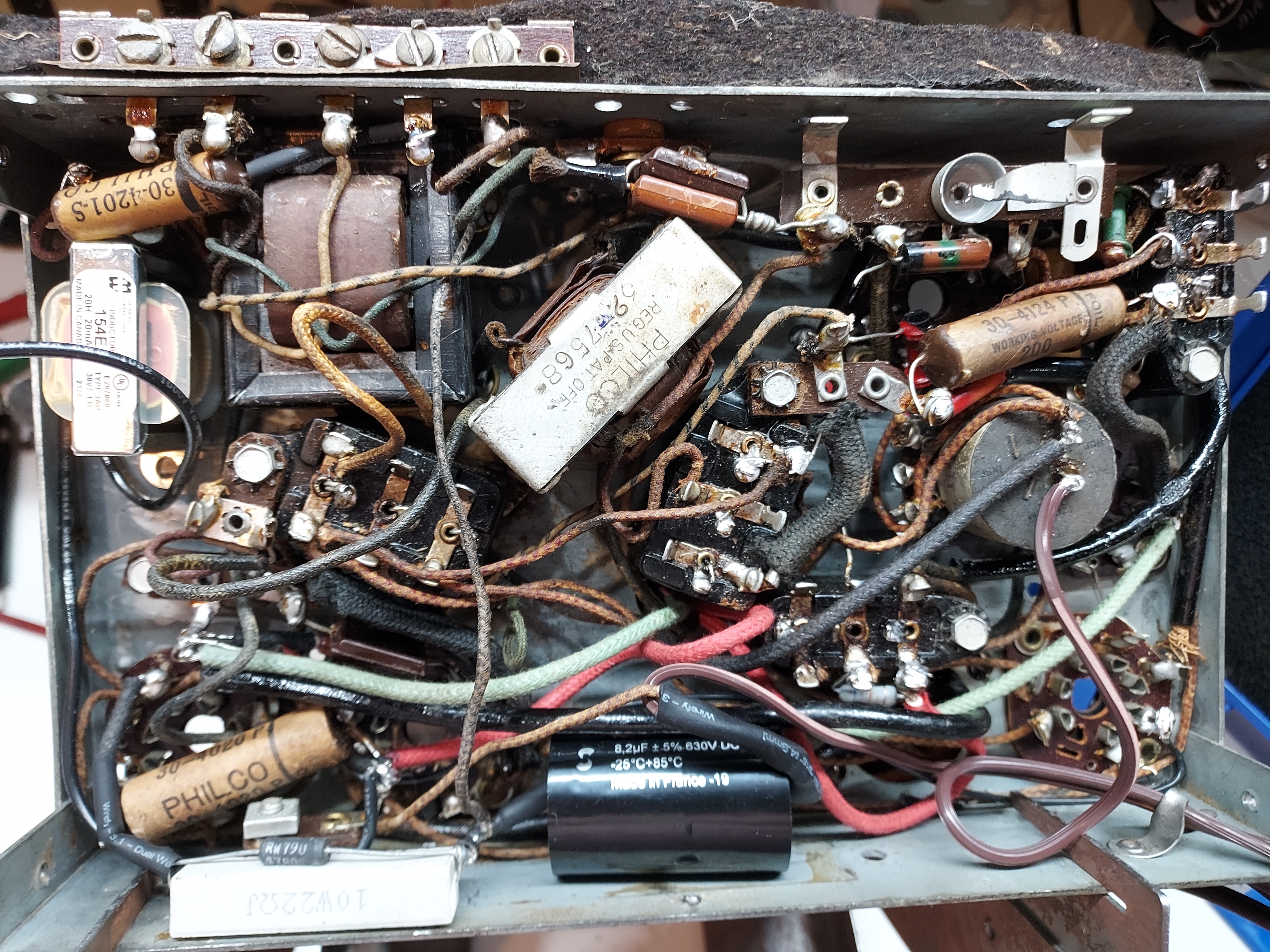

I've cleaned that stuff, the "rendered" wire cloth stuck to other wires and the chassis. The previous photo is at the Page 2.
After that I replaced a couple wires that seemed affected, and then put back some tubular caps.
Then I put together the filament dropper network, that is the cap 8.2uF and 16 Ohm resistor (for pilot lights), installed the power cord.
I am waiting for the 700 ohm resistor to come, as it needs to be in series with the choke, and then the last tubular cap, when I decide how I handle the battery circuit.
