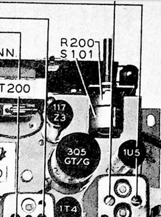

If you have not done so, press that tab that operates S100, the Line / Battery switch up and down several times.  Re the power switch, take a good look at it.  There should be 4 contact lugs on the power switch, 3 contact lugs on the volume control.  There is a shield over the power switch connections to prevent electric shock, as there is no interlock for the rear cover.  This shield covers the 4 power switch lugs.  A pic from the similar 46-350 is attached below:
To clean this switch or check its continuity, you need to loosen the hex nut, slide the switch from its bracket and pry off this cover.
This is a "DPST" (Double Pole Single Throw) switch.  One "pole" of the switch switches the A-, B- and Line Power return.  The other pole switches B+.  A and B batteries are both switched so as to prevent discharge of the batteries through capacitors.  Note that for Line Power (AC or DC House Current), the "neutral" is switched.  This is one reason why you cannot use a polarized cord on these portables, as they cannot be rewired to only switch the "Hot".  The other reason is for those radios, which, like yours, require the user to plug the power plug into a "socket" which operates the Line / Battery Switch (S100 on your set).
This is what is known as a "warm chassis" set. The "ground" (common A- and B- return) is isolated from the chassis, but to pass RF, a 150KOhm resistor and 0.05uF capacitor couple the RF signal to chassis ground while limiting line current. Whether the chassis is at "ground" potential depends on the polarity of the power cord and whether the power switch is on. For example, if the switched leg (the A-, B- "ground) is connected to neutral based on how the plug is inserted into an outlet, the chassis will be at ground potential with the power switch on, but with the switch off, the chassis becomes "warm" (connected to the hot lag through the cap, resistor and the cold 117Z3 filament.
Refer to the schematic and trace the wiring as best that you can.  The AC/DC Line Power - Battery Switch is drawn in the AC/DC House Power position.
