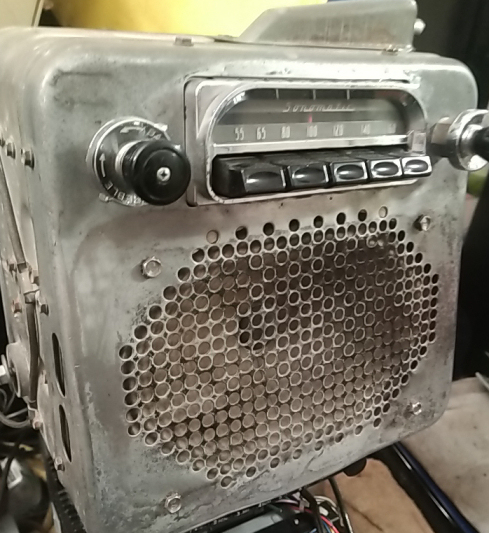

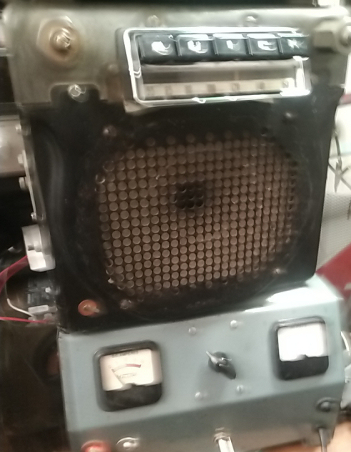

462ron, here are two bad photos of the two models of Buick radios I have.

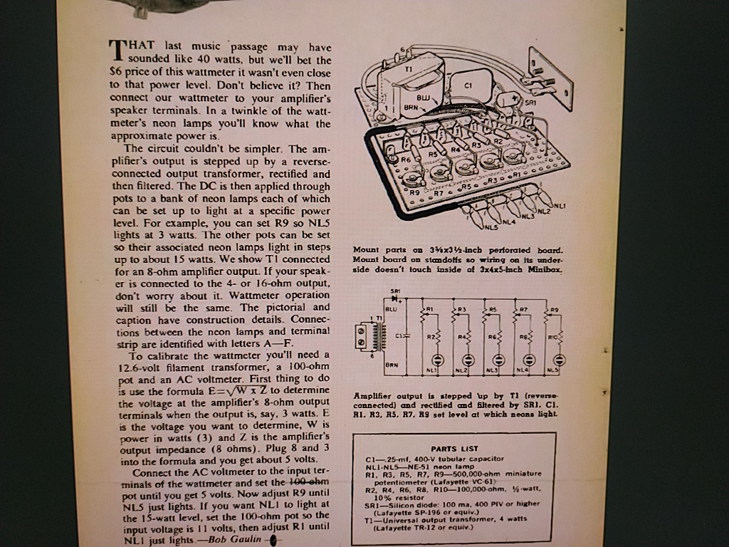

here's is a novel audio watt meter display from the same 1964 Electronics illustrated magazine.
It probably wouldn't be too much of a stretch to imagine somebody from that time making a honeycomb cluster shape of those neon lights for cool factor.
It says $6.00, but wasn't that like $50 in todays money?

462ron well if your father bolted anything to the top of that radio, than it rules out the newer 1954-
12v Buick Sonomatics because they have a big metal scoop up top for the dial light.
In the boxy 980868 model before, you had to go through hhhhhell just to change a burnt out bulb. Awkwardly get the radio (which weighes almost as much as a small bowling ball) out from behind the dash, and taking the radio apart to get to the bulb!!!
I gues on the "next gen" 12v babies all you need to do is reach behind and yank on the metal fitting, pull out the spring thing and change the bulb. Put it back in.

Oldie, those radios you posted look somewhat familiar but then I was only 10 at the time and didn’t really pay attention to it much. The only car radios I have sitting in my attic are one from a 70s Chevy, all solid state and a unique AM only radio from a 69 Mercury Monterey. That radio is unique because instead of having the on-off/volume on the left and the tuning control on the right, this radio has both controls next to each other to one side of the dial scale. It was from dads car and I replaced it with an AM/FM radio from another Merc. I imagine the aftermarket radio business is all but dead today as most cars have the radio buried in with the back up cameras and touch screens that control air and heat and navigation. Even an older 97 Ford Escort way back then had the radio in an oval shaped pod along with other things. Gone are the 2 knob simple rectangular radios of days gone by!

Does that Buick Sonomatic have a rear speaker jack? Does it use a 0Z4 or a 6AX5 as a rectifier (or heaven forbid a synchronous vibrator)?
In keeping with both what Philco did (Yeah, I know that these are Delcos), I would find a power transformer from a late 1940s radio that did not use an electrodynamic speaker but did use push-pull outputs (may have to be from a Philco, as they used 6AX5 or 84 rectifiers that ran from the same 6V winding as the rest of the tubes. It will likely have to mount externally. The Philco Service notes do not show the power transformer (Item #74) in the radio chassis. However, in the original C1908 from which this radio came from, the invertor transformer is mounted inside. This makes sense, as the transformer needed to merely develop the power for the B+ is much smaller than a transformer that has to develop the filament voltages (and a separate winding for the rectifier filament if a 5Y3 is used.
