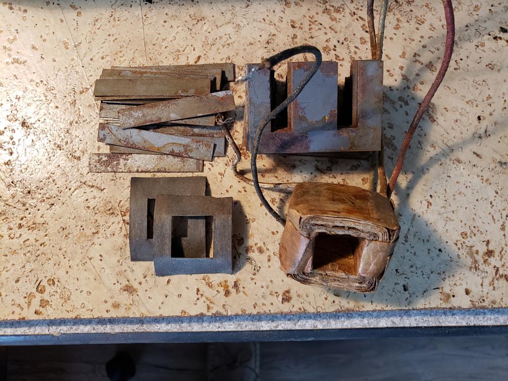

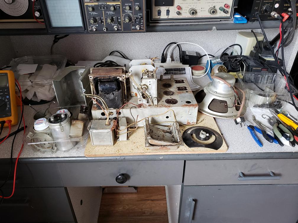

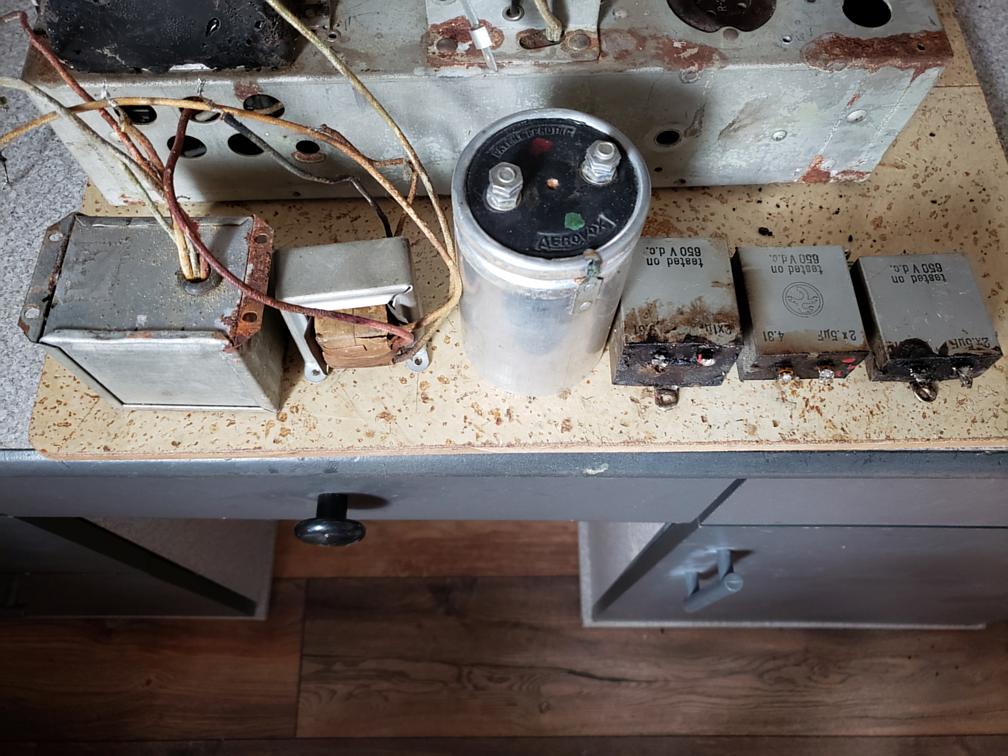

The chassis is ready for the next steps - cleaning, repainting, restoring dead components.
All dead parts are removed and disassembled for restoration, also the some chassis parts are removed for separate repainting.
As I expected, unfortunately, both audio transformers have open coils. This will be a big headache for restoration. But as you can see in the message above, for some people it is not a big problem Icon_smile .
Also, all the capacitors are bad. All of them show a maximum resistance of 0.5 - 1 mOhm. But repacking them is just toys with a transformer problem.

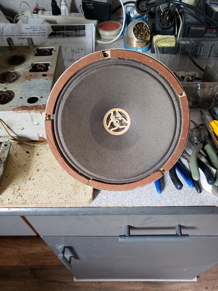

But the good thing is that the speaker is in excellent condition.
Okay, the next step will be cleaning and repainting all dirty and rusty parts of the chassis and repacking the capacitors.
I will continue to report on the restoration process.

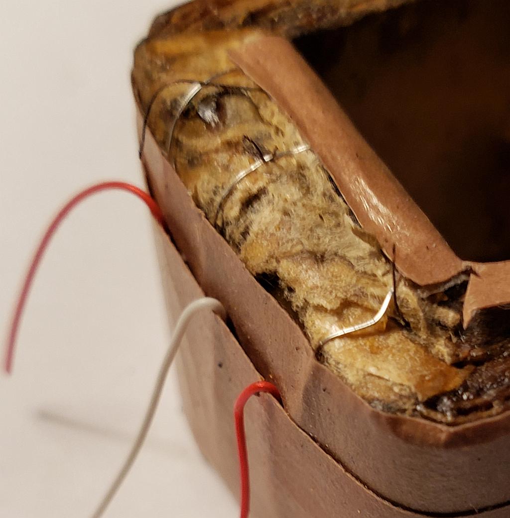

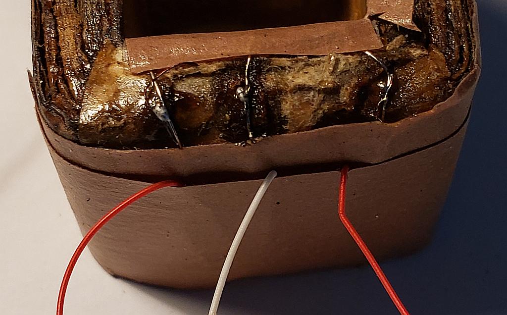

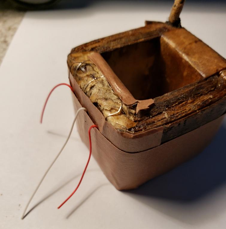

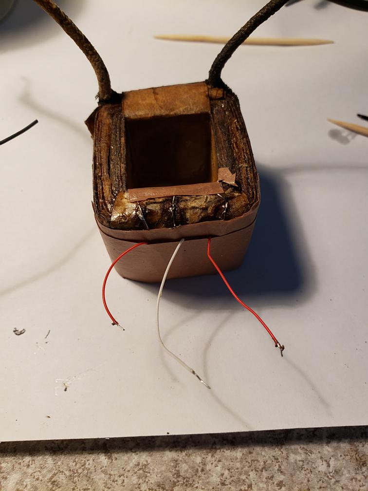

Today I tried to restore the output audio transformer. The primary windings were completely open. Usually in 50% of cases, in my experience, such a problem is a consequence of corrosion of the soldering points of the primary wires with the output terminals or wires. Usually the ends of the windings are brought out to the outside of the coil, and not inside (in this case, only a complete re-winding can help) and already from the outside they are soldered to the terminals.
Okay, I'll try.
First, I disassembled the transformer and removed the top layer of insulation.
Yes, I was right. The soldering points are completely eaten away by green copper corrosion. New additional connecting wires were created for soldering the very short remains of the ends of the windings.
Soldered them all
And ...
Yes, now they are not completely open, but the resistance is about 200 kOhm - 1 mOhm.
In any case, apparently, there are corrosion breaks inside the windings. There was no easy way. More brain-twisting and headaches will be required.
Fun continue.

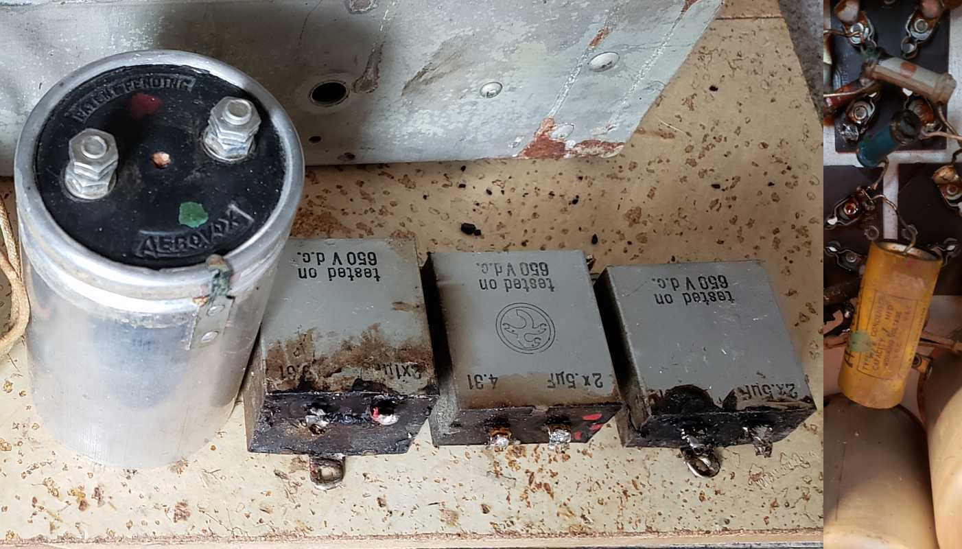

This is an electrolytic capacitor
8.0+8.0uF x 450V.
Paper capacitors are:
1.0+1.0uF x 650V,
2 x 0.5+0.5uF x 650V,
0.1uF x 650V.

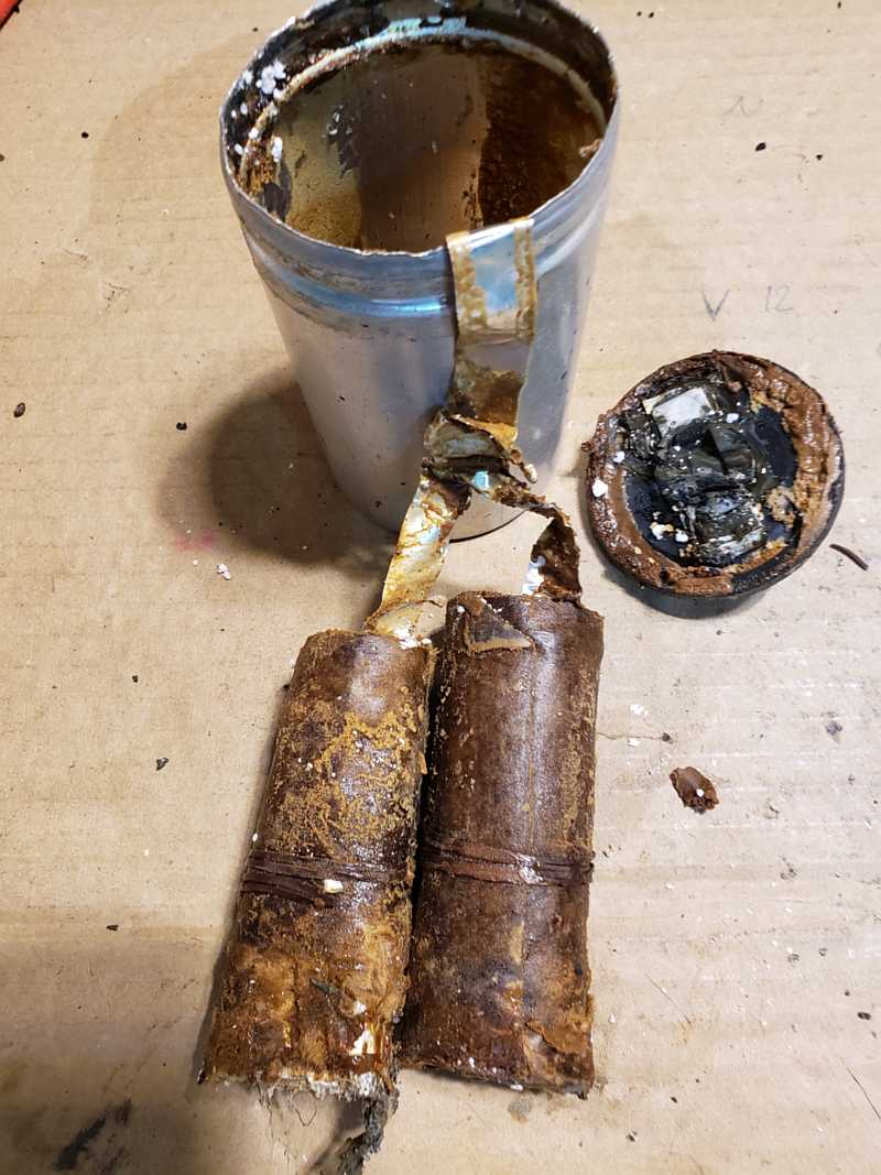

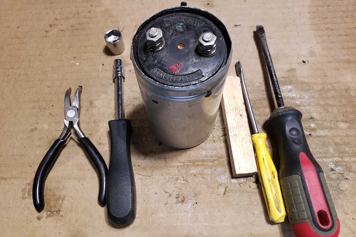

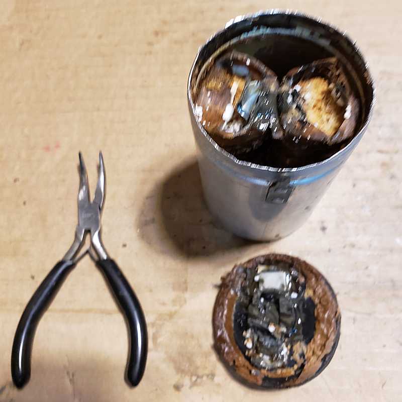

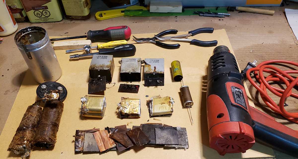

Let's open up the large electrolytic capacitor.
Carefully flare the case with a screwdriver, a wooden mandrel, pliers and socket heads to align the edges of the case.
And remove the two rolls of foil and paper.
The output connections are aluminum and will be replaced with solderable parts.
If you want to work, lie down and sleep, and everything will pass.
#38

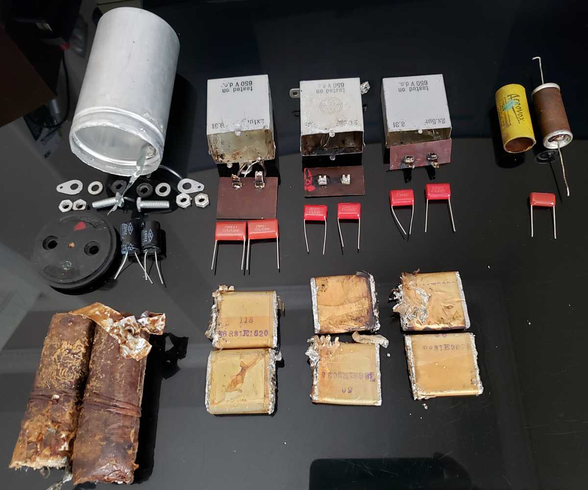

The square paper double capacitors were disassembled using a heat gun and a few handy words.
The small 0.1 mF capacitor was easily disassembled using pliers and a small hammer.
#39
All capacitor parts were straightened and cleaned. The following parts were selected to replace the capacitor internals:
electrolitic caps - 22uF x 450v
ceramic caps - 1.0uF, 0.63uF, 0.1uF x 650v
