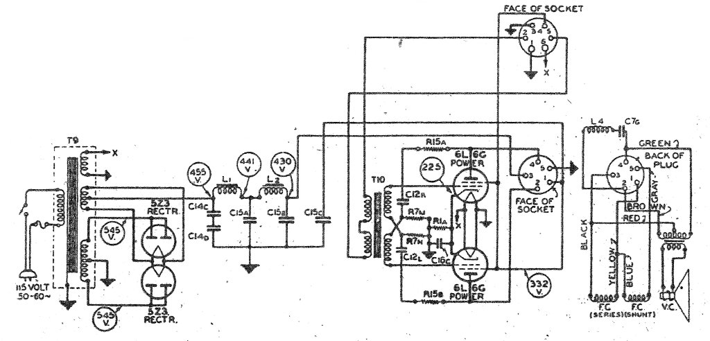

I found my Masterpiece VI schematic, and it tells me that the voltage going in to the 680 ohm section of the speaker field is 430 VDC, and 332 VDC on the other end, so the 680 ohm field drops 98 volts. Using Ohm's law, I = E / R, the MP VI will have just over 144 mA of current flowing here - more than Leigh's solid-state filter choke can handle, which is as I expected.
I'll have to either go ahead and use a resistor, or possibly explore an alternative design for a high-voltage, high current regulator. (Any and all ideas on this subject are most welcome.)

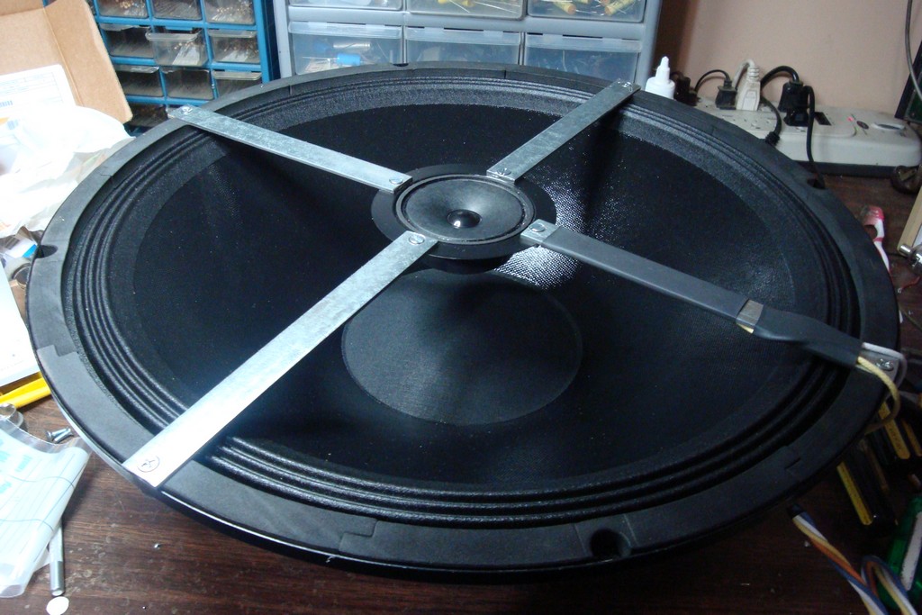

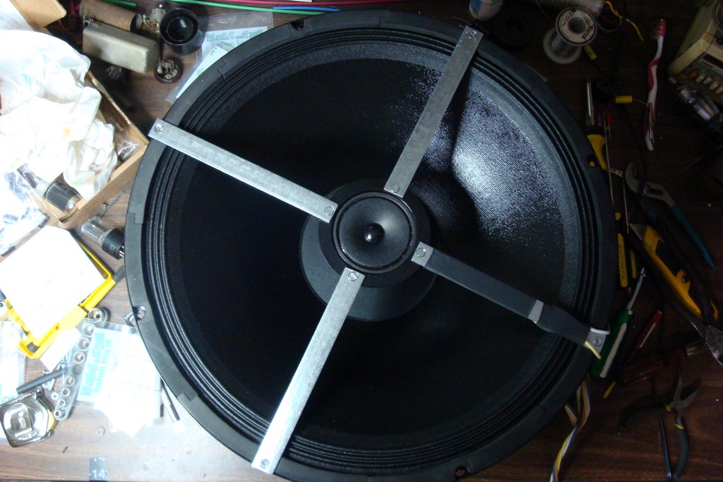

I found that two of the four arms that attach to the woofer had the holes drilled in the wrong places - they were just a bit off, which was keeping the tweeter from being suspended flat as it should. A little work with my Ryobi "Dremel" tool and a special bit designed to enlarge holes in metal, elongating the two mounting holes, cured the trouble and the tweeter then attached to the woofer just fine, no problems.

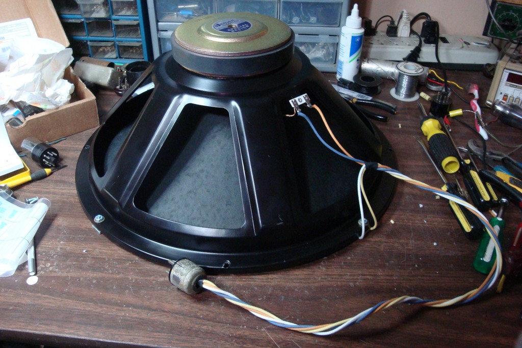

I attached cloth-covered wire to both speakers for that "authentic" look, and a 4-pin Amphenol plug and cover on the end of the speaker cable.
I also used some large shrink tubing to hold the tweeter wires to one of the support arms:
[Image: http://www.philcoradio.com/images/phorum...0c5ab4.jpg]
[Image: http://www.philcoradio.com/images/phorum...e49b42.jpg]
Another view of the coaxial speaker, showing the speaker cable and Amphenol plug:
[Image: http://www.philcoradio.com/images/phorum...a174c5.jpg]

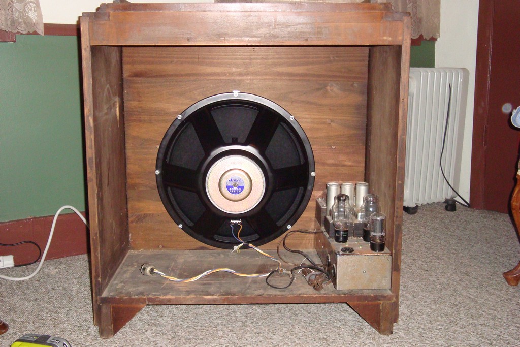

Next came mounting the speaker in the Clifton cabinet. I used two layers of stick-on speaker gasket material to ensure a good seal between speaker and cabinet. My cabinet had holes drilled around the speaker opening, but they were not spaced properly for this speaker. So I drilled four new holes and attached the speaker to the sounding board with four #8 wood screws.
[Image: http://www.philcoradio.com/images/phorum...da9d78.jpg]
No pedestal on this speaker, but it will have to do.
The speaker cable will plug into a project box I have yet to buy - this box will hold the 2-way crossover and the power resistor to take the place of the missing field coil. It will have an audio output transformer mounted on top. This box will have a cable running from it with a 5-pin plug; the 5-pin plug will plug into the speaker socket on the McMurdo amp.
[Image: http://www.philcoradio.com/images/phorum...295f94.jpg]
Slowly, it's coming together. Yes, it needs grille cloth; that is a problem for another day. When I begin electronic work on the set, I'll start a new thread.

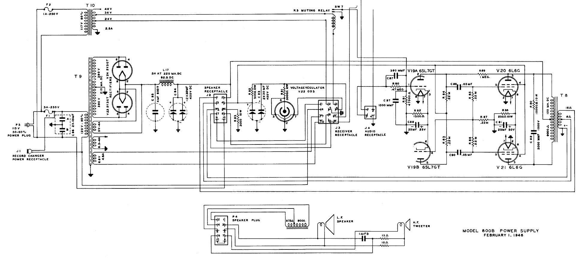

In case you're wondering about the field coils in the Masterpiece VI and the Scott 800B, here is a partial schematic showing the Masterpiece VI amp/power supply:
[Image: http://www.philcoradio.com/images/phorum...91f816.jpg]
And here is a small version of the Scott 800B amp/power supply:
[Image: http://www.philcoradio.com/images/phorum...aa7775.jpg]
Larger version may be seen here.
#42
Real quickie here. I'm trying to ride about 5 horses at once here, so the Jensen speaker project is going slow.
Got another theory about the dual fields. You never hear of them on lower ticket sets, so I just wonder about this.
Flux level in dynamic speakers was hard to get in high levels back before some of the super magnets that came to be in the WW II days and up to now. It appears that the series field winding did an accptable job in must sets, but a stronger field was desirable for the ultra-fine sets like the Scotts and McMurdos. Those power amps were running class AB. The shunt section of the field brought more flux level, and the resulting efficiency that they wanted I find that on some juke boxes, there was a shunt field used. I have an old Wurlitzer amplifier that has P-P 45's in the output, but with a 45 driver. That would have meant that Wurlitzer was pushing the 45's into class AB, and a shunt field would do the job better. It was a 1936 model. Today, a good PM speaker would do the job perfectly.
I have a pair of 18 inch speakers on my living room systems, and I can barely lift one of them. The magnets are the heaviest part of them.
#43
Doug
Thanks very much for sharing that info. It makes perfect sense to me now, and I now understand why Scott did not make any effort to replace the 9000 ohm shunt field in the 800B with any resistor when they switched to the Jensen PM speaker - only using a 675 ohm resistor to replace the 675 ohm series field of the older electrodynamic speaker.

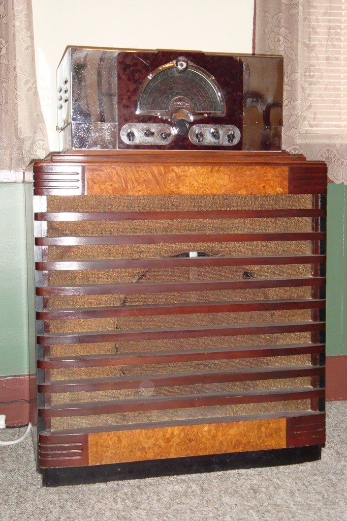

I recently purchased a Mcmurdo Masterpiece with the chassis and clifton cabinet but no speaker or power supply. After reading some of these postings I feel somewhat foolish because it is clear that the missing components will not be easily acquired. Is there any point in keeping the parts that I have. The chassis is complete and the cabinet is in good condition.
#45
If you have the tuner chassis and cabinet those are two of the most important and harder to find parts. Many of these types of sets, Scotts at least, were sold as bare chassis without a cabinet so there are considerably fewer cabinets then there are chassis to go in them, it's likely a similar story with a McMurdo Silver set. The main issue with this set is the 18 inch speaker which had a concentric mount for the tweeter, I don't know if all McMurdo Masterpiece sets used these or not. It may take some time but I think you could probably find a power supply/amplifier chassis eventually. If push came to shove you could always make one from new parts.
