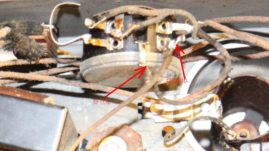

Alright, time for alignment. Got it. Thank you for the link. Has anyone managed to get a volume control like mine open to clean?I tried to shoot cleaner inside, but havent been successful yet. It still works at this point. If anyone has repaired one of these successfully, advise me. At this point, I am prepared to drill a small hole and shoot the deoxit in that way.
Tim
(This post was last modified: 02-19-2014, 07:01 PM by TV MAN.)
I am not even sure how mine opens, as there is that cap and it has no tabs. I guess it is either glued or snapped and I decided not to try to find out - spraying Deoxit inside through the large rivets worked for me.
Does yours have any hole that looks like it could lead to the element?

Some of the early volume controls have a cap over the back. My Fada 46 did. I was ready to drill but discovered that dang cap popped right off after removal of the pot (space problem) and a little help from a large jewelers screwdriver. Spraying didn't help in my situation as the carbon track was just plain mostly gone.
[Image: http://i303.photobucket.com/albums/nn129...e/pot1.jpg]
Best Jerry
